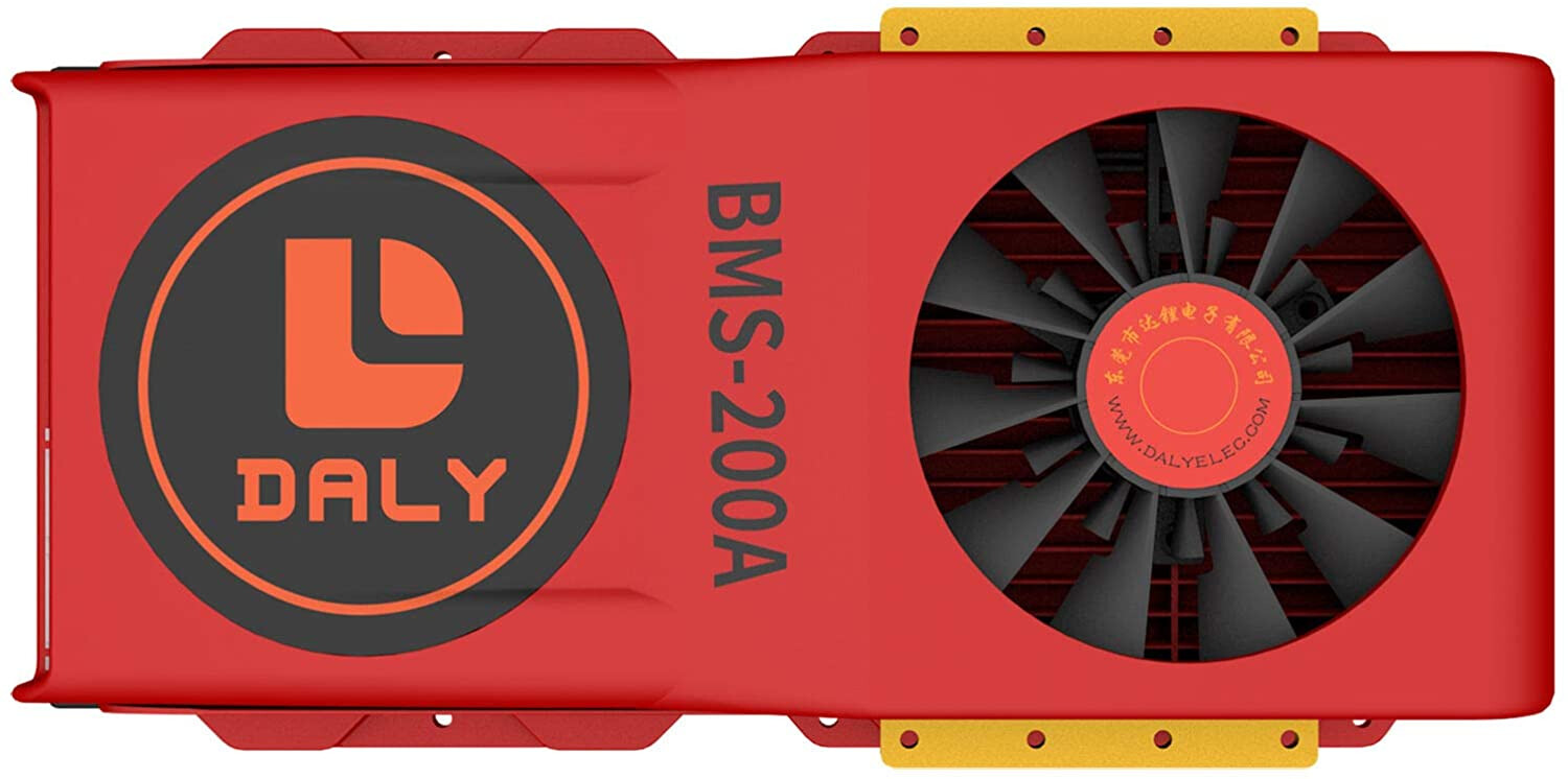

its not just about price but space. sometimes it comes down to what components you can fit in your enclosure.
I would love to use a proper 200a bms for my battery but I cant because this thing is the size of a graphics card.
