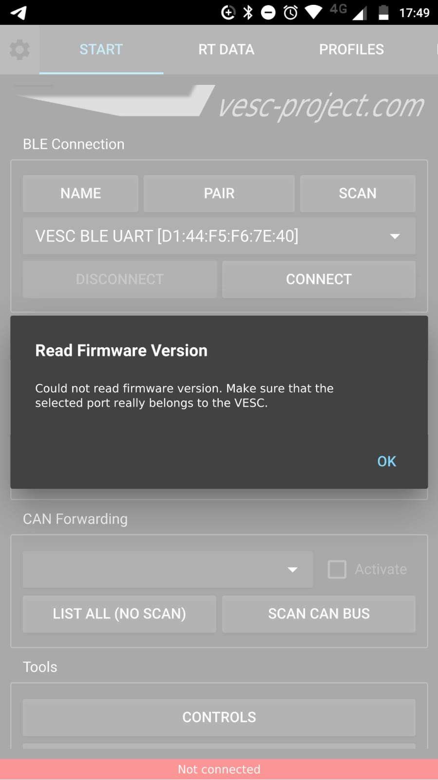

heyy i get this error trying to connect And my wand doesnt want to connect via pc
blob:https://web.whatsapp.com/1bcdb3f8-d63e-48e0-a8fa-26ee8a4b59f6
Connect via desktop version, update the FW on the VESC, you can pair the Wand via desktop version.
If you have no success, try and update the dongle via SWD Prog.
Sorry found the problem switched up 2 pins
