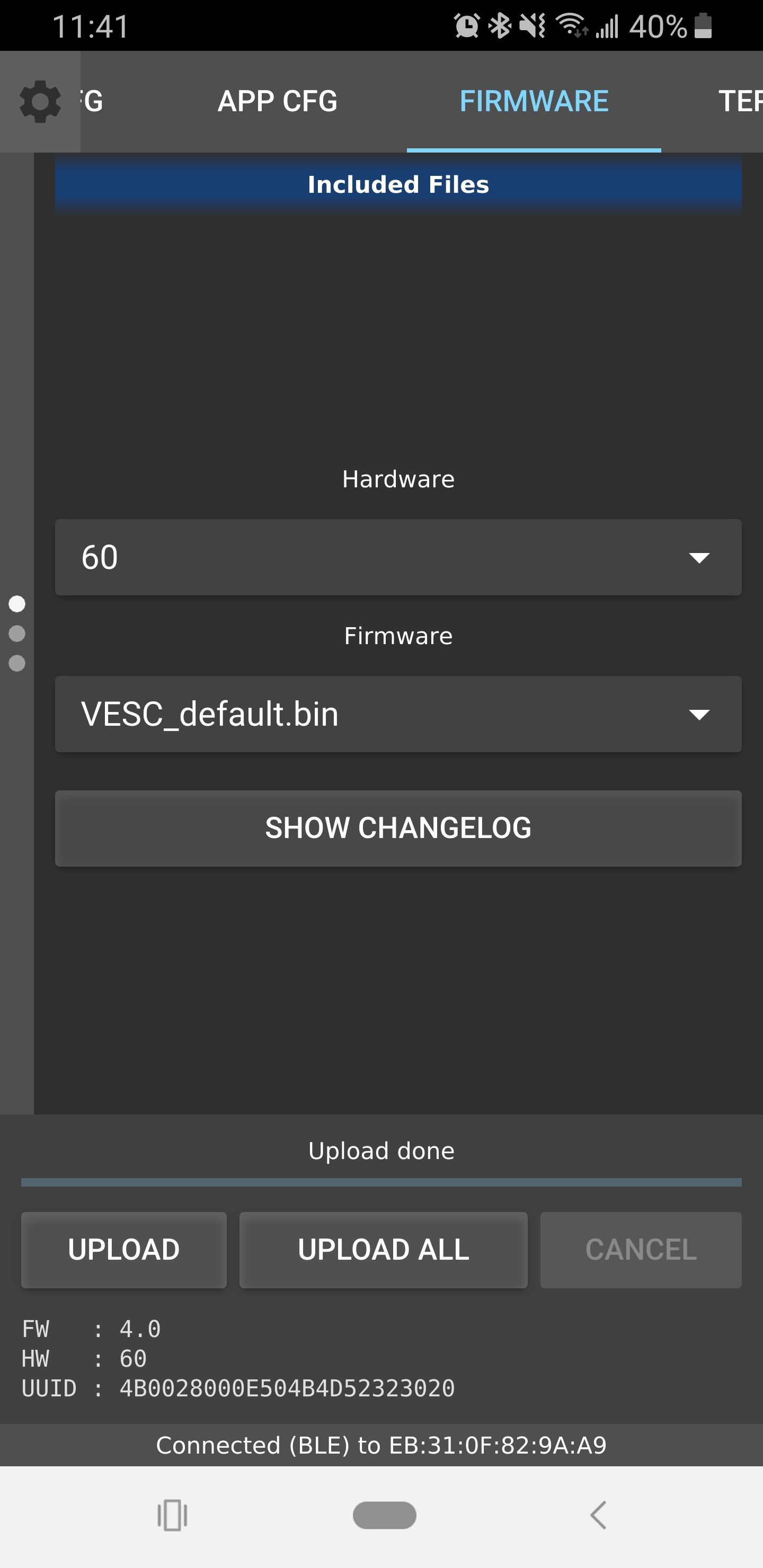

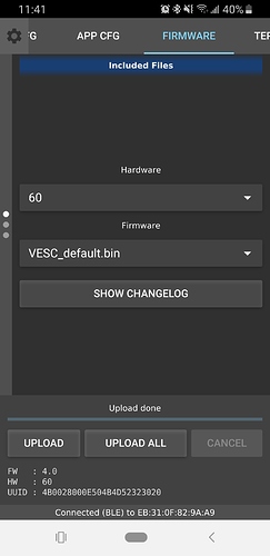

Took it on a longer ride today.

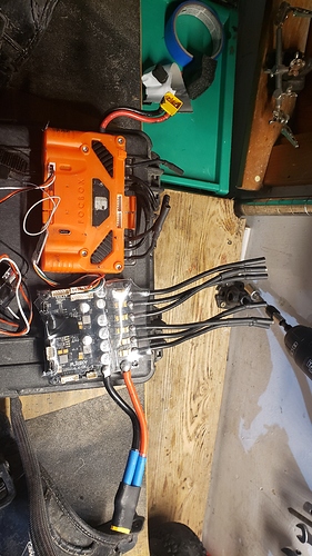

This is my MBS build.
10s4p 40t.
8 inch T1 tires. 12/62T on a chain drive
Maytech 6374 170kv. One with bad sensors.
I have been running on a unity with one motor sensored .
So I put in a Flipsky Fsesc 6.6 dual plus.

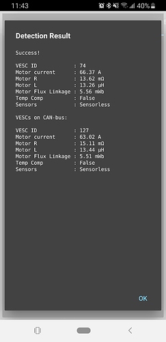

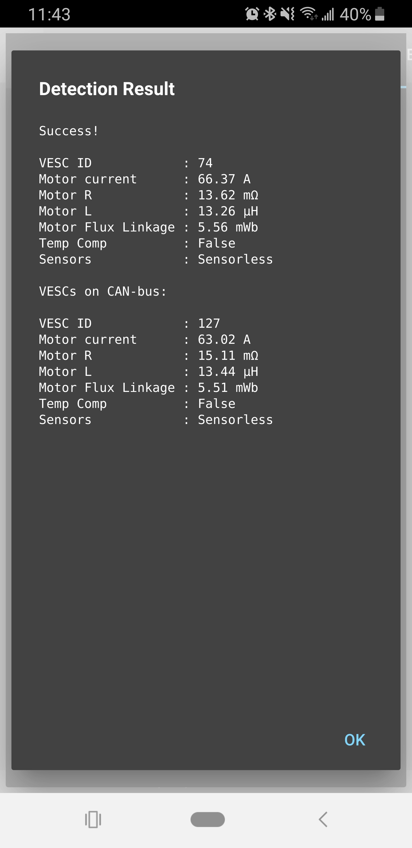

Motor detection suggested 66 amps on the motor.
Then after riding a bit I turned down to 60… After riding a while I turned it to 70.
I think it did best at 60…
It cogs a tiny bit.
But what is different is that it sorts itself out and gets going.
This is without me fighting and doing hip flicks.
So probably gonna keep this board like this because it sure as shit is cheaper than buying new motors…
I’m sure that with some tweaking it will stop cogging.
