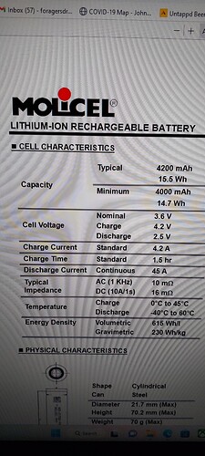

I’m running a P42A 12s8p and my battery current max is set to 60A each side. Should I up it to 120 based on this info? (Stormcore 60D)
You could definitely up it more because your battery could take it, however the recommendation from lacroix is 65A max per side

If the battery capacity for continuous discharge is 135a, isnt the thoretucal limit for battery amps in vesc tool ~65a? Im happy to leave at 50a (per side)
im trying to understand the relationship between pack capacity and how high i can run it while still being friendly to the the pack somewhat, i dont push it real hard too often, %90 of the time im riding like nanna…
Whatever app that is, its lying.
P42a is only good for 30A per cell and even that’s pushing it.
A 3p pack shouldn’t be taken over 90a, 45a per side. At 50 per side i wouldn’t be surprised if you’re seeing pretty hefty sag
Its also lying about the capacity. P42a is a 4000mah cell
Under normal conditions. I dont use under about %60 battery, it runs to the bar, charges and runs home. No sag noticed at all even at lower pack charge. (4k+ on it now)
You might not be pushing it hard enough to milk all the amps. And that’s fine. I’d still lower to 45 per side
Seems inline wIth the data sheet for typical values
