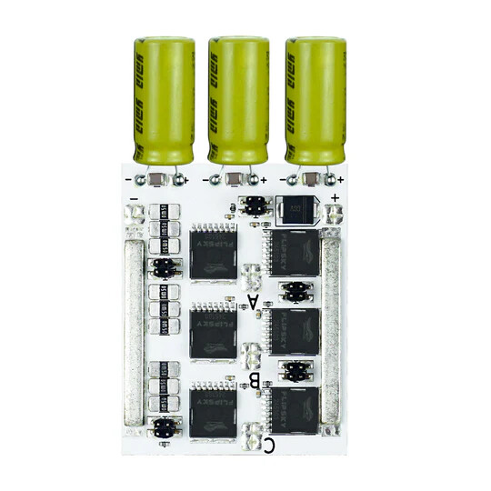

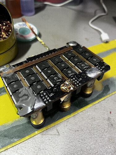

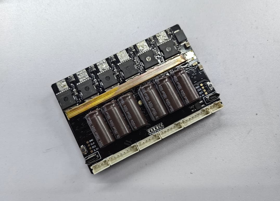

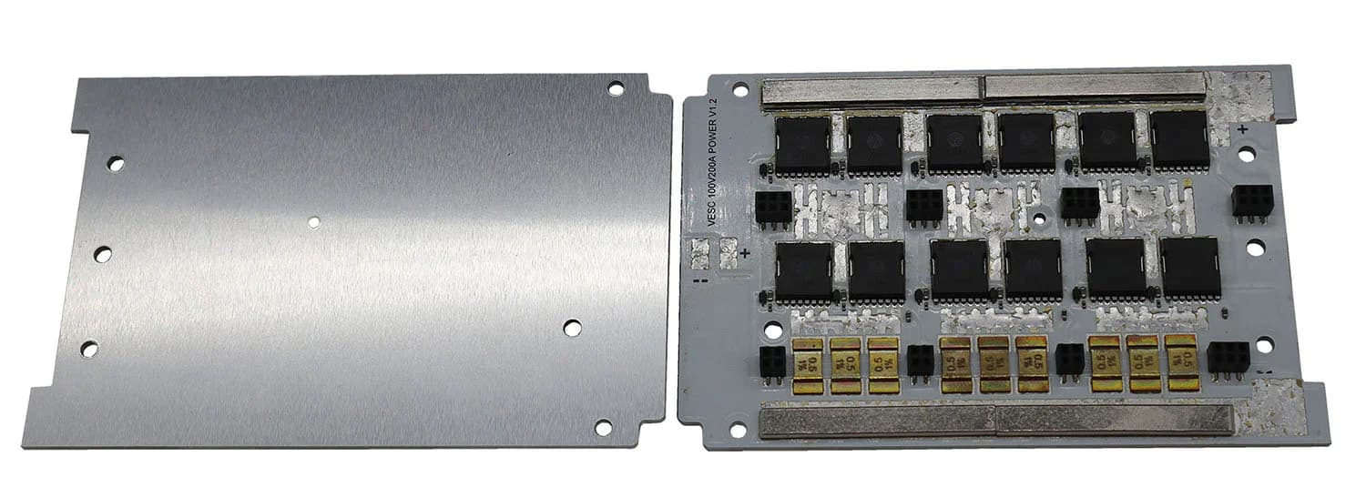

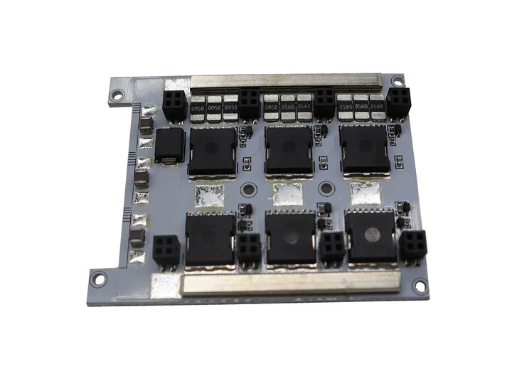

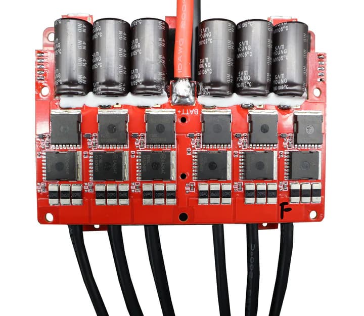

For those interested I think thats what nearly every comparable VESC does, and they look like IPT015N10N5 from the video. A little more resistance but less gate charge than HYG015N10NS1TA (used in D100S and flipsky iirc) and very similar specs to JMSH1001ATL (Spintend) granted I am very much not an expert.
Examples
Spintend 85250, 85150, 100v100a, every dual ubox
MakerX D100S front/back, G300
Flipsky 75200, 75100 (same for dual)
