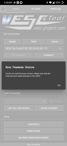

Actually pretty simple, as below LOL
I was on the 22/3 FW
Connected the VESC Tool android app of 10/4 using BLE
And then I flash FW by [Upload All] button using BLE
Flash completed via BLE
Reboot VESC
Try to connect using BLE but app started not recognising VESC with error screen below.

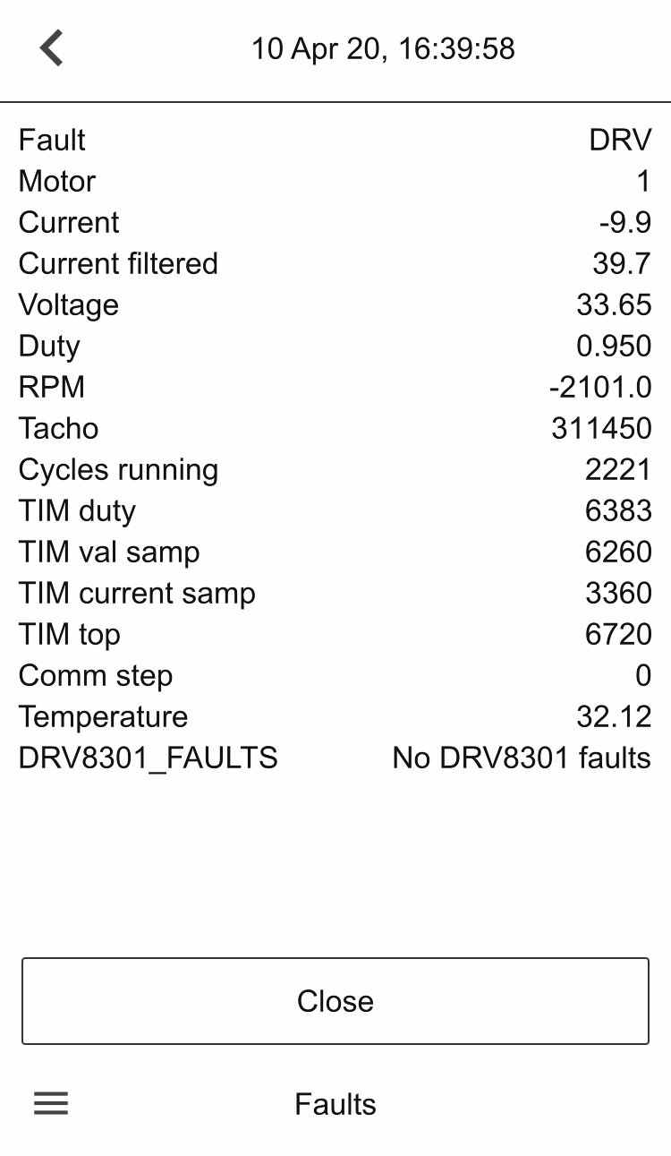

  • Why can’t I set ‘Absolute Maximum Current’ to 130A? 400A seems to be the minimum.
  • When I checked the fw version of the vesc over CAN it stated that it was on beta 3 but this wasn’t the case. Is it possible that the version check only is valid for the main vesc?
  • I was able to recreate DVR error and it was because of first going in reverse and then very briefly accelerated forward but without load, so very aggressive change of direction.
Did you wait 10 Seconds before re-connecting?
Yes I waited the 10 second buffer…
It is set to 400 intentionally to disable abs over current faults (that is the only thing that setting is used for, throwing faults). They are redundant with the DRV and were giving false positive with the unity hardware previously so we decided to disable it.
Is this while you were riding the board? Did you re-run motor calibration? Can you share the detected parameters?

No, on the bench, so just the wheels spinning. Yes, redid motor calibration, here are parameters:

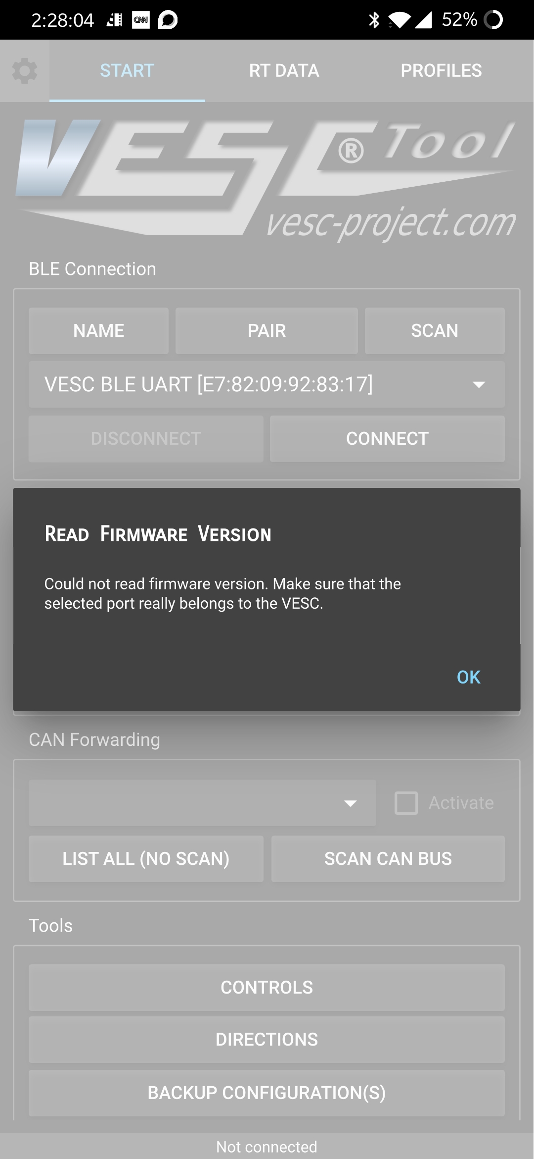

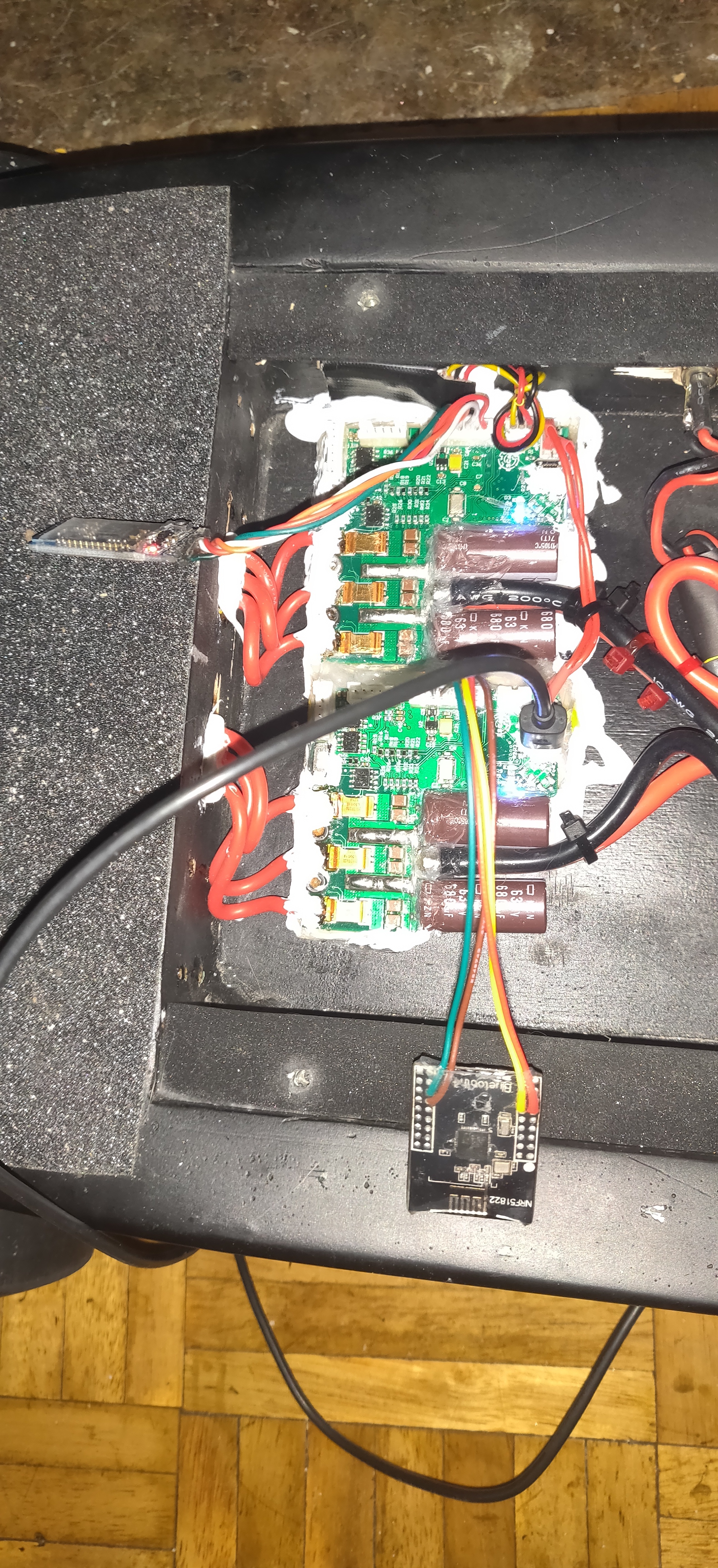

so I finally hooked up an nrf module to my ESCapes running fw5, beta3 currently. I have the matching test version Android app installed and I’m getting the firmware read error, am I missing something?
nrf51 module flashed with vesctool, uart @115200
Does it connects for half a second then disconnect then show the error?
yep, that’s what it does

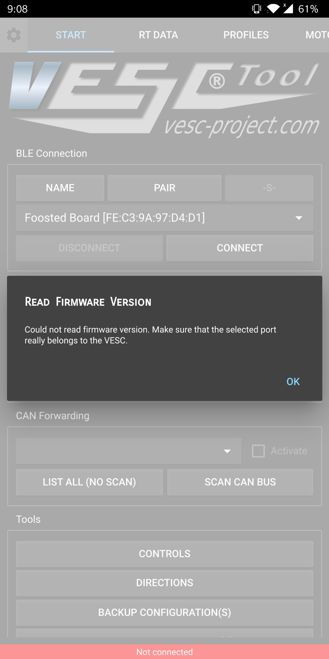

I’ve also gotten nothing besides firmware read error (connects for half a second then disconnect then show the error) – on any ESC and on any HM-10 or nrf module.
This was on various firmwares 4 and 5 of any version I tried, with Rx/Tx swapped or not swapped
I said “fuck it, don’t need that” and shitcanned it all. USB for the win
hmm, not fun
I also tried swapping tx/rx incase I’m cross-eyed
and I tried an hm10 module even though I thought those aren’t supposed to work with 4/5
The last successful bluetooth connection I’ve had is on HM-10 with Ackmaniac 3.103
That top one isn’t supposed to work, but I also tried it :expressionless:
