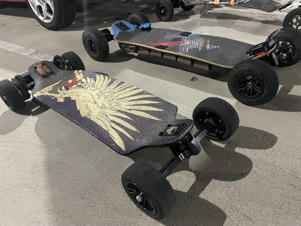

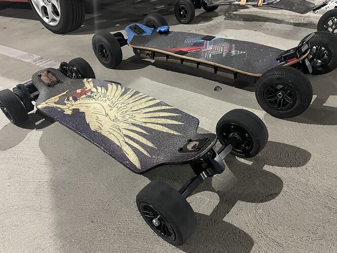

oof. :smiley:
my poor cable managmeent, combined with bumping into a sharp metal edge. … sliced through my phase wires.
strangely it still functioned on two phases each motor. just felt coggy like the sensor wires were broke, but. a bit weirder. didn’t expect to find the phase wires chopped. (one on each motor )
And this means time to freshly rebuild this board to be a reliable powerhouse :joy:

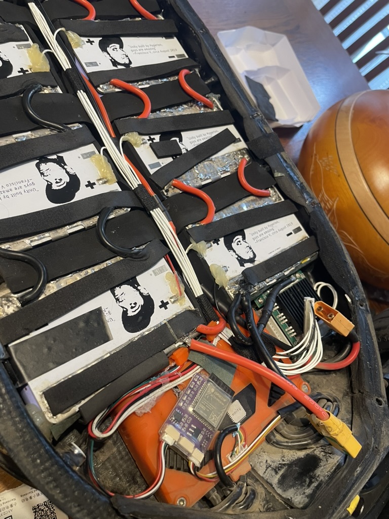

was running an external receiver. to be able to try different remotes without opening it up.

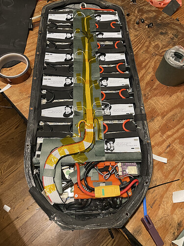

but.. never got it mounted very well. and stopped switching remotes. so opened it up to put it back inside.
And decided to upgrade to a smartbms. ( blame it on my adhd ) so I can watch how much longer my 5+yo battery holds out.
old
new
