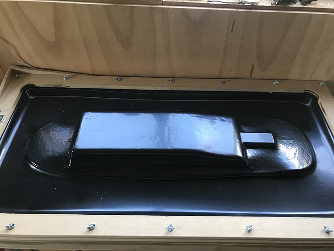

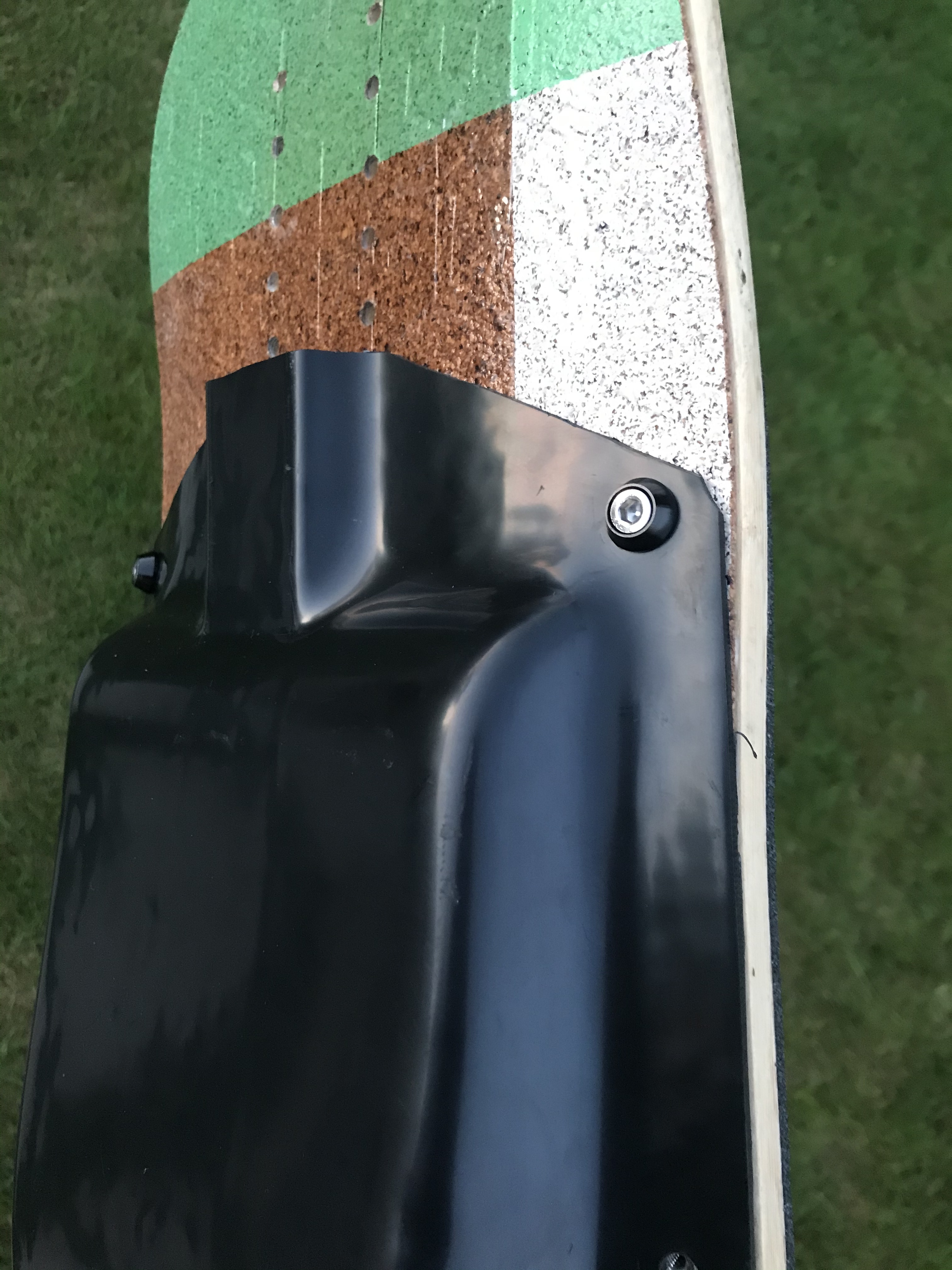

First attempt at vac forming today.
3mm styrene sheet formed over a buck and the deck to get matching concave on the flange.
Very nice! Are you going to use that one for a mold so you can get the concave shape on the next buck? You could probably save some space and material that way.
Yeah considered that. Might do. Really just a test of the heater setup and vac former first. Went pretty well after I removed the tilt switch from the heater I used. Haha.
Spent minimal time on preparing the buck which was just repaired from one I broke when I made a vac bagged carbon enclosure. Covered in packing tape which actually showed up on the vac formed part which was a surprise.
Probably remake a smaller frame to just cover the board and save material and make a new enclosure buck with a new shape.

Result.
Harder to cut neatly than expected. Melts easily. Best result with score and snap. Followed by hand held electric planer. :+1:

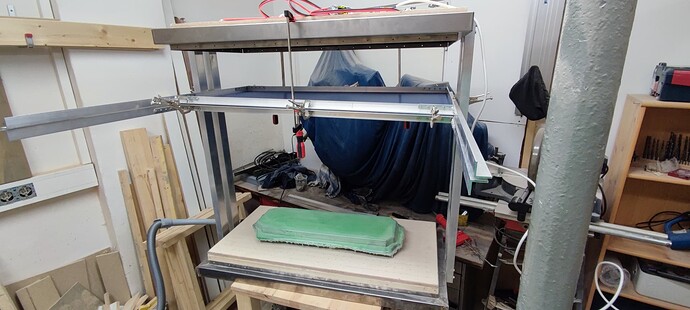

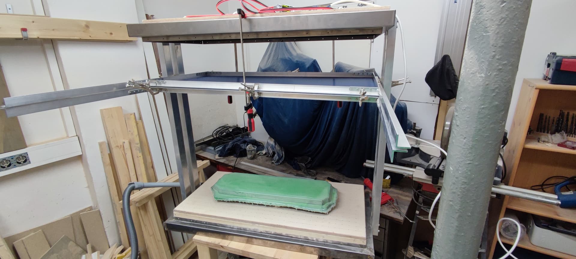

We are on a very similar mission. Fired it up the first time a few days ago.
Result was quite shitty but now I know I need to work on better heat distribution.
If only 1000x500 mm² ABS was cheaper I could test a lot faster to iterate. Know I’m stuck with overthinking instead of spending money :frowning:
