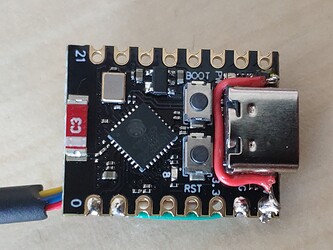

Sweet :slight_smile: I also made a small one like this for a friend. He uses them for access via WiFi, since it’s more stable, than BT. It needed to be powered via 5V, so I cut the traces from USB to 5V, on the underside and lifted the diode, isolated the pad below and rerouted it (red cable from diode to 5V-pad).
Also isolate between underside of USB-C connector and CAN-tranceiver. If you don’t do this, it will create a short between GND and 5V… Yep it happend to me… :joy:
Yeah thanks, I used double sided tape between the two
Did you isolate the 5v from the USB incase your friend wanted to use it?
I just paralleled the 5v pad on both the canbus transceiver and esp and didn’t bother cutting traces as I won’t use the USB C whilst plugged in anyway.
Then you should be all set! If my friend ever want to use USB-C, he can do that, while powering via 5V and GND of his VESC. RX, TX and GND of USB-C are still connected, but I didn’t want to be responsible for frying anything at his side, so I cut the 5V trace, leading to the diode. :laughing:

This seems to be the same approach the later VESC Express modules took as well, no power over 5v. It means setting it up without knowing that is a total pain though, because it doesn’t respond to just USB

I had the same issue at first… I solder R0, to connect USB-C to 5V-rail. However normally it’s powered by the VESC and not USB-C.

In my understanding you have to use GPIO0 and GPIO1 for CAN and GPIO20 RX and GPIO21 TX for UART. Please dont get confused! I messed it up when I did the image of “side-by-side comparison” in my initial post.
