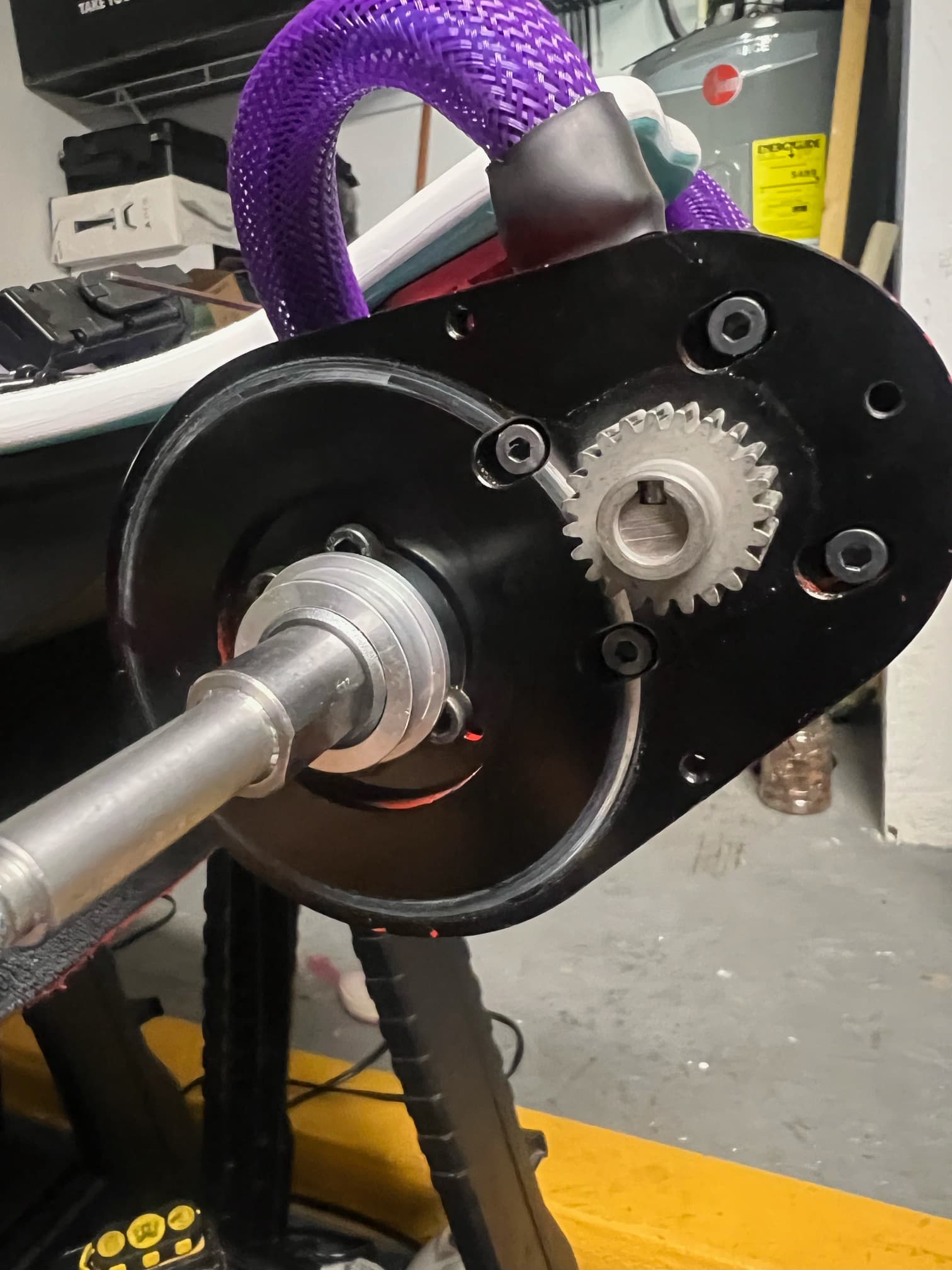

What’s the smallest possible motor pinion tooth count for this drive 13t?
Thinking how the 88t straight cut might help with reducing RPM and giving a bit more torque
gonna hope I can either find a moderately robust low tooth count motor pinion or make one myself..
17T is the minimum. And if you go any smaller it wouldn’t be robust.

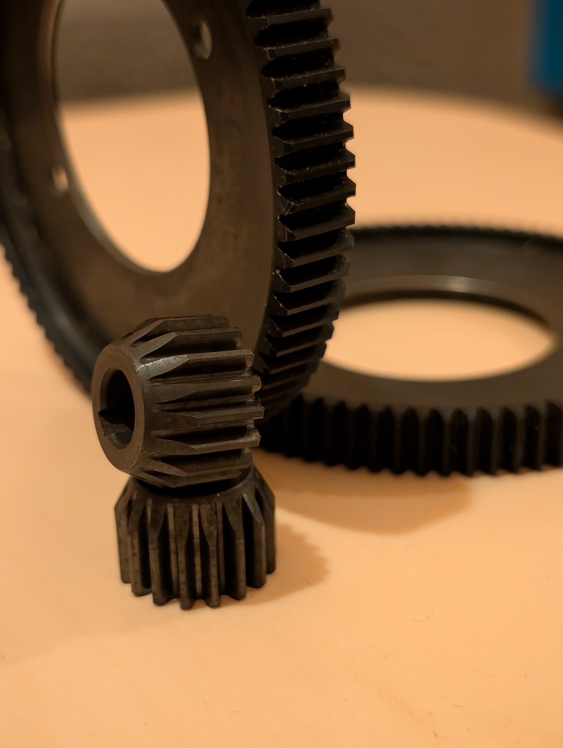

Kevin made a very small batch of 16t mod1 pinions. He specifically clocked the keyway so it aligned between two teeth, to maximize the cross section. He also added a collar top and bottom of the teeth to add strength.
At the same time, he made a batch of 89t wheel gears which he said are the largest possible to fit in the housings.
I’ve been using my set of 16:89 gears for a couple years now on Mistfall. They’ve been hauling my 300lb ass around, taking 4000W each, without issue. Opened the drives up recently and there was no sign of failure or significant tooth wear.
So I’d say, with all those added considerations, that 16t is the smallest mod1 pinion that can be made for an 8mm shaft with a keyway.

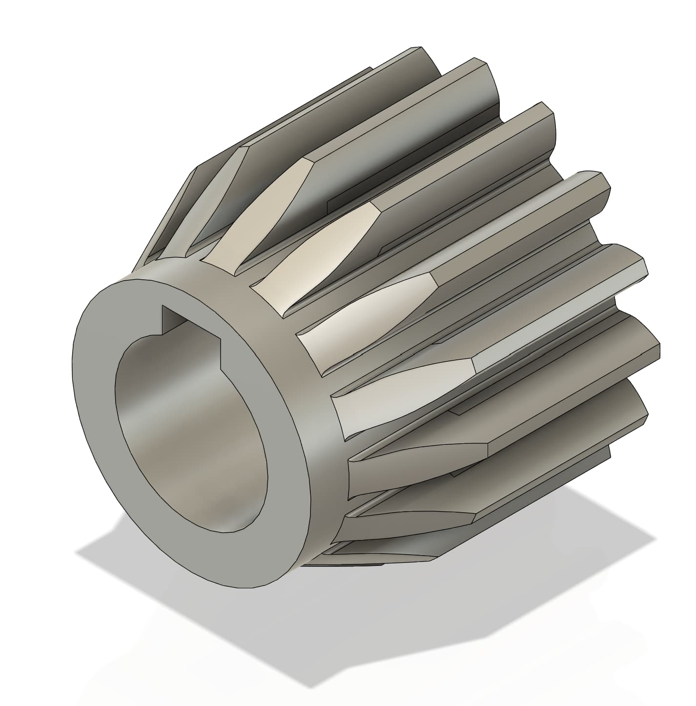

I have a design in mind for a 15T keyed mod1 pinion

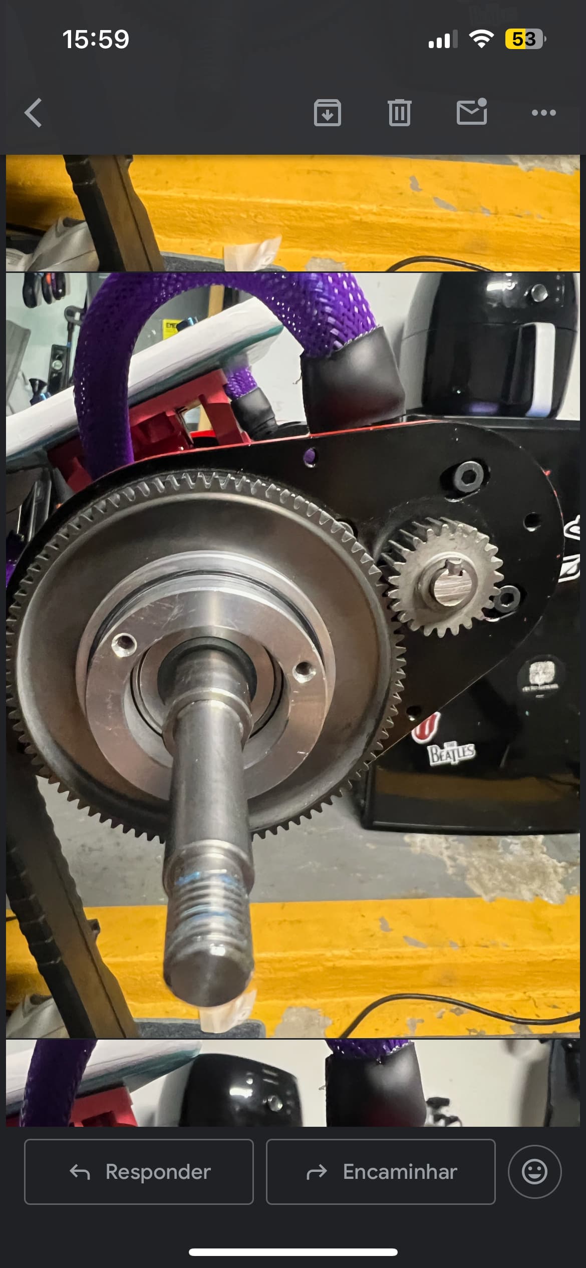

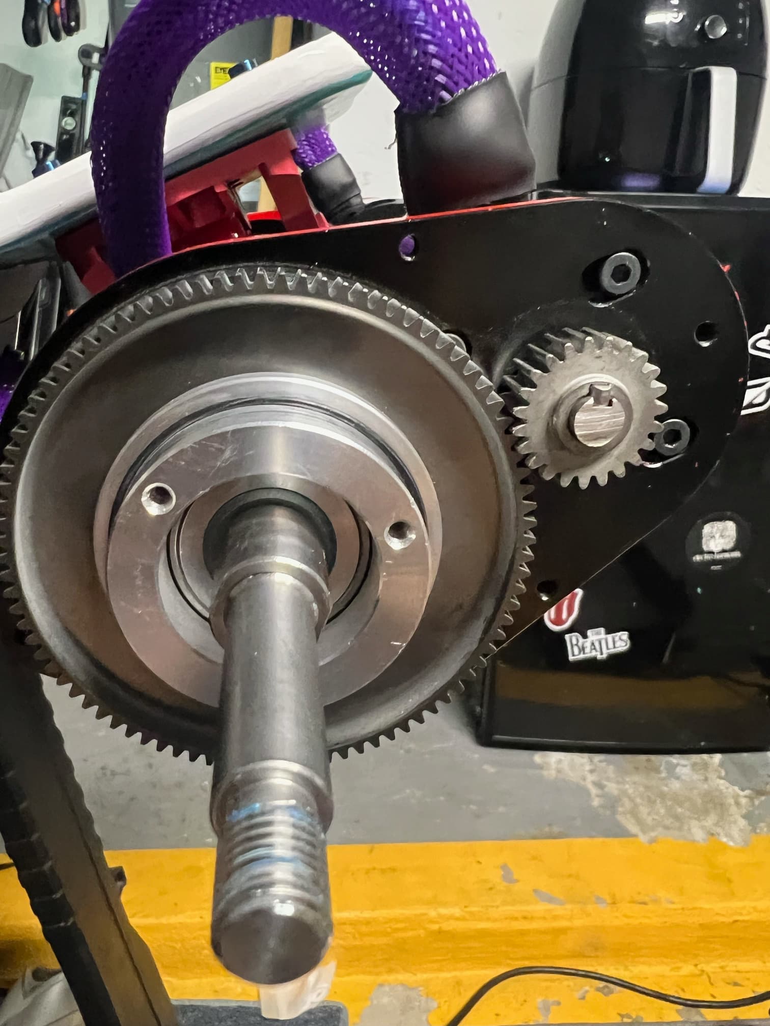

what’s the largest that fits?
I have 17T/65T for 3.82 gear ratio on my BN.
i’m now wondering why kevin didn’t chose a bigger pinion instead of the smaller wheel gear.
I think it’s either 21T or 23T? Not sure.
hmm i bet it’s 23/88 and somehow I got confused. been so long since i had them open. the only record i have is kev saying 3.82. damn I don’t want to open them. but tempting to get more gears in this buy. :smiley: (mine are already straight cut)
Given the pretty short motor adjustment range, I’d think all the ratios use the same wheel gear
mine is a straight 23/88, might need new ones soon
