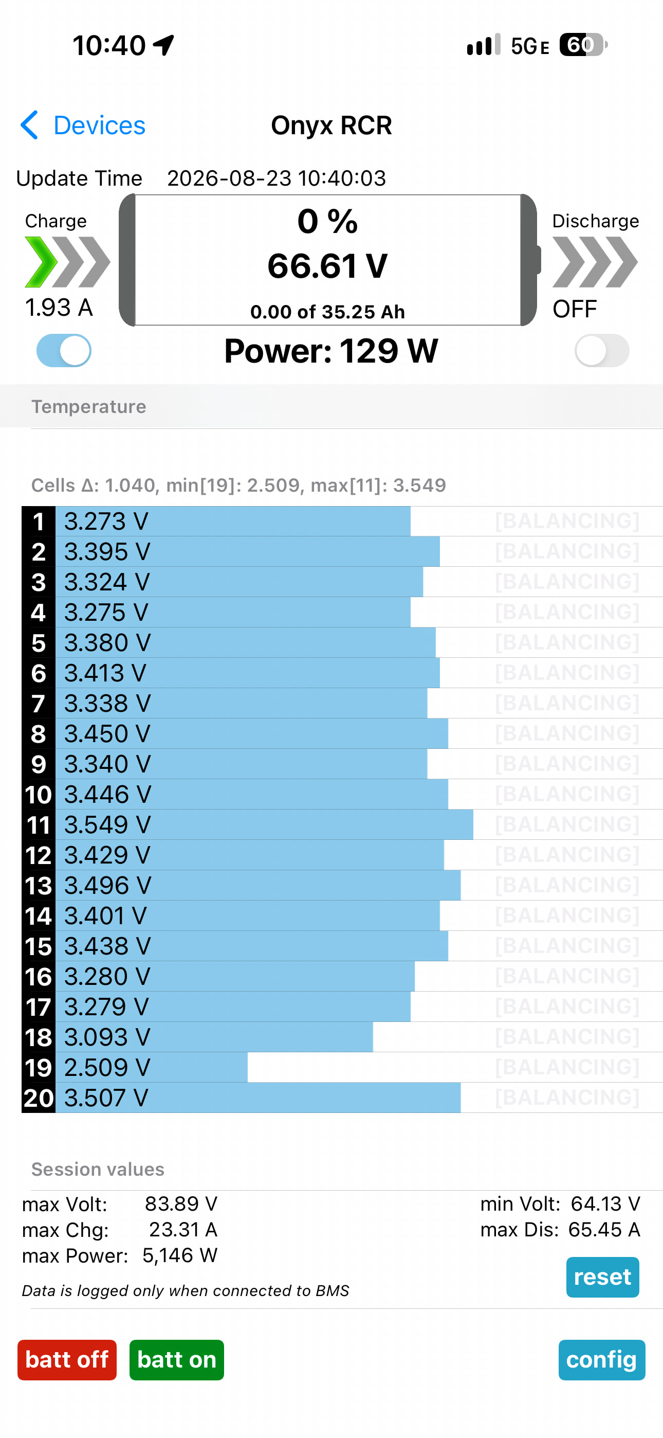

@kkim0228 I really hate to do this, especially since we are local but I have to back out for this $150 deal of a lifetime. I just realized I might need to spend my money elsewhere. I got a time bomb on my my hands I have to deal with
Josh @monsterbuilder will definitely put it to good use and build a beauty
Bummer dude. the onyx is a big big expensive battery huh?

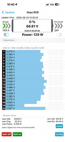

This 20S battery is like 7 years old. Replacement is around $1,400 after taxes and I need to get or make a new $40 connector for it to connect with the bike. Cell group 19 dropped to 2.2V today, way too low to charge and hope it balances (plugged it in yesterday, THEN looked at the BMS app and immediately unplugged it) It’s all glued together inside, hard to get to the cells and I don’t think putting 20 new cells in there would be a good idea given the age difference. I miss Dave, I would’ve driven this to his house so he can burn his place down prying at it.
