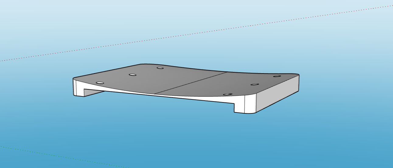

Created my own wings, they are hugging an old Trampa Carve deck (around 7 years old or something), looks similar to this one:
I didn’t want to just install extensions on both sides since I had no solution of how to take the current grip off, so I made a whole “block” on top instead, printed in PETG-CF, quite happy with the results.
