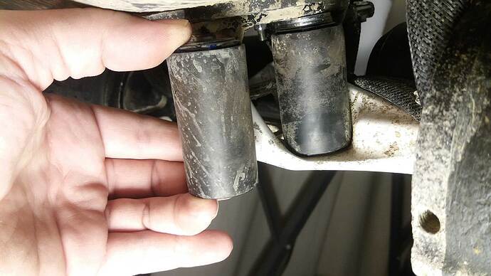

Alrighty, I changed the back position as well to inside, and rode it in a little. YAY, starting to get the stoke out of it now! It’s just also a completely different riding style you have to get used to, but it’s actually very carvy! Currently still running naked without motors downhill. Will set it up now. Looks like I would need either 8 inch tires or need some massive risers though as I have the feeling with 6.5 Inch wheels I would hit the bottom of the enclosure in the curve.
anybody tried to slightly cut the trampa barrels => shorten them to get a bit easier turning?
As minimum one guy cut out small rings in the middle of the Barrel to reduce the overall diameter. Not sure how that turned out in the long term.
I wouldn’t shorten them.
They should just fit how they are in between the baseplate and the hanger. They shouldn’t be much compressed. If you take away some mm you have a drop of no damping at all and then the same like before while turning.
Doesn’t make much sense I think.
I’ve seen people cut wedges out of the sides of them but I really don’t think it is necessary. I am 160lbs and can easily turn them on the inside positions. If it is cold out they do stiffen up a good bit though. In the summer they are wayyy more carvy.
Man I wish I had your problems, I need longer ones. Please send me your cuttings so I can prolong mine.
But joking aside don’t cut it because :point_down:
Which deck do you have and do you ride with bindings?
With the wobbling Trampa deck (elastomere in outer position) and bindings the trucks were very carvy but also stable at speed which was great. With the ultra stiff MBS DW II deck the same trucks are way too carvy like if made for kids and unstable. When accelerating too hard the trucks start to wobble , also off-road they tend to wobble above a certain speed. But unfortunately it’s the only setup which works for me when riding trails.
You’ll laugh but I need to compress them with washers.
With 1 washer still wobbling so next step were 2 washers. This is how it looks compressed compared to uncompressed
i have cut the barrels before, I’d recommend using a hacksaw.
Ok thx to all i think i wont cut them :sweat_smile:

I still prefer the E-Toxx retainers for 2 reasons. First the shape at the end is more rounded and they are adjustable. There is a M8 threaded hole (combined with M5 for bottom) where you glue (or thread locker) in a M8 grub screw. If you have holes in the deck you can adjust the compression of the dampers/barrels from top like with springs. I use shorter grub screws so nothing sticks out on top.
I wouldn’t need the washers shown in the pics in my previous post but it feels more sturdy and this way the level of compression is everywhere the same.

5mm, it was to fit them to a set of scrub trucks as they would have been compressed by about 10mm
The supplier sells 2 different shore ratings, the softer black ones and the harder red dampers. For science I bought the stiffer red elastomere dampers and it was a waste of money. They are so hard that it is impossible to steer, on lean the opposite wheels lift off instead of a curve so straight riding only :man_shrugging:.
I sent the dampers to a guy in australia (for shipping costs) because he wanted to try them even after I told him many times it makes no sense except world record speed runs without turns. I never got feedback from him, maybe he never came back home after his first ride because he couldn’t turn and is lost in desert :joy:
