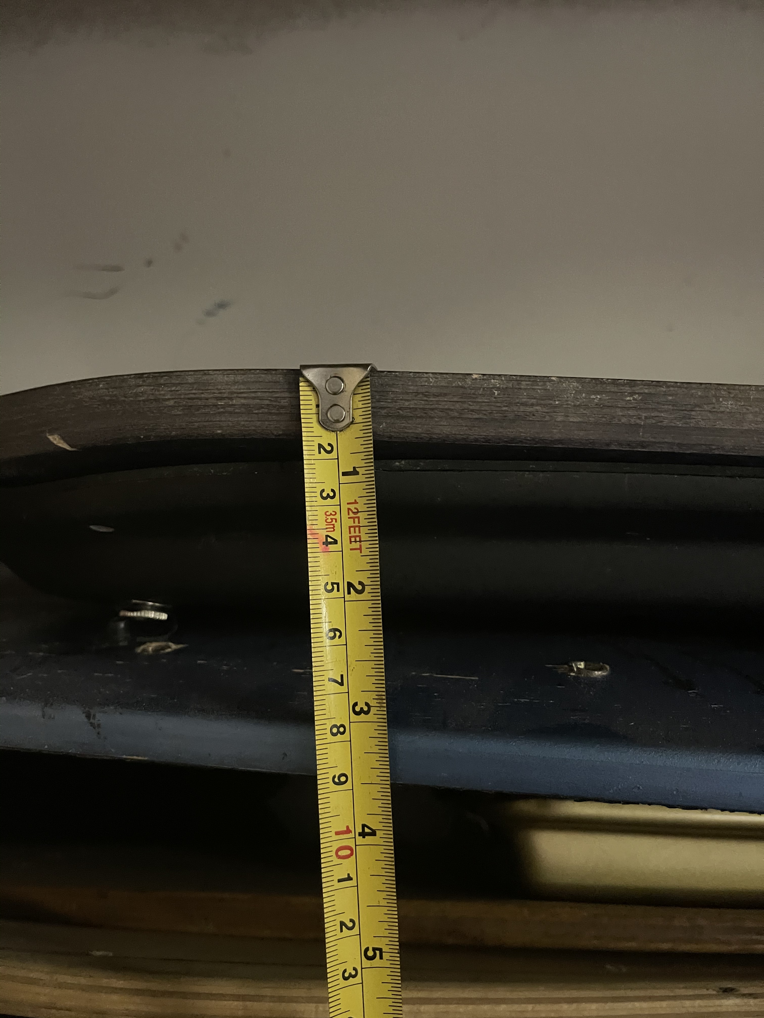

It seemed like quite a lot of people ordered these a while back so are they still holding up flawlessly? I am about to order 16 m5 which are 10mm long for my Haero bro 96 stiff deck and I was wondering if this is okay. The deck is 13.5mm thick.

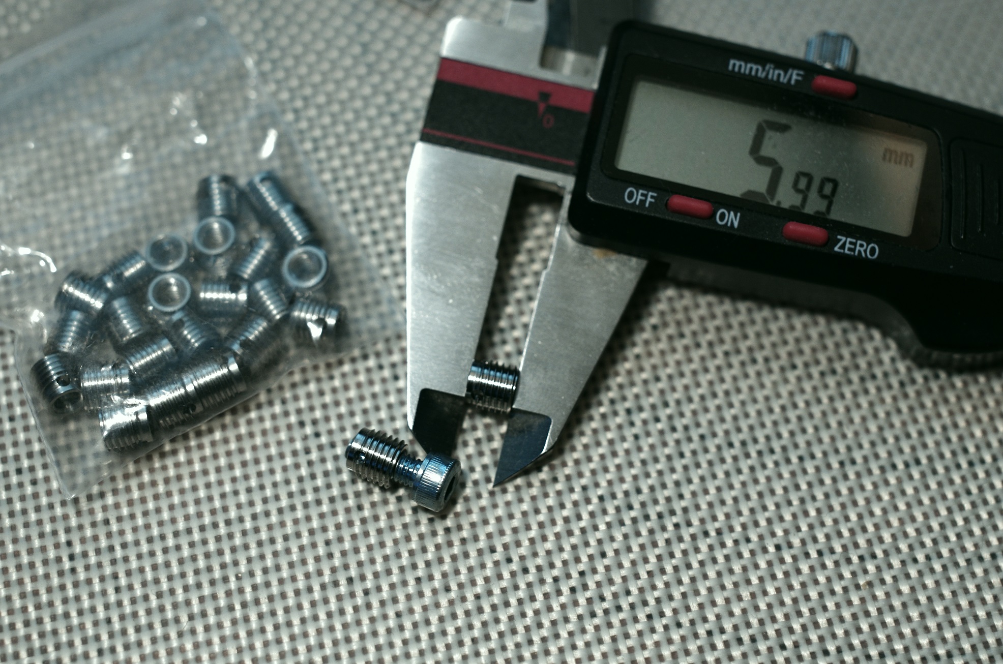

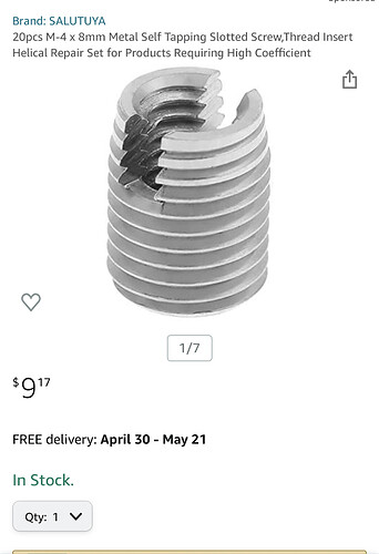

These are the inserts Kaly sends with his enclosures. They are M4 -07 x 6mm, and I can’t find them anywhere. The shortest I can find is 8mm for m4. They are really nice to build with.

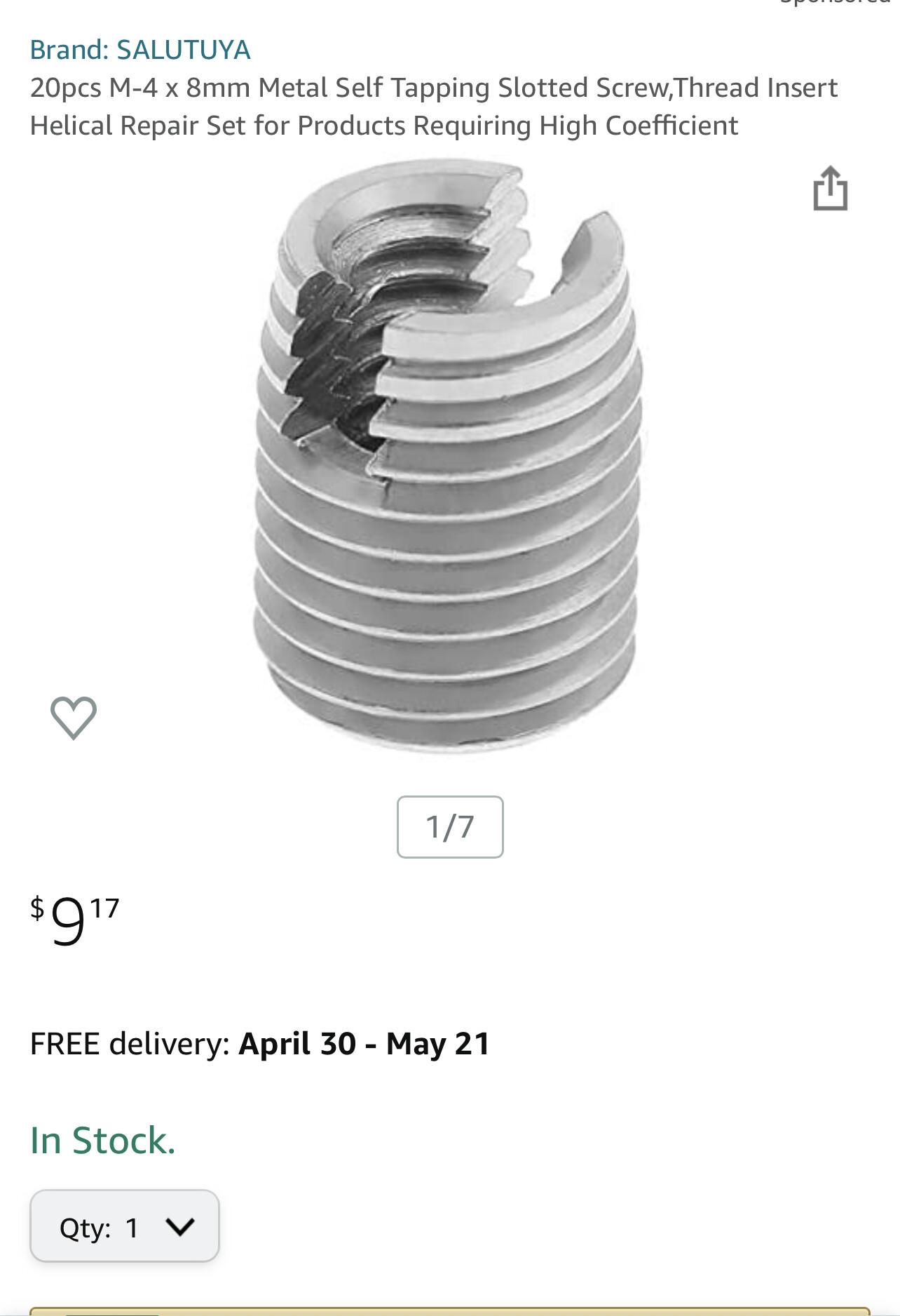

20pcs M-4 x 8mm Metal Self Tapping Slotted Screw,Thread Insert Helical Repair Set for Products Requiring High Coefficient
https://www.amazon.com/dp/B08RZ8ZTG6/ref=cm_sw_r_cp_api_glc_fabc_73F7SB99PSYGA11X6H16
Would these work or is 8mm to long
Links :us: if you have any would be great
And wouldn’t you want to go bigger than m4?

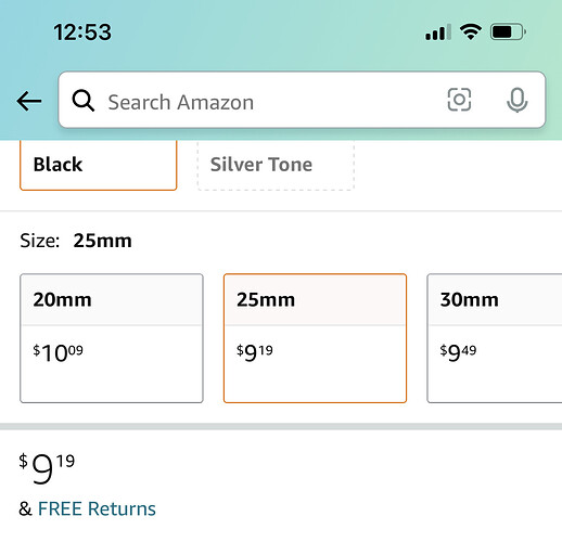

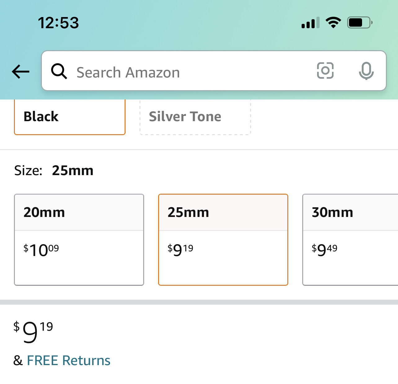

What length did you buy it’s for a evo
Idk about your deck thickness but I went with 25mm
Thank you. I really appreciate the update. I just ordered them.

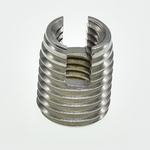

I have been using some threaded inserts put in via epoxy and 2 off them got cross threaded and got pulled out
I tried putting in some new ones using jbweld but they keep coming out again
What epoxy can I use or is there a better method I can use
What inserts. Can we see how well youa re filling the hole back in? Could you add something to the epoxy?

How big are you drilling your holes?
The inserts should still have a tight fit into the deck - you can’t just ream out a massive hole and fill the gap with epoxy. Epoxy can’t be threaded (well).
i fill with liquid epoxy and while it is still wet i push in the insert after taping the bottom of it
then the epoxy hardens around the insert
If you’re pushing the inserts in, not threading them in (assuming you’re using externally threaded inserts), your hole is too big.
