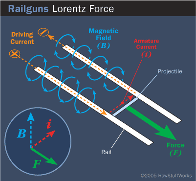

capacitor bank powering either electric motors or a rail using the lorentz force.

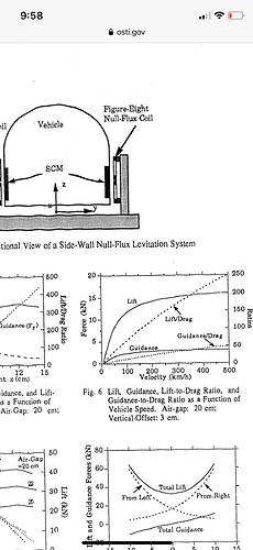

i was looking into the drag forces a magnetically levitated vehicle might encounter, this paper is pretty interesting:
https://www.osti.gov/servlets/purl/10145105
^top right chart clearly shows the lift to drag ratio increasing proportionally with increasing velocity, up to 250:1 around 500kmh
a 747 apparently has a lift to drag ratio of around 17, and steel wheels on a train track are about 1000, apparently from rolling resistance
… so if the trend continues, then around 1200mph (2000kph), the null flux magnetic levitation gets the same “rolling resistance” as metal wheels on a metal track…

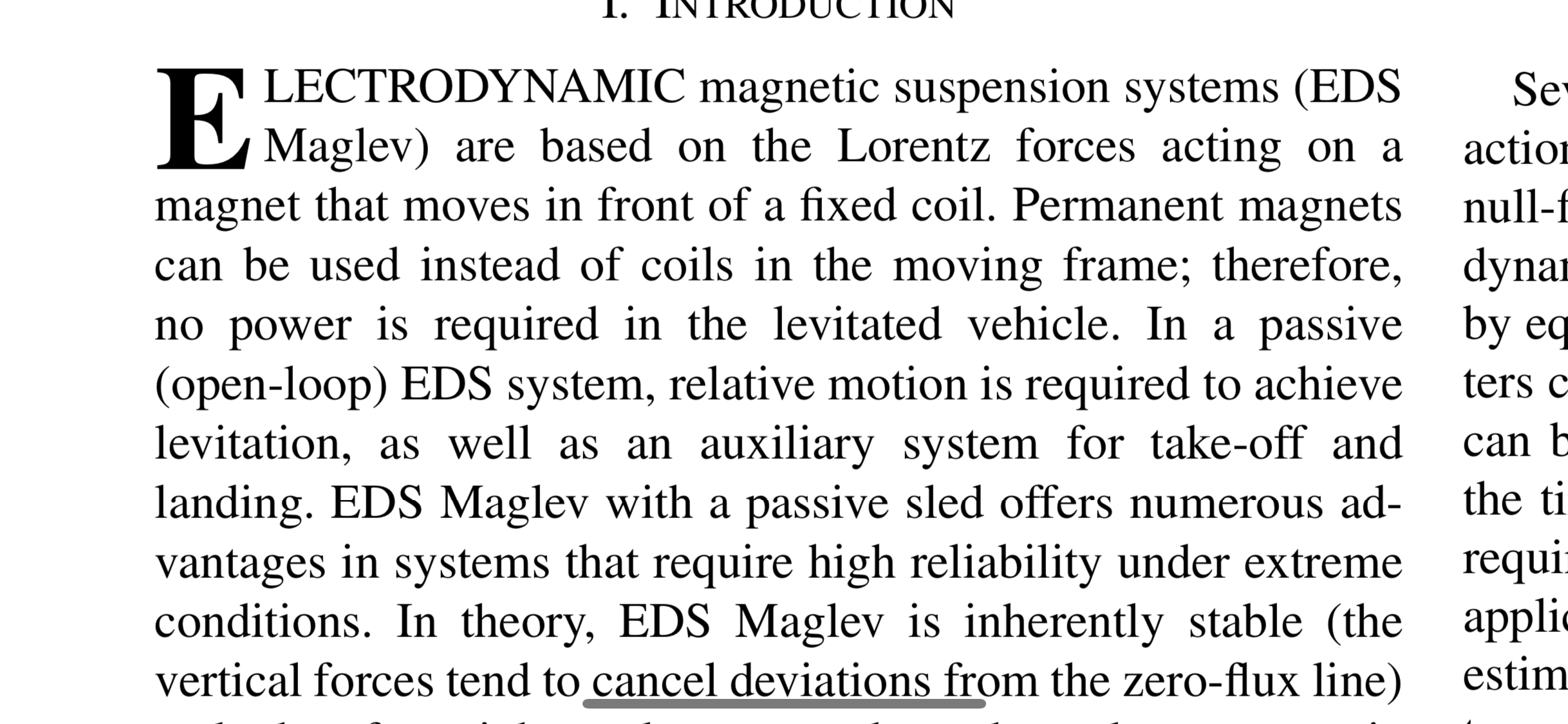

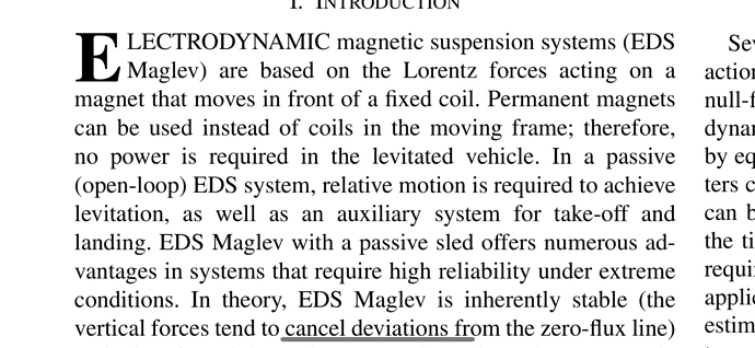

further info:
^”no power required in the levitated vehicle“
“relative motion is required to achieve levitation”

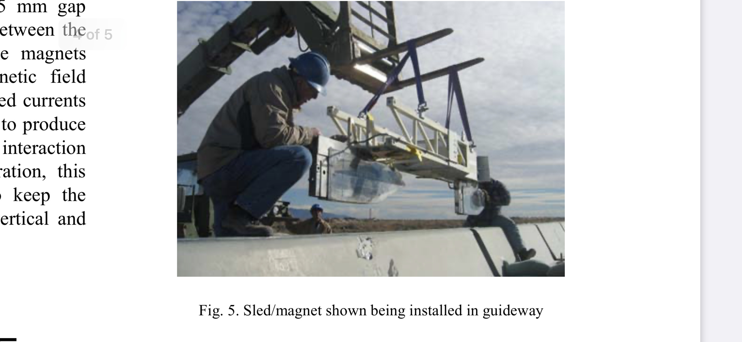

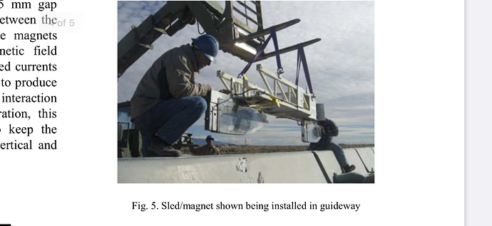

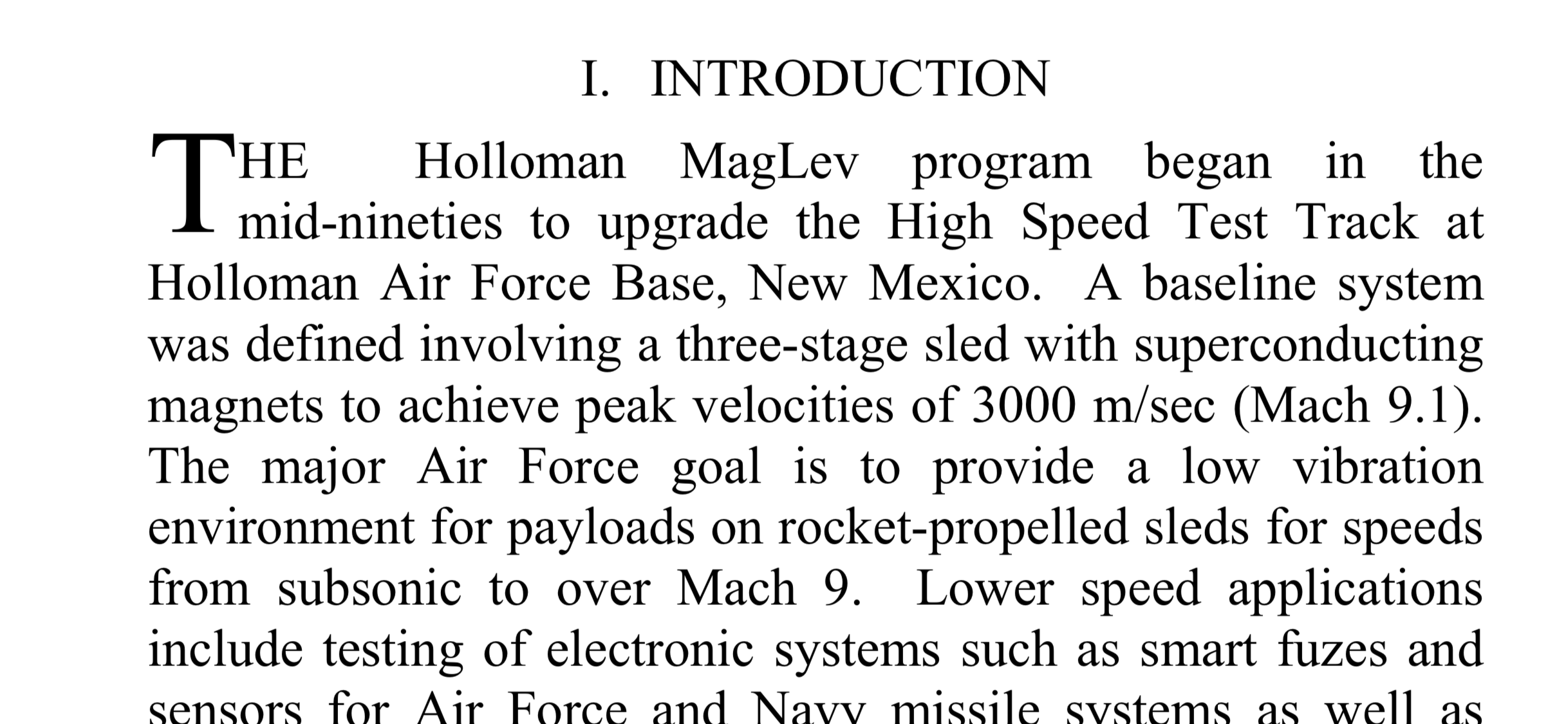

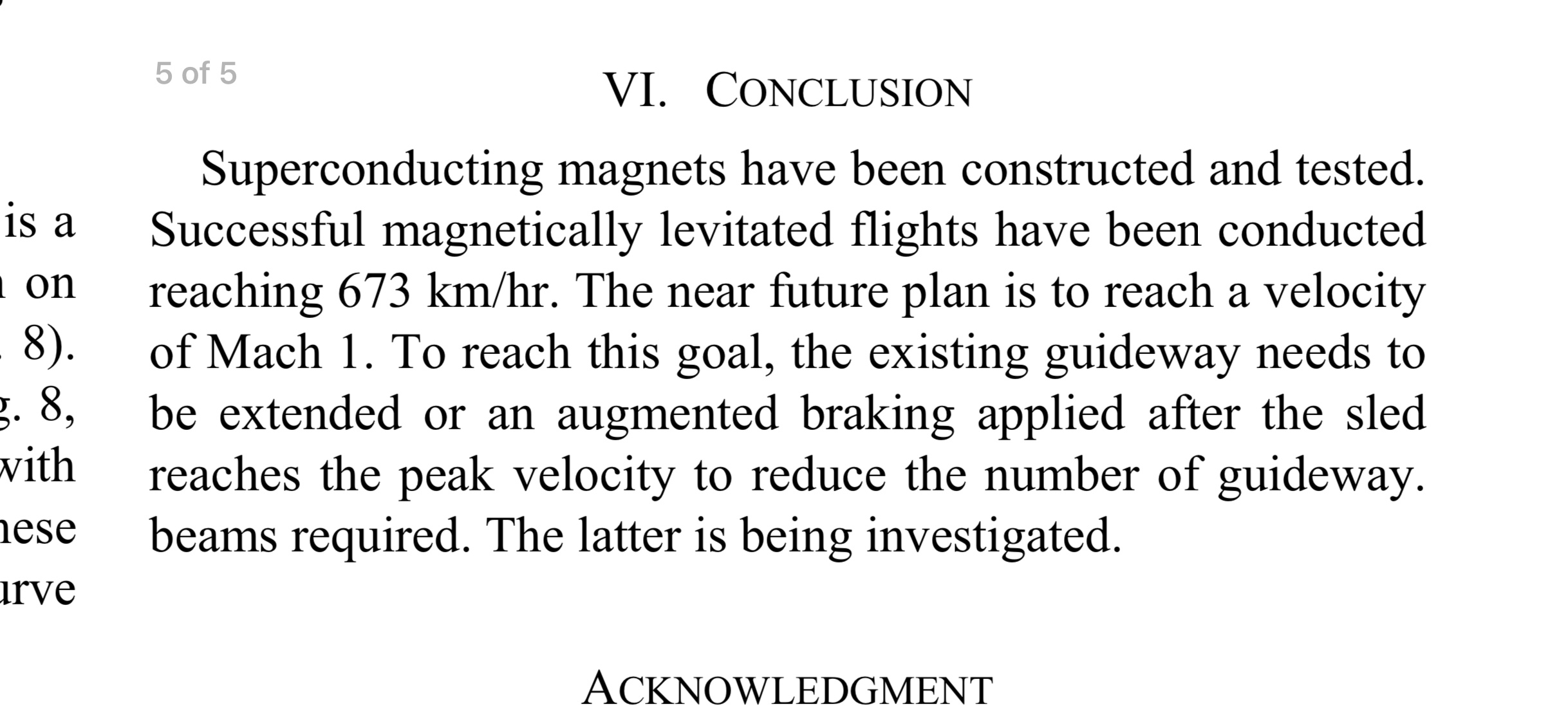

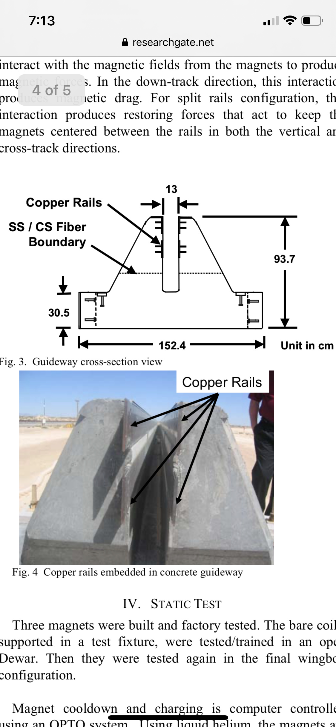

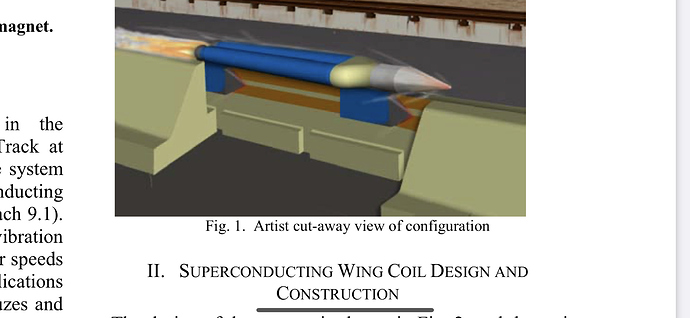

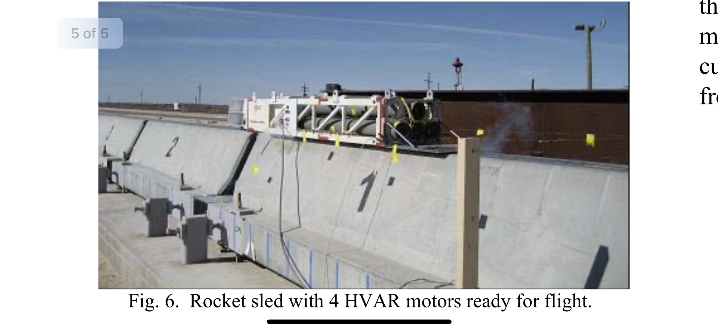

it seems the air force has been testing a mag lev system that will be able to reach mach 9 which seems applicable to the wormhole:
this video from the holloman high speed test track shows that maglev @ 6,599mph is achievable:
hypersonic

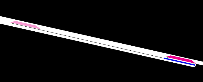

I was thinking a problem is the water tank coming down the ramp has to be quite long and possibly massive to give the vehicle low enough acceleration for passenger comfort (3g’s or less) when the full tank is pushed at the bottom of the ramp. Since you have to lift the empty tank you want it to be a light as possible to use the least amount of energy lifting.
So to mitigate the problem what if there are 2 tanks set up like an elevator counterbalance, when the vehicle with the full water tank is falling down the ramp, the empty tank is getting lifted back to the top simultaneously, and when the vehicle pushes off the full tank at the bottom, the empty tank is already back at the top ready to be refilled with h2o.
So I’m trying to figure out the best way to “push” the water at the bottom of the ramp so the vehicle can accelerate to a reasonable speed without exposing the passengers to excessive g forces… here’s possibly a better idea than having a “long water tank”
Instead of a long water tank that the passenger section accelerates against at the bottom of the ramp, you have a somewhat more ordinary shaped tank on a long tether which is ahead of the passenger section. When the passenger section and tank-on-a-tether approaches the bottom of the ramp, both traveling ~650mph, the passenger section “pulls” on the tether attaching it to the tank or “reels in” the tank like a fishing pole, causing the tank to decelerate and transfer its kinetic energy to the passenger section.

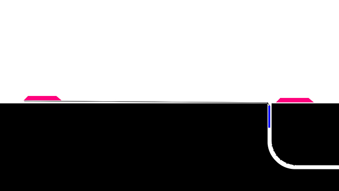

it isnt quite as efficient as the passenger vehicle traveling at depth, but…
in the following diagram, the vehicle (in vacuum) accelerates from gravity pulling down the water tank until the tank reaches the flat section at the bottom of the tunnel, at which point the vehicle applies a mechanical impulse to the tether sufficient to stop the tank, which transfers 100% of the mechanical impulse plus the kinetic energy of the tank to the vehicle. afterwards only the empty tank is lifted and the water is placed in direct contact with a geothermal heat source to produce electricity, and a portion of the kinetic energy of the vehicle is captured at the desitination via regen braking.
