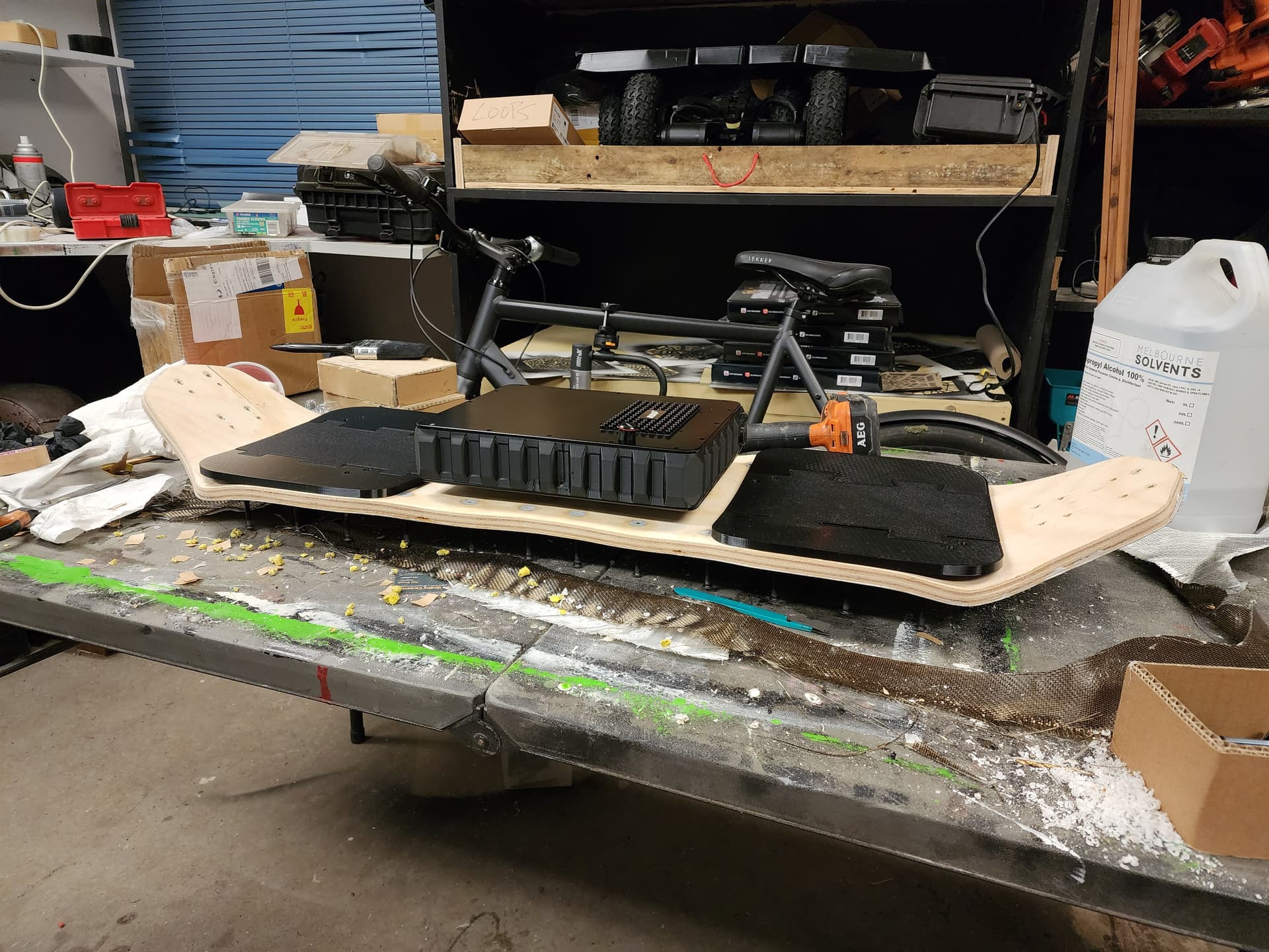

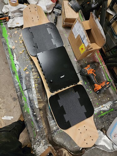

Second stomp pad printed, little mock up of the final layout… top skin going down tonight!
So sexy
I love the look of that top mount enclosure, makes me want to do a MTB for my next build :hot_face:

Once everything is finished i’ll upload all the fusion files, it should be fairly easy to resize the box to whatever size you like, then you’ll have to build one :rofl:
Finally, a top mount MTB enclosure that I don’t find silly looking.
I can see where my BOTY vote is going…
Fuck. Now my top mount enclosure looks like shit. Are you happy? :rofl:
I’m pretty happy with my box yeah :rofl: i’m not so happy with my composite skills…

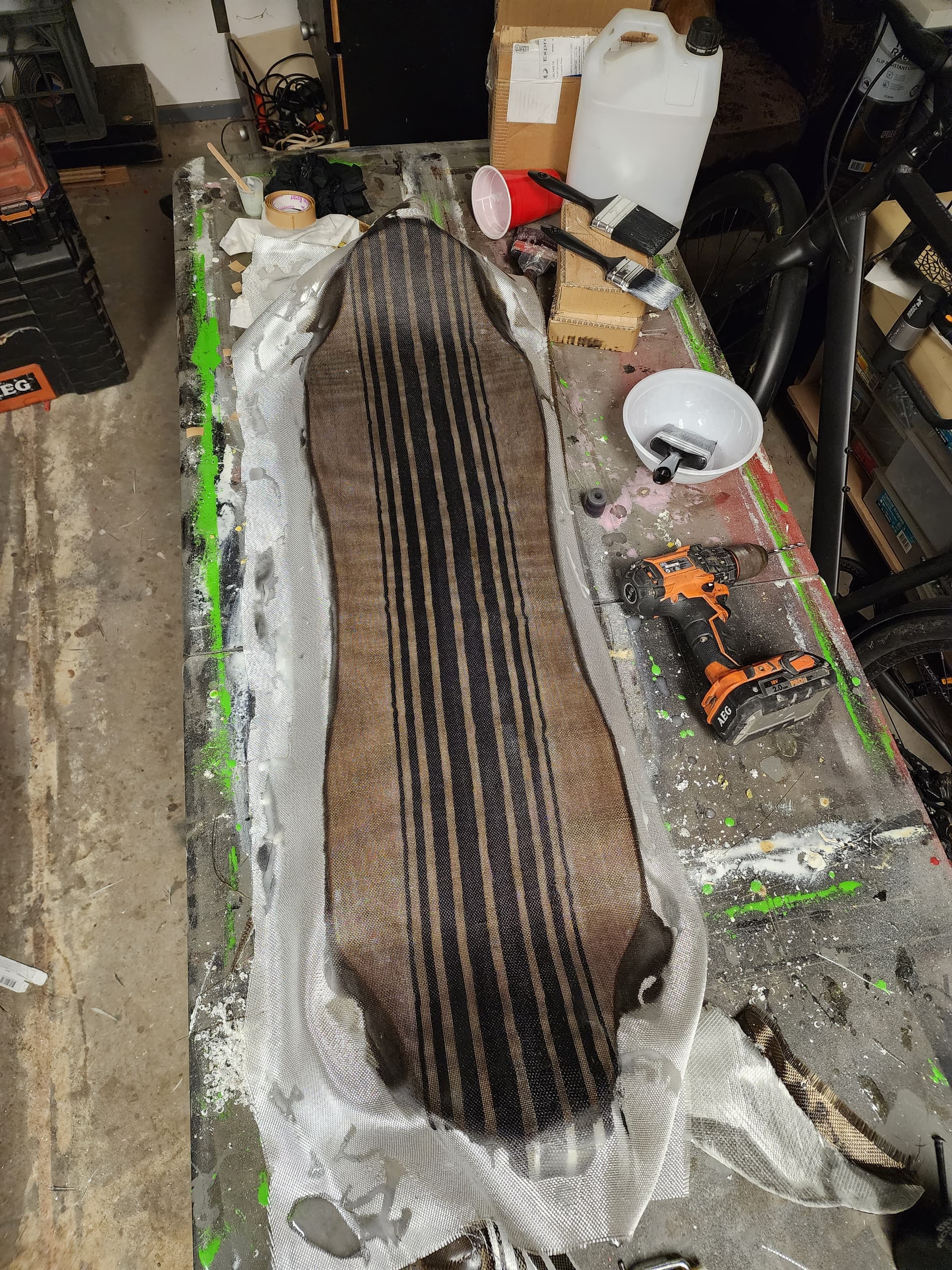

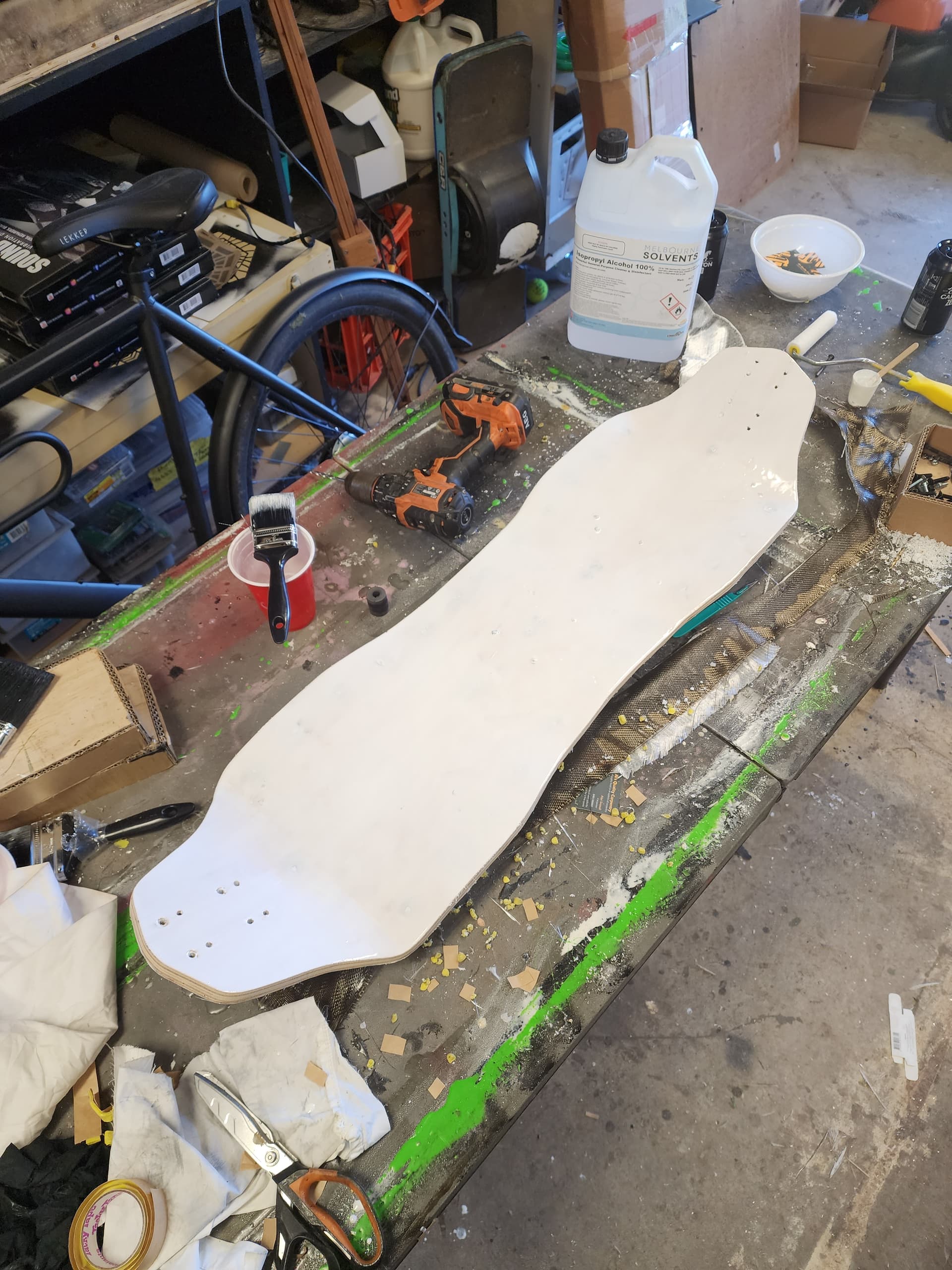

After I laid down the white, i checked my stock of the special rail tape i wanted to use as my ‘throwback’ feature… i was surprised to learn that I had enough to do the full length of the deck, I was just planning on doing the ends…
So I did the whole lot! And it’s totally not straight :rofl: but it all gets covered up anyway so it’s not a biggie, still kinda annoying tho.
The layup on the top ended up being different from the bottom, I did the basalt twill first, 300gsm, then the carbon/fibreglass railtape that is probably about 200gsm, and then a 200gsm glass cloth over the top.
Keen to trim it up tomorrow!
