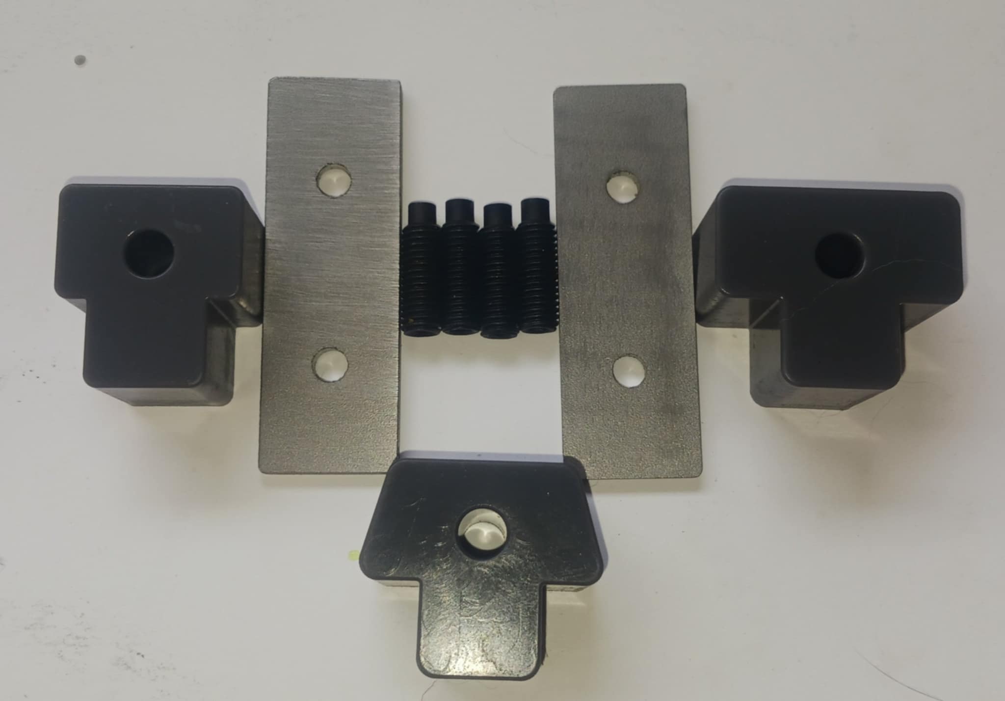

I like your Saunders vise clamps ![]()
They work really well!
