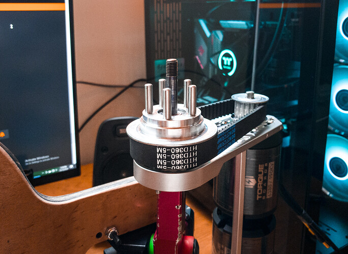

Just threw together some of the drivetrain, the 110’s along with the super wide @Boardnamics axles look fucking sicc. Next on the agenda, fire up the kweld :muscle:

For what it’s worth…riding the Sportster deck is a massive motivator. It’s a sublime ride feel.
