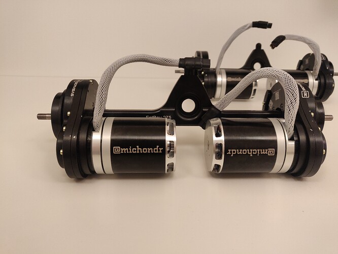

Not much has been going on lately, especially because Iâm finishing my semester and few more weeks will be hell in the exam period.
But, when Christmas time came, I got myself one free day. And the drives are finally assembled!
I need to order metr pro and two trampa HDs. This is not a small project for me, especially with the time constraints I have.
To cite Martin from the marble machine x - how to eat an elephant? Bite after bite
