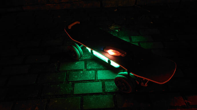

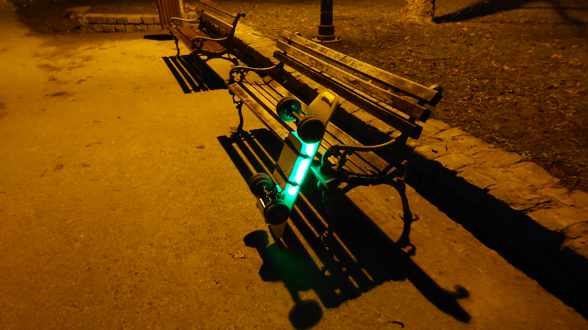

Some wheelie attempts. Gotta practice.

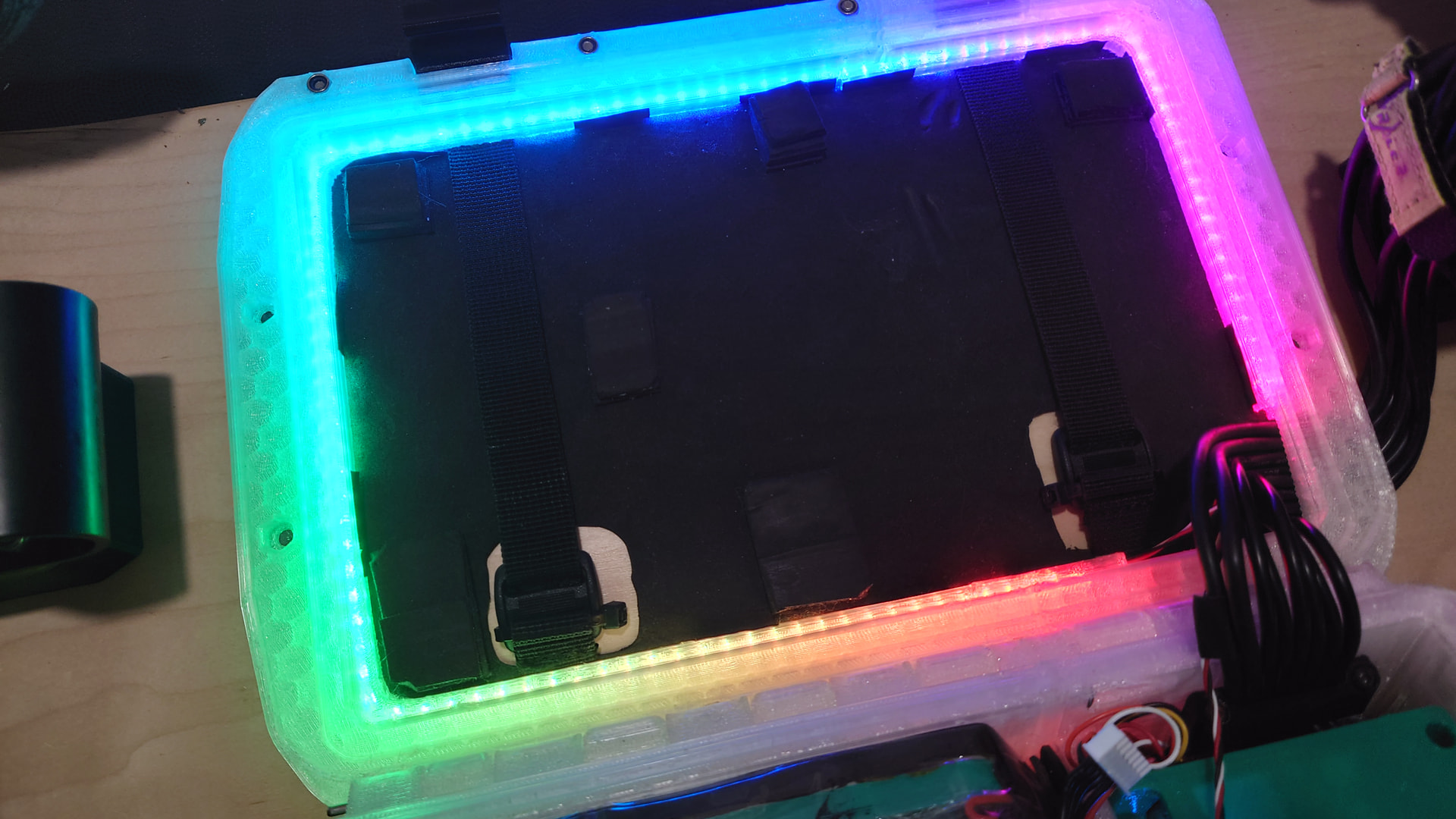

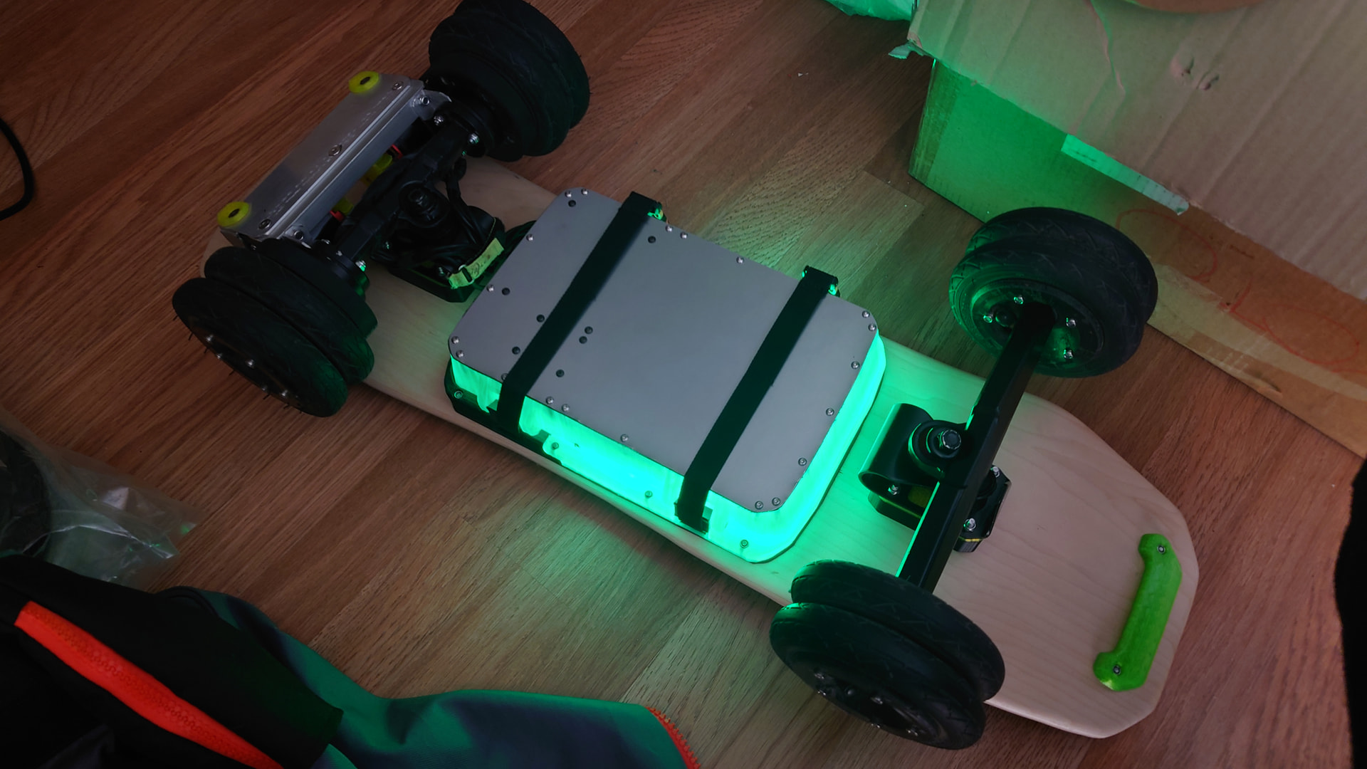

Reprinted the bottom part with TPU. Now the whole thing diffuses light so nicely. I should get an RGB strip, inspired by @Pecos

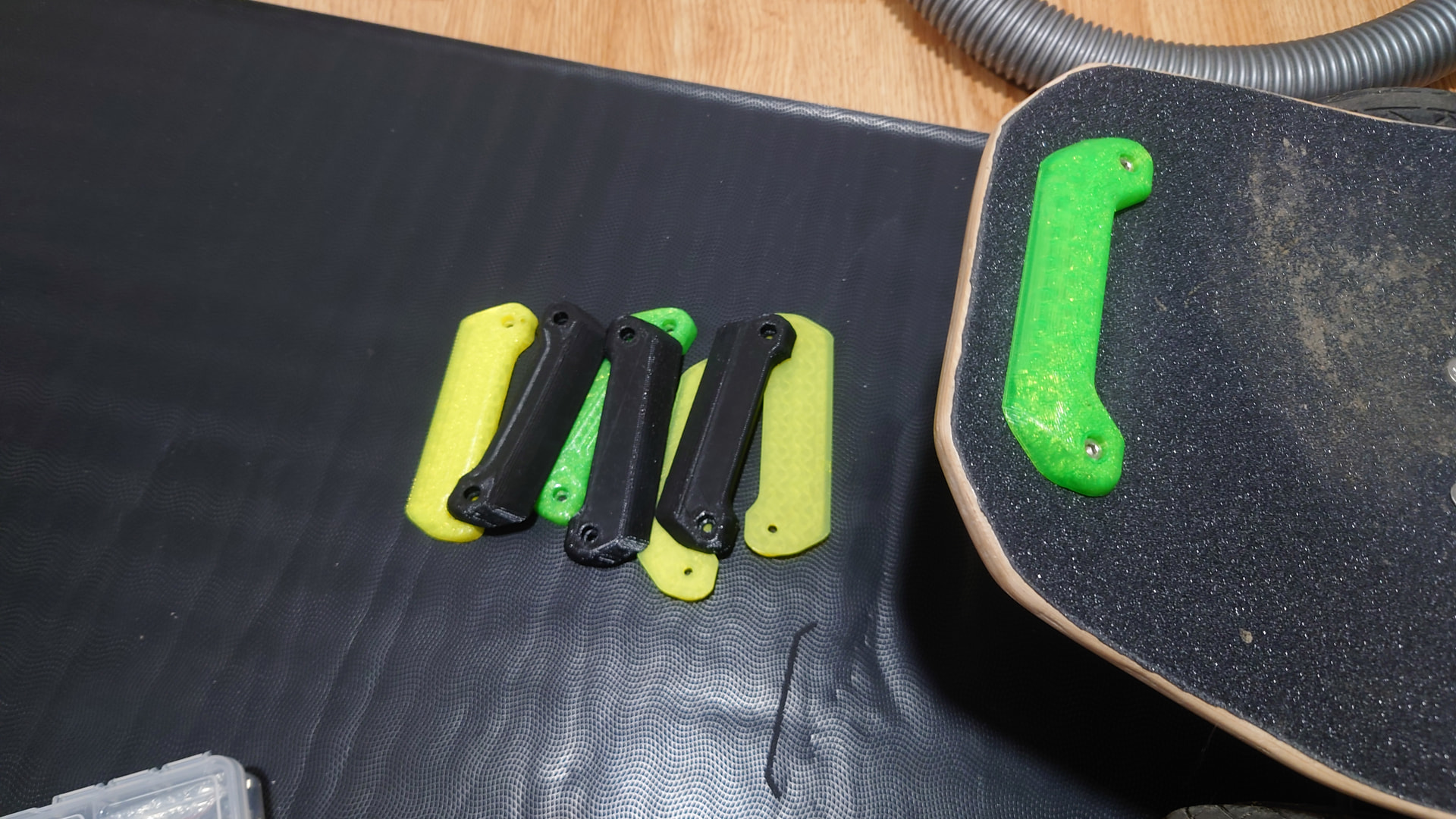

Grip ergonomics never works the first few times.
Also publishing the enclosure 3d designs - Electric skateboard enclosure. Battery box + ESC box. by vapgames - Thingiverse
That last one looked pretty far
And I love the light.

Looking good! Love the way that tpu picks up the led :heart_eyes:

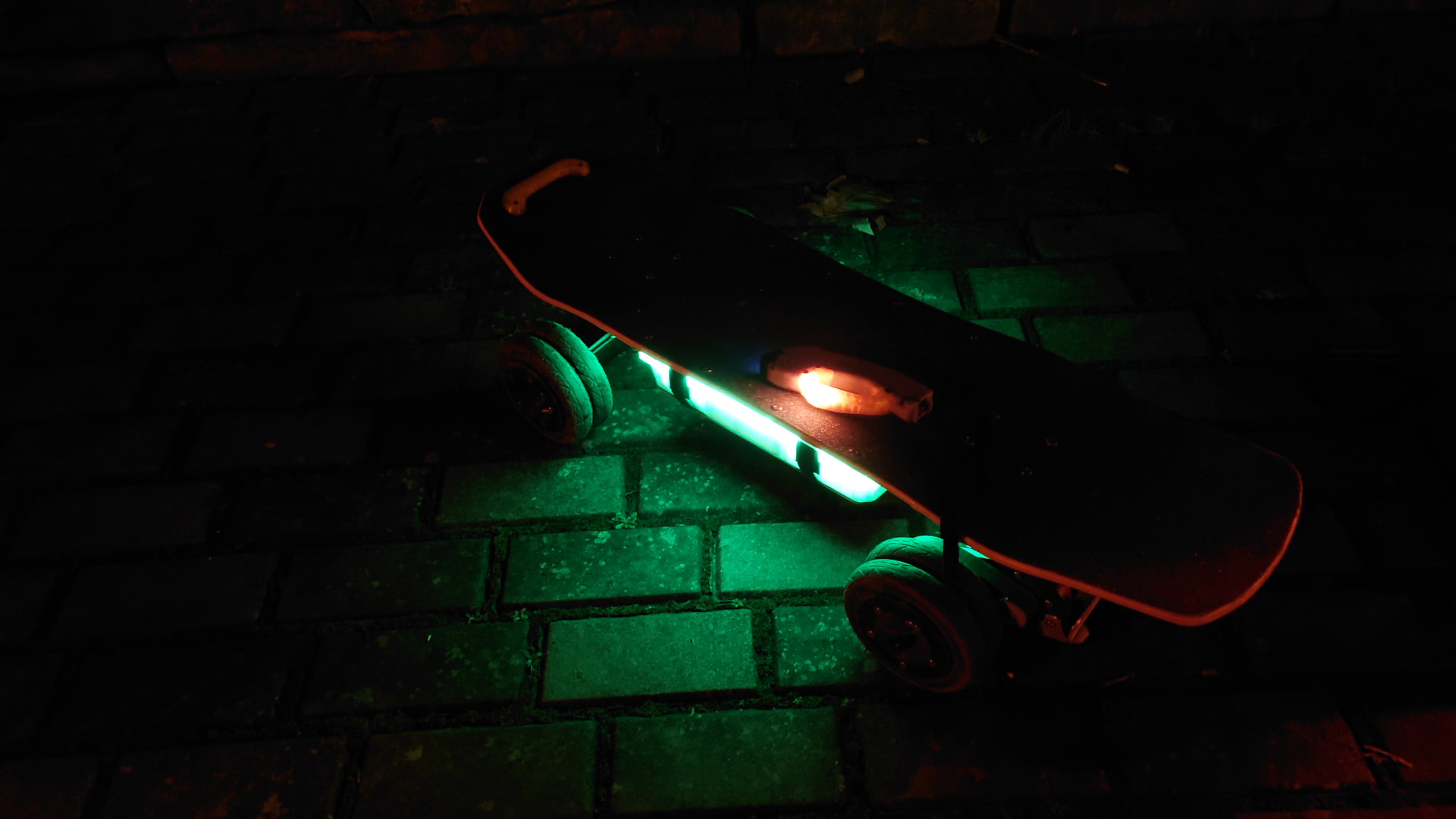

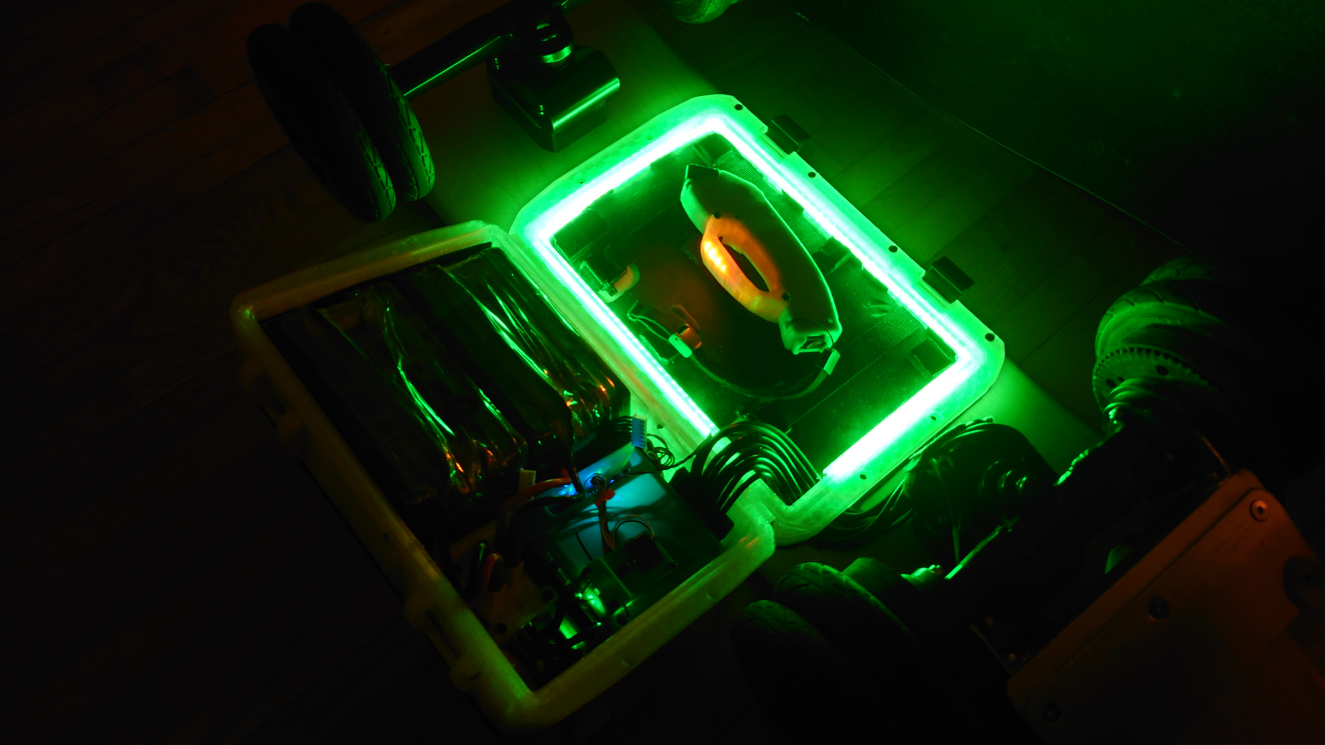

Added LED channel into the base.
For now running directly of 5v on FSESC 6.7. It’s supposed to have 5v 1.5a output, more than enough. Though in the future I’d want to isolate the strip from vesc with it’s own supply for electrical safety.
That looks really awesome. I think the 1.5A also includes the current draw of the controller itself, and is not the sum total of excess current available. But I could be wrong. I know on older models that was the case.

That’s very sneaky on flipsky part.
At full brightness the strip consumes 850ma, I’m running it at half power. I guess that was a good call.
With it’s own supply it will be blinding.

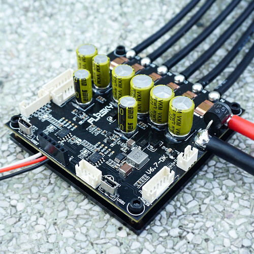

Do you have a high-res photo of the ESC showing the part numbers on it?
I don’t have my own photos.
Here’s photo from flipsky:
