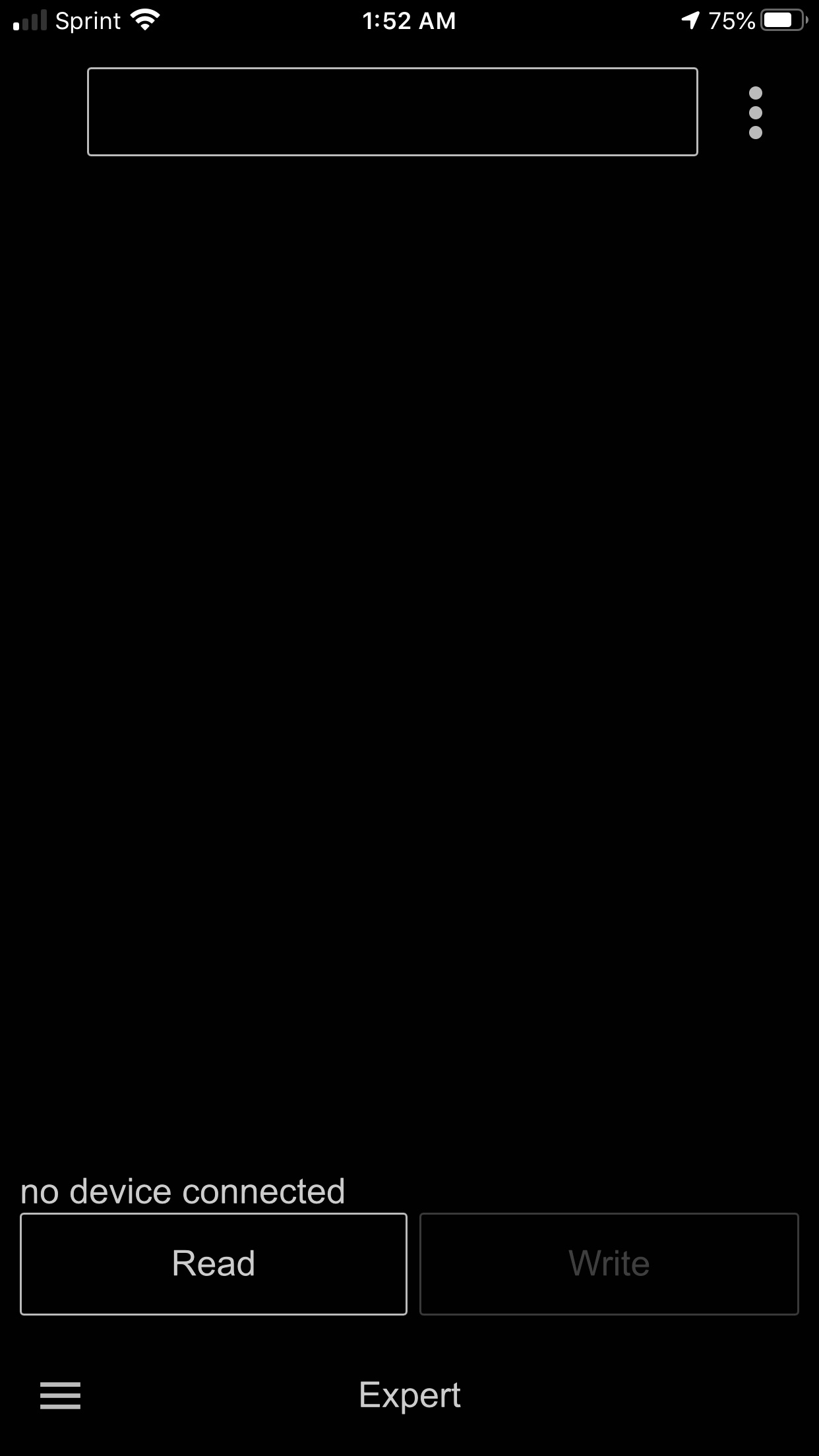

I’m having issues with my metr. Its connecting via Bluetooth but no data is being shown on my app. Stand alone metr pro connect to a unity

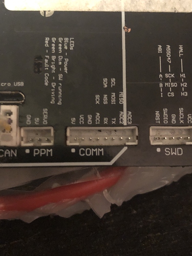

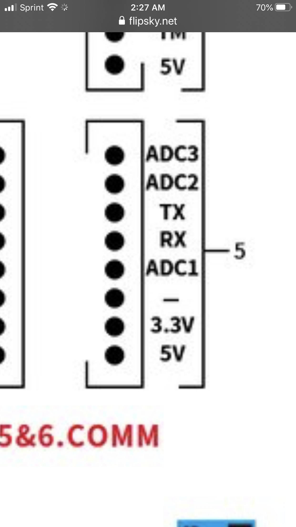

Strange. I’m having the same issue as dude above but I’ve been monkeying with my set up.
In order to troubleshoot a problem I’ve swapped esc’s a few times.
Escape>flipsky(worked but not at first)>escapes(didn’t work again)>TB6(doesn’t work)

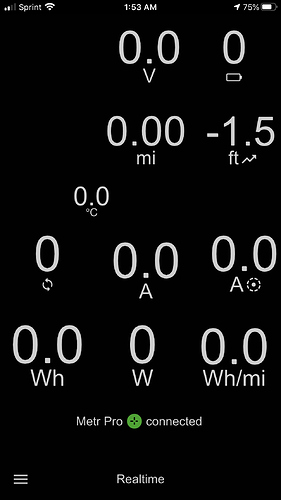

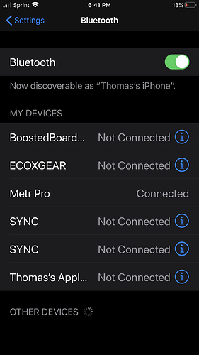

The pairing works and says connected, but no data and no tools.

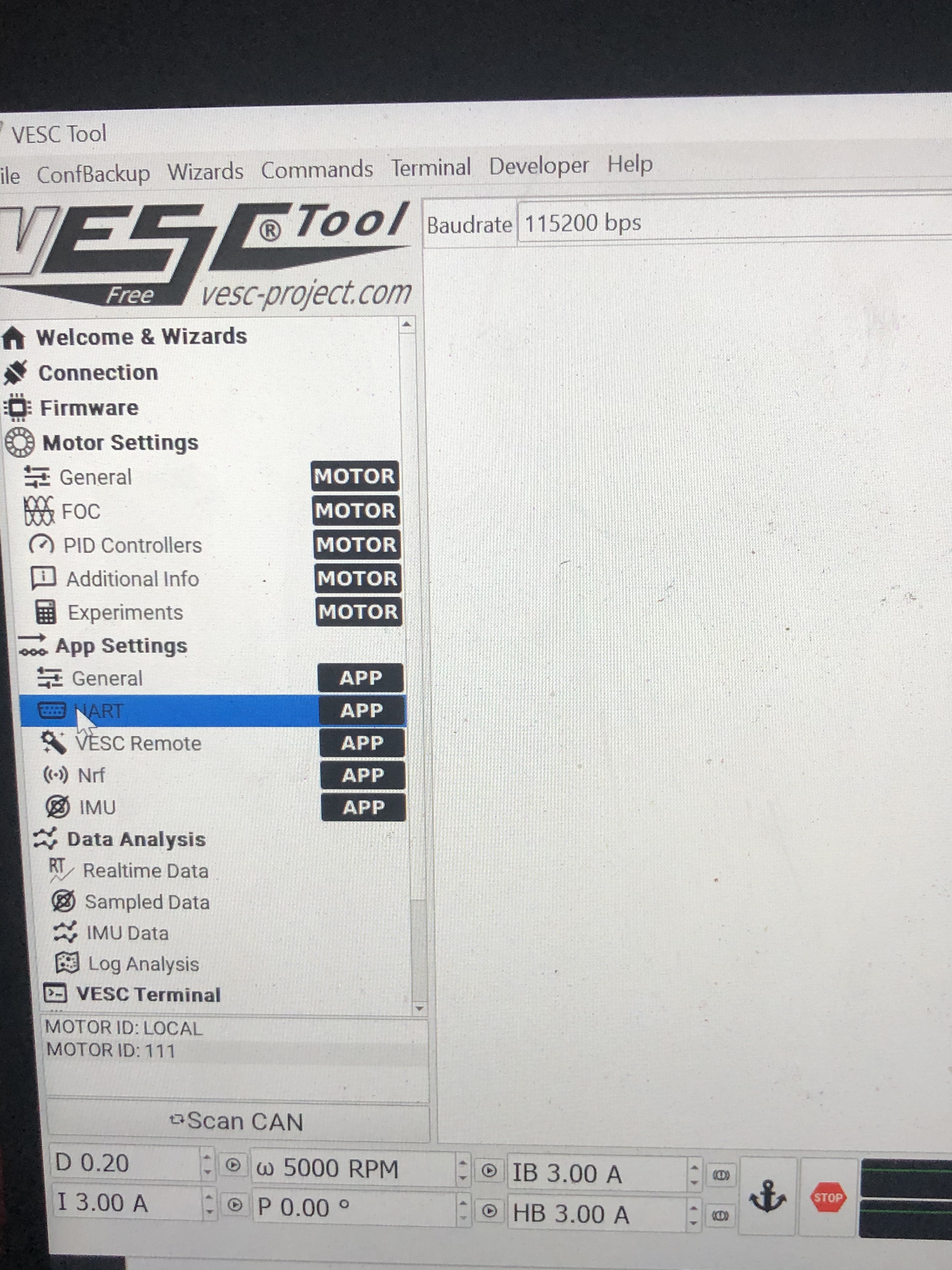

Uart enabled and correct baud rate.

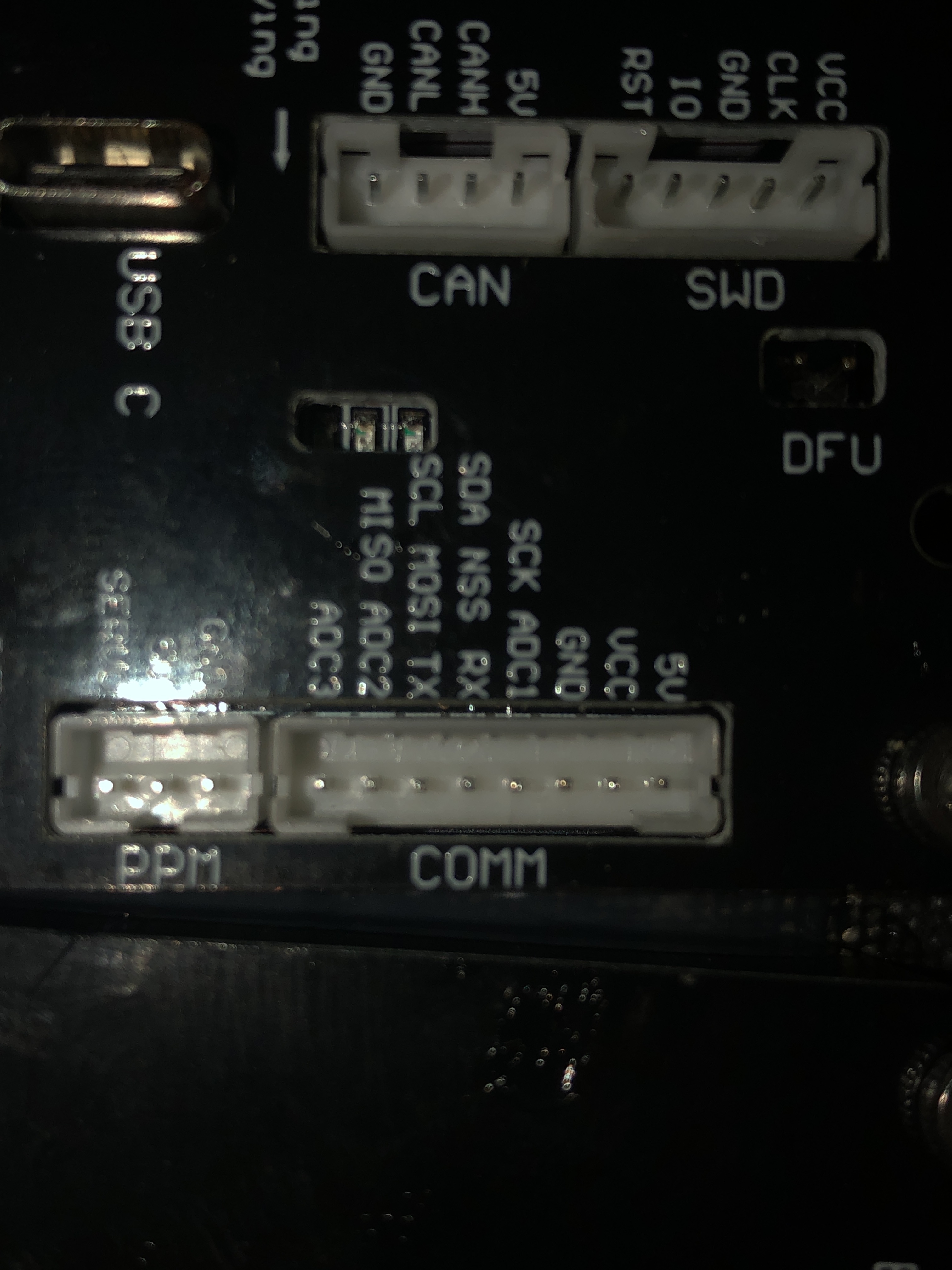

Escapes have reversed UART pins, you have to change the cable. Could be similar issue with TB6? @Skatardude10?
Yeah, I have been changing those mofos like a mad man. All still have continuity. It connects immediately. If I forget it it goes red, and then reconnects. Only escape is different and I’m set to factory default metr pins now. Lol
The escape is like this
Flipsky is this
And TB6 is this

I have confirmed that continuity from connector to pcb is good as well. Everything is connected as the wiring should be and the metr module connects to Bluetooth. The phone also sees it. No data is transferring.
Also notice if I force close the app, it requests the pin before paring again.
And more info. Green and blue lights blinking light crazy. Metr says connected, phone says connected, but no data. If you switch tx and rx it exhibits the same behavior.
Green blinking means UART is not enabled / wrong UART pins. Please check with USB that you have UART app enabled.
I’ll double check but I did confirm that both vesc were enabled at one point. They were not to start. Thanks for the tip and will try I’m the next hour. Beating the youngsters at a video game currently.

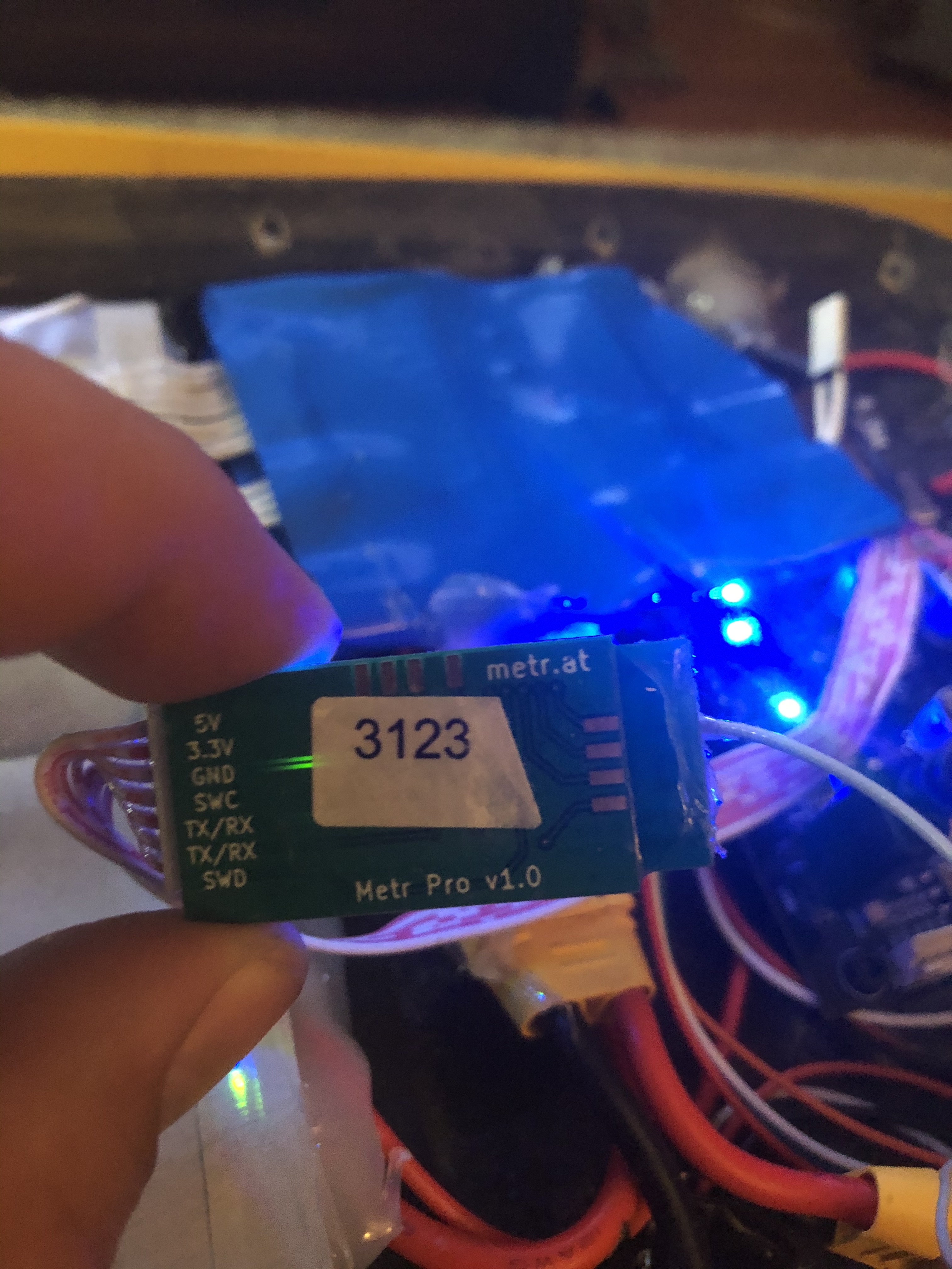

I found an old android device to try. I don’t think it’s actually pairing. I can’t remember the pin and what I took a picture of doesn’t seem to work. I have a pic of 3123 but the sticker was ripped. I can’t remember if it used to be more than 4 digits. The android never stops asking for the pin.
Ok there are 2 separate issues.
  1. PIN for all Metr Pro modules is 6 digits. Without PIN you won’t be able to use Metr Pro. We might recover that, but first let’s sort out issue #2.
  2. UART. You mentioned that you got it working with flipsky at some point. Did you see realtime data? Can you connect to flipsky again and check if green is blinking rapidly? (btw UART settings look fine on your photo)
