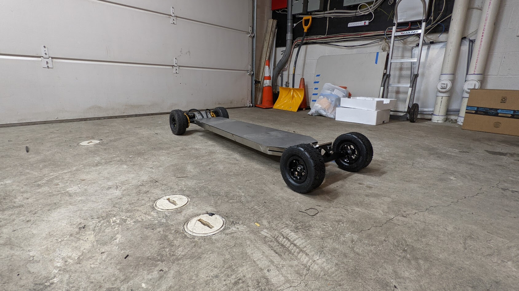

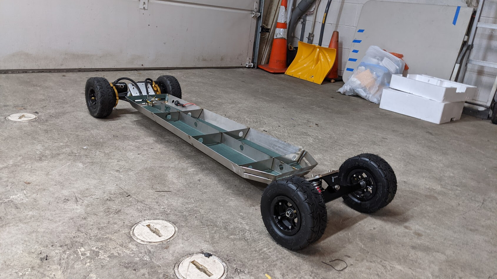

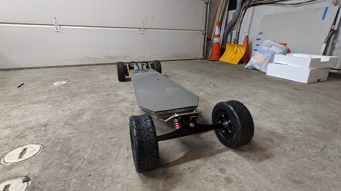

Finally mounted the brackets and got a rolling chassis going. Next problem to solve is the god damn lid situation. Fuck. I really need help. Easiest plan so far is a rubber/foam layer on the underside of the lid and magnets sucking it down to the body. Please help me think guys.
Also,
I refuse to drill any more holes in this body/lid. I may order a new lid with build in tabs to align.

Looking good !
How are those bracket holding on ? have you tried jumping lightly on the board ?
Don’t really have an idea for the lid… I’m not a fan of the idea of magnet, doesn’t sound like a solid enough link between the lid and the board
Man this is sick. I get excited at every update you post haha.
#BOTY2021
Yes, it’s rock solid. Very happy.

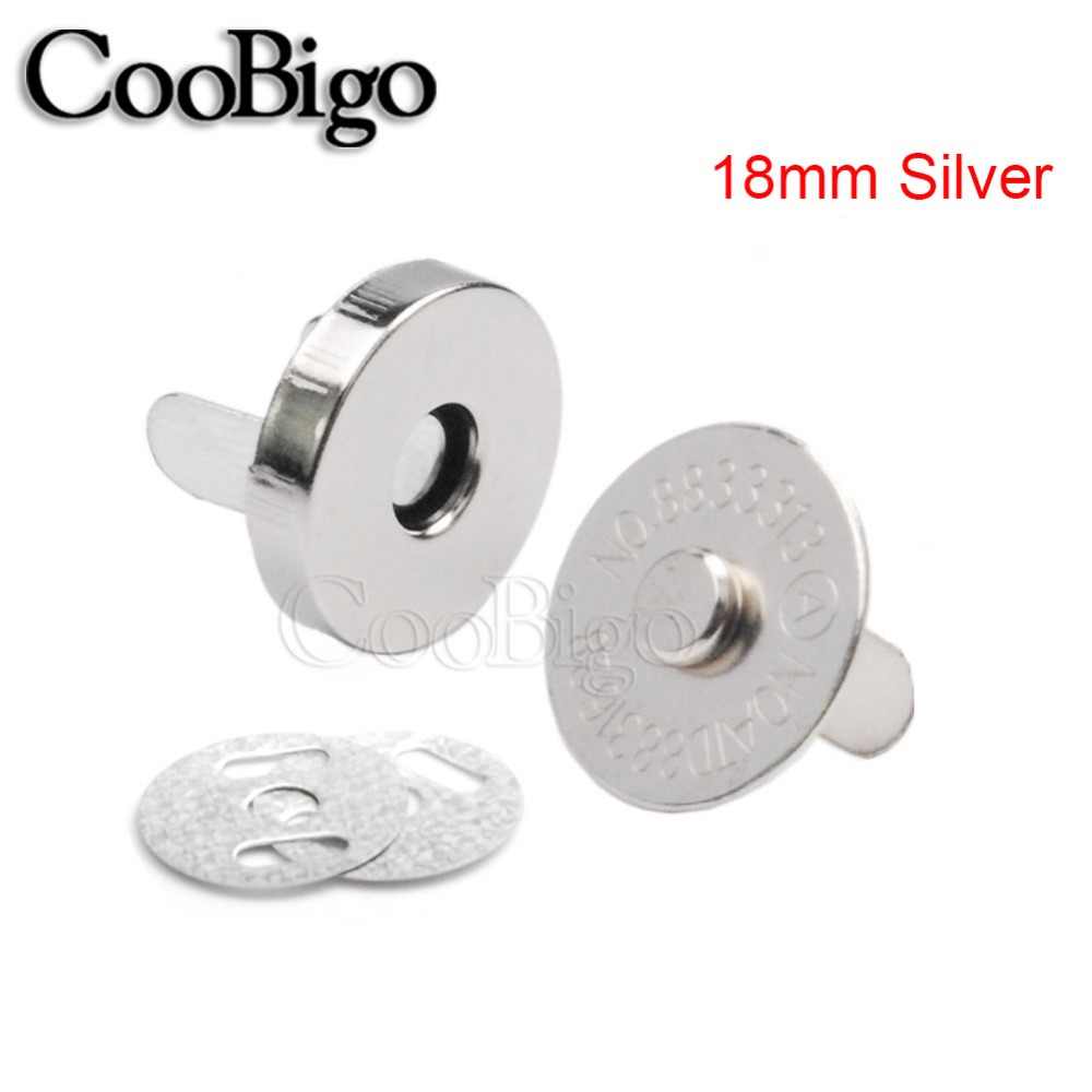

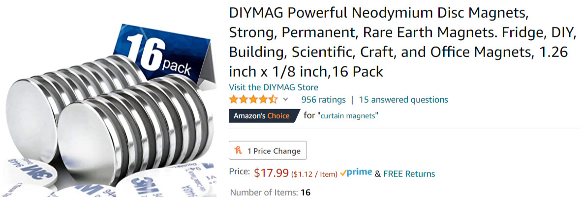

I have some rare earth magnets. This wasnt my first choice but I dont know how else to do this precisely. Theres no way to get the alignment perfect. The deck was welded by hand so I can’t rely on the CAD model to be a 100% accurate depiction of the irl deck. I haven’t committed to magnets yet, but its the leading method in my head.

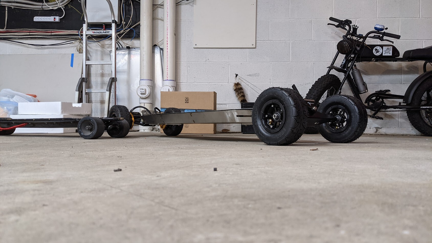

That would look cool too, I agree. My reasoning was;
#1 To look like the Cybertruck.
#2 This allowed me to place the batteries in the front for stability.
#3 It’s kinda like a teardrop shape, which is the “optimal aerodynamic shape for any given volume”

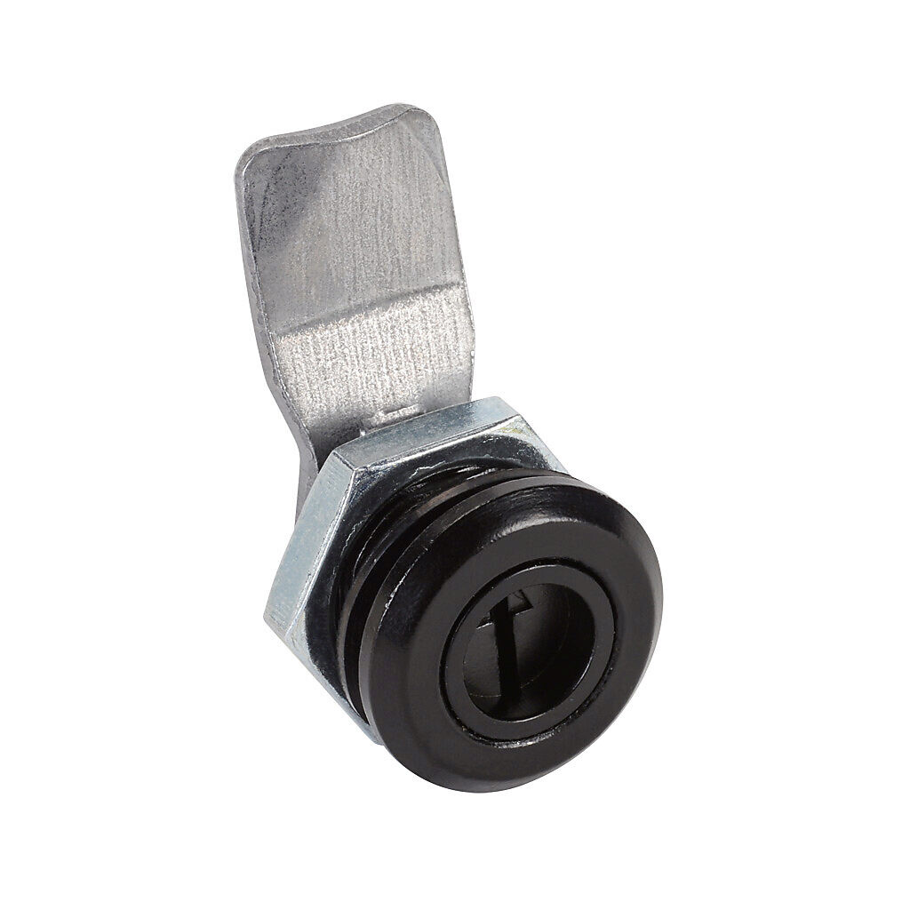

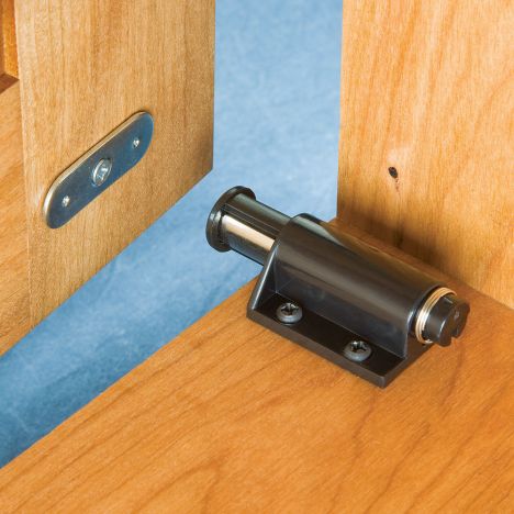

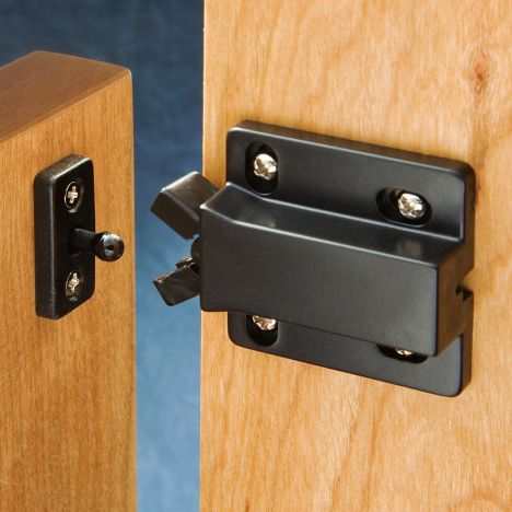

On lid attachment - look into cabinetry latches?
image image image
Also if you do go with magnets, use magnetic snaps to align and stronger magnets to hold
Board is dope :ok_hand:
Depends on how much room you can sacrifice inside.

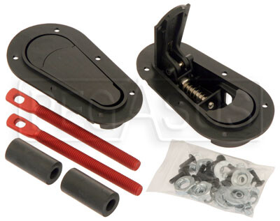

Consider auto latching mechanisms like flush hood latches:
Simple enclosure latches:
Twist lock fasteners:

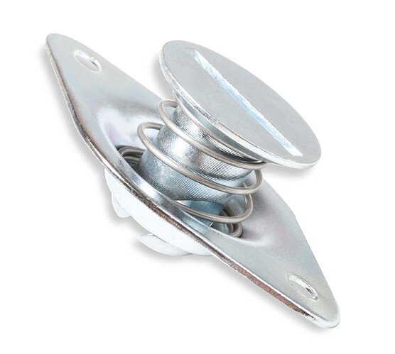

Holley Quarter turn fasteners:
Mount some detent pins (double duty with alignment):
Probably easiest would be to use flush-mount captive fasteners / panel screws.
Cabinetry latches would probably pop loose every time you hop on your board / shift weight too much.

Easiest, no-thought approach would be to 3D print some wedges that match the angle of your enclosure side walls. Make em beefy and epoxy them in. And then use normal enclosure mounting techniques - sink some threaded inserts into the 3D printed part and screw through the lid.
No matter how you go about it, you need a mating face / mounting pt inside the enclosure.
Well… unless you used a hinge. You could piano hinge really any seam of that lid. Then you’d only need a way to “keep the door closed”. Could be elastic bands between two posts, a really simple latch, any of the fasteners above. A hinge would be fun.
I guess it’s not going to be watertight with those front/rear slits? If you were going to waterproof it with a large overlapping lip and gasket, that would be the place for your fastening method.

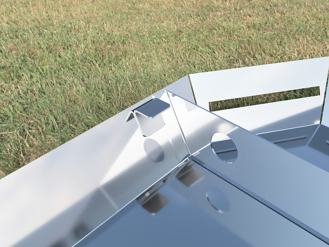

Ive been thinking about this a lot. I think im going to do this
But with bent pieces of stainless spot welded on the inside. They will support a plastic lip that runs around the entire deck to create a seal. The lid will be sucked down to the deck with a ring of rare earth magents.
I wanted the hinge to work but you guys already explained why it wouldnt.

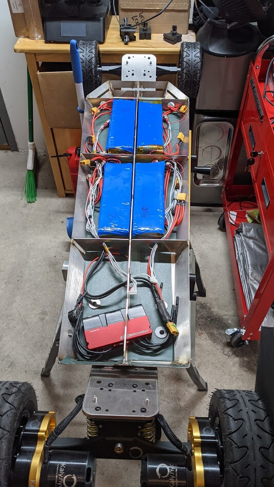

Edit: also heres how much room i have inside:
Oh yeah, if you’ve got a lip, magnets will work nicely. Just run some tests first on magnet strength and make sure you have some way to open it.

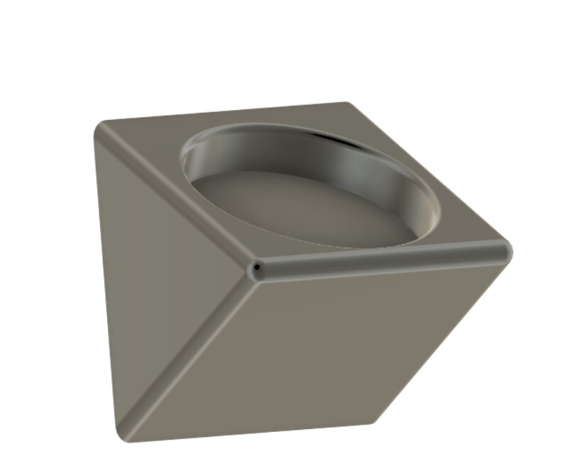

Here what the bracket will look like. Some will be holding on to the lip. Others will be holding onto a rare earth magnet. Should be solid.
EDIT:
The above is a bad idea. Bending would be a pain in the ass. I am going to go the 3D printed route. I made this to hold a magnet. The lid will have carbon steel tabs glued on since stainless isnt magnetic.
