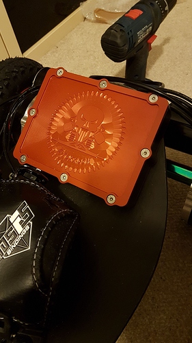

I installed my E-Toxx enclosure and my vescs aren’t screwed in yet.

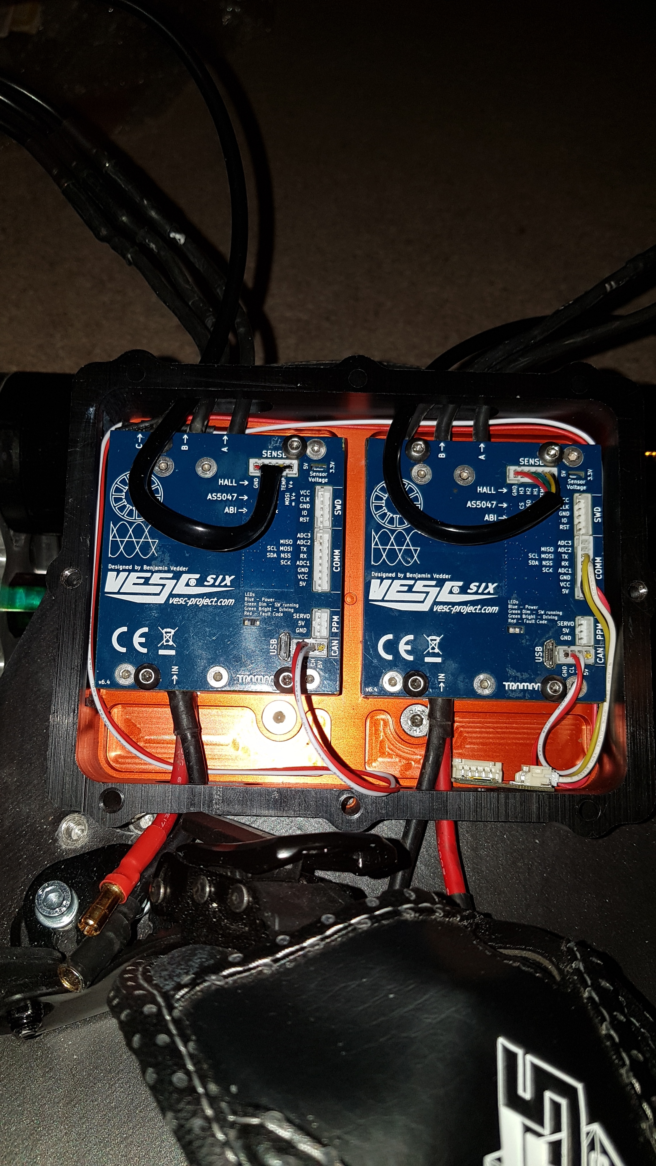

Vescs are installed.

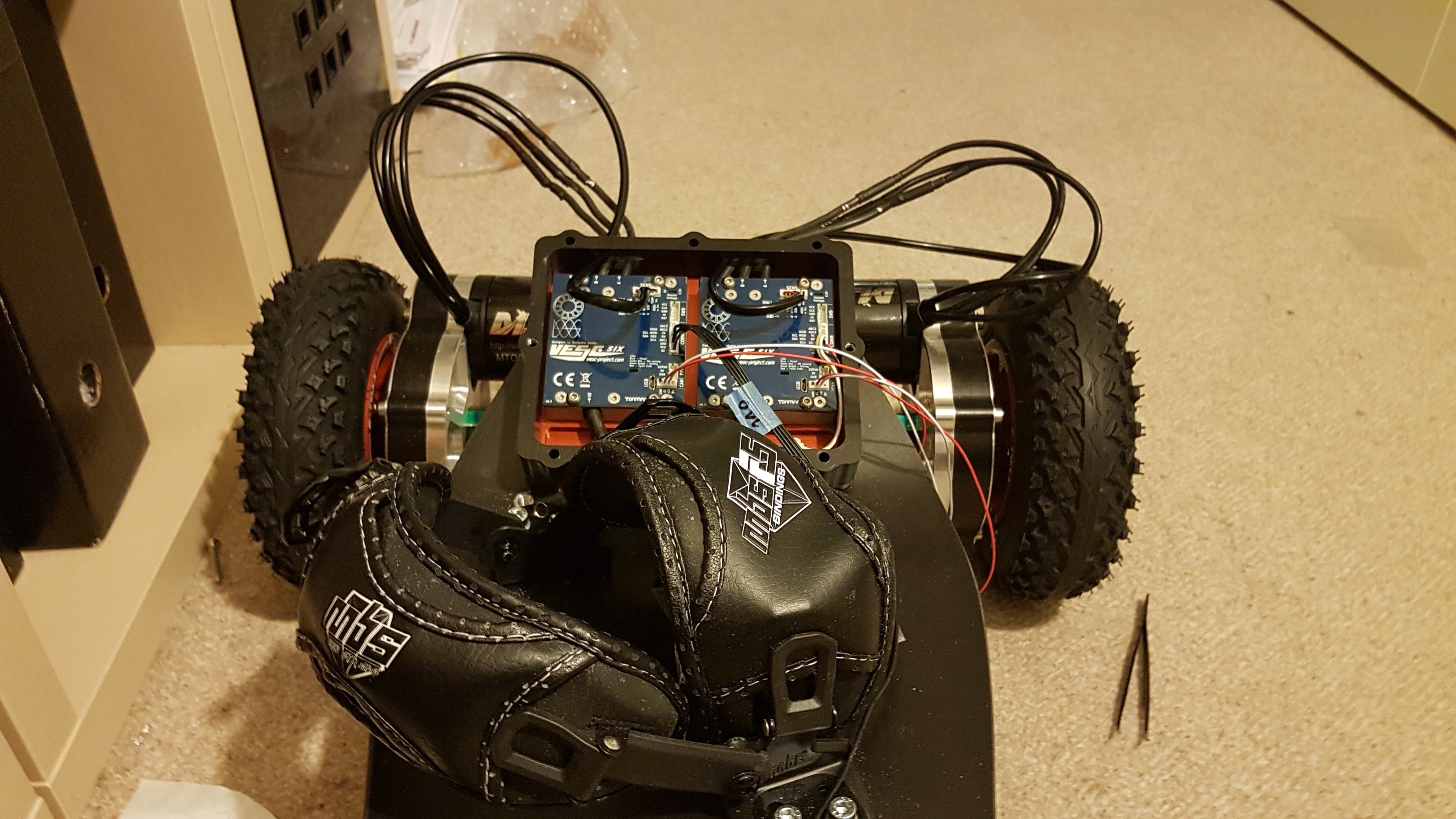

You are gonna shorten those phase wires right?
wdym?

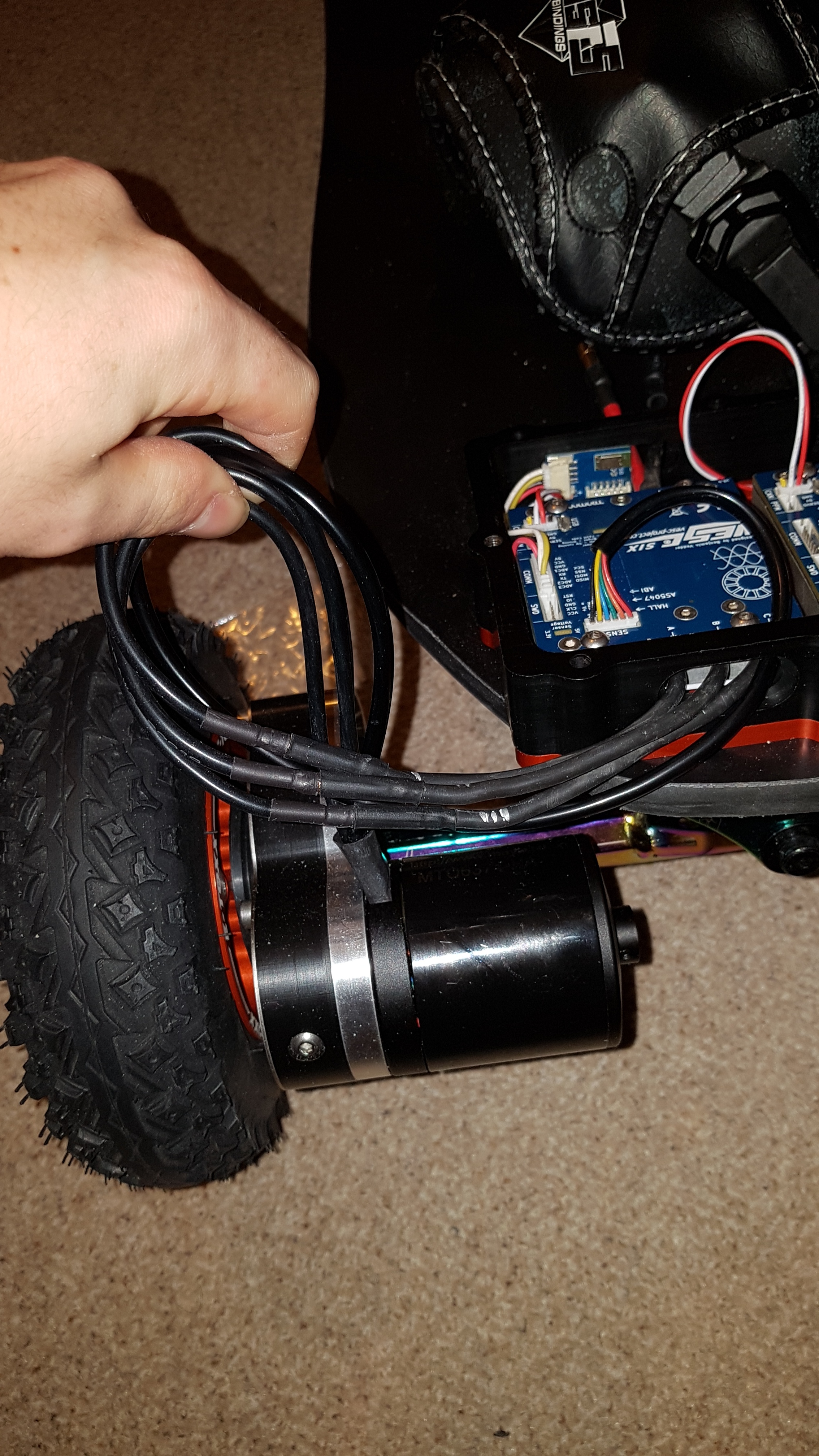

Your phase wires and sensor wires are incredibly long, do you have a plan for tidying them?
pet cable sleeves and zip ties and I’ll loop it or zip tie it to the truck
Even your CAN cable is super long? Do you like long cables? :grin:
sort of…
But also a bit lazyness is involved… :shushing_face:
It’s not bad though. I’ll manage this
Im sure you will do a good job on it, just an observation :+1:
Like this
to add some stiffness, I add some print filament
Having the phase wires that long and running them like that is a bad idea bro.
What I would do if I was you is make the phase wires shorter and bring the sensor wires into the enclosure a bit and lose them in there. You dont want long coils of cable flapping around like that if you are off roading

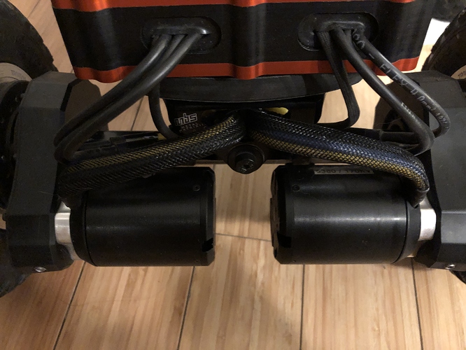

Here’s what I done to my extra wires.
