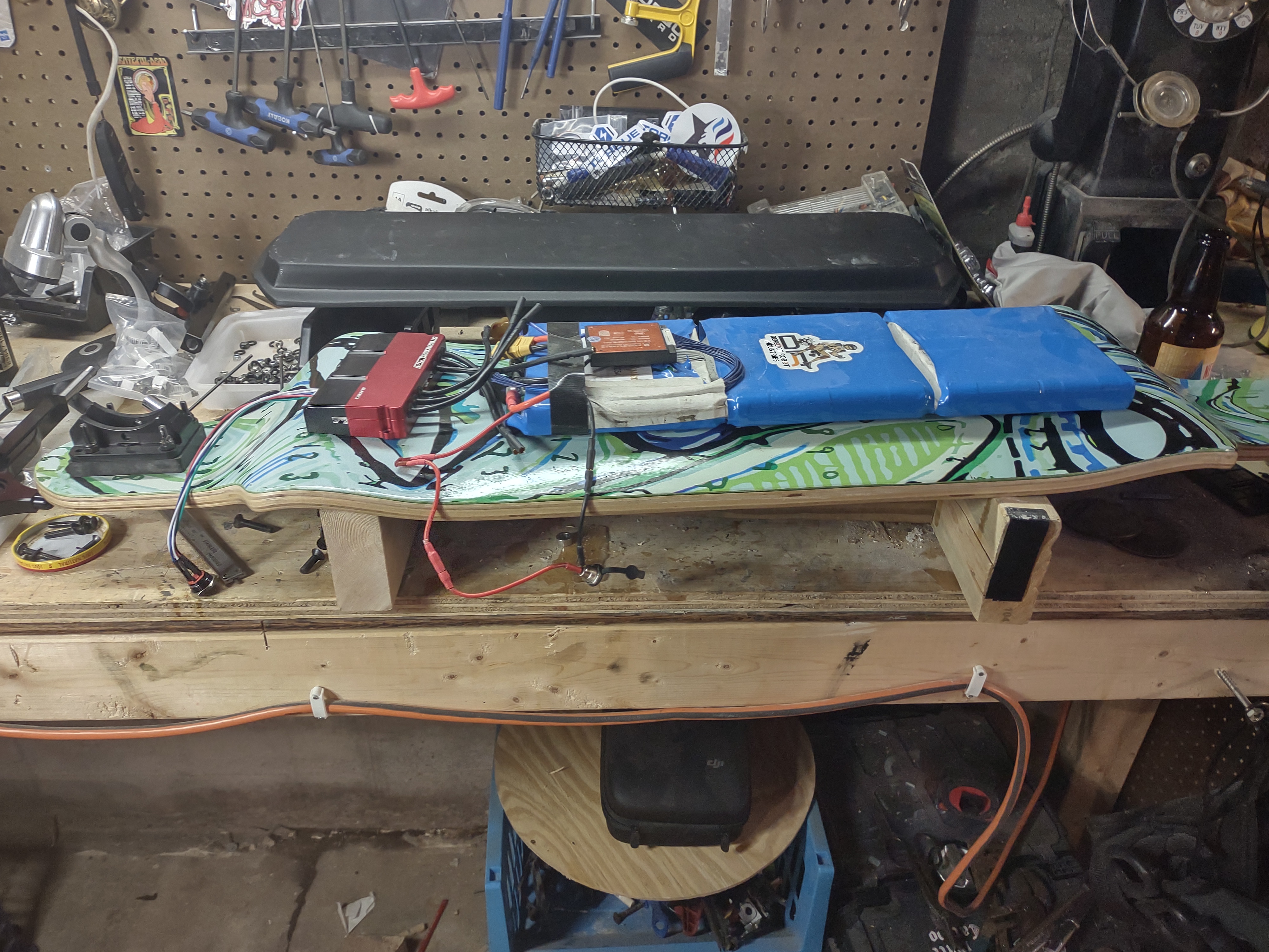

The beginning of my Mando build.
Haha yeah dude let me start over please
Your setup is perfect by the way, can’t wait to watch the progress

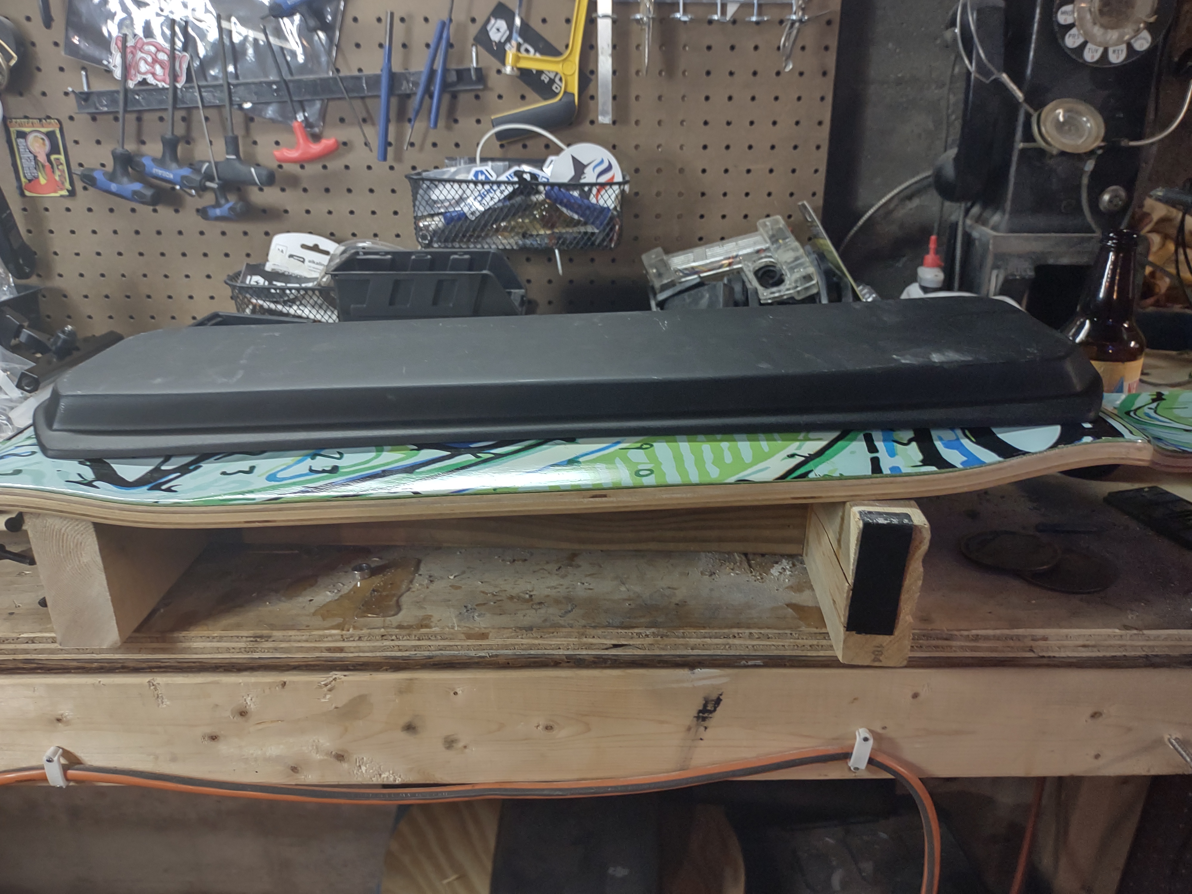

I will be curious to see how your battery enclosure works out, I have a deck just like that on the back burner because I can’t find a good one for the huge concave it has. That will be a super nice build when your done!
As far as the axles have you talked to Keven @Boardnamics to help?
I hit him up, but he hasn’t responded yet. I’m confused. But I’m sure I ordered something wrong
This is my other option. This enclosed sort of fits. It’s gonna get some fiberglass epoxy first.

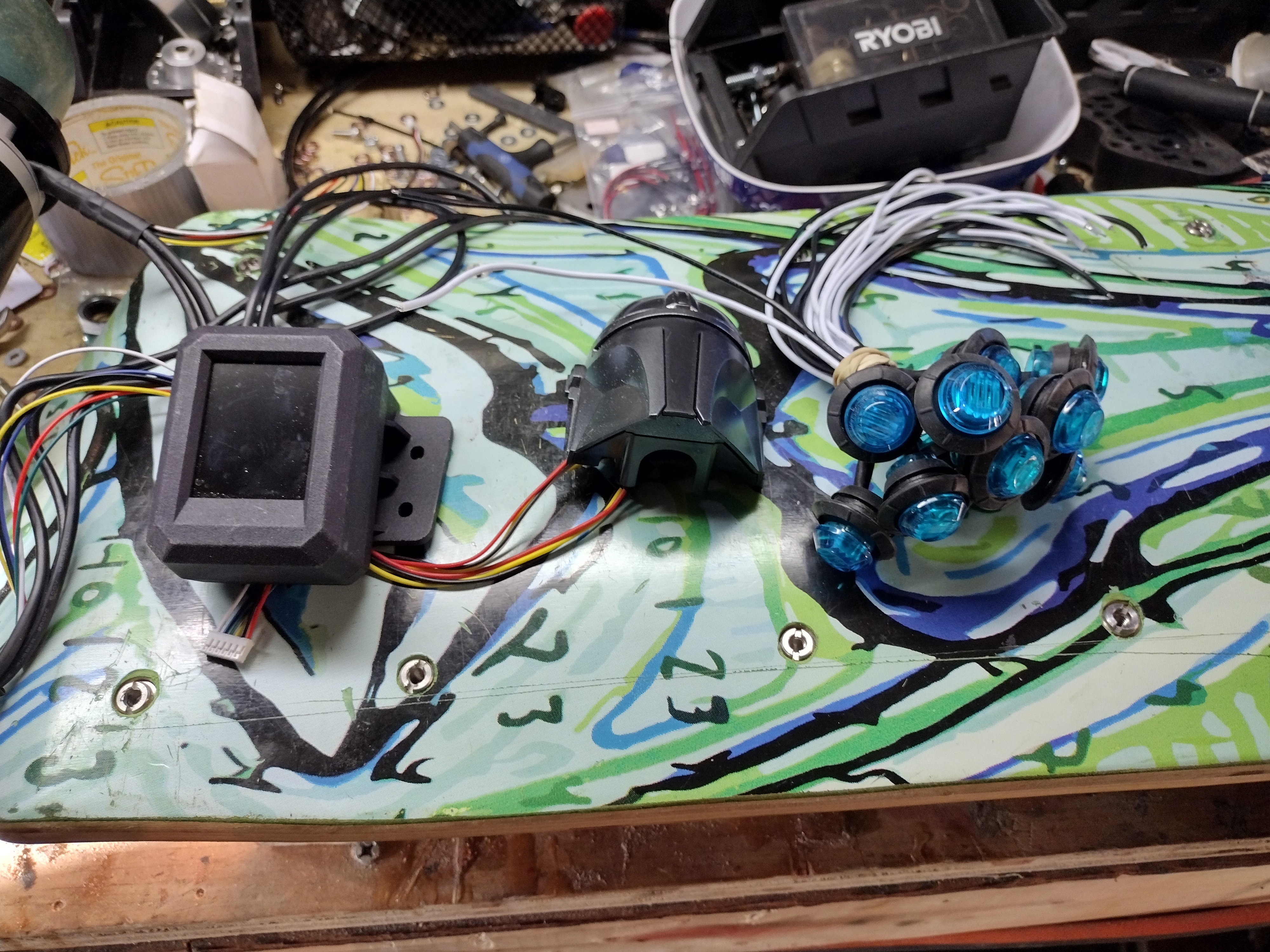

Gonna put this mando helmet on the display and these blue 12v blue lights around the bottom of the deck.
