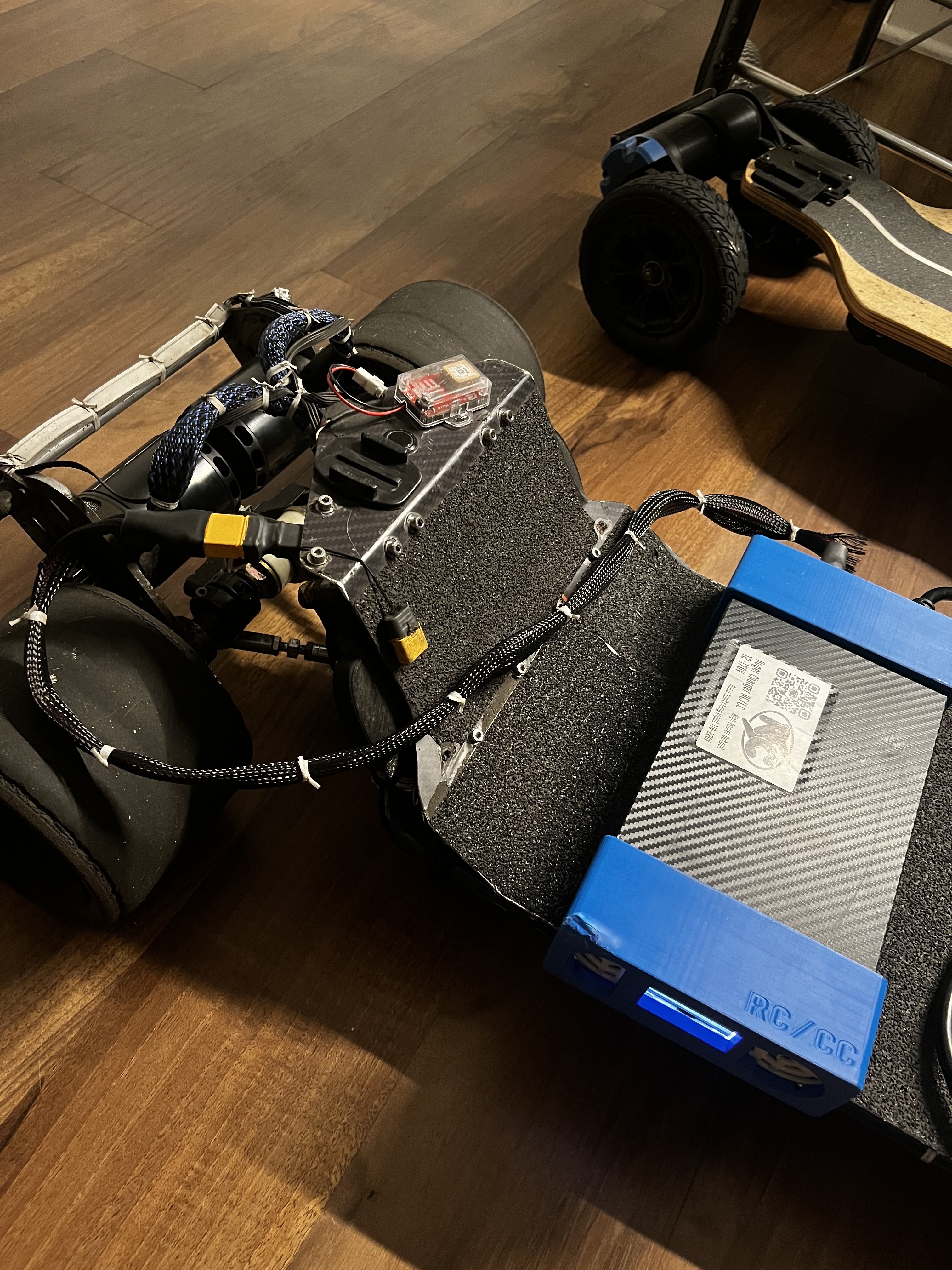

Around the same time I switched this board to 15s, I bought a master v4(EUC). I bought a Roger Charger RC/CC to be able to do multi-leg long distance rides with the wheel (a roger charger is just a compact, high power CV/CC power supply).
Of all of Roger’s models, I got the RC/CC primarily because it can output lower voltages, so it could do double duty as a esk8 charger.
Having the roger charger is partially why I upgraded to 15s (I didn’t need to buy another charger)
The Roger Charger RC/CC is now the primary/only way that I charge this board. Being able to adjust the current to match the amount of time I have to charge is very nice (limit battery stress).
I was wrong
I think it’s notable that I didn’t always feel this way, and I now believe my opinion from earlier this year was/is wrong .
I’ve done a complete 180 since then. I’ve seen the light.
I wish I did this so much sooner;
  • Cost - I have a huge pile of brick chargers that are now collecting dust on a shelf. The RC/CC is less then the cost of that pile, If I ā€˜invested’ in the roger charger sooner, I would’ve saved a bunch of money on those chargers that I’ve bought for different currents and voltages over the years. If you’re like me and have a fleet of boards and your raceboard seems to constantly be changing voltage of your raceboard, it definitely makes sense.
    if you want some cheap chargers keep an eye out for a sale thread at some point
  • Speed - Being able to pump as much current as I want into my board on raceday is an obvious bonus. The limiting factor is my ZBMS, but also not really. Charging at 12A, my legs take longer to recharge then the board does.
  • Speed (again) - (assuming I’m not spending $100+ on fast chargers for each of my boards, because I don’t) When charging multiple boards, using the Roger Charger is so fast that it often takes as long (or less) as charging them in parallel with their dedicated charger would take.
  • Logistics - Having one, compact charger is significantly easier then a bunch of discrete chargers. Really helps for eks8 events, where I’m often bringing 3-4 boards. Less bulk in the toolbox.
Now to actually answer to your question lol;
Absolutely FANTASTIC. Highly recommend a similar route if you’re looking for a solution.
TEF1
TEF1 was about 3~4 miles of high speed racing at a time, so my board was definitely close voltage sag after every race(~40%) and needed to be topped up.
Moe graciously let us use his generator at the race. I left my RC/CC plugged in all day, set to 15s and 12A (~700W). I would come off the track, park my board, and plug in the XT60 like it was a ground tether. I also had a USB C that I would simultaneously plug in my Insta360. Took 10 seconds.
Every time I went to use the board, I had a full charge. It just worked ^TM
iCharger x12
My old icharger x12 setup, took several minutes of setup to start charging. Better then opening the bellypan every time, but still an unwelcome interruption to raceday, frequently pulling me away from conversations with fellow racers. Not to mention an annoying hassle to deal with.
It did cause me a bit of a panic when it suddenly stopped charging in the middle of the day. Thinking the worse, I disassembled the whole board’s charging setup and checked my cell voltages(Thanks @HAIRYMANJACK and @derekstavis for the multimeters). Shockingly, charging in direct sun 20% faster then zbms spec will overheat it. Lesson learned.

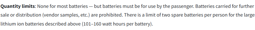

It’d be great to be able to ship packs but from memory was a major issue looking into esk8con last year. I thought about hand carrying 99wh/hr packs but even then it seems you’re only allowed 2 of those now.
I think the 2-pack limit is for batteries 101Wh-160Wh
https://www.faa.gov/hazmat/packsafe/lithium-batteries
Depends on the airline :confused:
Really?! Considering pretty much everything we use nowadays has a battery in it it seems implausible. eg. I tend to travel with multiple insta360 and GoPro batteries, are they really gnna stop me for that?
