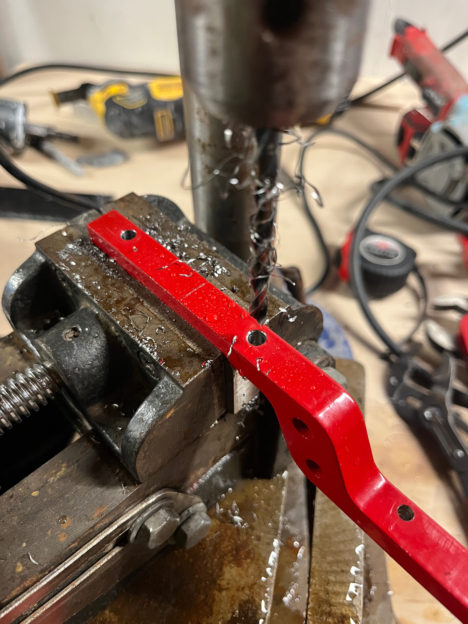

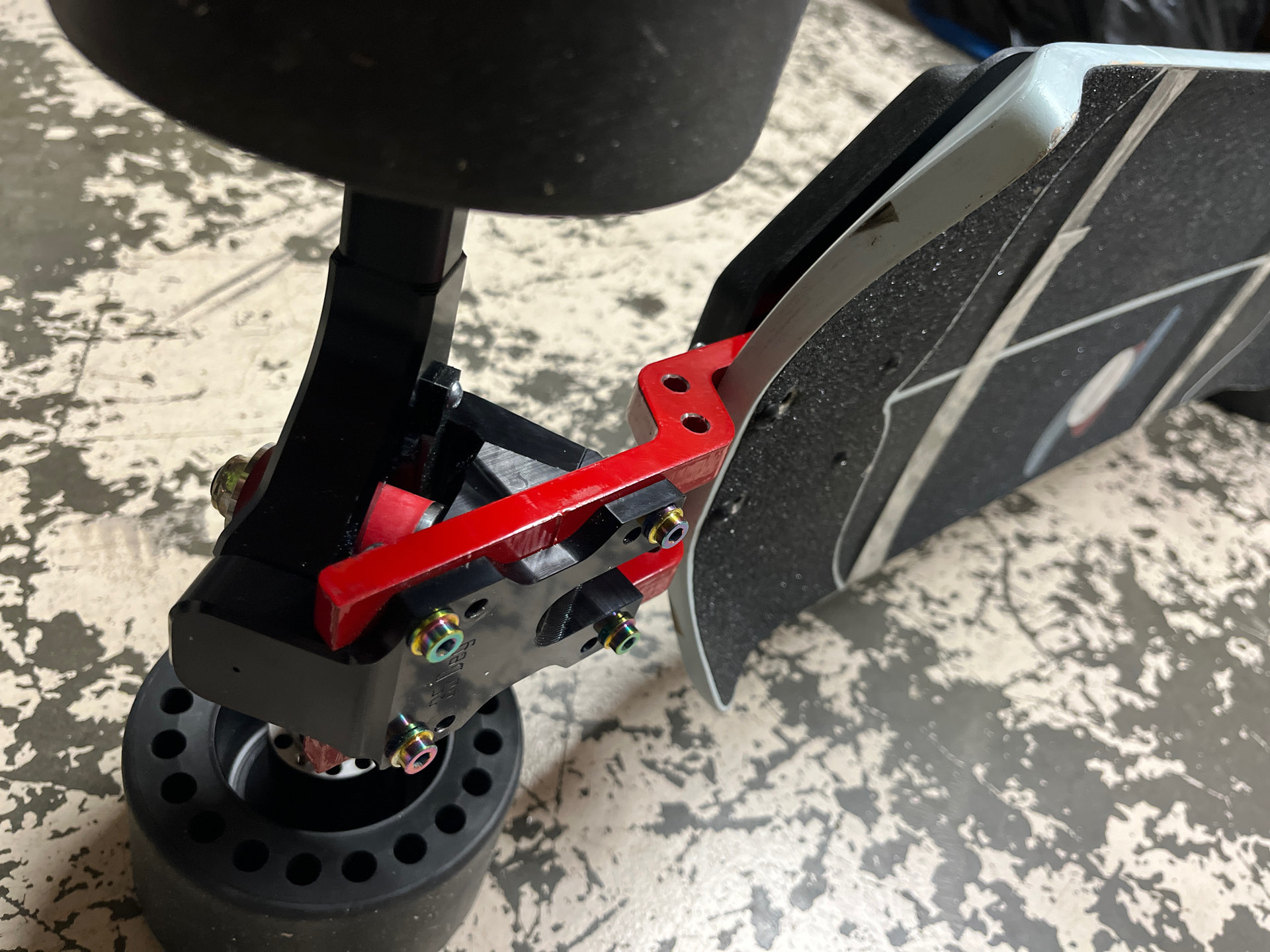

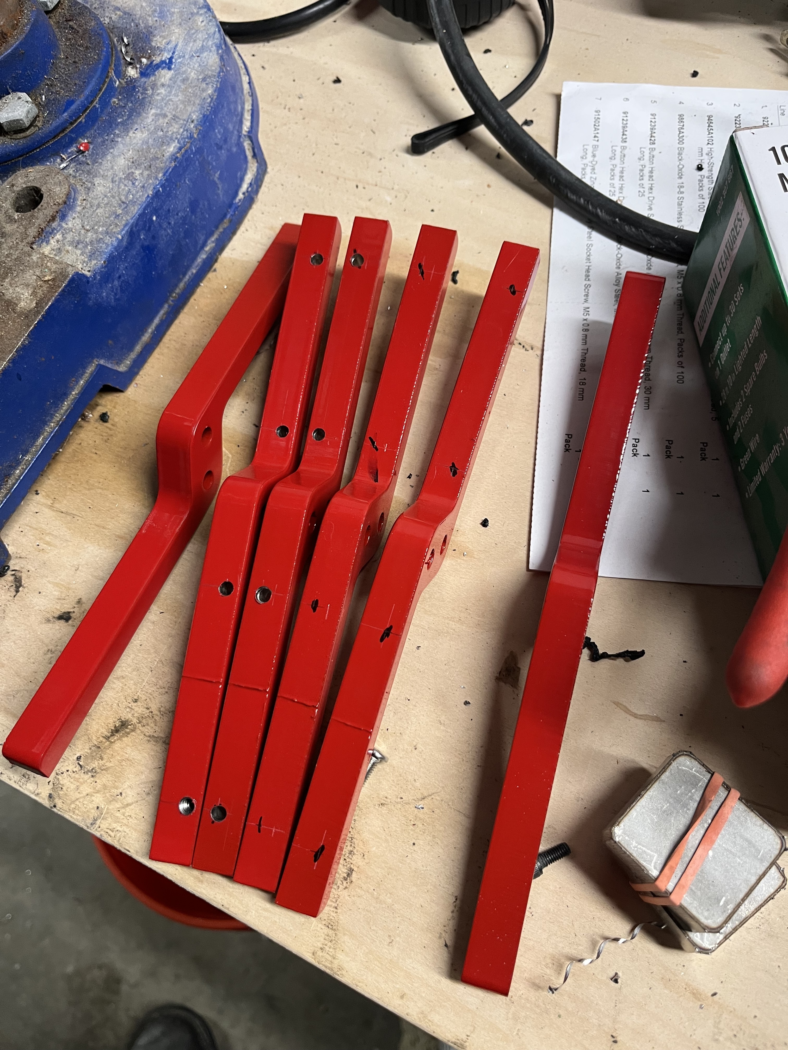

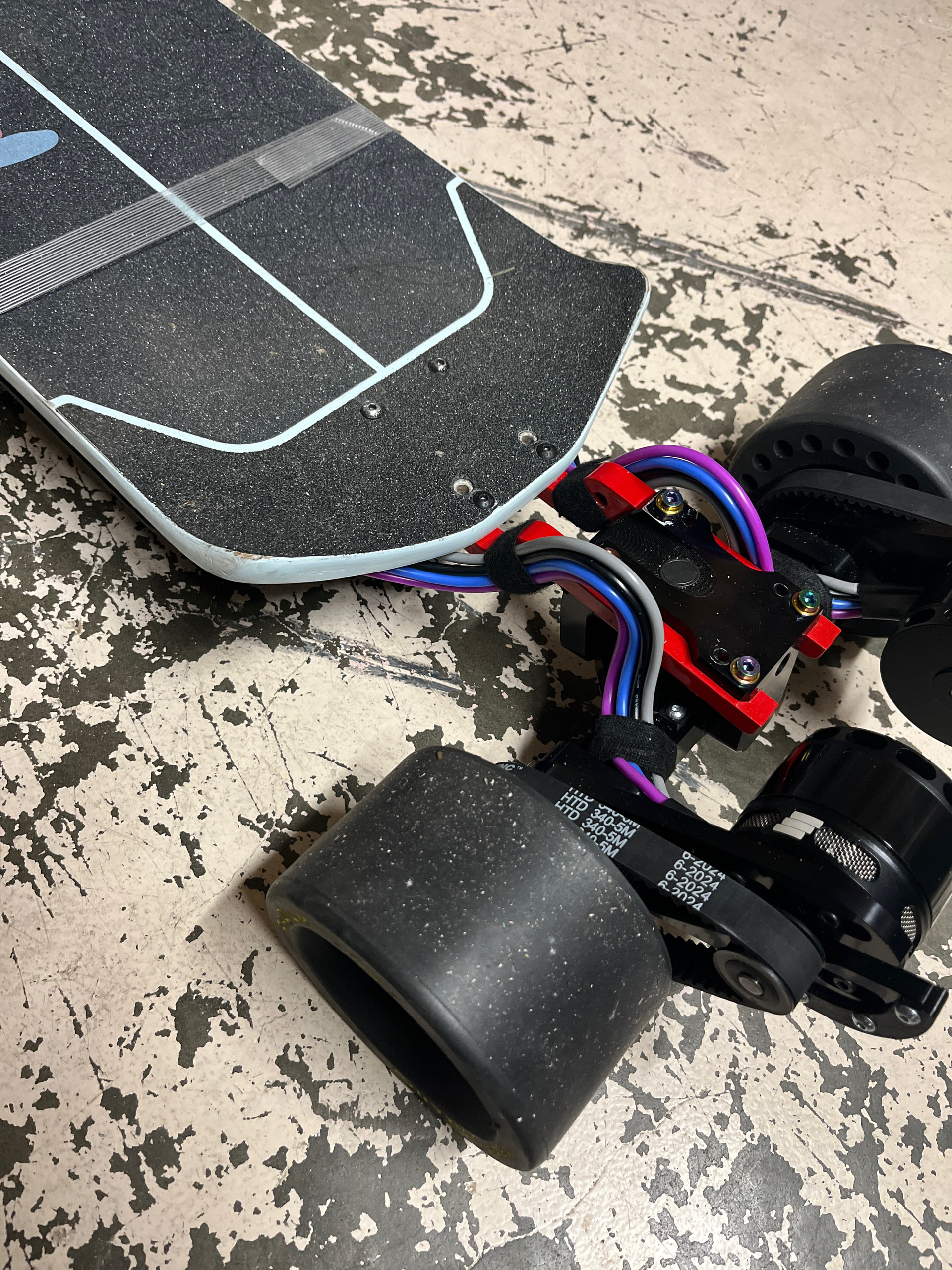

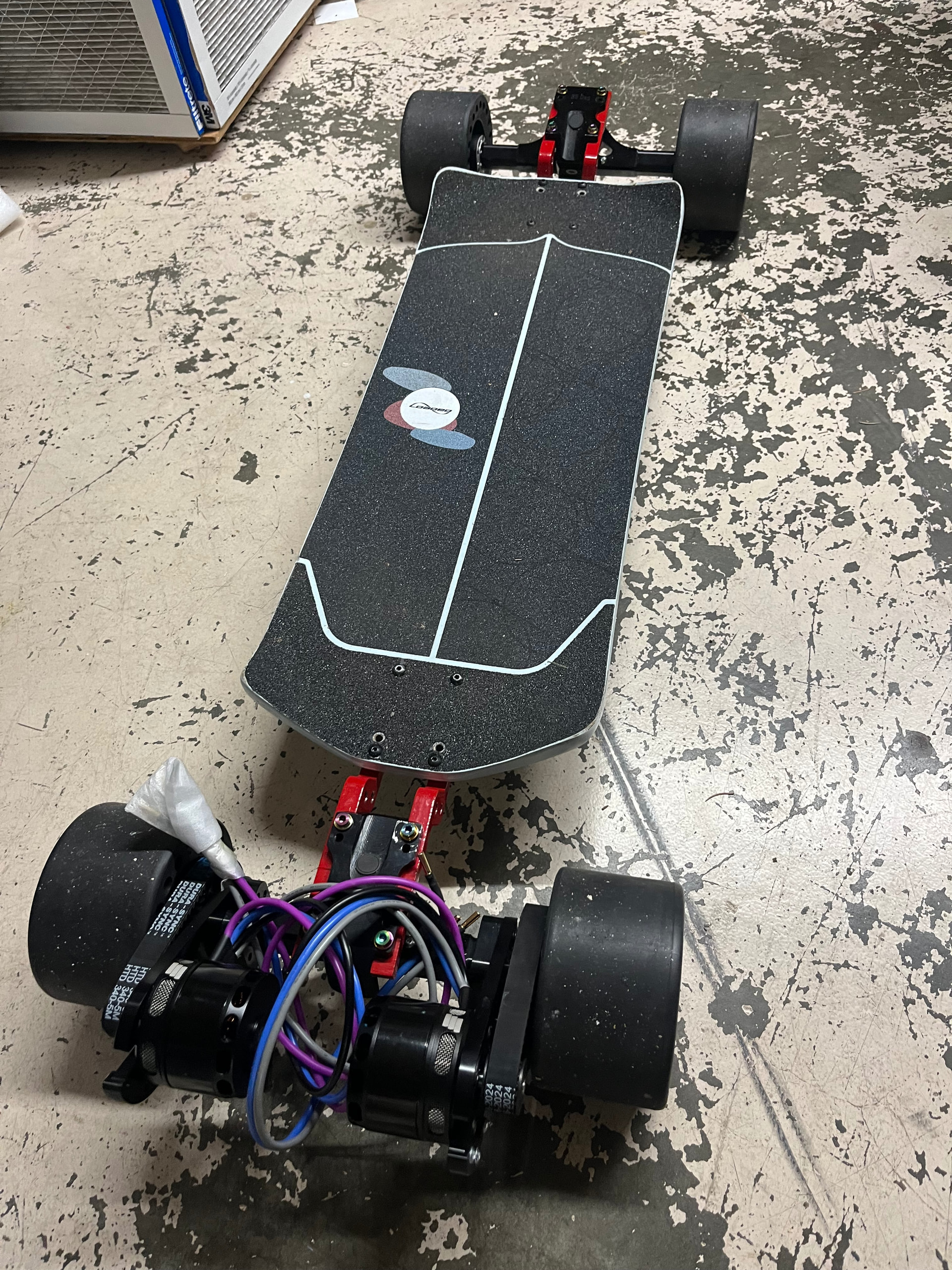

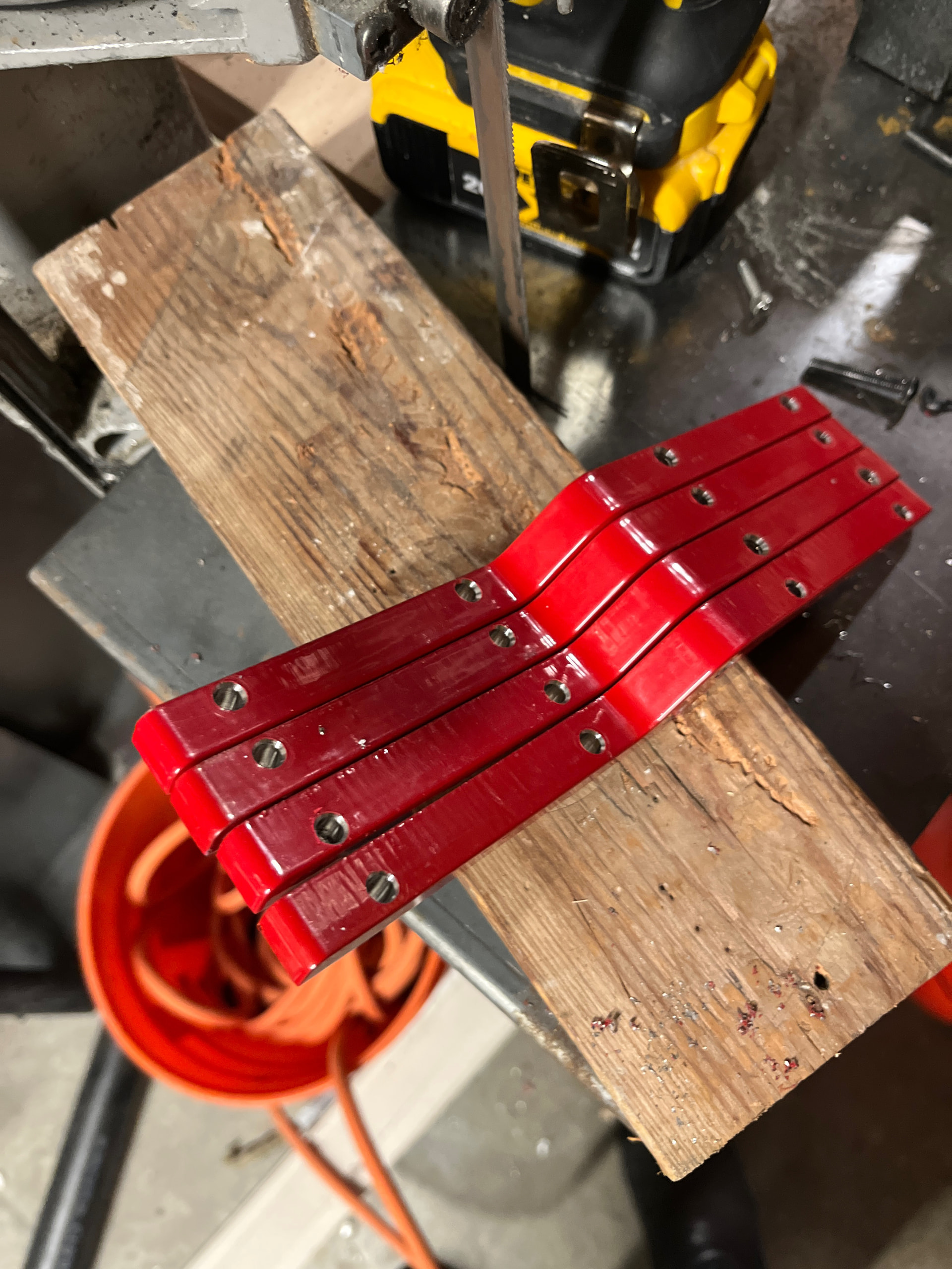

Only snapped two taps and seven bits to get here, ugh i hate stainless. I did get to stand on it though. Not finished by a lot and ill break it down later. Feeling really good though
Tantrum build: 210 dualities, tangent deck, 18s4p rs50, rs125s, d100s, custom brackets, BOTY 2026!!!
Hell yeah. Get it done by new years and you have my BOTY vote
love this build

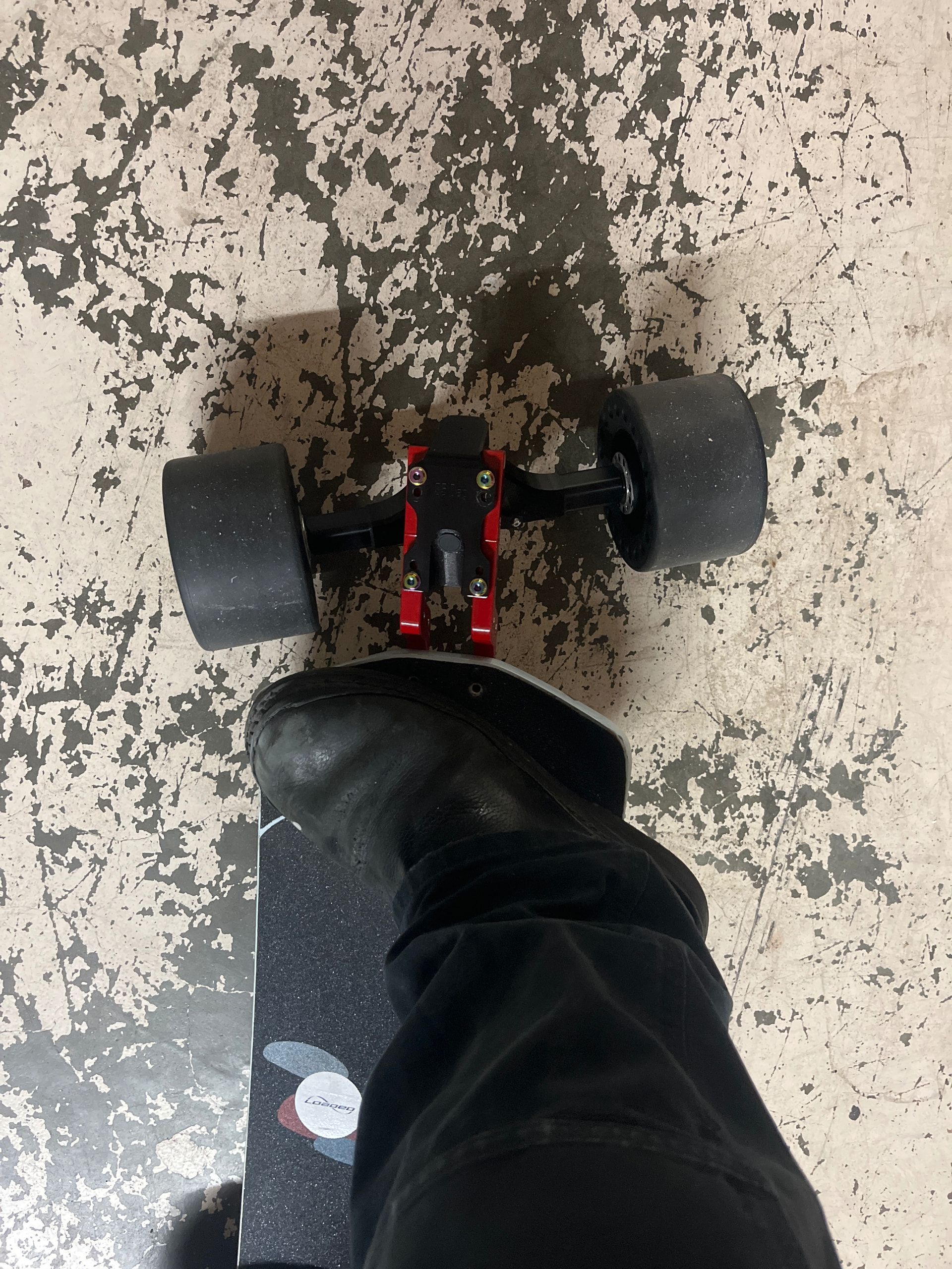

How long is the standing platform? Do you like the corner kicks being so pronounced?
I think i might soften the front toe and rear heal Just a smidge. It feels really good as is but not quite as walkable as i like. I move around a lot and like to have more foot placement options. Snagged a tomiboi foot hook to play with, i donât want to soften up the kicks until i have a good feel to not get foot bite when im moving around
I might make a little wing from tpu to be able to braille my foot position. Finishing the gasket and

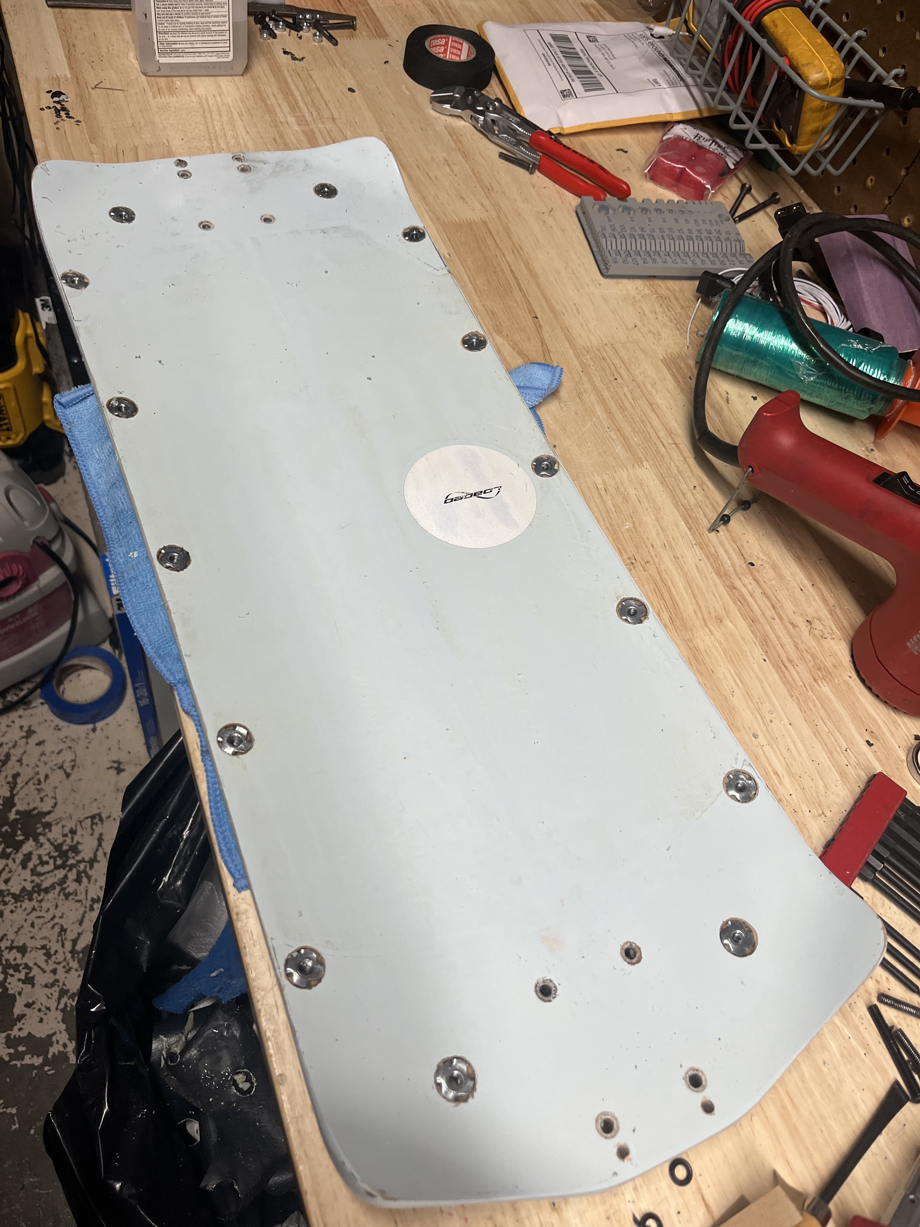

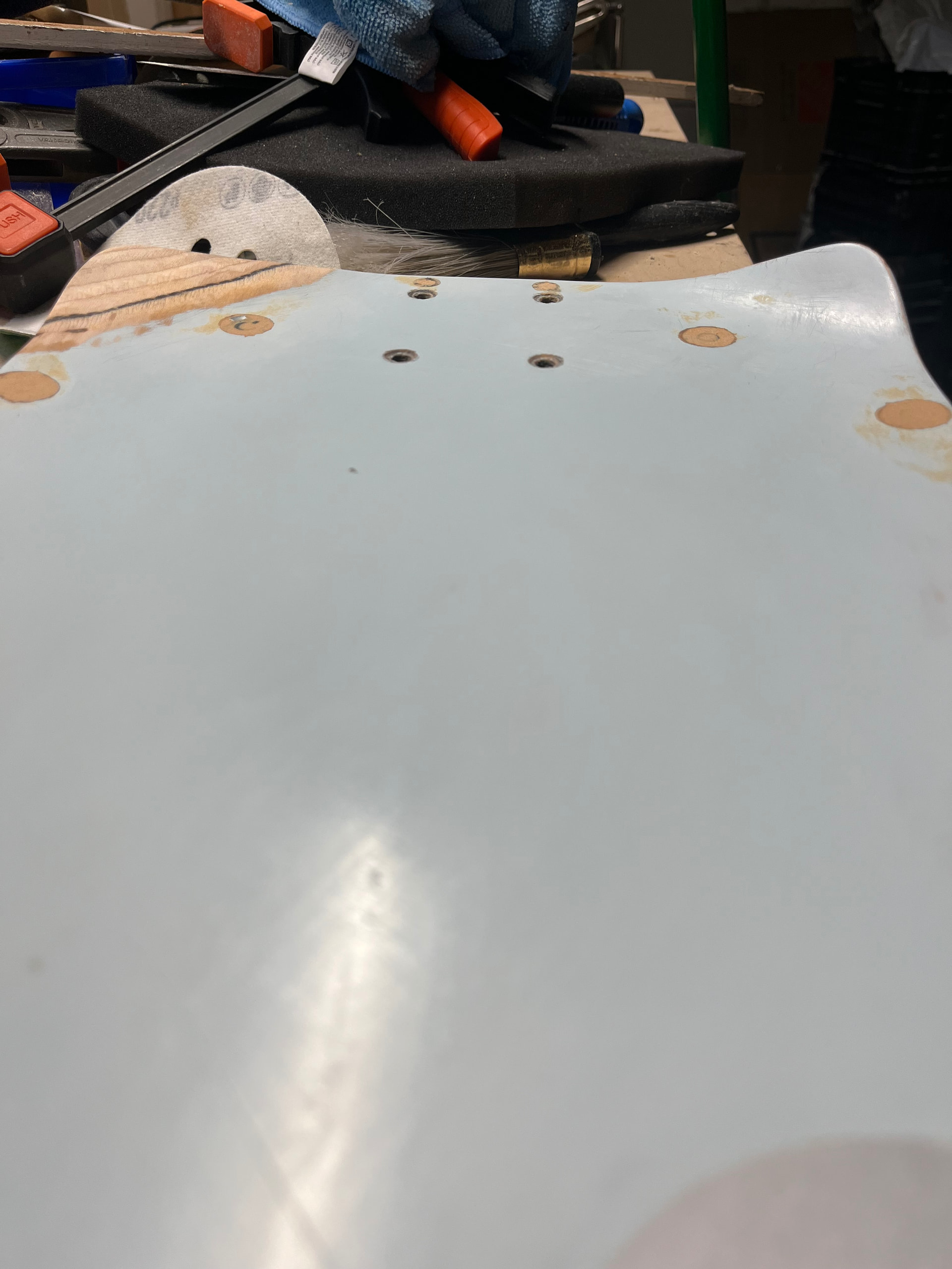

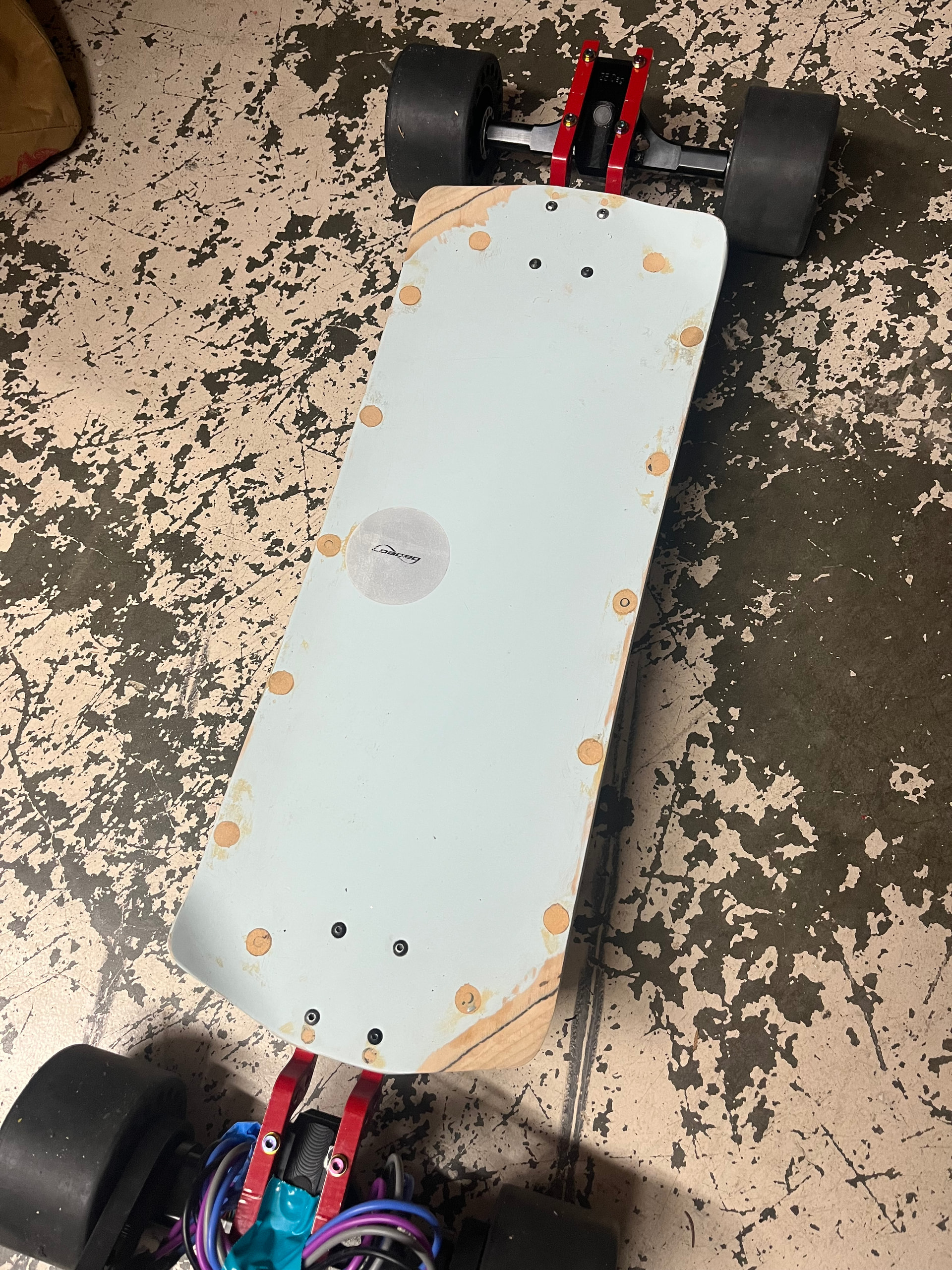

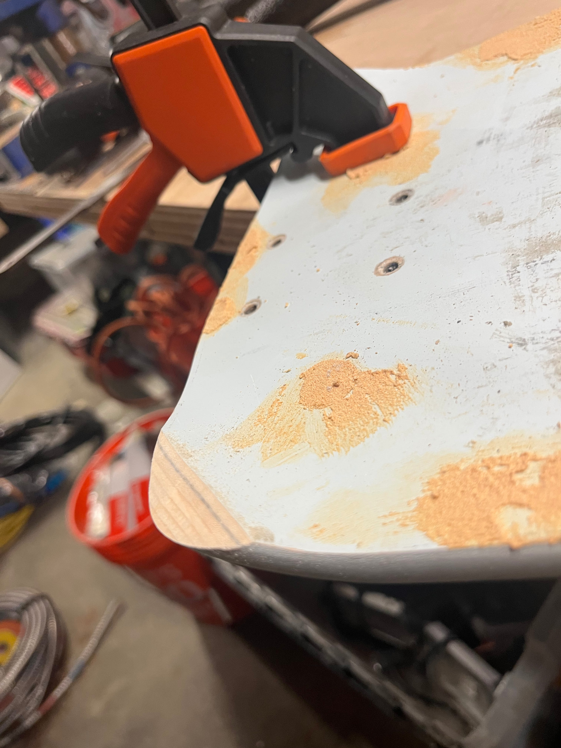

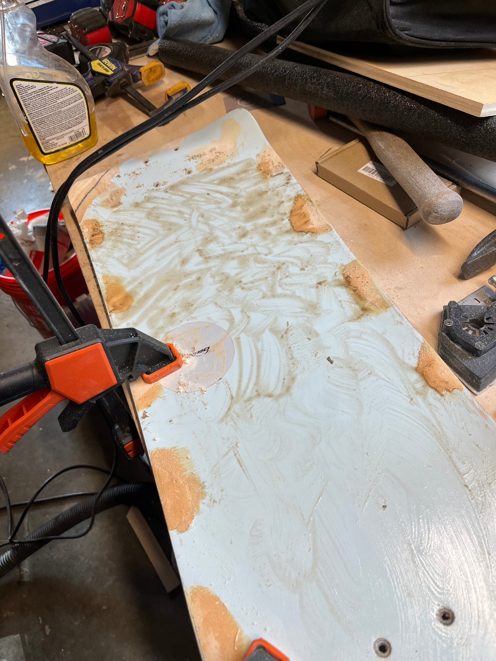

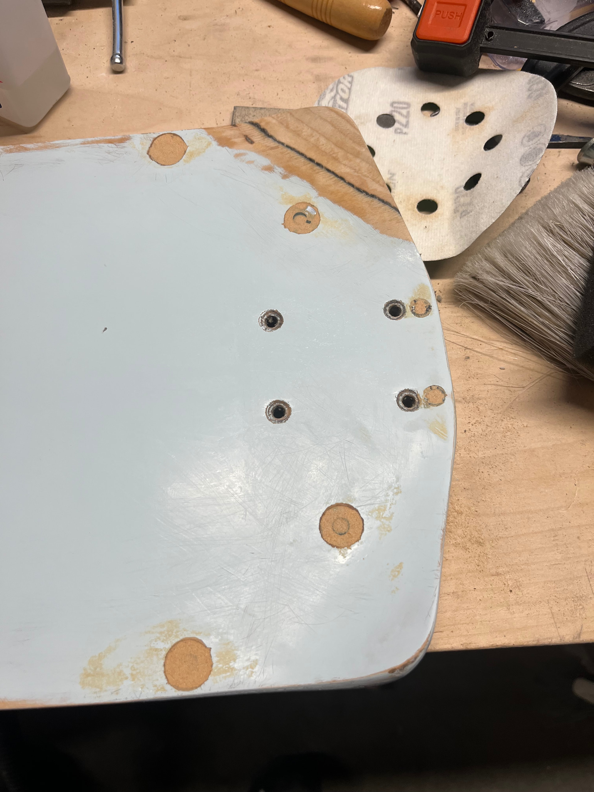

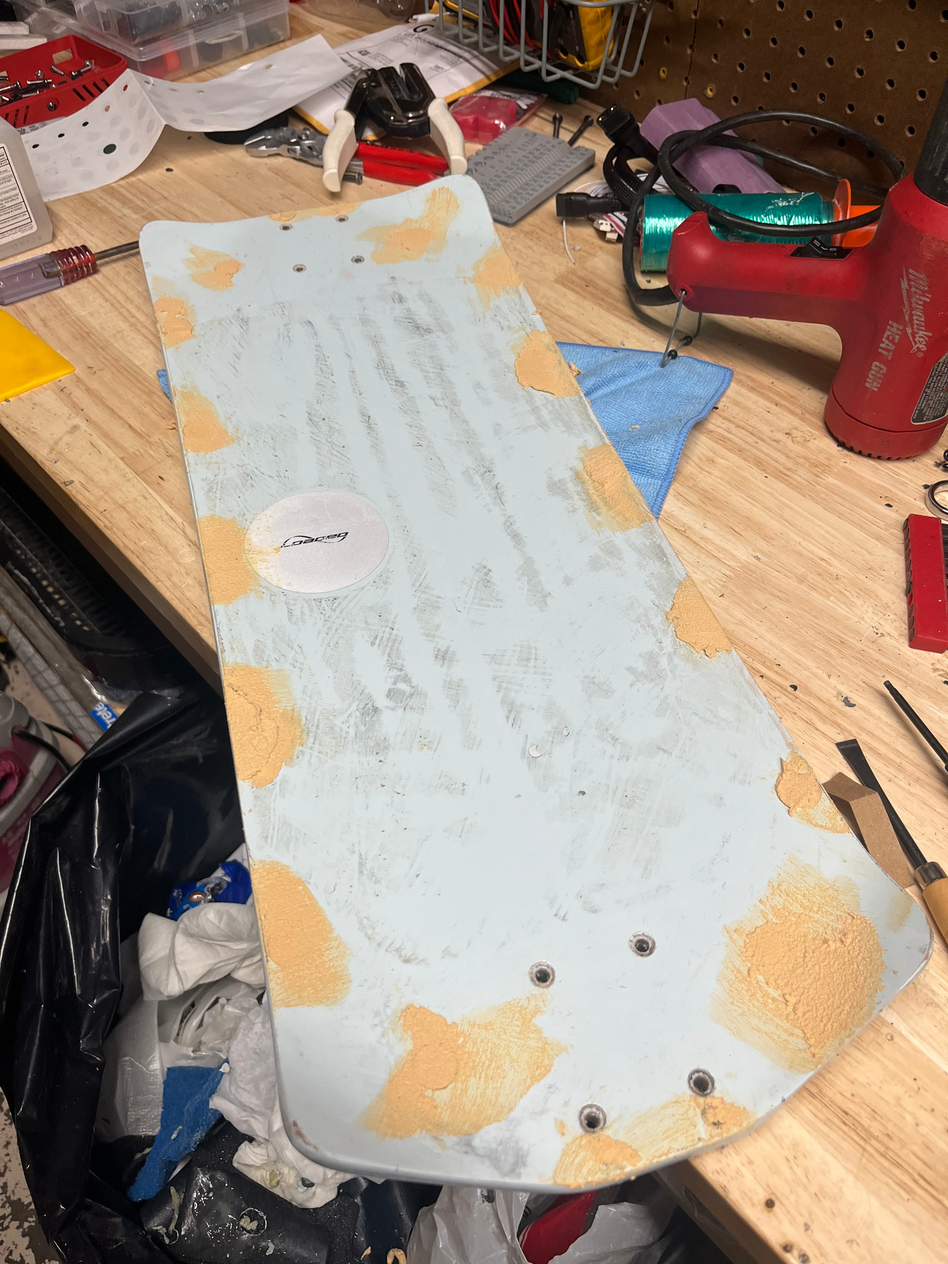

Defanging process⌠and some inserts

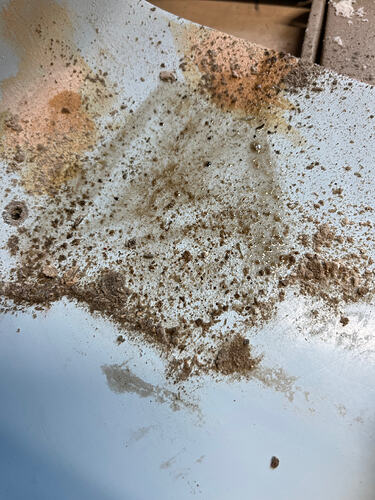

Googone actually works so much better mixing it with sawdust ÂŻ\_(ă)_/ÂŻ
Ok this feels so good defanged, gonna work on a little foot stop to catch my front foot securely and make have it hook over a little so i can lift the front end and have a little lip or bump right on he rear to push my heal into when i lock in

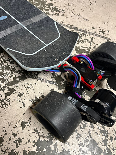

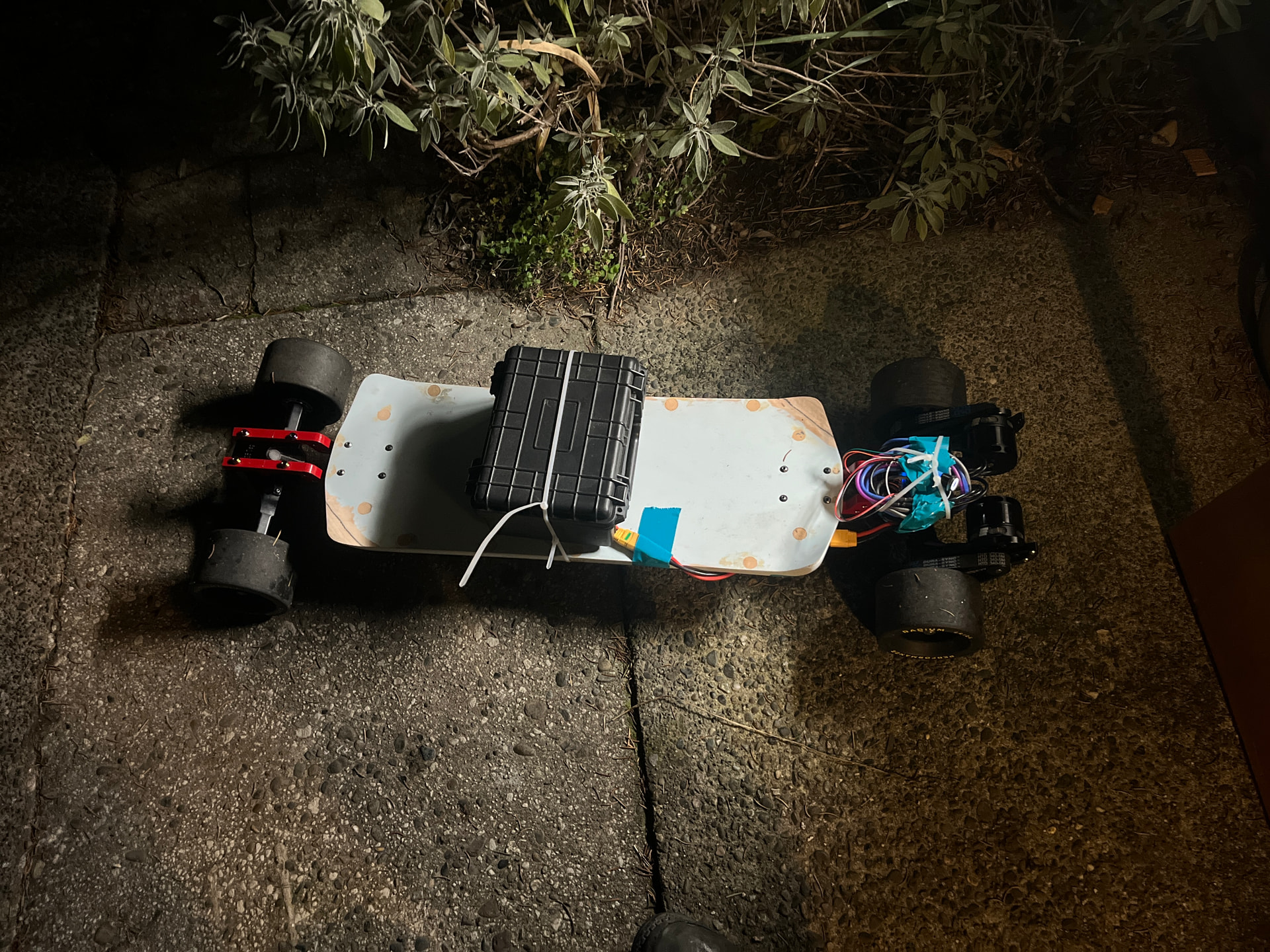

Eeeeeeeeh ok so i slapped an old 10s6p i have sitting around on it so i could play with it for a bit
70/-50 motor 50/-40 batt and its feeling nice and torquey my garage floor is like dusty polished concrete so the tire cherps are no as impressive as they feel. A little dry weather and ill test it out in the driveway but tearing it all back off to try some different foot stops

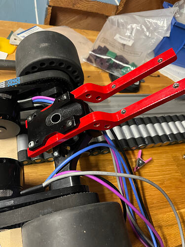

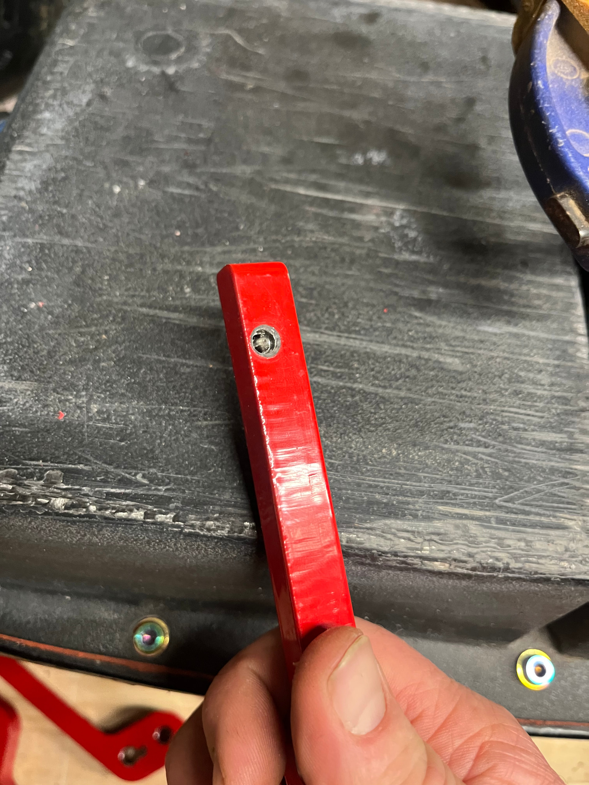

would have to remake the brackets from how they are now, currently the board side holes are through bolted and the nut protruding into the enclosure would make a large amount of the volume un usable without redesigning a little and getting the holes tapped. i was really struggling to tap the 304 stainless even when i thinned the material to be tapped significantly to 4mm. also the reduced strength of the connection with fewer threads concerns me and i want to beat this board up not worry about over straining this connection point. i plan on taking this board off curbs and down stairs as well as just generally beating the shit out of it. i could upsize to m6 from m5 so the 4mm of thread would be a bit easier to get done as well as increasing the strength of the connection.

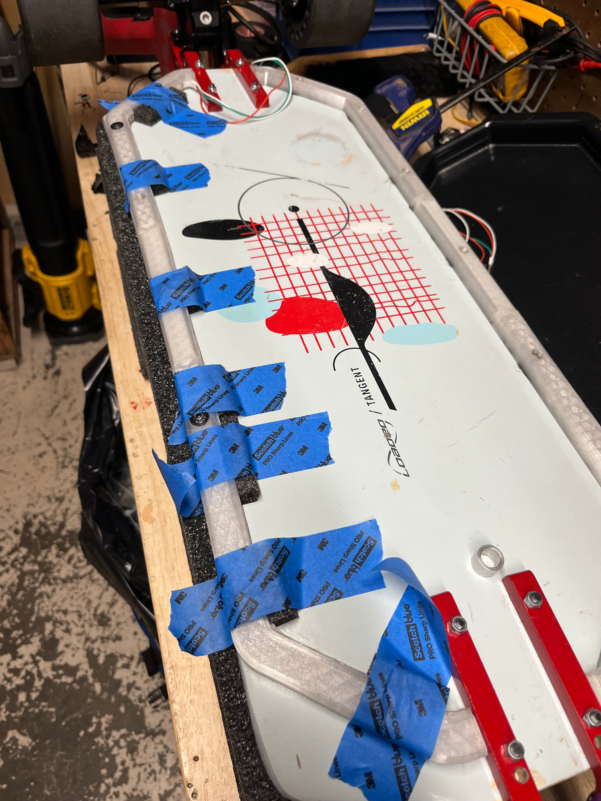

smaller gasket (7-8mm) keeps my clearance good enough and the enclosure will only scrape on the hardest of slow turns and the kydex would hit some of the steep speed bumps but not in any way id worry about.

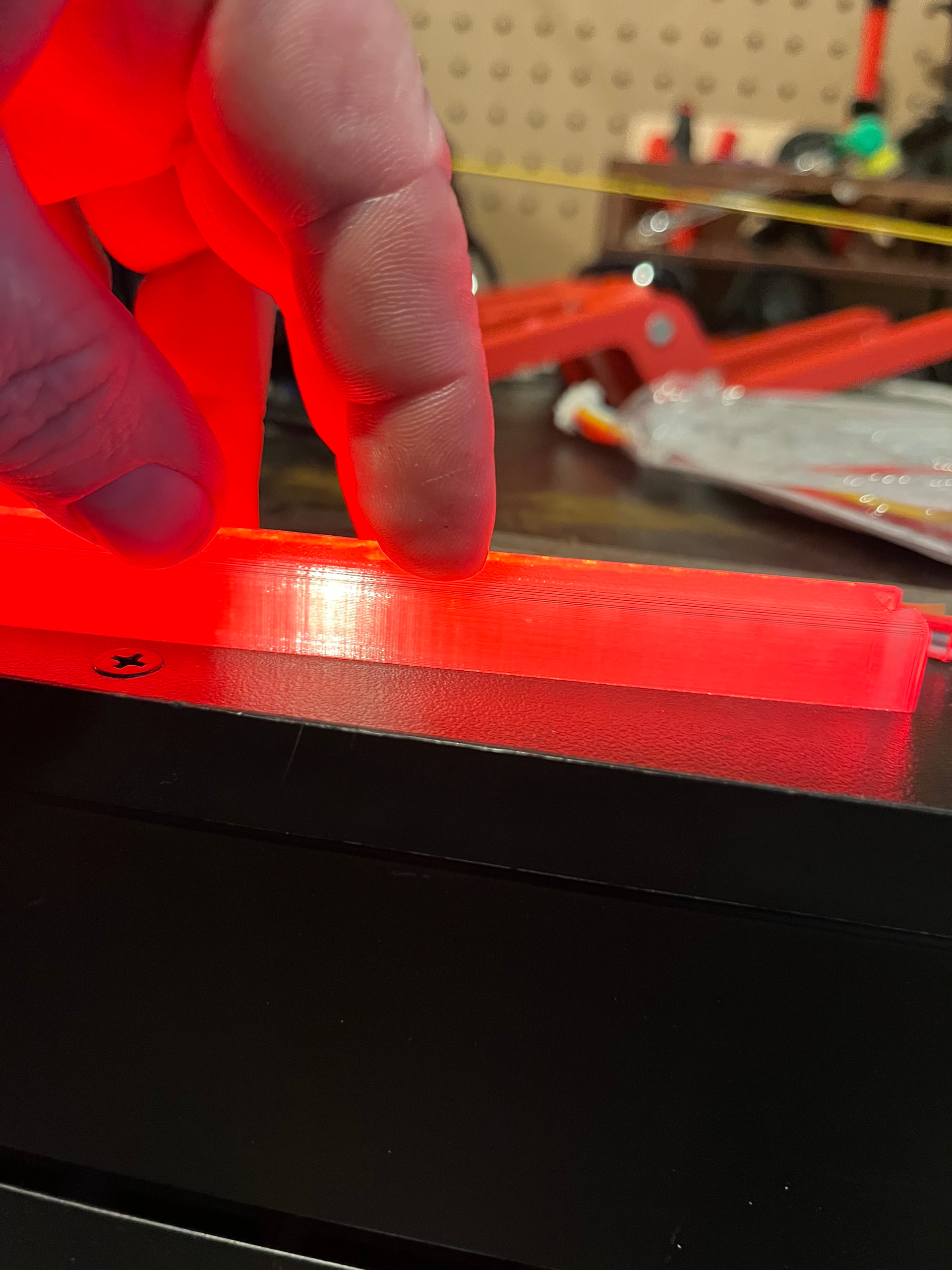

enough gasket that i could make it from clear tpu and put shiny lights in it - more fun for rainbows and visibility. i like ledâs

Reduced clearance and the fix is smaller bracket offset. Reworking it is easy
It will need the deck lifted up a bit, 10mm. Tested it by arranging the drop through to bottom mount but my minimum offset is 17mm but feels ok - just not quite as good as being just a little lower.
Fills the space i was going to use for the bms⌠maybe. Might be able to tetris it under the esc if i eliminate the board side bracket nuts or rout a slight channel for the brackets⌠hmmmmmm

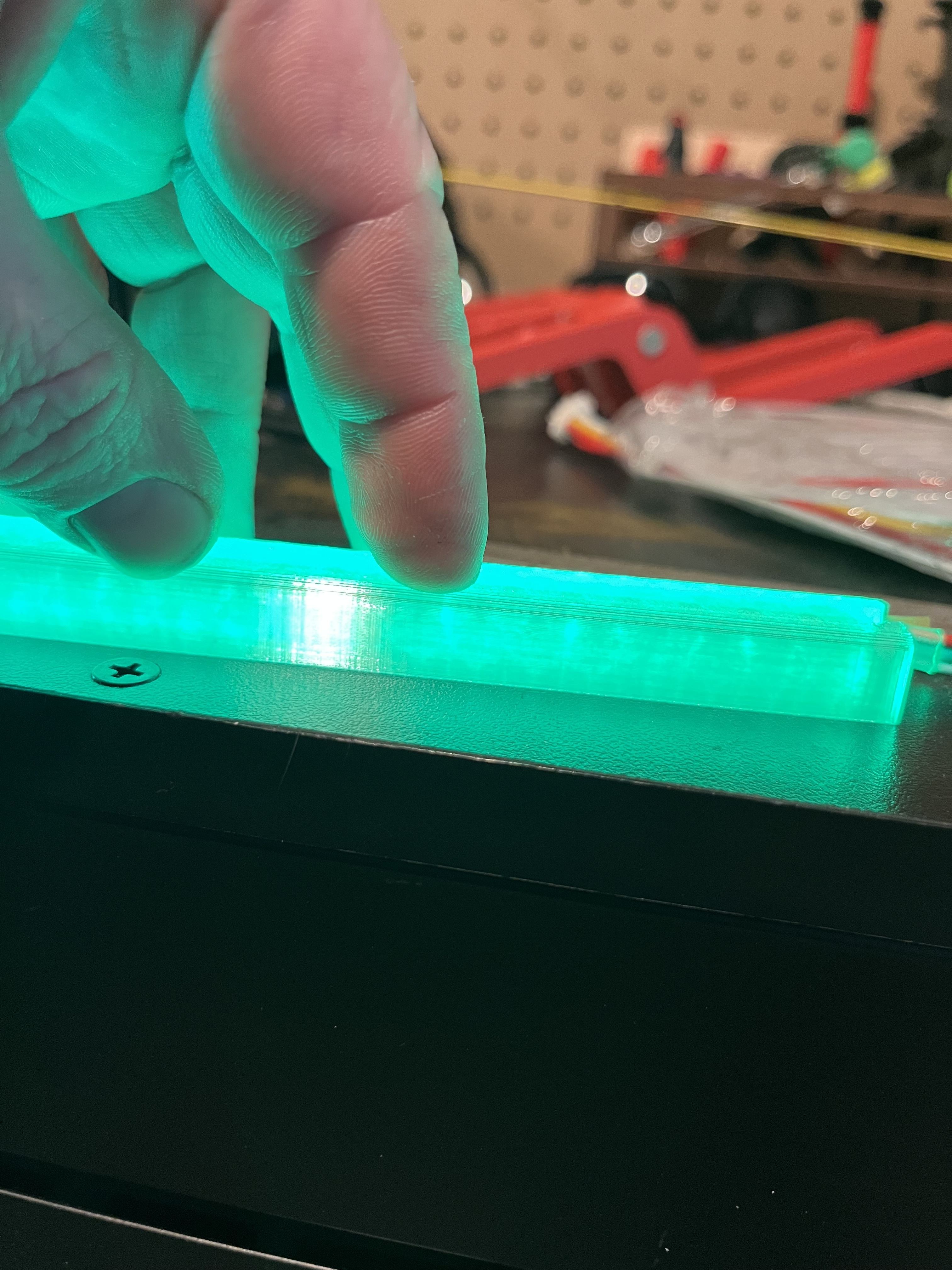

ok so the plan is addressable ws2812b led strips and a ring on the loop front and back of 8 ish leds. Id like to figure out how @tuckjohn did break reactive lighting with vesc express and implement it on here to flash then do a full brightness red for break lights. Scope creep

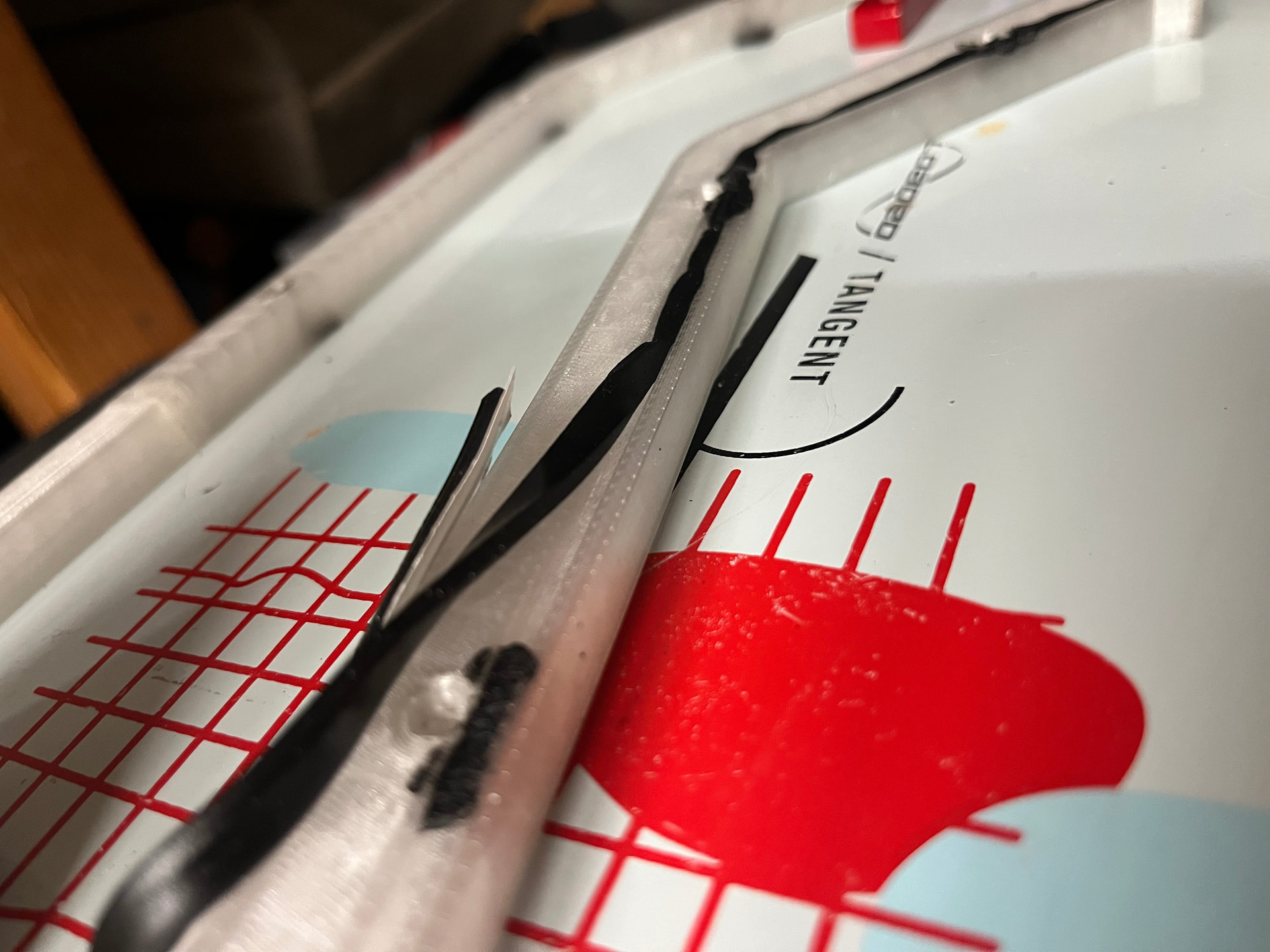

Also added the butyl to the channel in the bottom of the tpu gasket to seal it up nicely
Custom Arduino hardware/software to âtranslateâ vesc/PWM data to WS2812B serial commands
