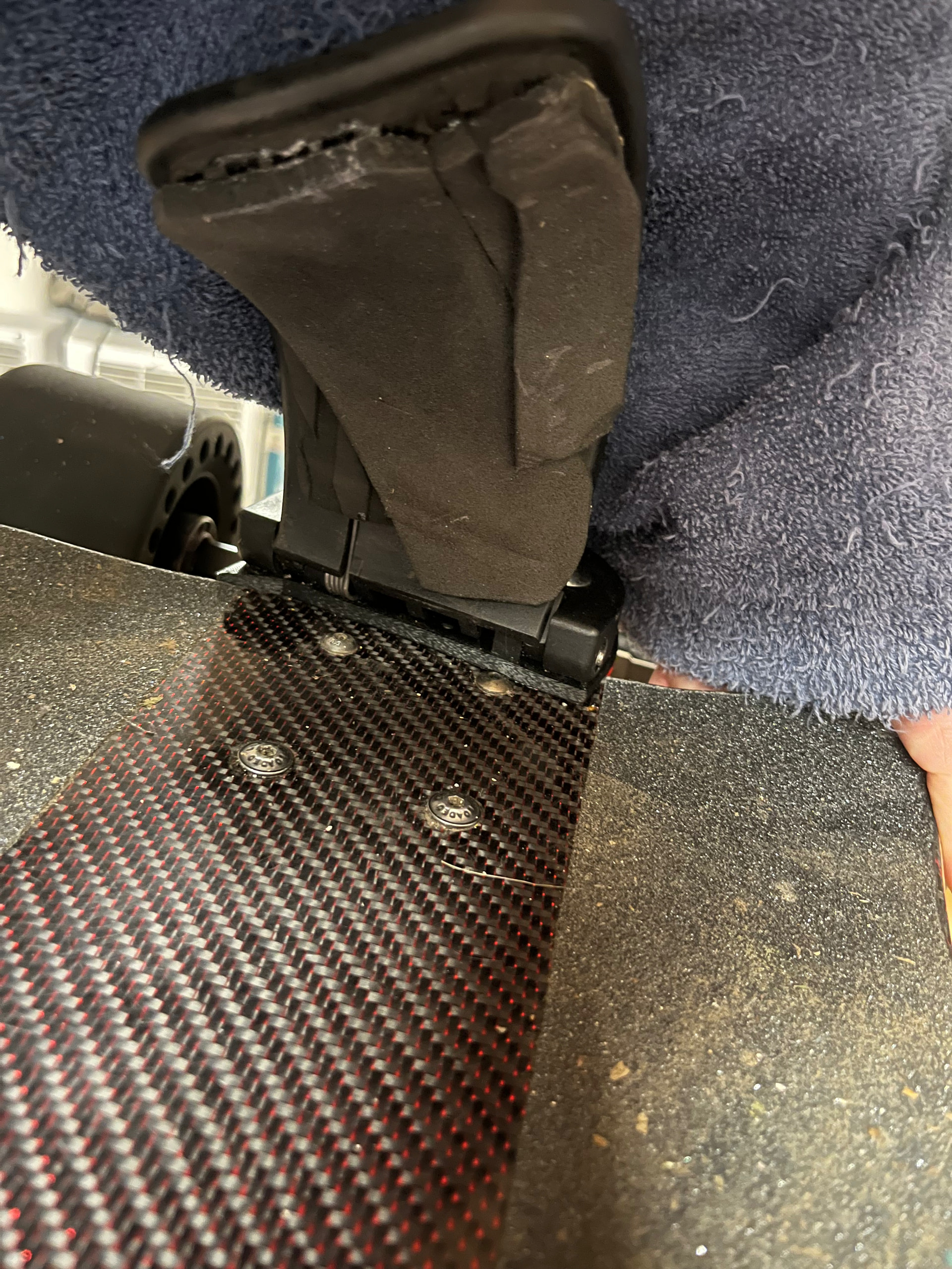

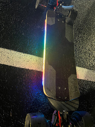

Added some hook padding, top of my foot was feeling the pain so giving it about 7-12mm depending on the spot of nice foam to help spread the load

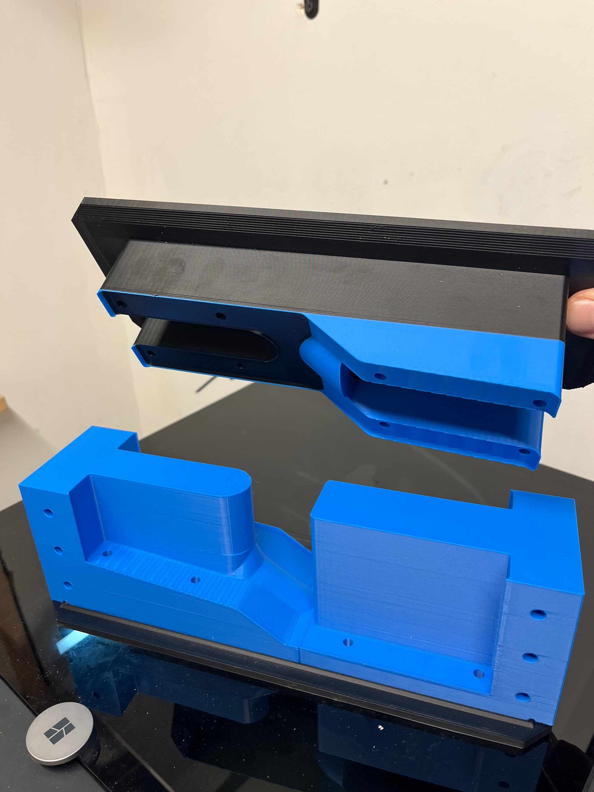

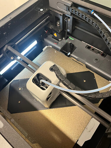

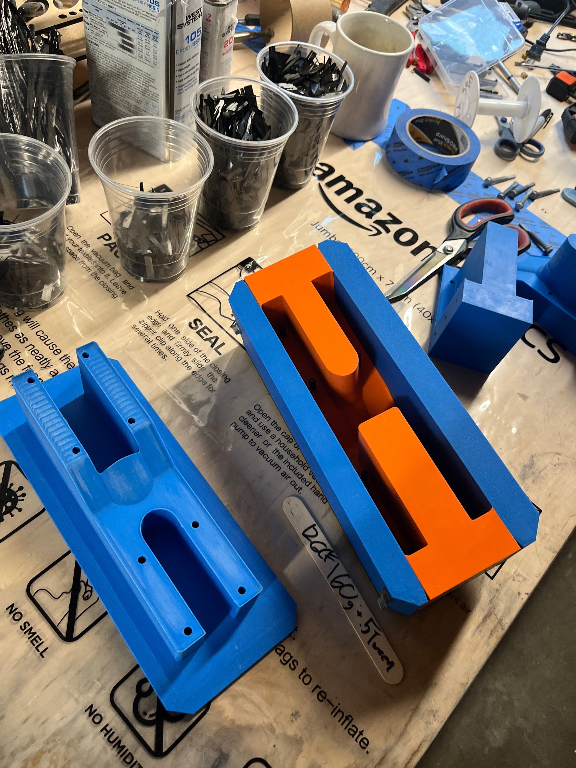

If you can 3d print something it’s good for prototyping and spacers. Im going carbon fiber for my brackets and thinking i can do longer motor mounts in cf also to drop weight and get better tooth engagement. Above is the mold im working through for the v8 brackets with integrated -5° wedge.
Is this what i think it is!?
compression mold?
That’s a lot of mass.
Get some sloooow epoxy.

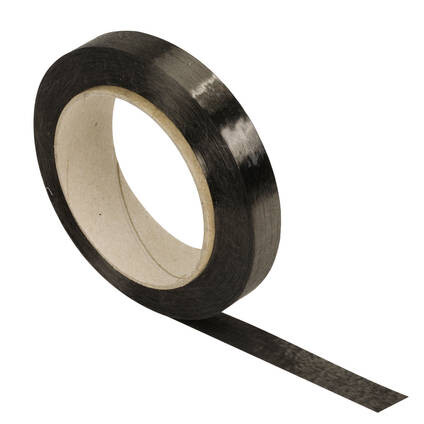

You thinking forged, or many layers of unidirectional tow / tape?
I feel like forged would be the way to go, strength in all directions, def don’t want any torsional flex in these
Ive got enough tow to do it or chop. Going to do a 60/40 mix of chop and long fibers on the long axis. I should be able to get it in, wet, and compressed in 30 minutes i think. 1 hour on the outside. Unspread epoxy in the cup is still flowing until about the 1:30hr mark so hopefully it will work out. Also got some surfactant to try from @Venom121212 (thank you​:face_blowing_a_kiss:) so hopefully will wet out a little faster too to improve my margins and ease of compression
Gonna be a fun experiment
Super excited for the results!!!
My only attempt at a (admittedly difficult) compression mold was a total disaster, so I wish you luck!

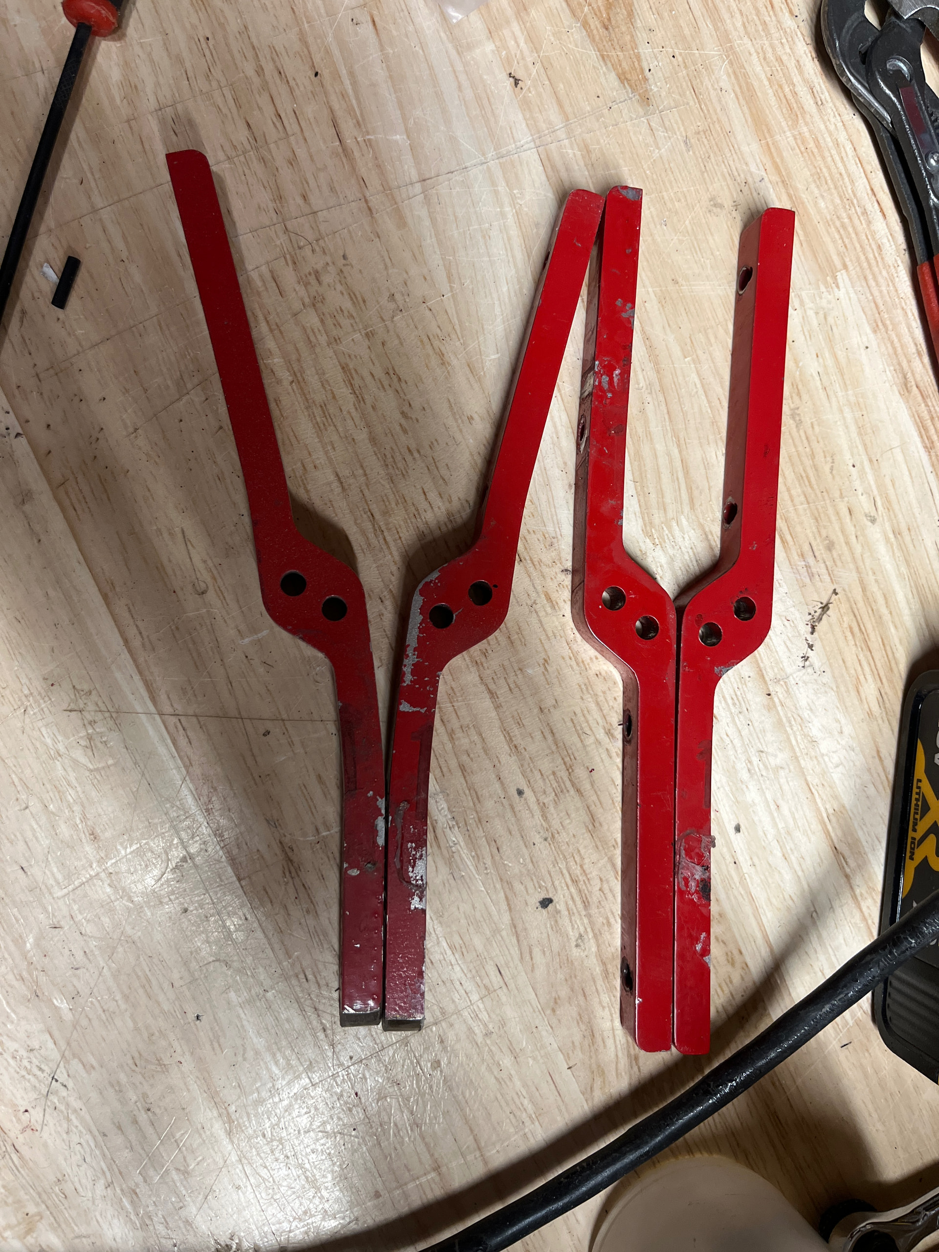

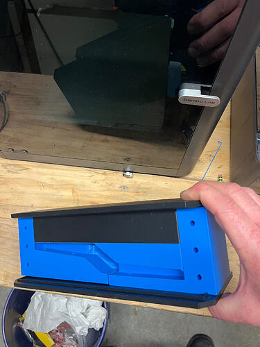

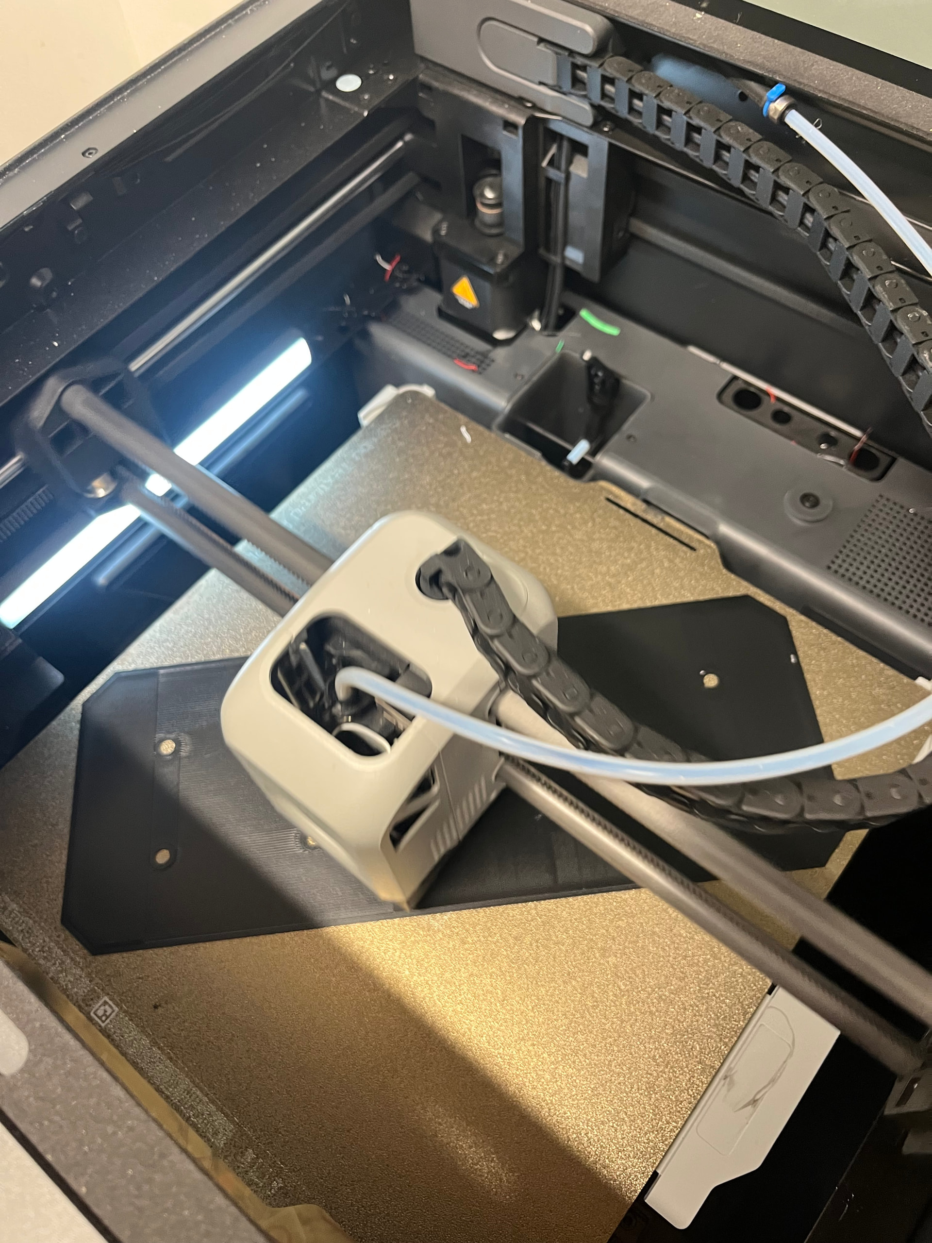

The test print turned out so well im gonna try it while i wait for the full strength parts to print. If the mold dies it will be ok and a good test - if i need to modify something it will be quicker down the pipe. Excited to see how much lighter it will be - the steel ones are going banana after just a couple dozen curbs and drops and these SHOULD be about twice as strong as i think ill need.
Im already on my second set of (4th set?)brackets

Ya and its a l bit of vibe engineering too. Im not an engineer, i can overbuild and trial and error this but i cant really math my way to a solution. I can take a known solution, measure and compare, then add some safety factor. That’s how i got those banana brackets except what i wanted (14.6mm thickness) and what i could source (12.2mm) wasn’t good enough. Close but not close enough
The 304 can’t be heat treated in a conventional way - so the ones from scs are a bit if a dead end. The aluminum options aren’t any better and the cost of having them cnc something for me was astronomical. Just too low volume to justify a big enough run to make it viable.

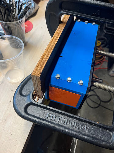

So got the mold looking good, three coats of mold release on it and hoping it’s enough
Mold is printed 8walls and 60% cubic infill - when i got to clamping im glad i went so heavy as it took some serious force to get the excess epoxy out. Much less would have blown out for sure as the “piston” part of the mold was definitely deforming if i applied pressure unevenly.

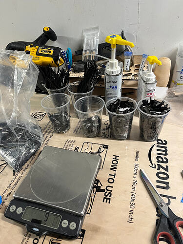

Strong and pretty is the goal. 150.4 cm^3 of volume for the part, so at 1.44g per cubic cm that puts the part at about 210.56g total. Ideal mix is 60/40 so 126.3g of fiber and an excess of resin to aid in losses and compression im doing 150% batch of 144g of epoxy (rounded to nearest dose from my metered pumps.
Im also going to replace 25g of the chop with long fiber tow to add strength to the long axis.
Measured out all my chop and tow for both brackets - let’s do this:

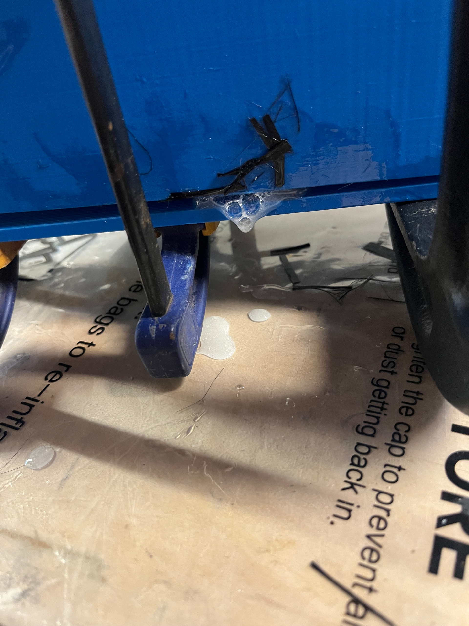

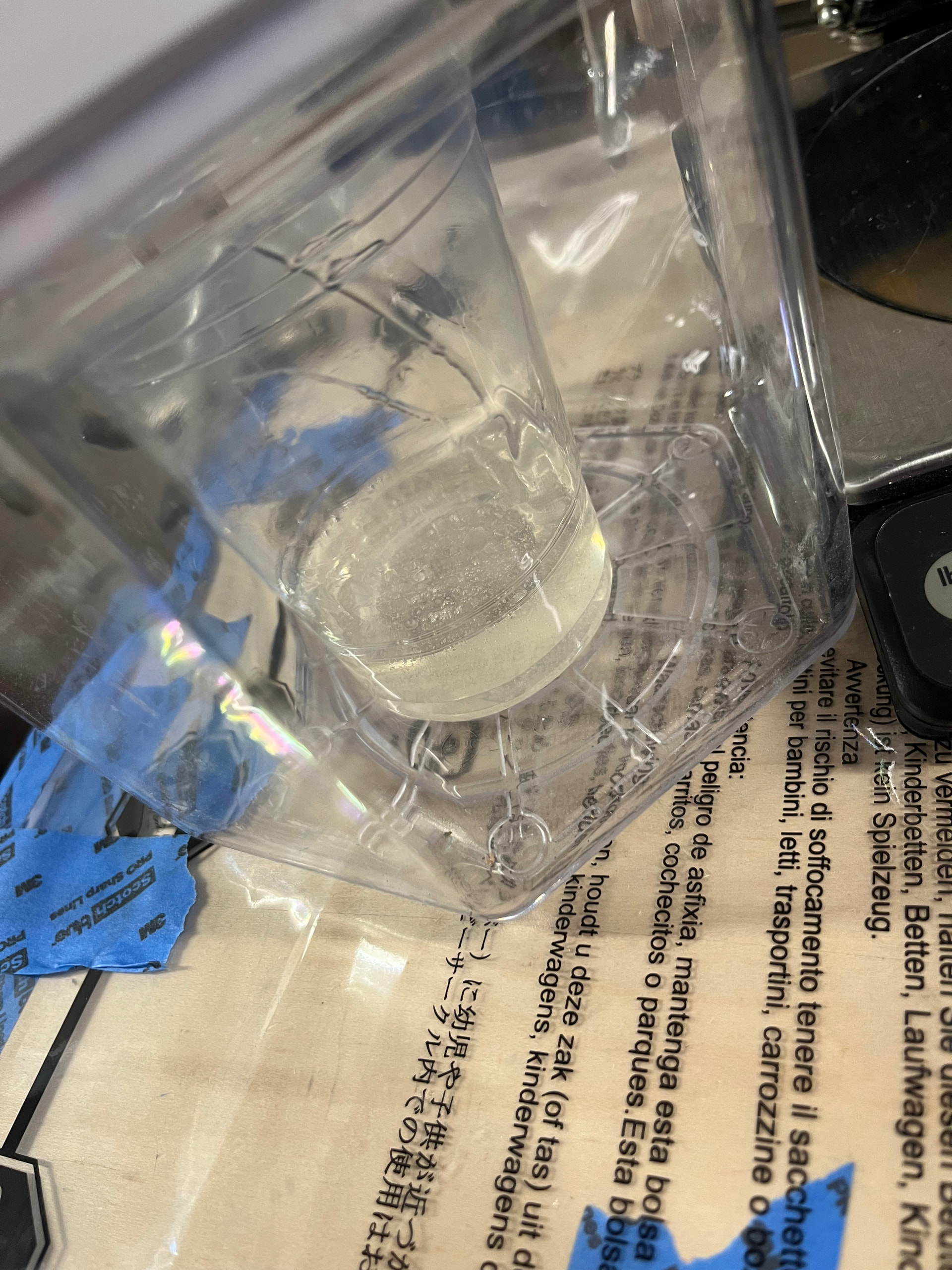

Epoxy was mixed in two batches and i made a little Lincoln log pool area under the plastic to pour out the epoxy flat on the table. I didn’t want to risk it cooking off fast and not being able to clamp it. Added .5cc of the tween20 surfactant to hopefully help the surface tension break a bit and get it to squeeze out of the fiber and mold a little easier.
Painted the mold then dropped in a layer of chop and stipled it down as best i could, put in about half the chop in layers this way making a huge mess and added the tow. I made sure to get the tow on both sides of the inserts i added then put the last of the chop layers on top. Careful with scrapers - popsicle sticks - and fingers i got everything wetted out and feeling kinda evenly distributed and generally in the bottom of the mold.

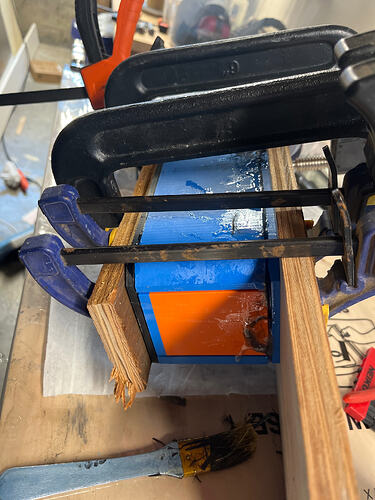

Then started compressing. The piston part slid in well and the through bolts lined up perfectly for the inserts - using a mix of bench vice and giant c clamps i was able to slowly close the mold over about 20 minutes. Give it a squeeze, wait, another 1/4 tuen, wait, until it closed fully. This was to give the epoxy time to flow out of the fiber and out of the thin mold parting lines. Seems good - now to wait and let it cure. I think ill give it 6 hours before I crack the screws back and a full 48 before i demold. Definitely need acme screw clamps and a vice. No way the bar claps could generate enough force
No fill process photos because i was gloved and covered in epoxy.
I can’t help but wonder if it might have been an idea to add a little extra meat around the holes :thinking:
The holes are all the way through and have brass inserts, it’s definitely my first thought and it m going to beat the crap out of em first thing to see how they fail. Hope but verify. Has big version 1 vibes
