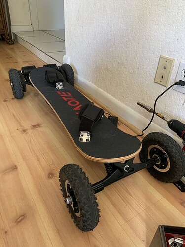

There’s quite an important design flaw with this board under the trucks, you have these nuts and bolts sticking out at the bottom so when going off-road these are perfect for catching all the twigs, grass,dirt and especially rocks which will hit these bolts and bend them or deattach them.
Has anyone come up with a solution to this?

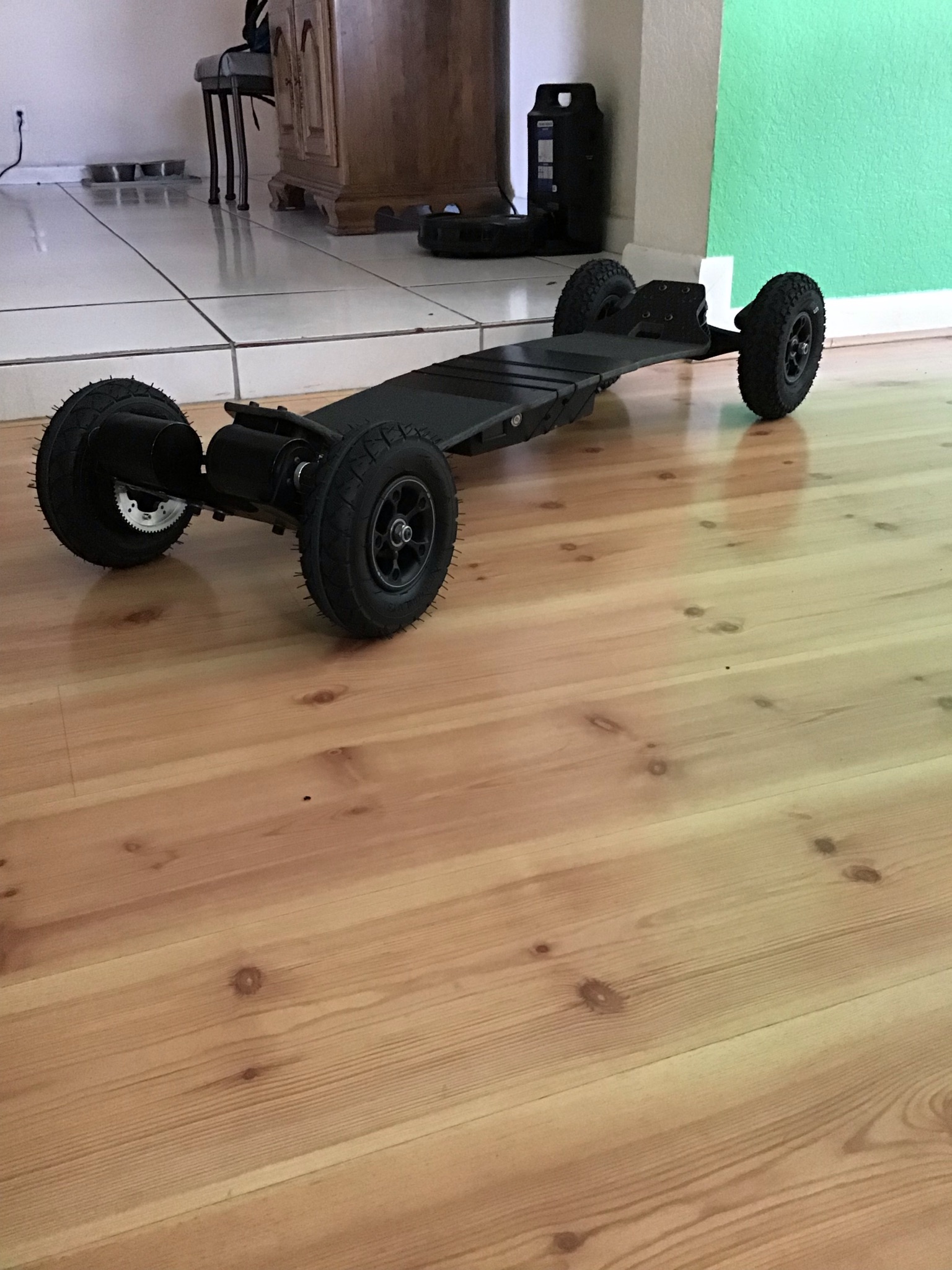

Been slowly remodeling…still waiting on the DV6, tracking has it close, next day or two hopefully. In the meantime the 6354 / 140kv are here and I’ve been playing with the aesthetics (never my strong suit but I like this better than stock).
Stock:
Now:

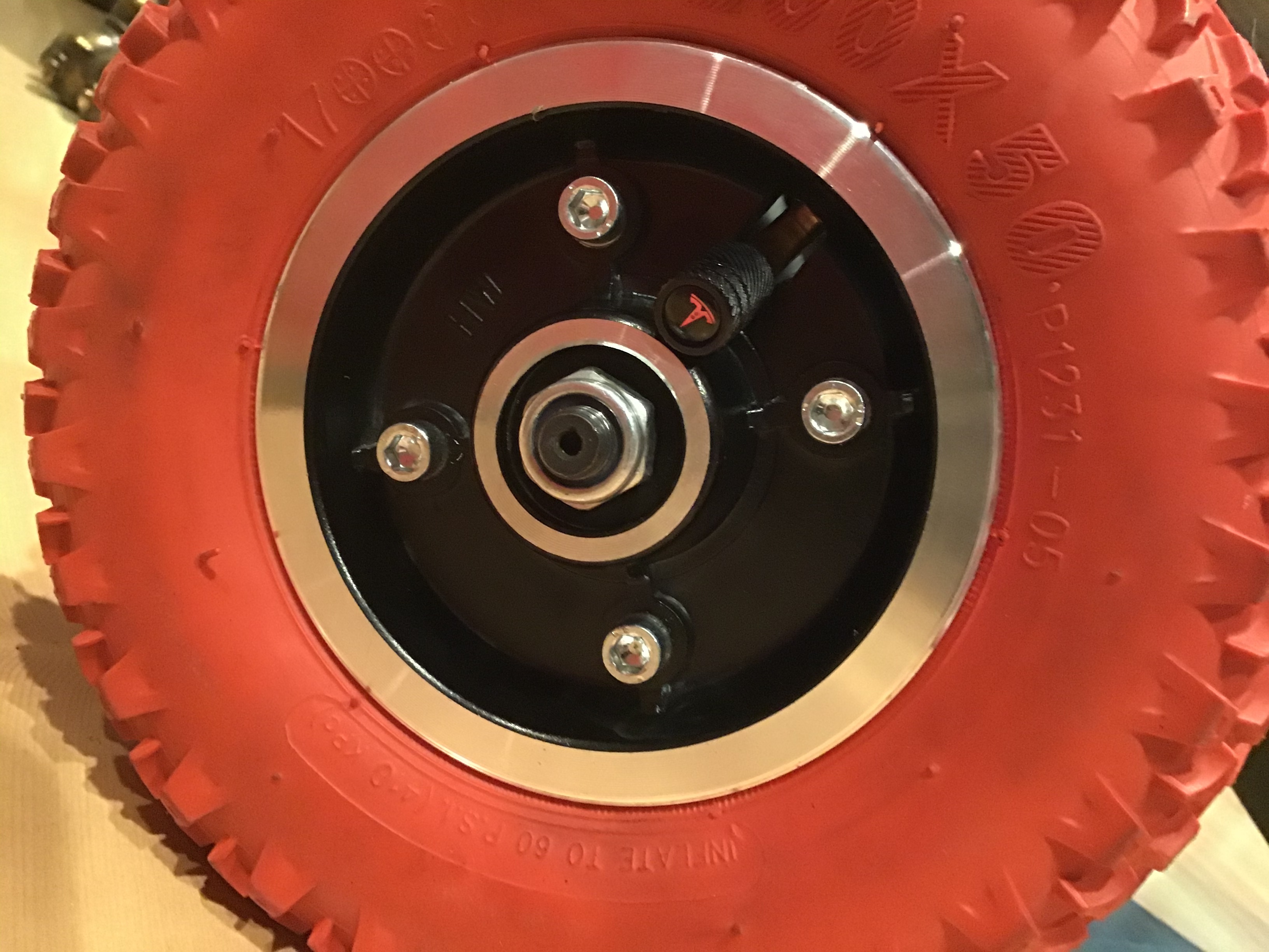

I thought the ā€œTeslaā€ Valve stem caps were cheeky:
Internals this week I hope!
Been doing mine the last couple of weeks, although I’m beginning to realise that there is not much left of the original. So far, new deck, new enclosure, new battery, new vesc, new motor mounts. I’ll be replacing the motor next too.

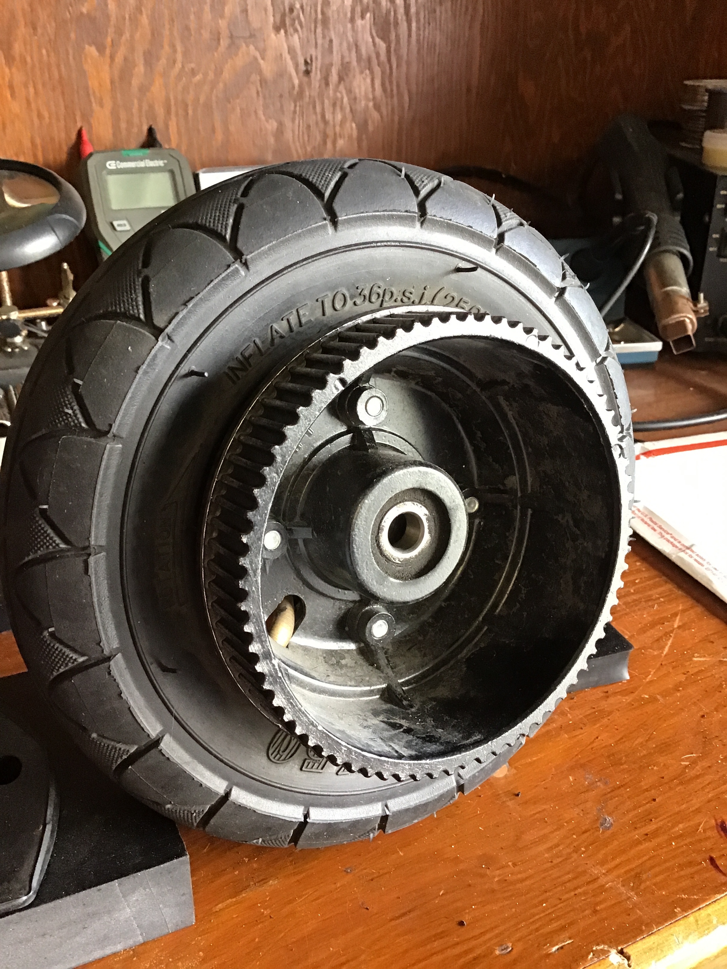

Hi. May I ask how looks holes pattern on this wheel. Dimension bolt to bolt and hole diameter? Iam now developing my chain gears and Iam thinkig create more universal chain sprocket fits to Trampa,MBS and maybe SYL-08. It depend on dimension.
Fitting any kind of drive system to the SYL-08 as stock is not plausible because the wheels/hubs that come with it have the gear pulley machined as part of the actual hub. As such, you would need to scrap those parts completely (as I did) and get third-party’s hubs (MBS, Trampa, etc) at which point the holes are the measurements for those products.

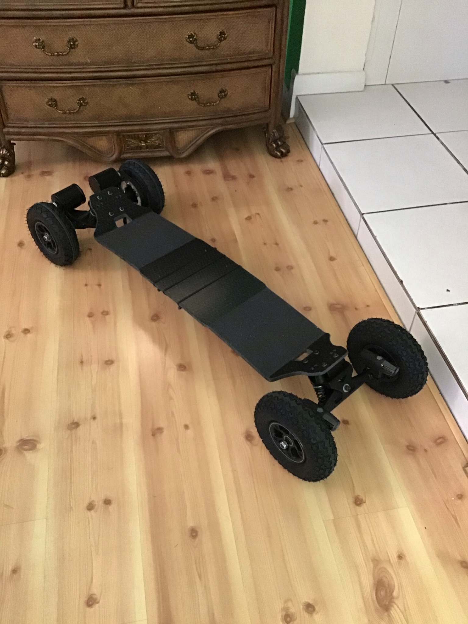

To update this thread…so far I’ve replaced/upgraded the ESC, added an anti-spark, receiver and remote, wheels and tires, and the deck.
All I have remaining is the battery and the trucks (which will need to include a motor mount solution).
The enclosure I am keeping forever…it is awesome.
Solid, tough metal that also acts as a giant heatsink that gets constant airflow.
I’ve also replaced the zip ties that were there during the fitment testing phase. It is bolted on proper now.
The flexy deck requires that the nuts are not on too tight, but the EVA foam seals the gap.
Also had to fashion risers with a channel-truck footprint out of rubber. I’ll create a whole build/upgrade thread when it is complete.

Thank You a lot for Your explanation. I heard lot of about never ending upgrades, but to be honest It was not clear for me that wheels are so difficult to tune. Iam starting my first build of MTB board and waiting now 1month due to covid on MBS pro. I want use custom made chain gears so I was thinking to produce more pieces and universal as is possible. But now Iam see that use SYL pattern make no sence. Thanx again.
