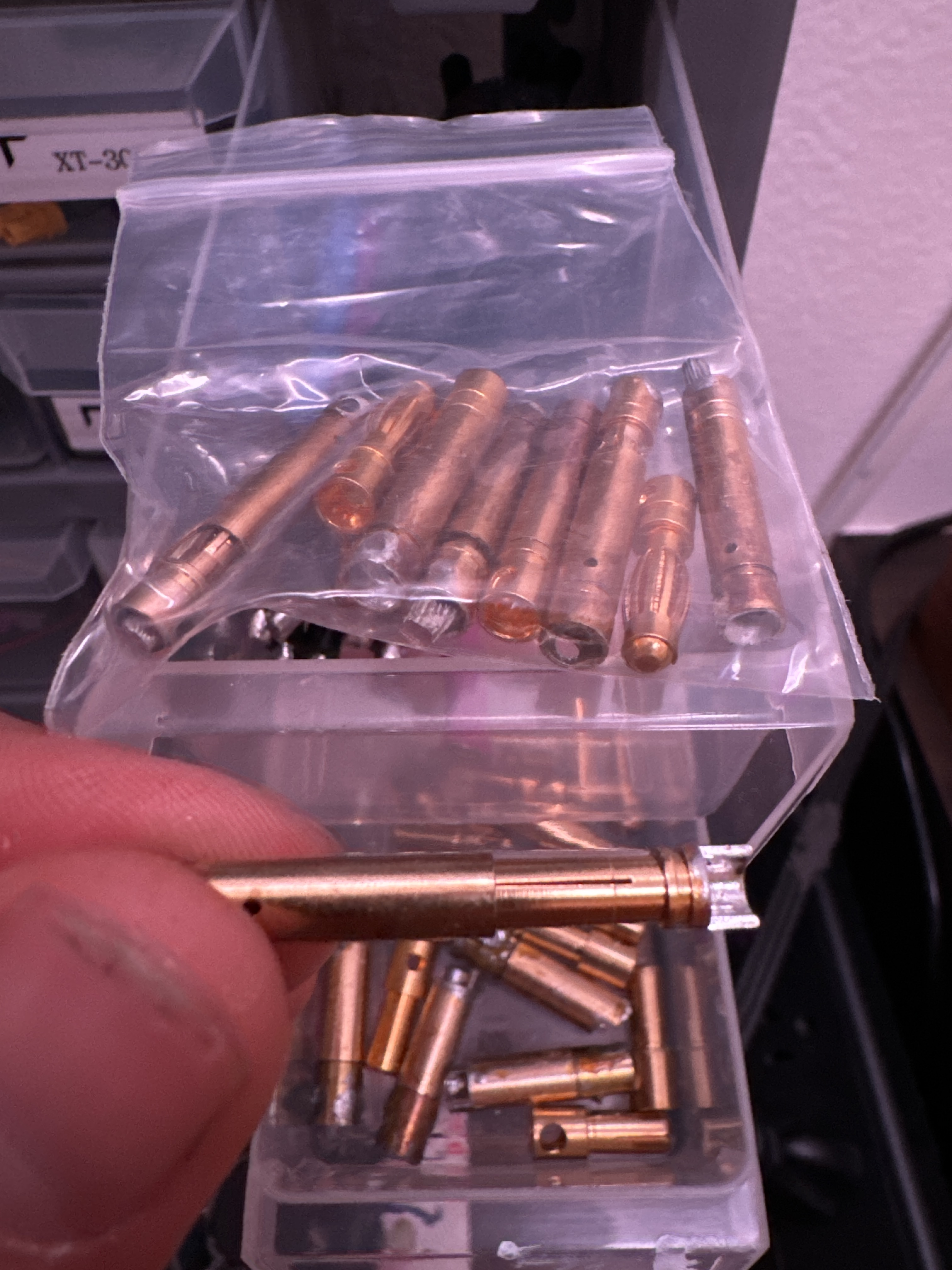

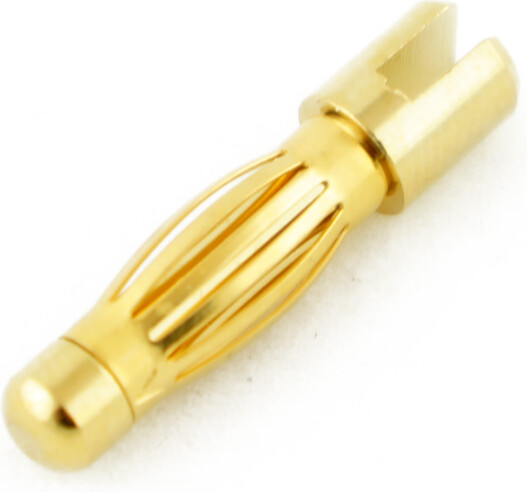

Redundancy, I have a fear of smaller bullets that spin. (The male ones)
Generally the smaller ones are this weird spring like mechanism that spin and I’ve been told that they can cause cutouts as they aren’t ideal when pushing hard.
Also If and so I ever let someone ride my board I don’t want any chance of cutout happening.
The reachers I put on already have xt150s on em so I figure just also create a standard across my boards and go xt150s
Its what Ilan would have wanted

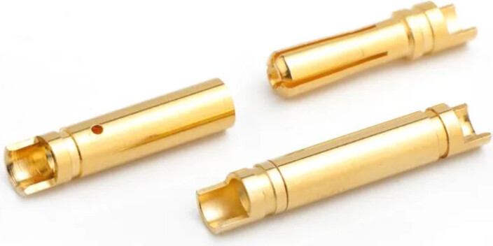

I understand where you’re getting at but I hope you understand also that their exists for a mm bullets that don’t have this spring cage design. They have the same design as the xt150 but as a 4 mm bullet. Hope that helps.
^this da good ish
↓this is the bad ish
overview_image_242226159_5490609
Both are 4mm in diameter.
Correct Yeth :clap::clap::clap: @jack.luis
@jack.luis
So this does beg the question why go for the larger more expensive bullets?
Because I’m retarded @jack.luis :smiley:
I guess because it potentially provides a more reliable connection/ robust connection
Pushing many more phase amps / power overall I want I to definitely utilize such a connector.
Yes it’s expensive
But all of esk8 is.
Why risk it? Yaknowwhatimean?
Lmaooo honestly that’s good enough reason for me

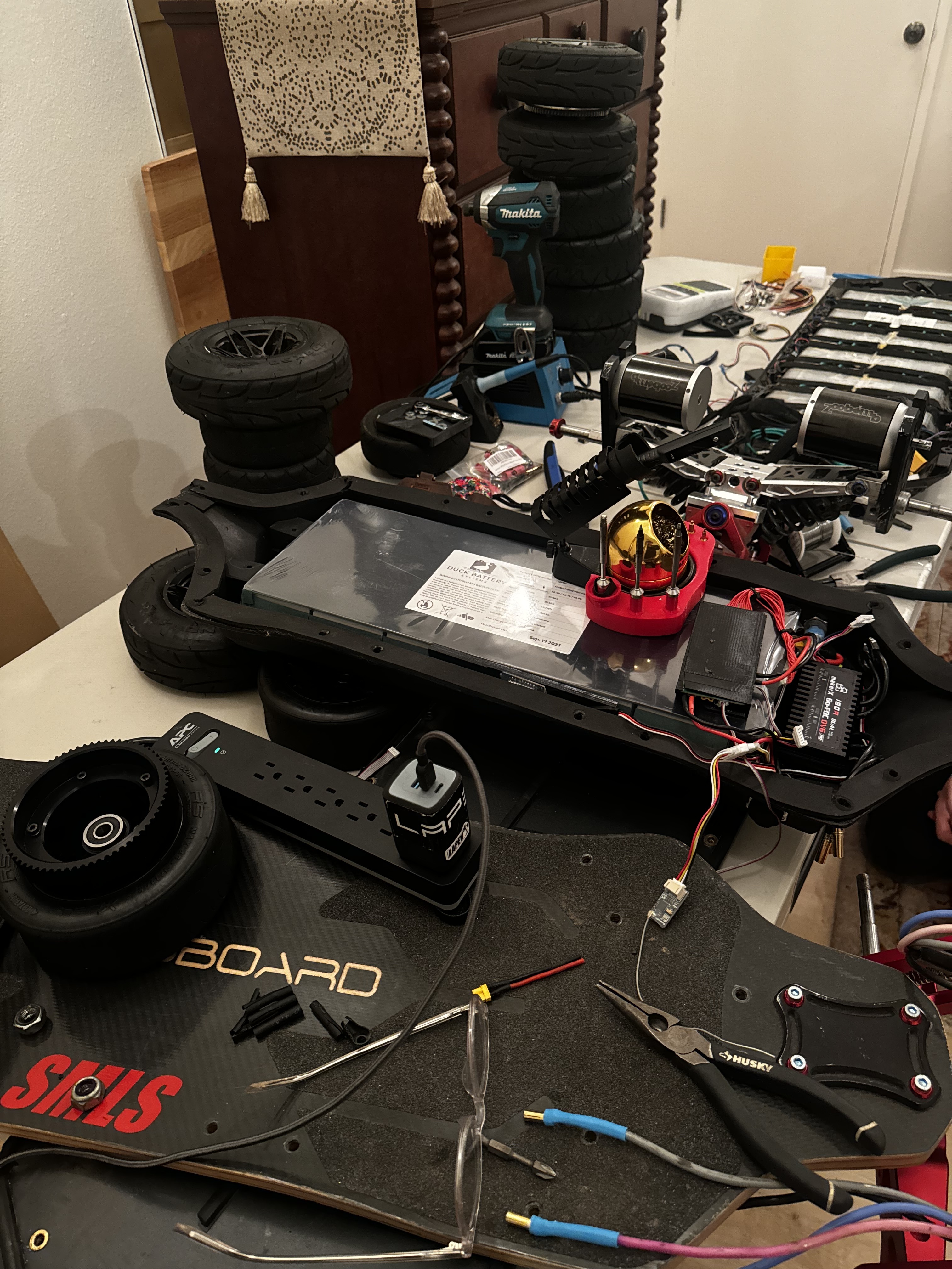

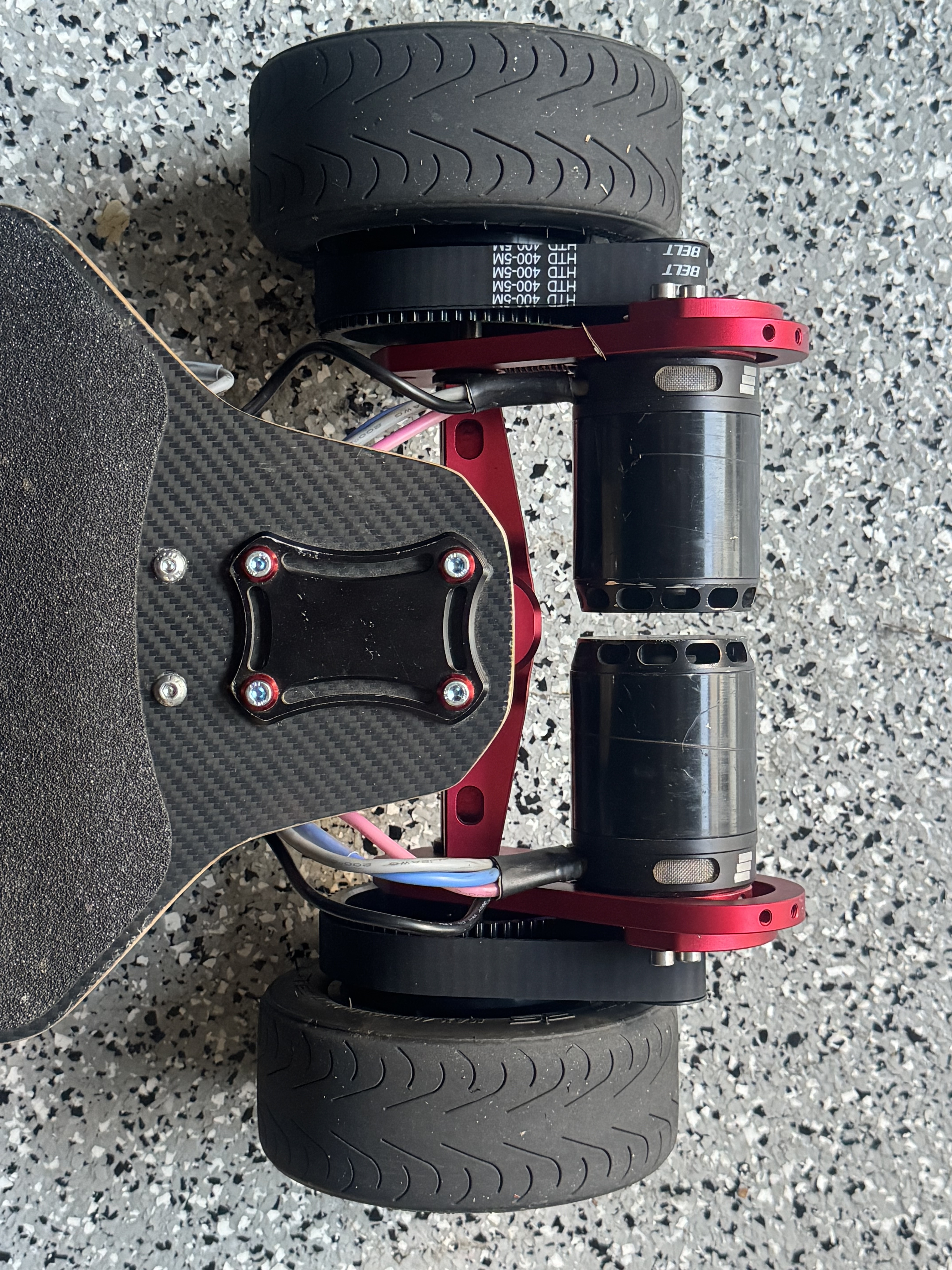

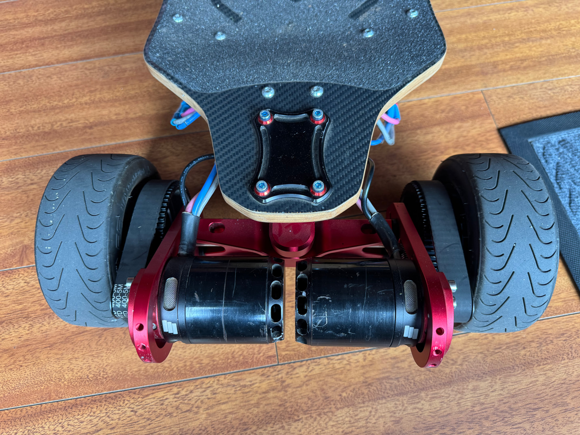

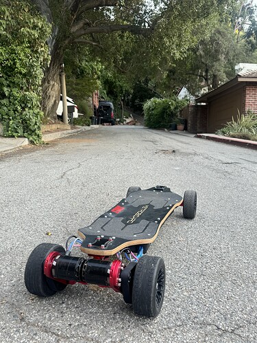

Belts ordered she ready babyyyyyy
Probably going to shred the belts immediately :laughing:
I really hope these motors last atleast 5 runs they sound crunchy as hell on the bench ngl

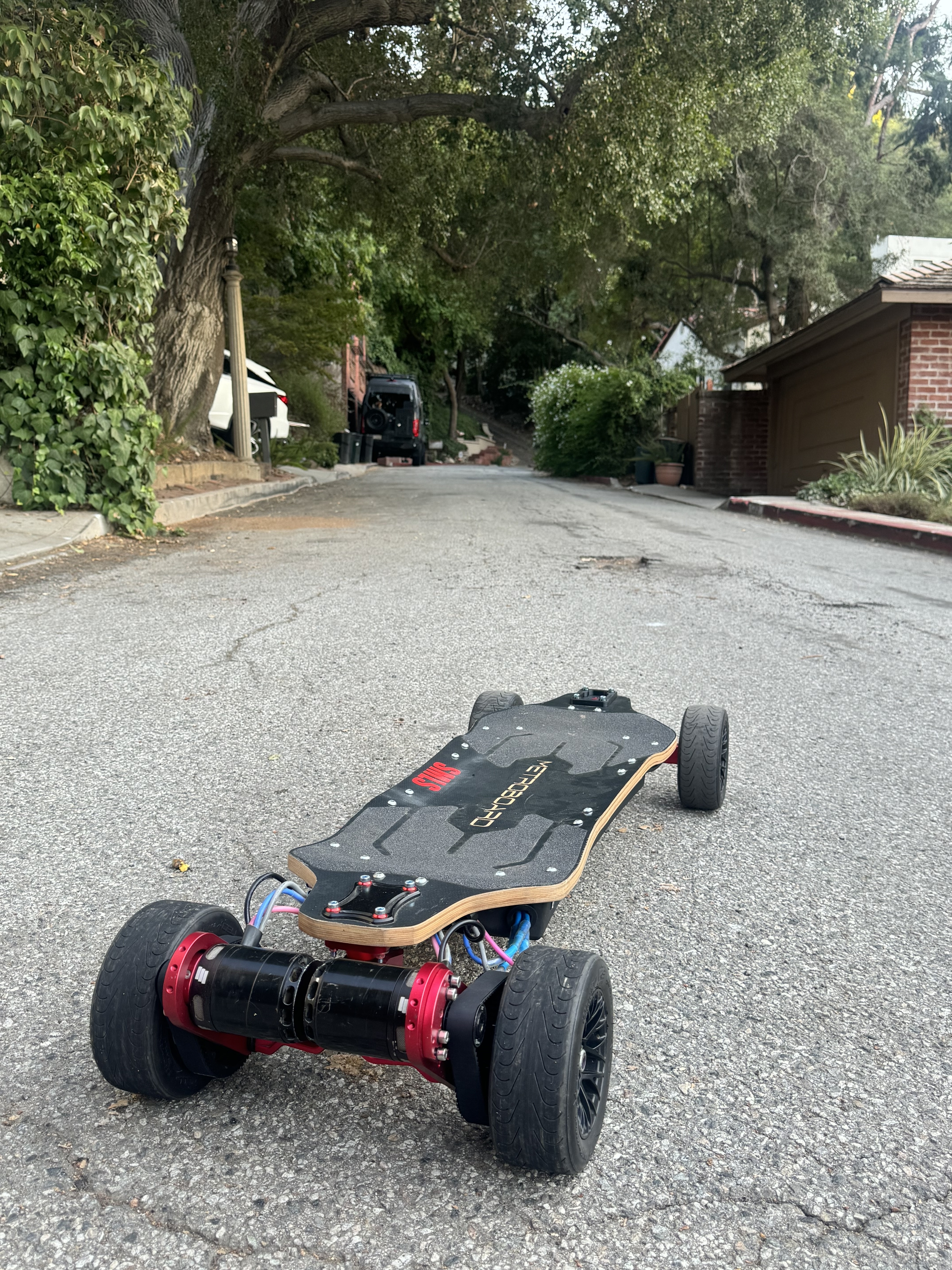

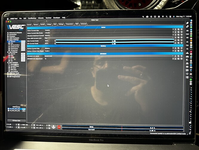

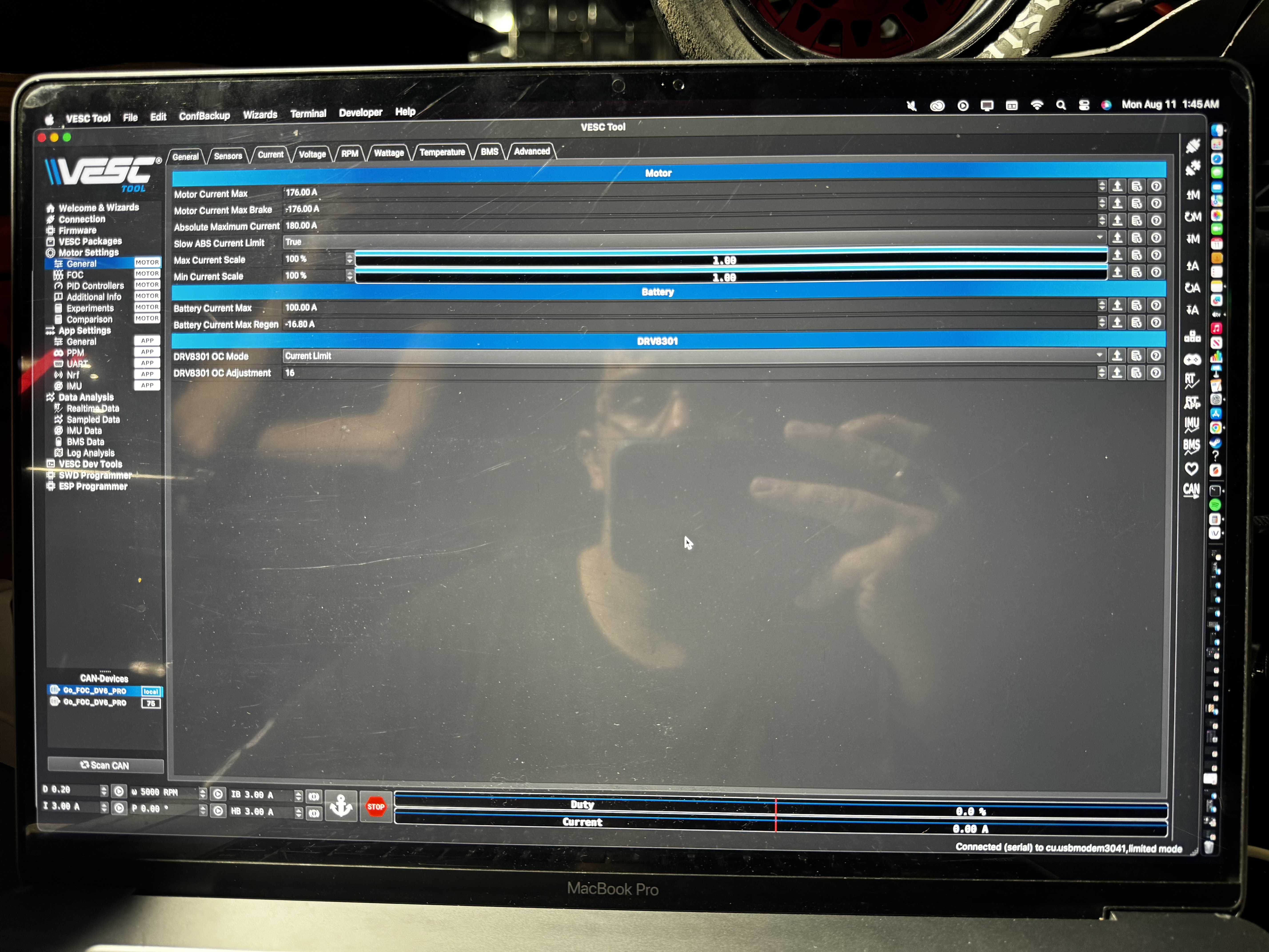

Officially running max power through this bad boi
Max battery amps + max phase amps :blush:
I might take it for a beach cruise tonight maybe I only did like a two min run on it.

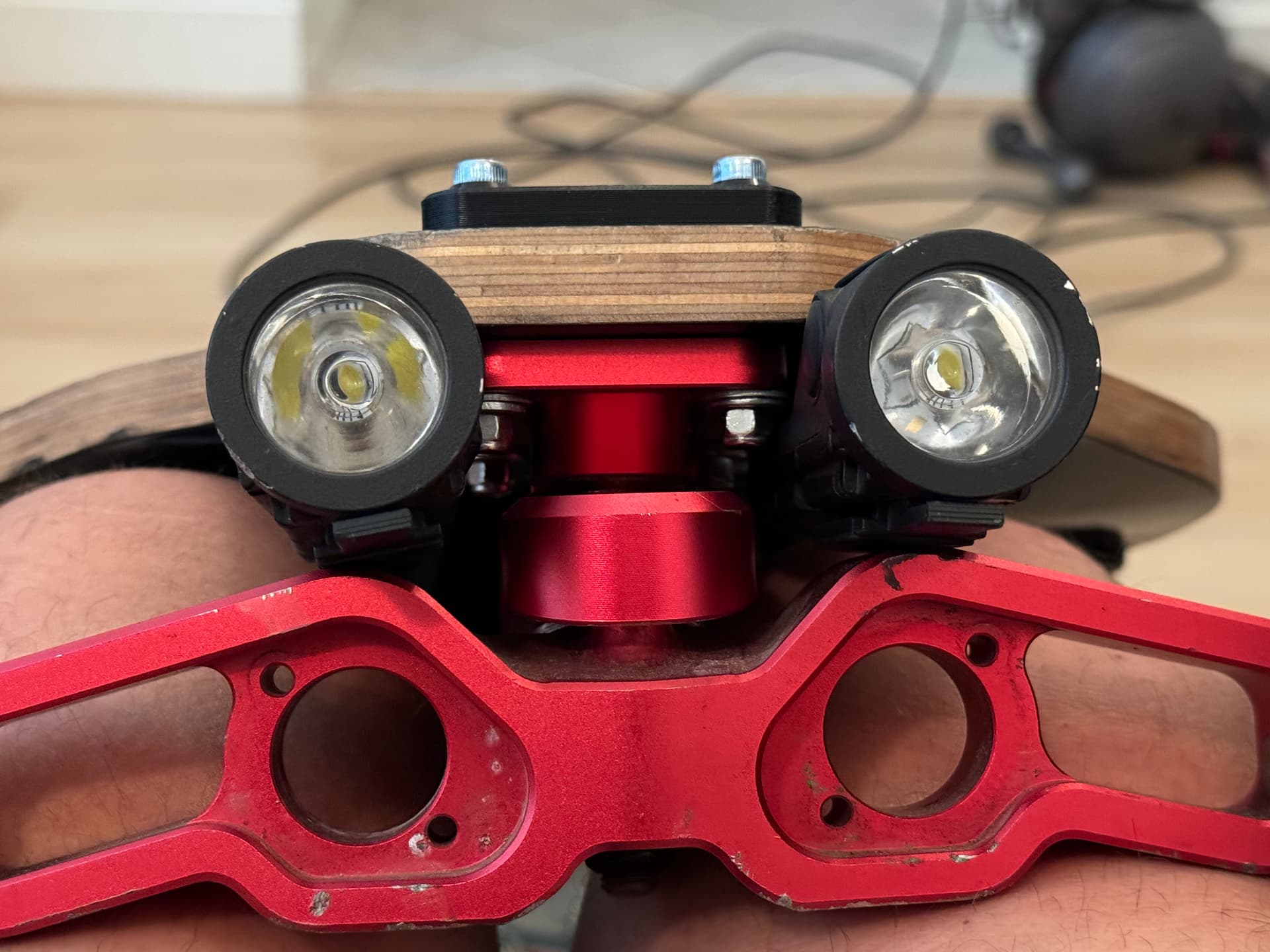

Gonna rip these little shred-lights to pieces design headlight cowls for them.
Shove the bulb reflector into these holes and it shall be retrofitted for success
Gonna run a small auxiliary pack to both of these lights in the tiniest pelican case known to man. :joy:
