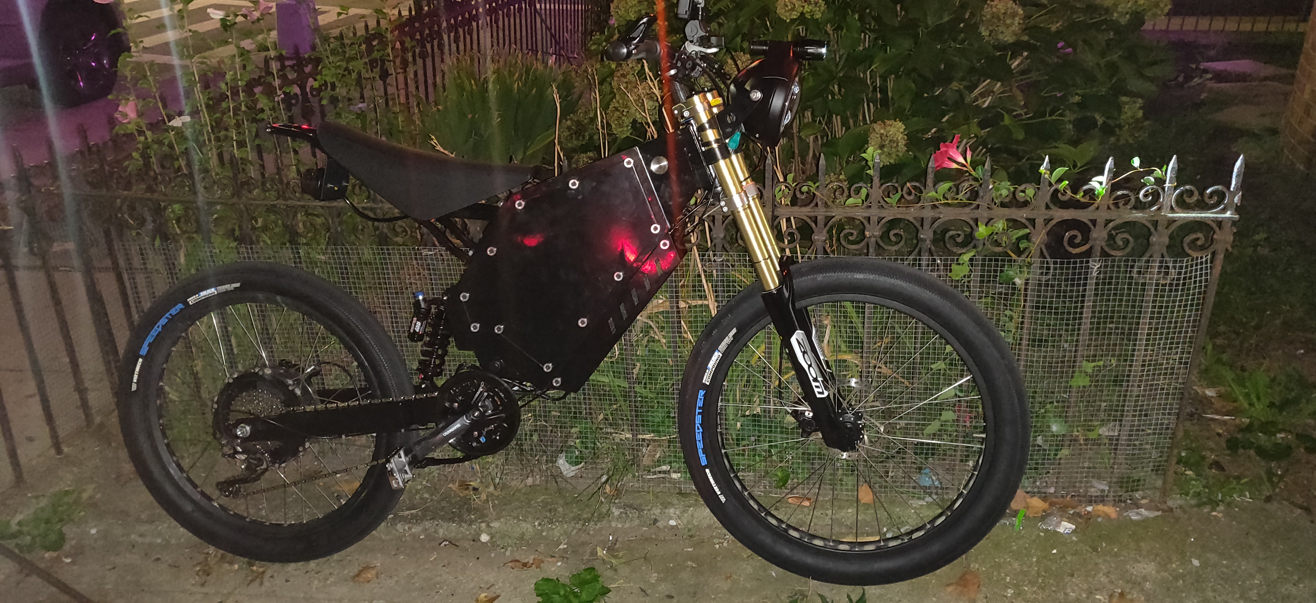

STOBA Bomber 5kW "eBike"

Got chain, derailleur, shifter installed and tuned, many thanks to @abusfullofnuns for donating the derailleur and shifter and a lot of time helping me get it setup :kissing_smiling_eyes:
Got torque arms from @hummieee and installed those too, not really needed but definitely doesn’t hurt to have :yum:
Drivetrain is officially complete
Upgraded the shock I had already with a DNM Burner-RCP 2S(750lbs spring)
got front brake installed and dji pocket mounted
everything but the lights is installed and setup :grin:
24S BMS and charger onhand, guess what happens next :stuck_out_tongue_winking_eye:

I can actually sit on it and my feet reach the ground, that was previously an issue, made stopping… tricky lol

it’s f$&$&ing ready to goooo
just came back from first ride on full setup, simply magical

Lighting is done, I never wanna do it again lol
