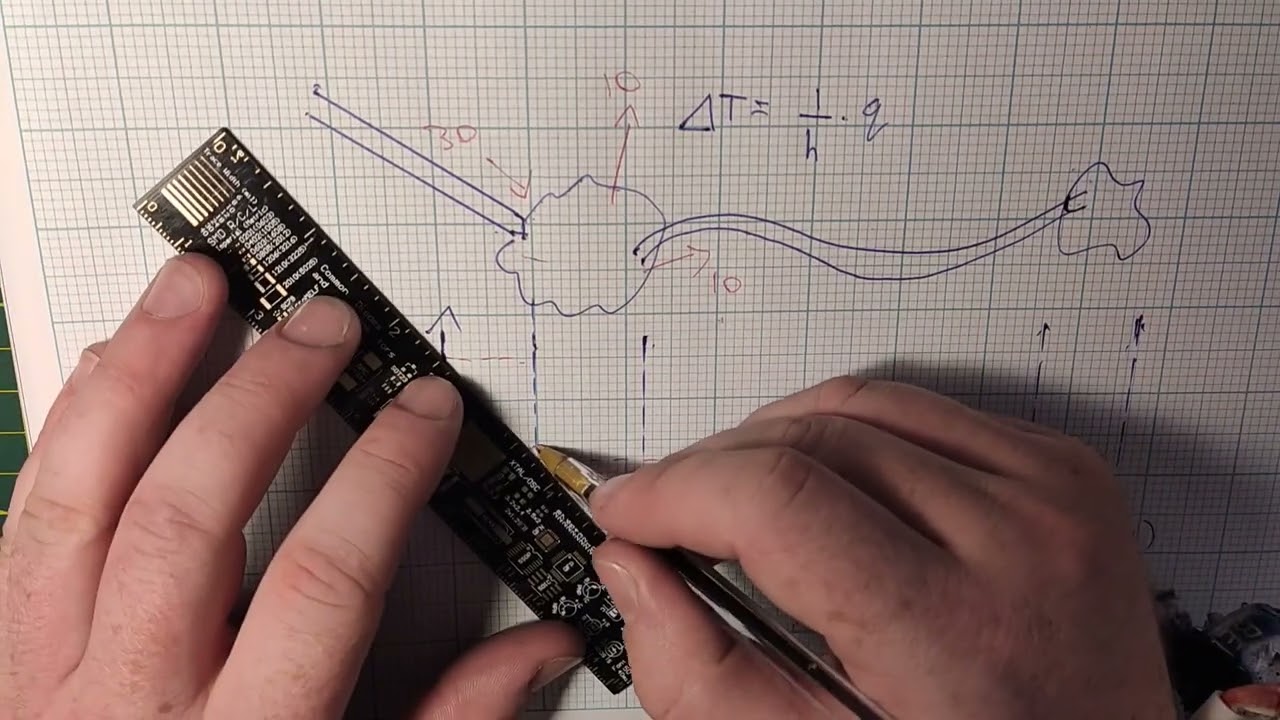

Heyo so apologies for the 10 minutes, I made a couple of attempts and they were all similar length. This was last night and the only insight I’ve had since then is that thermal resistance would probably be better described as reactive impedance; ie resists current but doesn’t generate heat loss
You can see how it was mounted in the first post.
I think we can both agree that heat comes from power.
We should also both agree that power is the product of voltage and current and thus, increasing either variable while keeping the rest of the factors the same increases the net power going in to a system. Power being the rate energy is moved, more power = more heat transfer potential.
I agree, so a larger temperature difference would be analogous to a larger voltage difference.
At the end of the day, I’m sure with enough time, it would get hot regardless.
