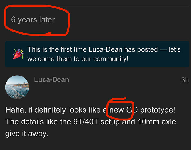

Haha, it definitely looks like a new GD prototype! The details like the 9T/40T setup and 10mm axle give it away.
:woozy_face:
