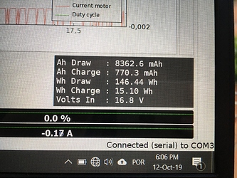

Well, that was a bit disappointing, only 10% of energy back in the pack, from the simulations I was expecting something around 30%
Also the breaking is nowhere near enough to avoid using the disc brakes, but it can prevent you from speeding up on a moderate hill, if I have the courage I will open my board and take the Metr module from a more detailed analysis

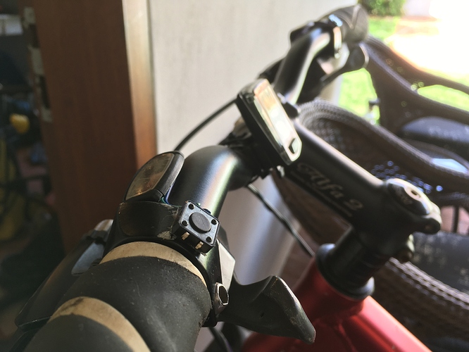

Now I have decent buttons, but having it to lock on assist after a single press is a must, my thumb is numb from holding it all the time

In case it helps - I’m using a force sensitive resistor module to control my throttle. It turns 0-5kg force directly into the 0-5v ADC signal so no extra wiring. https://www.aliexpress.com/item/32830267123.html?spm=a2g0s.12269583.0.0.1de237a5SDHRKl
You can use it as a button like your existing setup, and can set 1v or so as max throttle in the VESC so you only need to touch it lightly (no sore thumb).
