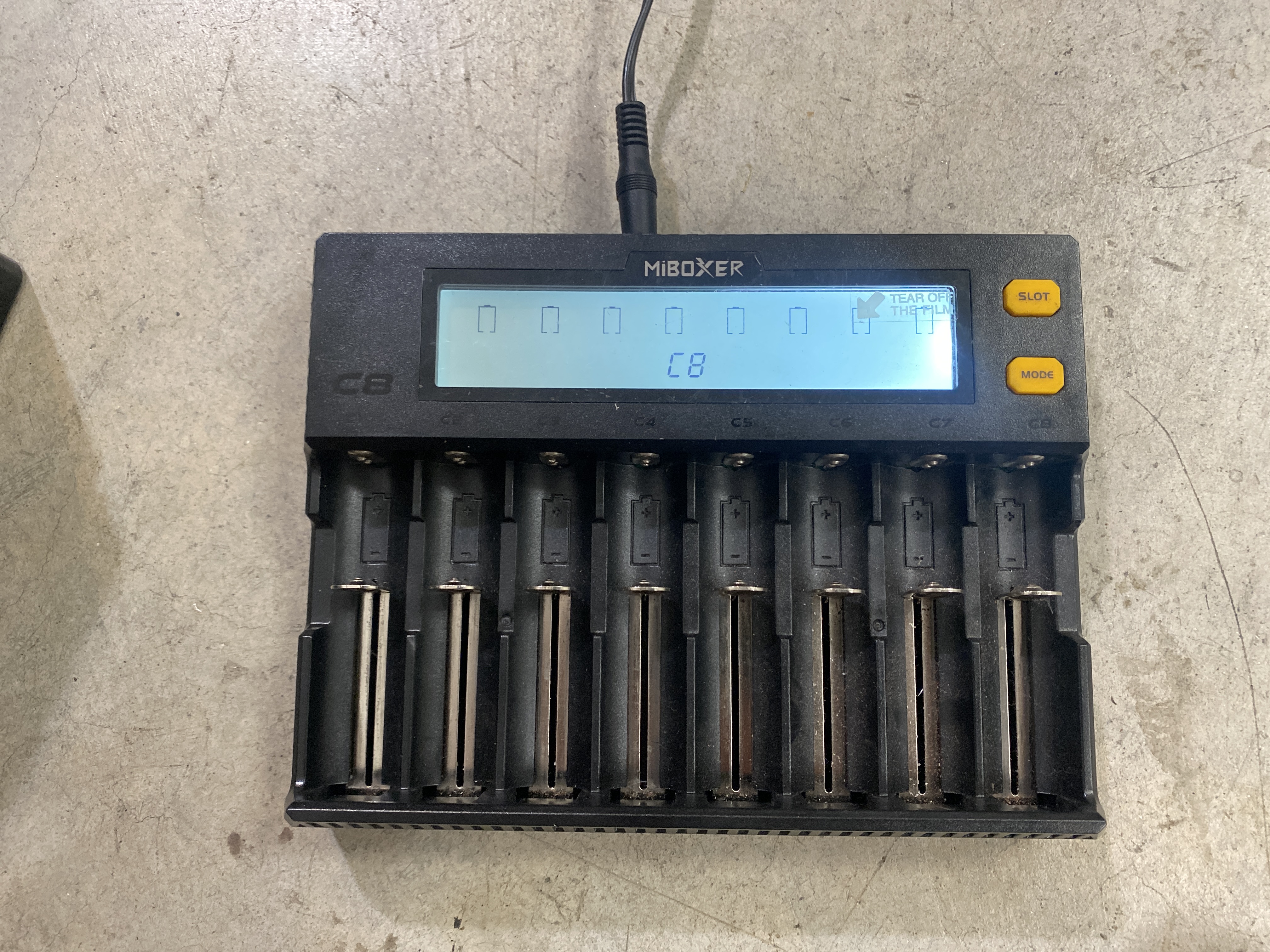

We’re u asking about these?
I didn’t like this one.
Yeah honestly lygte has much better tools to compare graphs compared to what mooch was doing. And he tests wayyyyy more cells. That website is quite the goldmine.
Nope that ones shit. There’s seriously like 3 chargers you should use to capacity test cells. Either that or DIY it yourself.

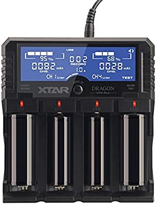

Or xtar dragon
Every other 18650 charger is useless for this kinda shit (I mean there’s a few others but that snot one of em lol) and they cost way to much.
I agree. The opus and xtar brands seem great.
The XTAR Dragon looks awesome, minus the price.

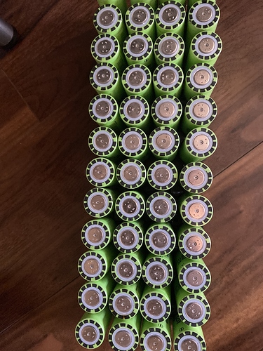

… and despite what I just said above…
They came from battery hook up.
70$ for 48. All at storage voltage, in a server PSU.
I’d love me some 120 of those rn!
I second the range extender suggestion. I sort all my old salvaged cells to be put into range extenders / charge on the go / charge away from an outlet packs.
Lol hey we all like good prices for things, I don’t blame you. I might pick up cells from there before buying new if they have the ones I want.
