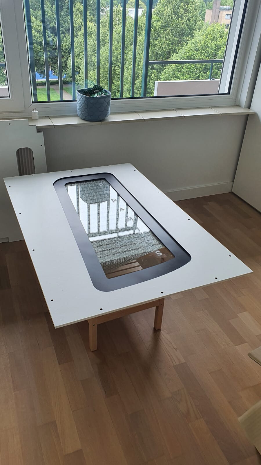

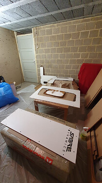

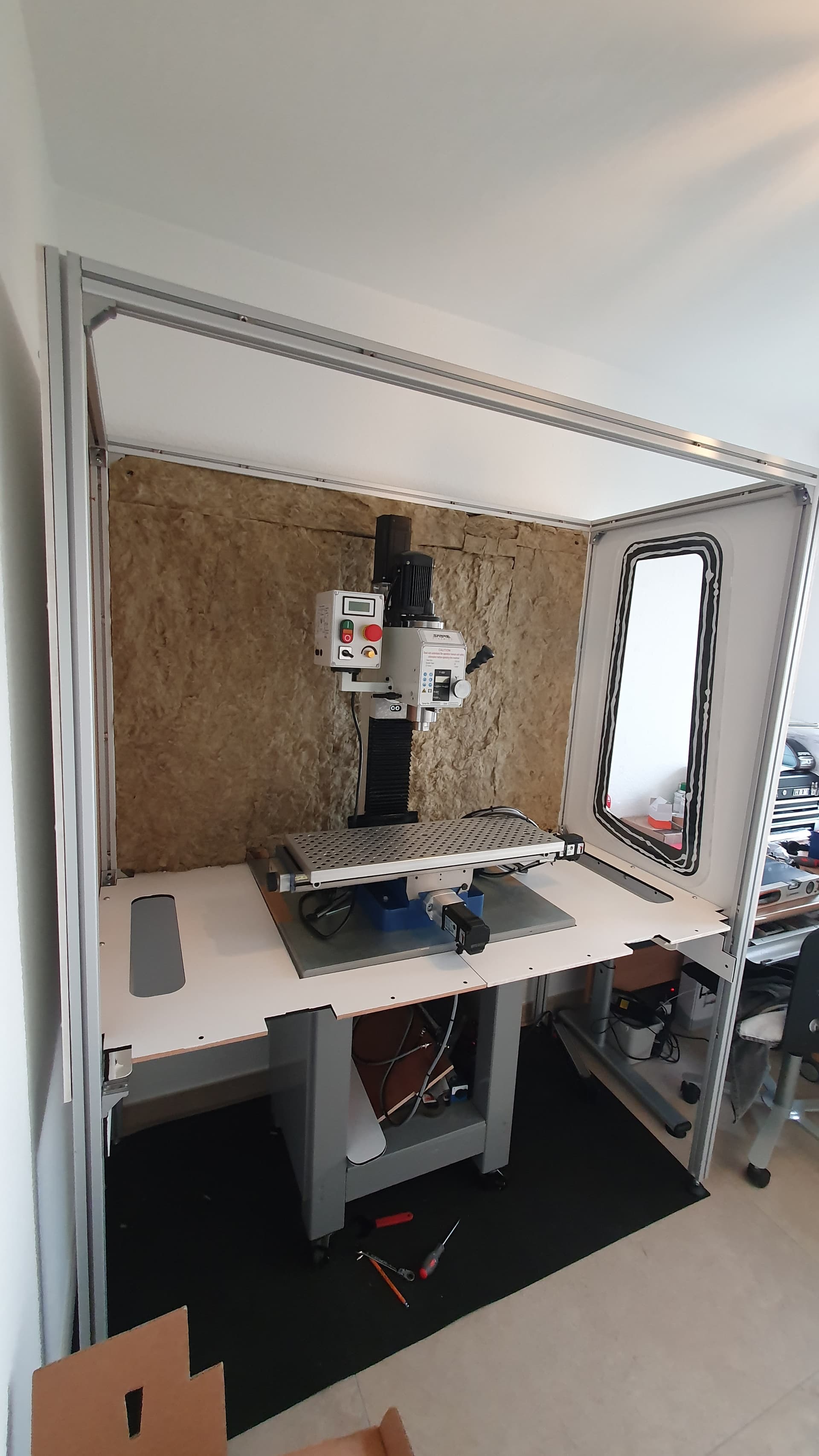

Been moving the complete workshop to the new place in the past few weeks. We designed a custom enclosure for our CNC mill along with some other upgrades for the machine. Currently in the process of building up and calibrating everything again.
Enclosure design:
Progress:

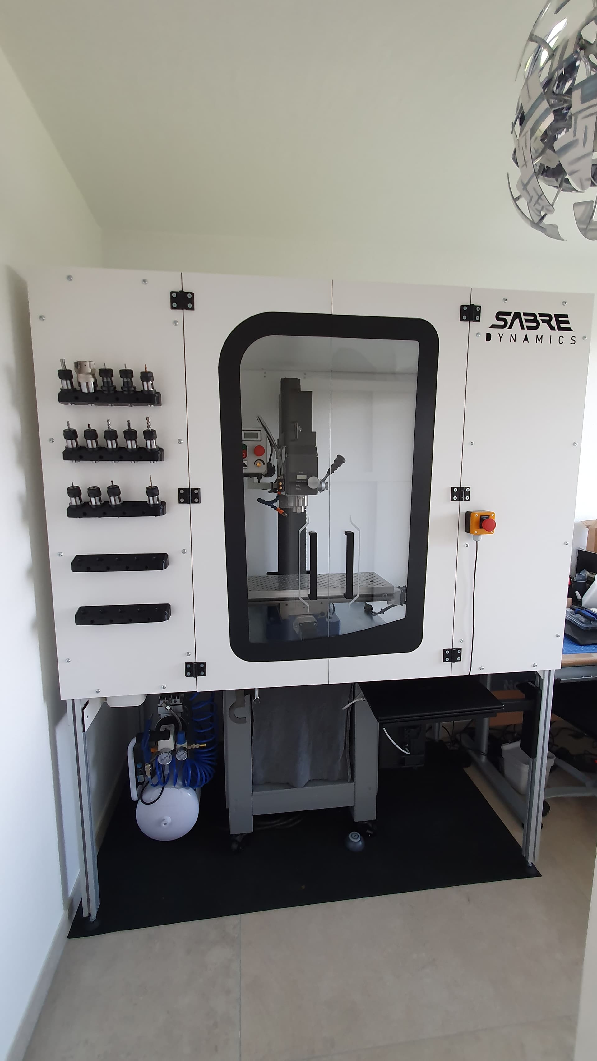

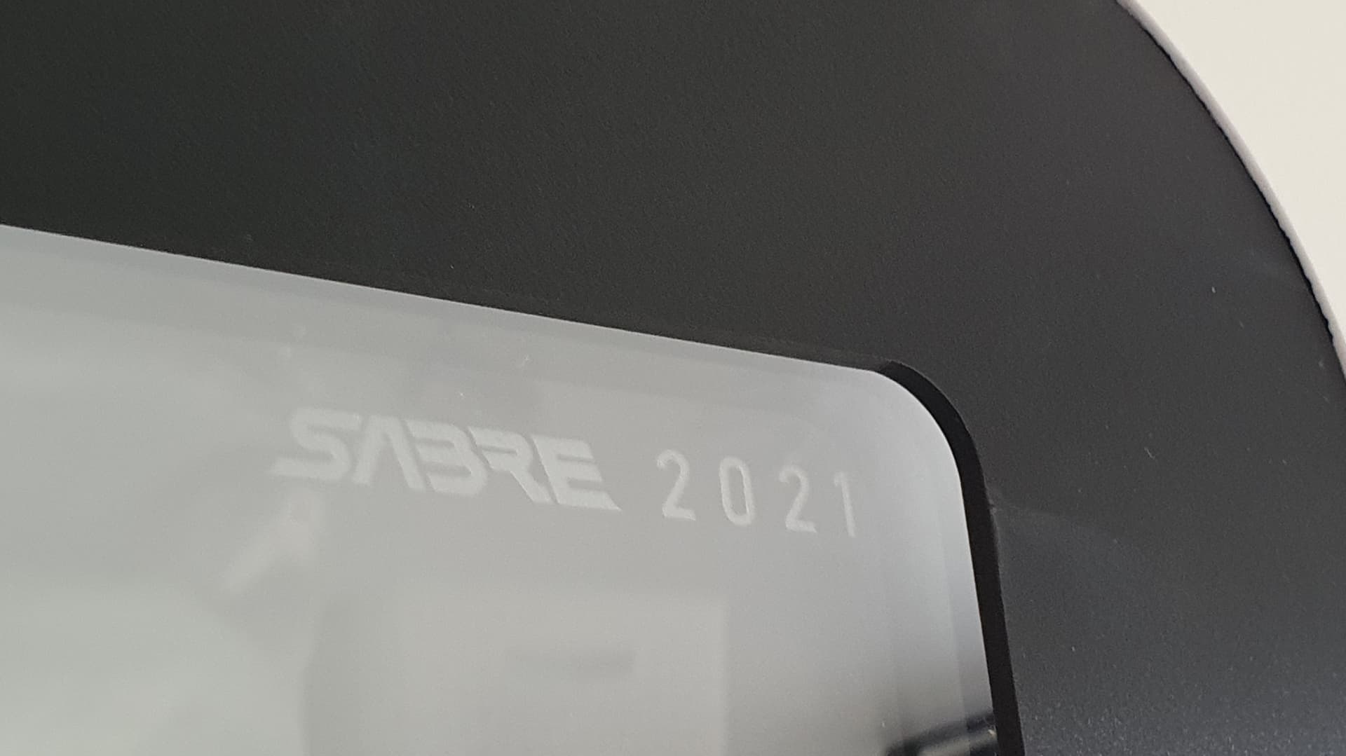

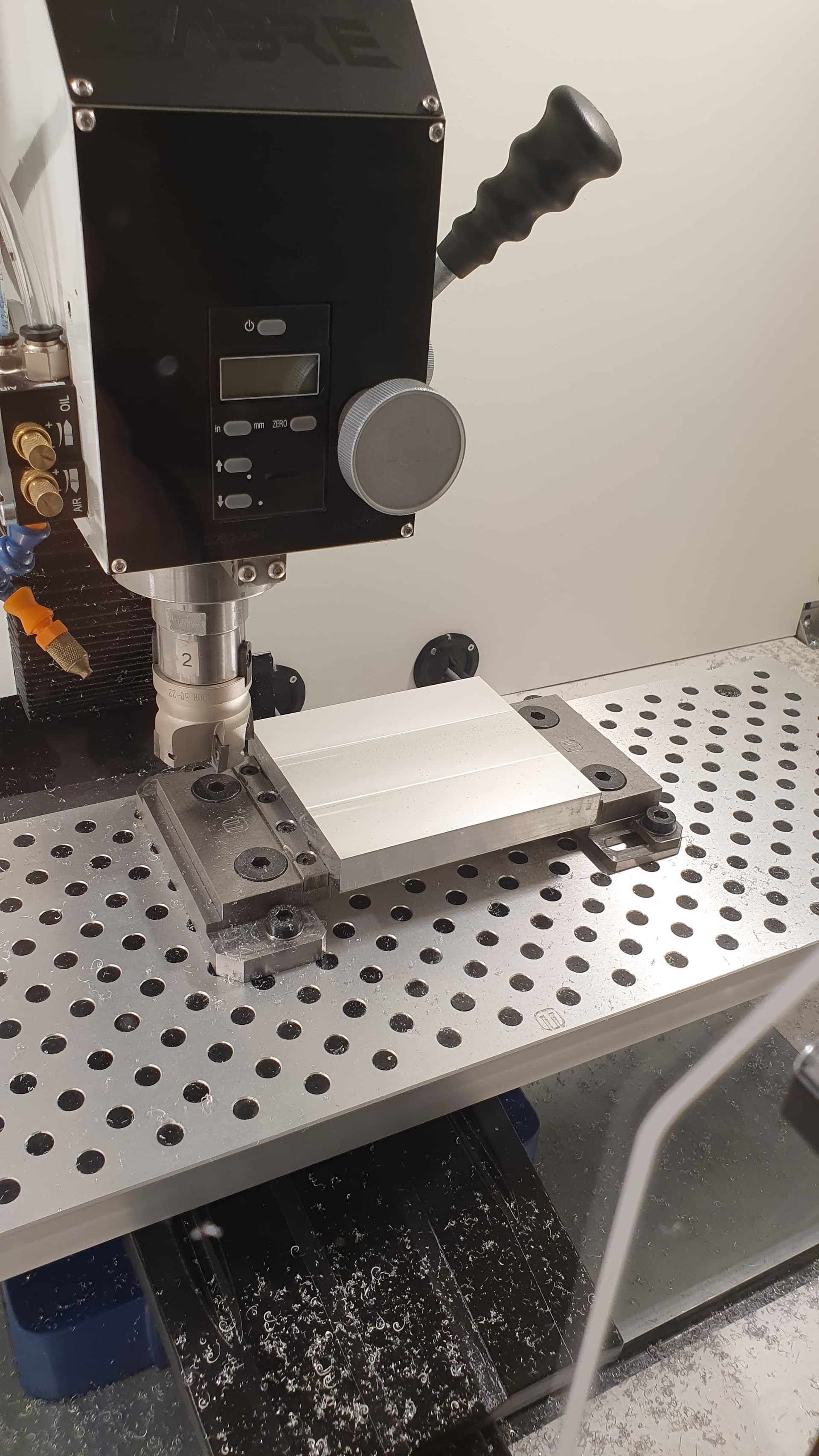

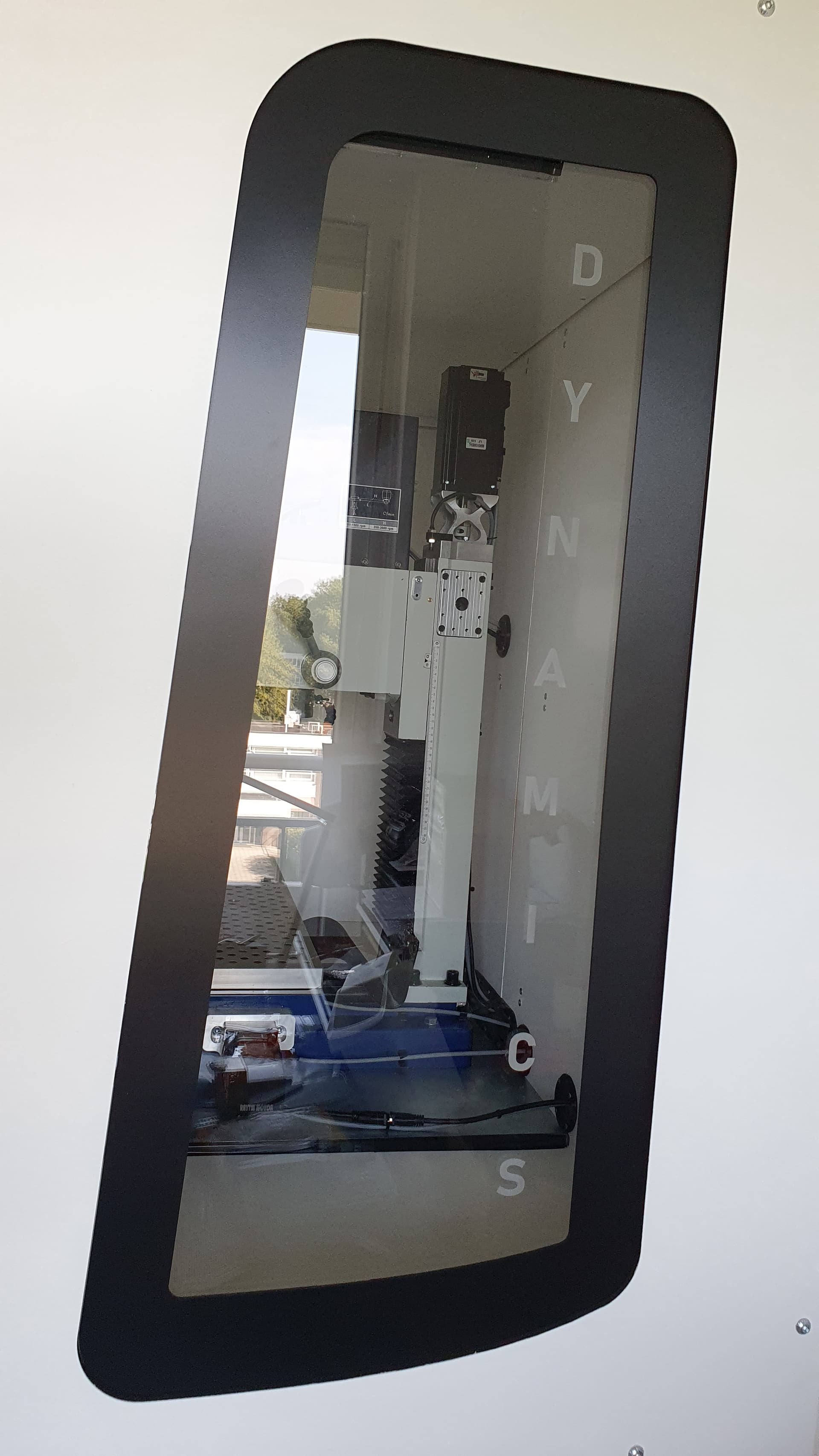

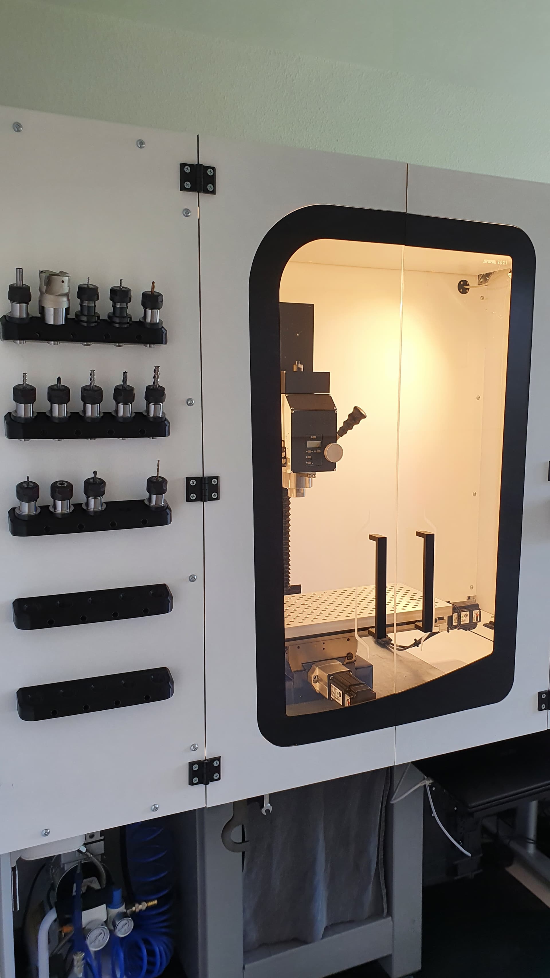

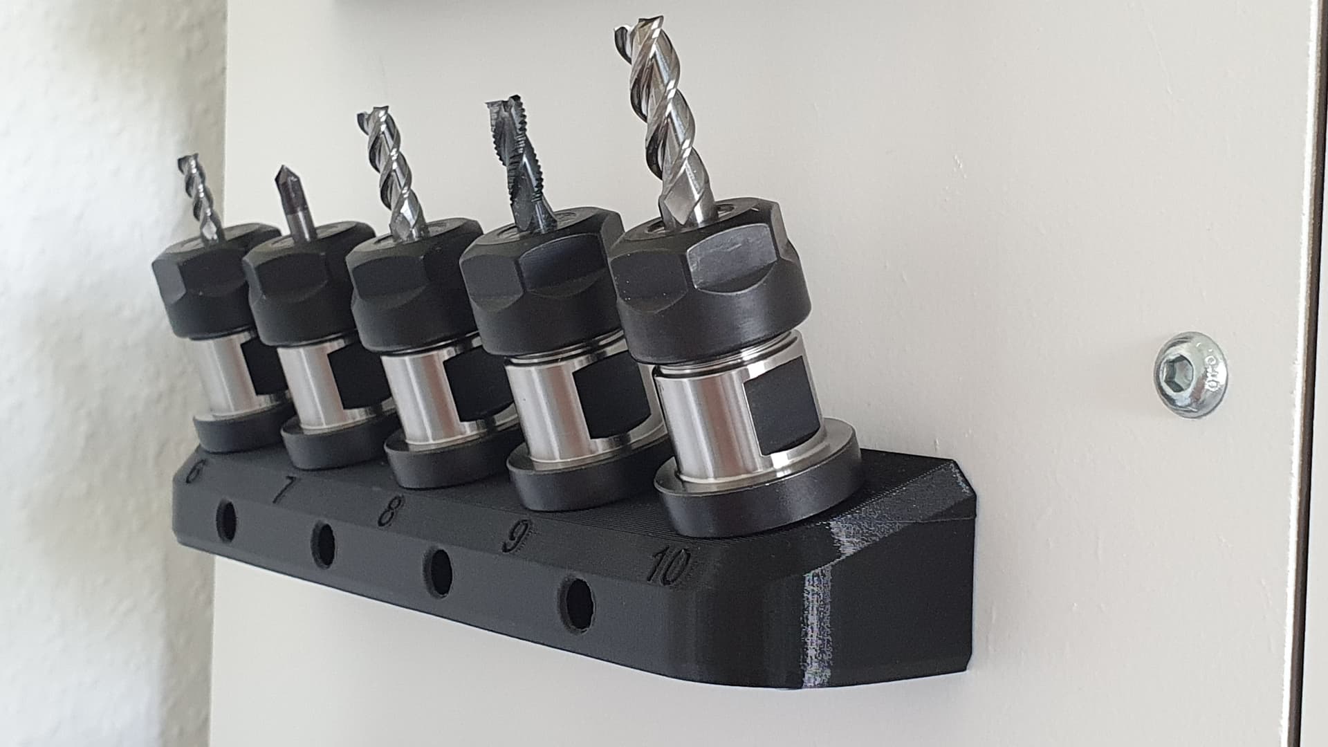

Has been a while since we did an update here. The past few months were rather productive. Finished the CNC/Workshop move, and finalized the custom CNC enclosure build at the end of summer. Took a while to finish it but worth it, it prevents making a mess of chips on the floor and it insulates the sound well. The walls are double panels with rockwool in between. Construction is made of 40x40 aluminium profiles, and the panels were laser cut and engraved on a CO2 laser. Afterwards they were painted in a durable coat of white paint. Lots of 3D printed accessories and mounts added too. Got two flood lights installed too which are so nice to have. Next we still have some upgrades planned like cable management, probing, spindle rpm upgrade, automated mist coolant system etc.
Here are some pictures:

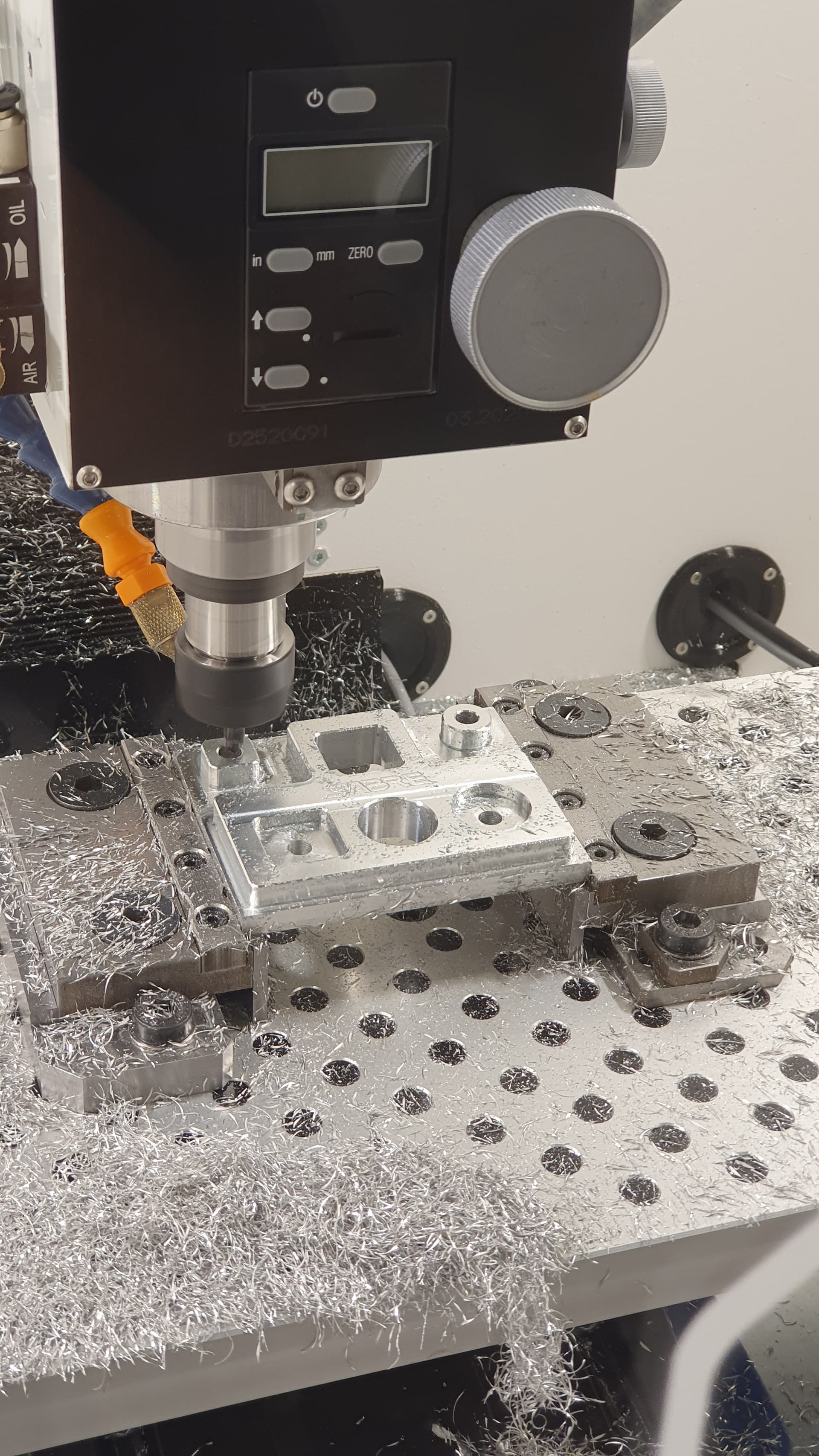

In the meantime, we have done some custom work for people which was a blast, learned tons and got a lot more tools in the arsenal that were needed for these jobs and can be used in the future too. We have some more jobs planned that will be finished soon.
Some pictures of custom CNC work:
E-GoKart parts for @PixelatedPolyeurthan

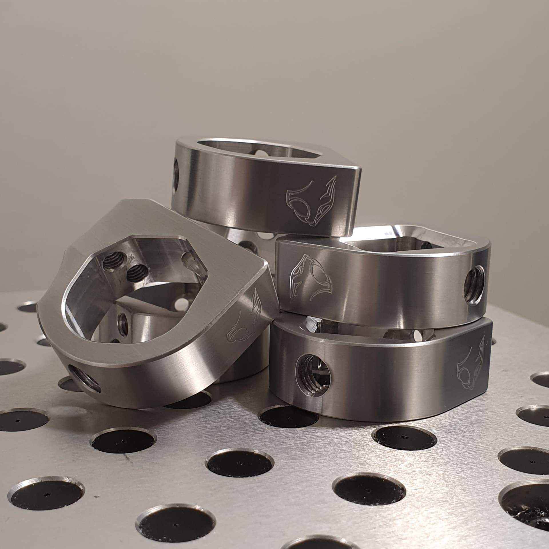

Light Mounts for MBS, 3D servisas and Trampa trucks made for @Esk8freaktal

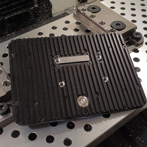

Heatsink mod for @brown5tick
