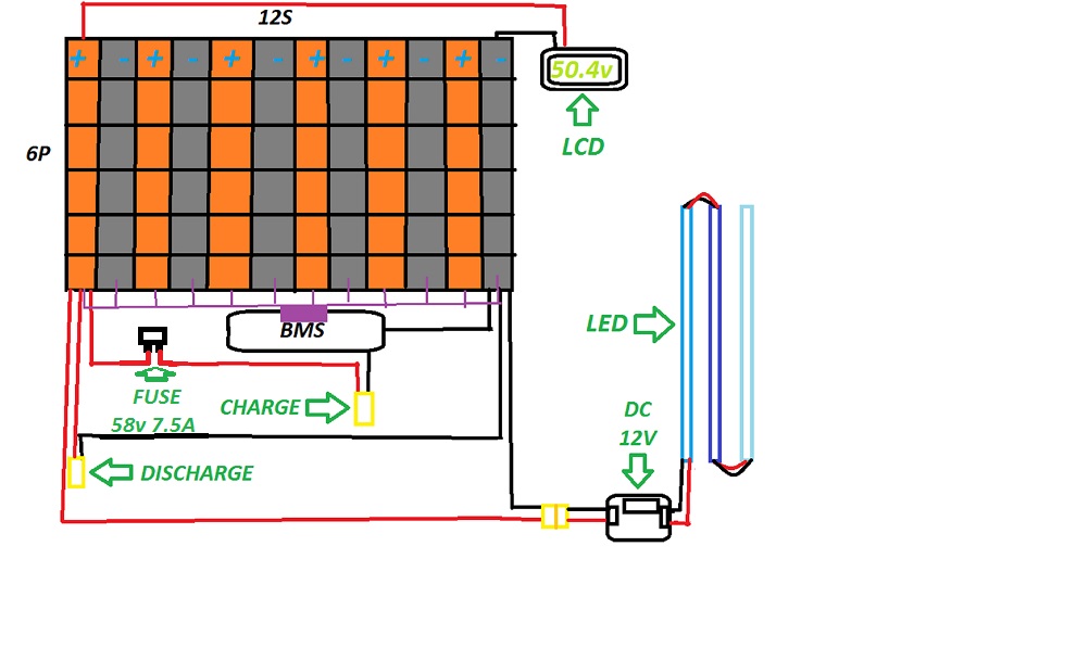

I’d hope for a 4p battery in double stack, maybe 2p 40t single stack for lightweight build?

It needs to have a minimum of 12s4p so whatever size deck would go. I think the 38 you have there would be ideal. I would rip that from you in a heart beat. Whats the enclosure set up on that thing? Fully incorporated or half and half?
I have a 31 inch board and a 34 inch and both are confortable to carry around and im 5’11"
A 3p battery has always been my go too as I can usually get 10-15 miles on it which is enough.
If you shoot for 10S5P, that will also hold 12S4P

Should be able to use the same enclosure actually. I’ll see. Was going to have a 12s4p/12s8p enclosure. 12s4p first with just cut outs for charging port, lcd, on/off. That way they are universal for battery pack builders as well and for anyone else that wants to build a custom enclosure for it.
10S5P is better because if it will hold that, it will also hold 12S4P but maybe not the other way around
I like both of those decks with a passion. Both cuts are fine for the type of battery most people would be chucking in there. I say go with the biggest available space and then let the builder make the decision.
