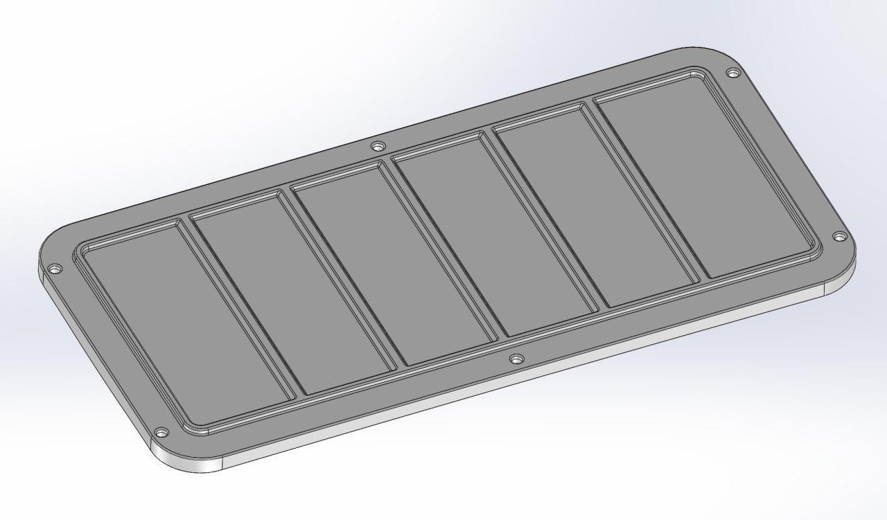

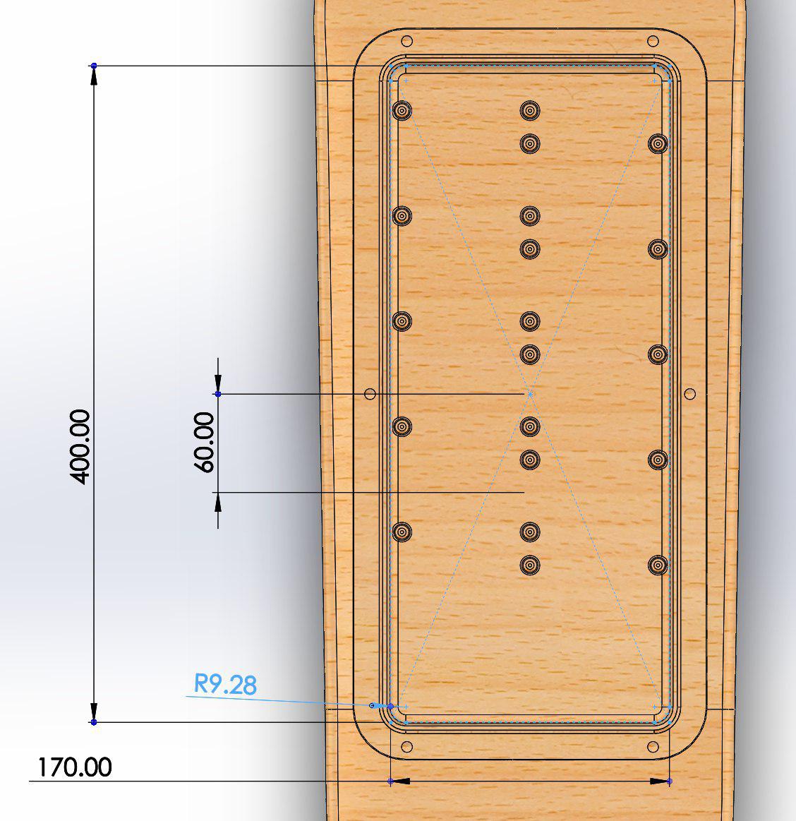

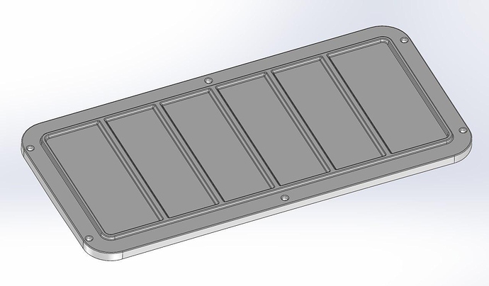

This sizes from enginer
We make deck strong now can stand 100kg lid
  1. That’s the smartest thing I’ve seen all week
  2. I think it’ll break as soon as you make a turn :confused:

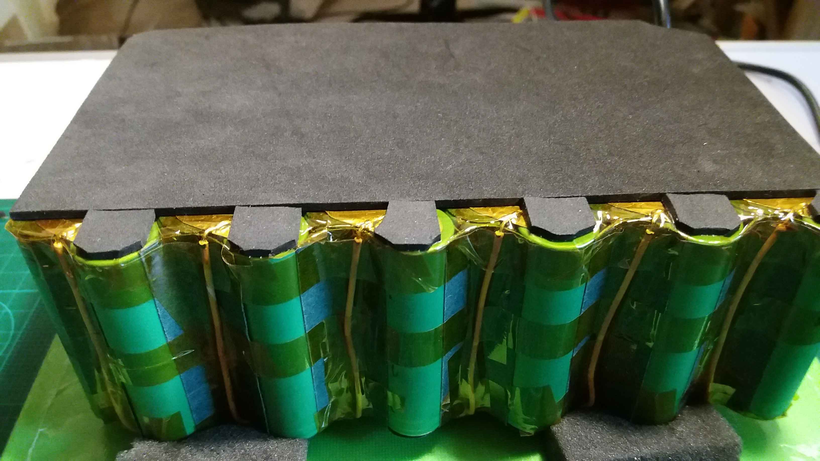

DAMN @rich that is very, very well done
Thank you very much :grin:
I was in a hurry and couldn’t do everything like planned because of the big BMS and I wanted to keep it modular for the future. Originally I planned to have all wires on the sides but that was not possible.
It would be better not to solder the balance wires on bottom because you gain height, in my case no problem so I used 2mm neoprene foam
The good thing is that I could change all wires if necessary. Desolder 16AWG and 22AWG wire is easy.

Excellent work!
Thanks man :blush: yeah send them :joy:
Actually this is my first spot welded battery pack ever, soldered a flexible 10s4p before (shame on me) and used lipos with BMS only.
But I can do it better so glad you like the first try.
