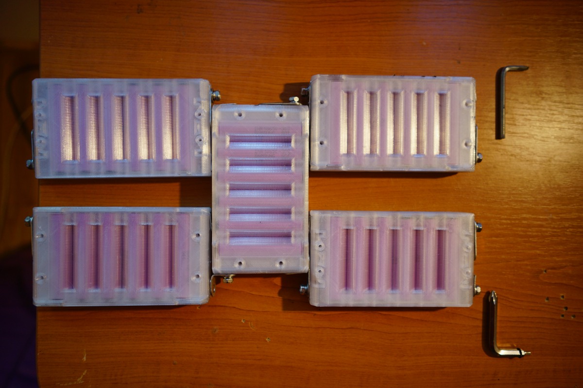

You can get more space by rotating the modules 90 degress and alternating. I’m doing a 10s3p like this:
Alternating ? How would it work with the Bus Connectors and caps? (I’m planning on using NESE Modules.

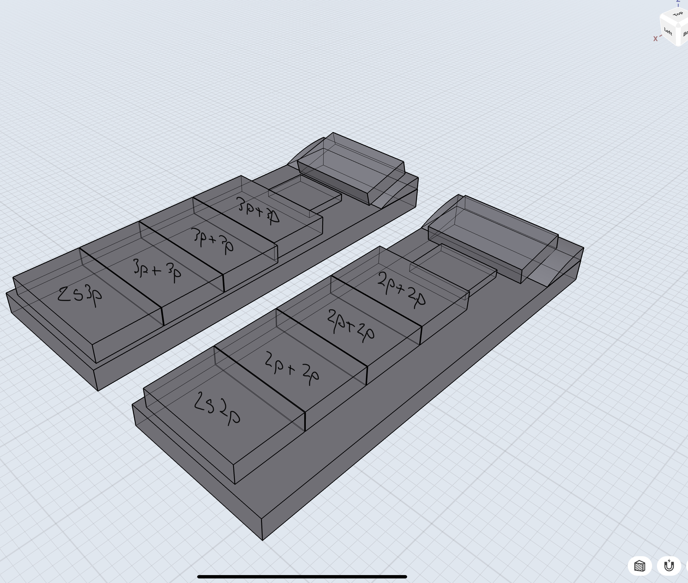

Though looking at it now it seems that I didn’t read it correctly. the first 5 modules were 4P + 4P with the last one being 2s4p.
SO instead Mine Should be more like:
right?
Could you show me na illustration of what you mean by alternating?

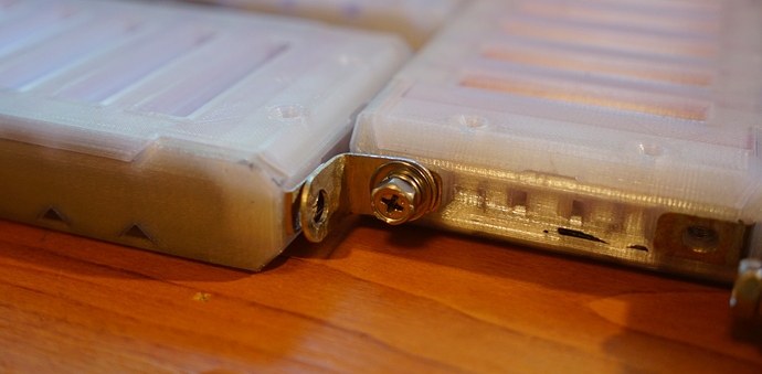

You bend the bus connectors, and the plastic caps won’t work really :stuck_out_tongue:

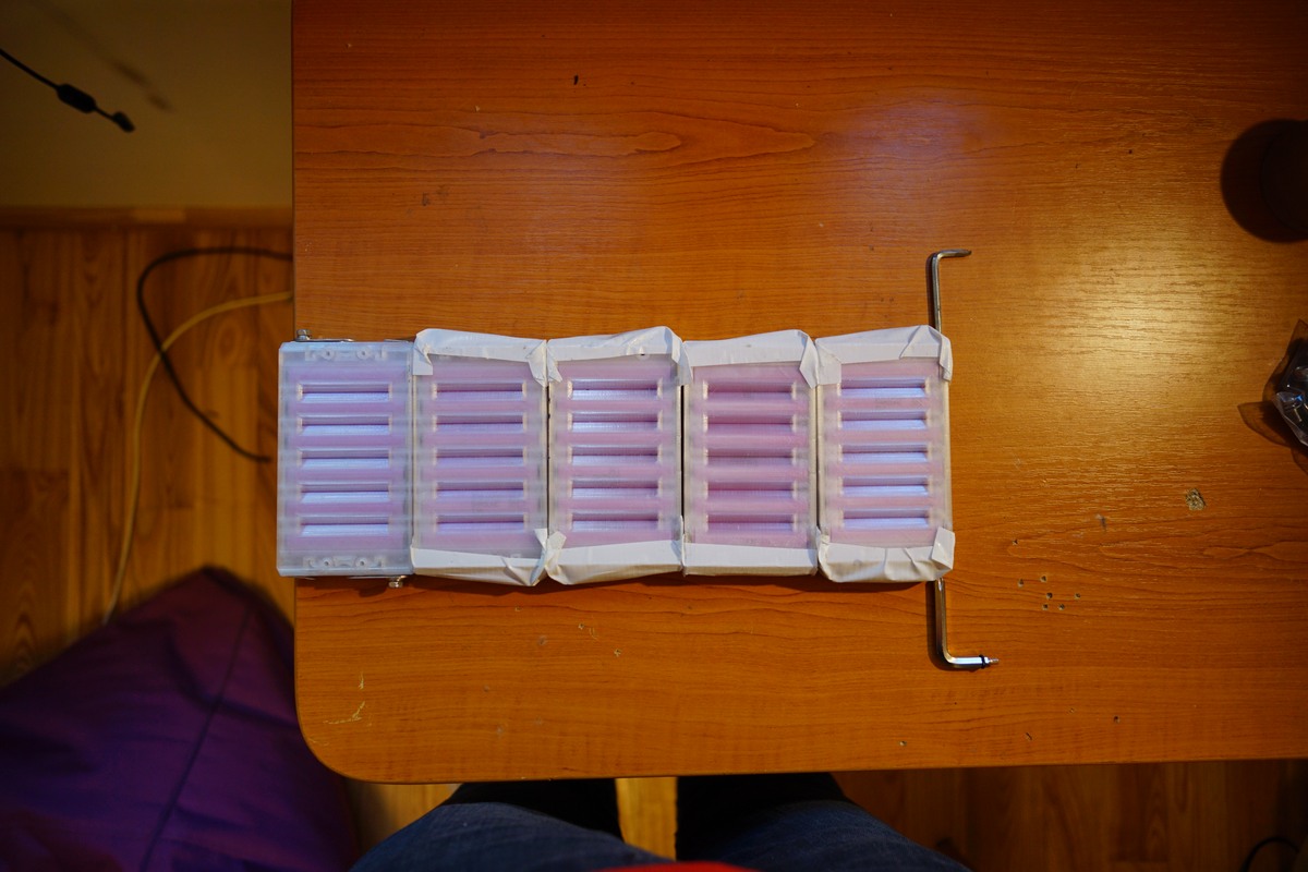

The hex keys show how long a pack done the normal way would be for reference.

I’m not able to import files yet since I’m still waiting of my student credentials to go through so the ports of where the connections go are wacky, but should I assume the compartment will look like this?:
I’m a bit confused about how theater connections play with the rest of the arrangement
is this a xP + xP pack in the middle with the outer NESE’s being 2sxp’s?
edit: just noticed I labeled the positive and negatives wrong, fixing now
Yes, middle pack is 3P + 3P, and all other packs are 2s3P.

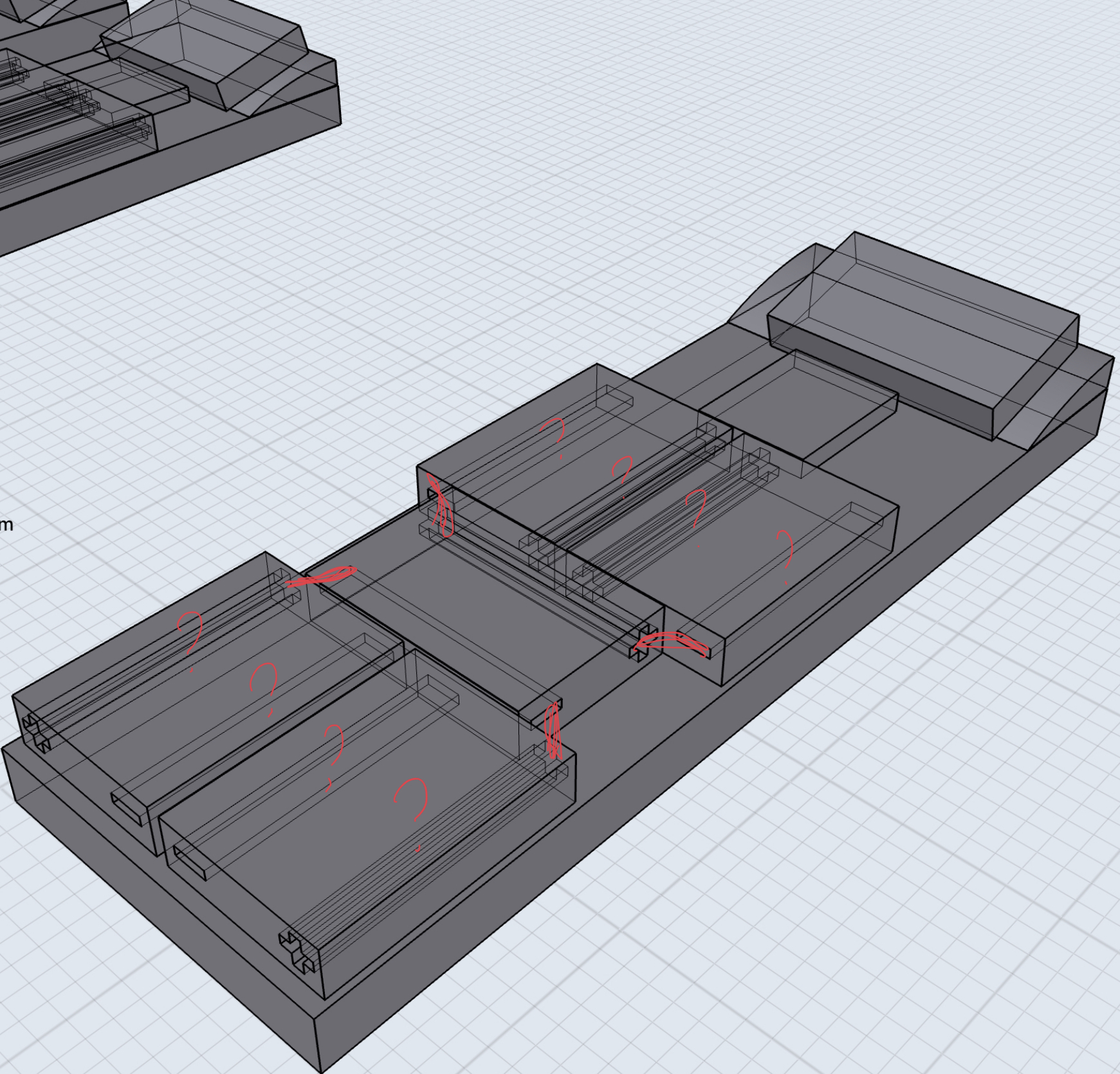

The Positive and Negative Terminals aren’t in the right locations. Once Shapr3d approves my Education License , I’ll import the real module’s or fix the location. If you can measure the arraignment from the end to end I can tell you if it lints and if the 90 Degree is possible (or at the very least the distance from the positive to the the negative.
I can measure for you , are you using the same layout?
For the Terminal touching the middle part are you not going to put a screw on it ? What about the outer Terminals?
Yes, terminals touching the middle get nothing. Outer terminals all have screws.The outer terminals closest to the middle are used for the balance wires.

Fiddled some more. I used 3Dhubs to get a close but still imprecise measurements:
I don’t think a 2s3p Alt Arrangement would fit though:
Two Vertical 2s3p enclosures measure up to 148.4mm (74.2mm + 74.2mm)
According to the dimension by Jeff:
The compartment space for the battery is at most 160.84mm long. that leaves only 12.44mm of play room:
I can only imagine 27100 being bigger. I think I’m going to stick with 8s3p since it’s the cleanest configuration:
