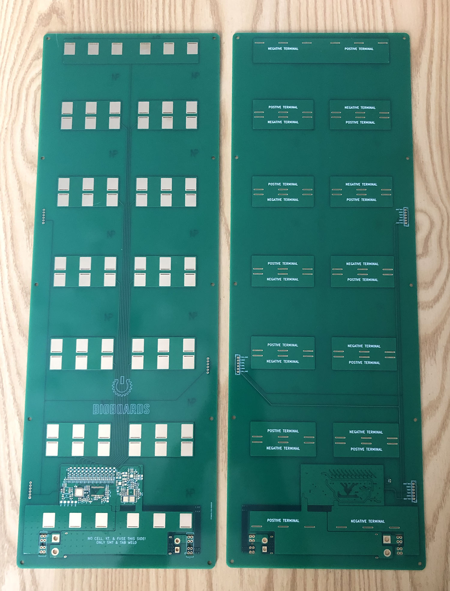

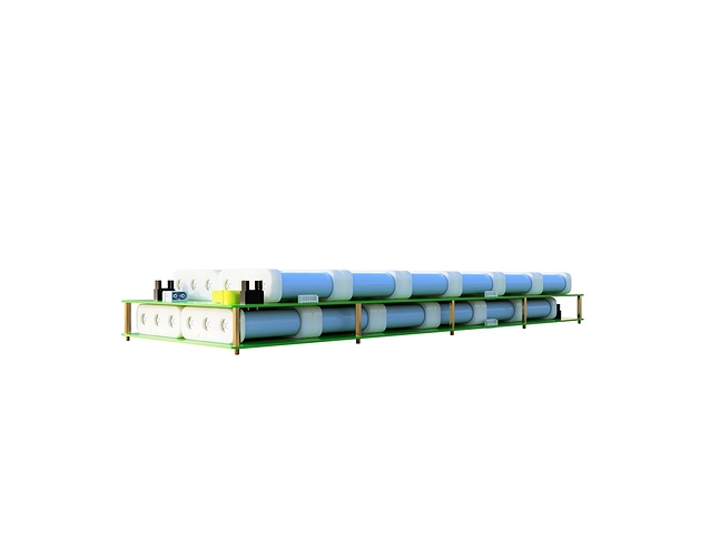

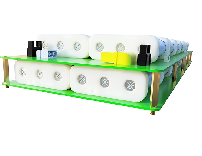

Got any more details on this? With all the pictures of PCB battery assemblies lately I have been wondering when someone would integrate a BMS.
Would be great if there was a way to have similar functionality to the LLT smart BMS. Fully configurable with bluetooth monitoring.
Its a special version of flexi bms connected to the canbus. The pcb also have canbus traces so no need for cable for 4wd.
Battery pcb to make it easy and fast to build batterys!
Have Flexi BMS integrated in the pcb.
Flexi BMS:
Canbus connected
Can read/monitor cell voltage with Metr app or Davega display
Charge only
For double stack use up to 10A charger and for single stack use up to 5A charger
PCB:
Made for 21700 cells Samsung 40T
Comes with precut 0.3 mm nickel
No cables needed for safe and clean install! Have traces for canbus, charging current, discharge current, balance current
XT90 connector on the end to power the Vesc
XT30 connector on the end for charging input
Triple fuse system for maximum safety:
  • Nickel fuse for discharge 60A that is made for 60A continues and 90A burst up to 30 second (12s3p single stack)
  • Discharge fuse 100A (12s3p single stack) – easy swap
  • Charging fuse 15A – easy swap
Can stack on top of each other with canbus connection that connects automatic between the PCB
For double stack (2x12S3P =12S6P total) it will have XT90 on each side of the PCB so 1 12s3P per Vesc for 4wd. If using for 2wd double stack it comes with a cable to parallel connect the 2 12s3p to 1 Vesc
