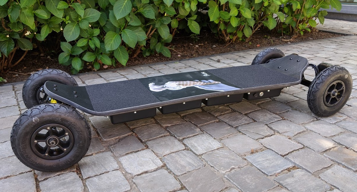

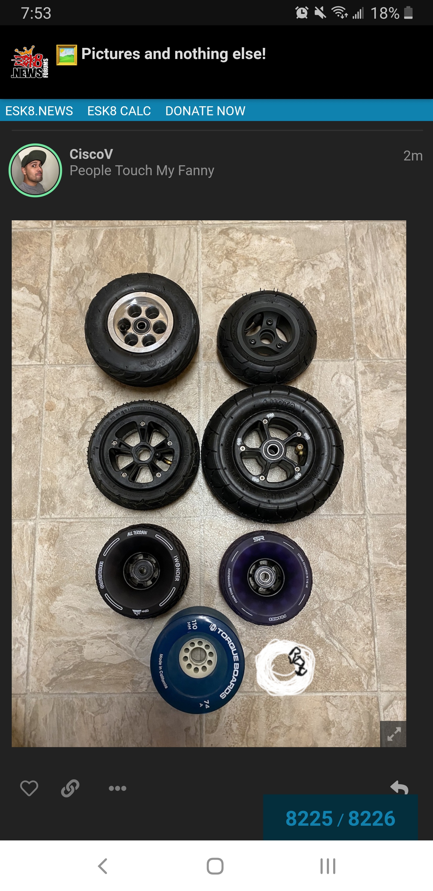

Are those from boardnamics?
Are those Clever tyres?
Nope, metro 155mm… Check out my Ground Control thread and it has a parts list :smiley:
Only if you’re okay with the weight penalty. For me the pro’s outweigh (lol) the cons.
Cool. I’m looking for something in the 150-160mm range. Currently only Evolve 150mm looking to be an easily obtainable option in Australia.

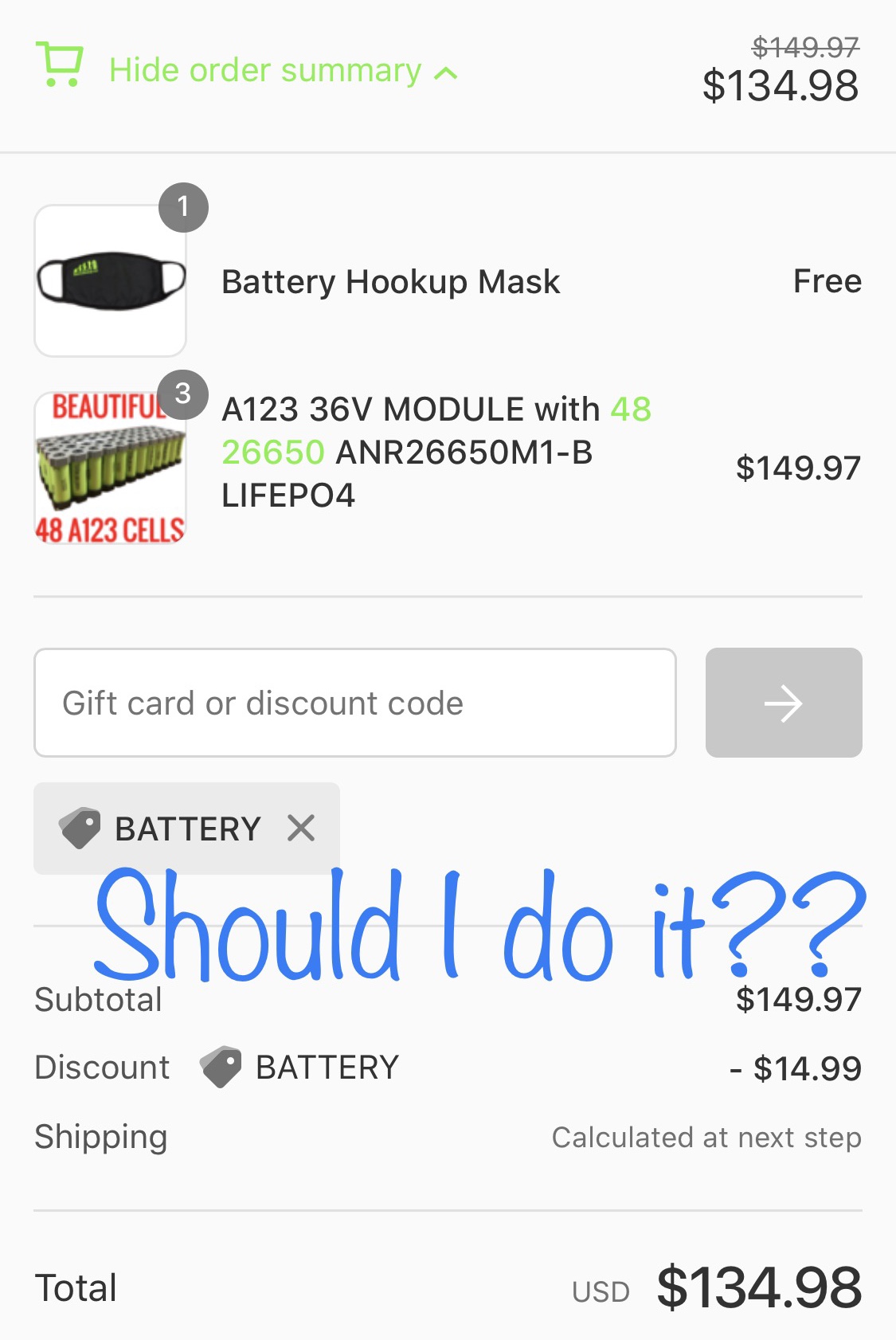

What @malJohann said. The only con to LiFePO4 is range per weight. If you’re okay with that, then they are better in nearly every other metric.
Range per weight is important to a lot of folks though, and they might not want those.
I love my LiFePO4 skates. Recommend.
Ordered. I specifically chose A123’s to learn how to build batteries packs :smile:. Need to pick out a spot welder, undecided between kWeld or Malectrics.
Nothing like knowing you can go blow a whole charge riding at full throttle as many times as you want and not really put any noticeable dent in the battery lifetime at all. #LiFePO4life
And the charge rate is limited mostly by charger and BMS, the cells themselves can take ludicrous levels of fast charging (4C) – for a 12S6P pack that’s 60A (:exclamation:) max charge for 15 minute empty-to-full

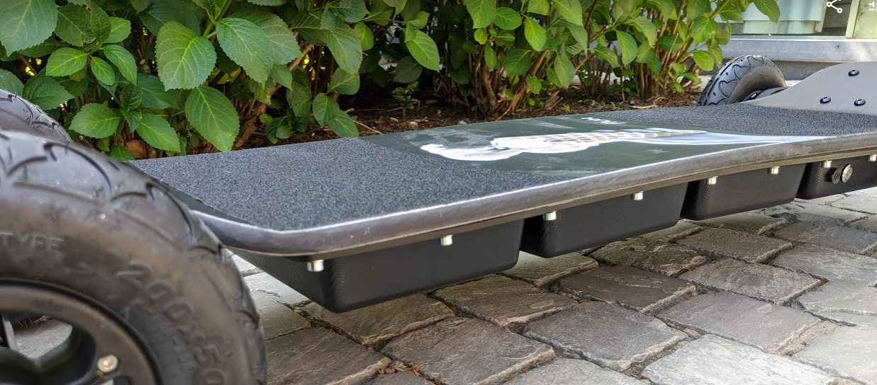

I am starting to think the Haero needs a friend…
How big of a pack can I get in there?
It’s for 12s10p 18650 cells :slight_smile:
I want one!
I will do a Kickstarter for the completes and so some deck + enclosure combo’s aswell :slight_smile:
Love it man. I Would buy this before I buy a boosted haero
Yeah. I’m going to need it… I only get 15 miles of good range out of the Haero with 12s4p 40t…
Woah! That ain’t enough for sure.
12s8p 30q is giving me 25 solid miles on mildly aggressive riding
