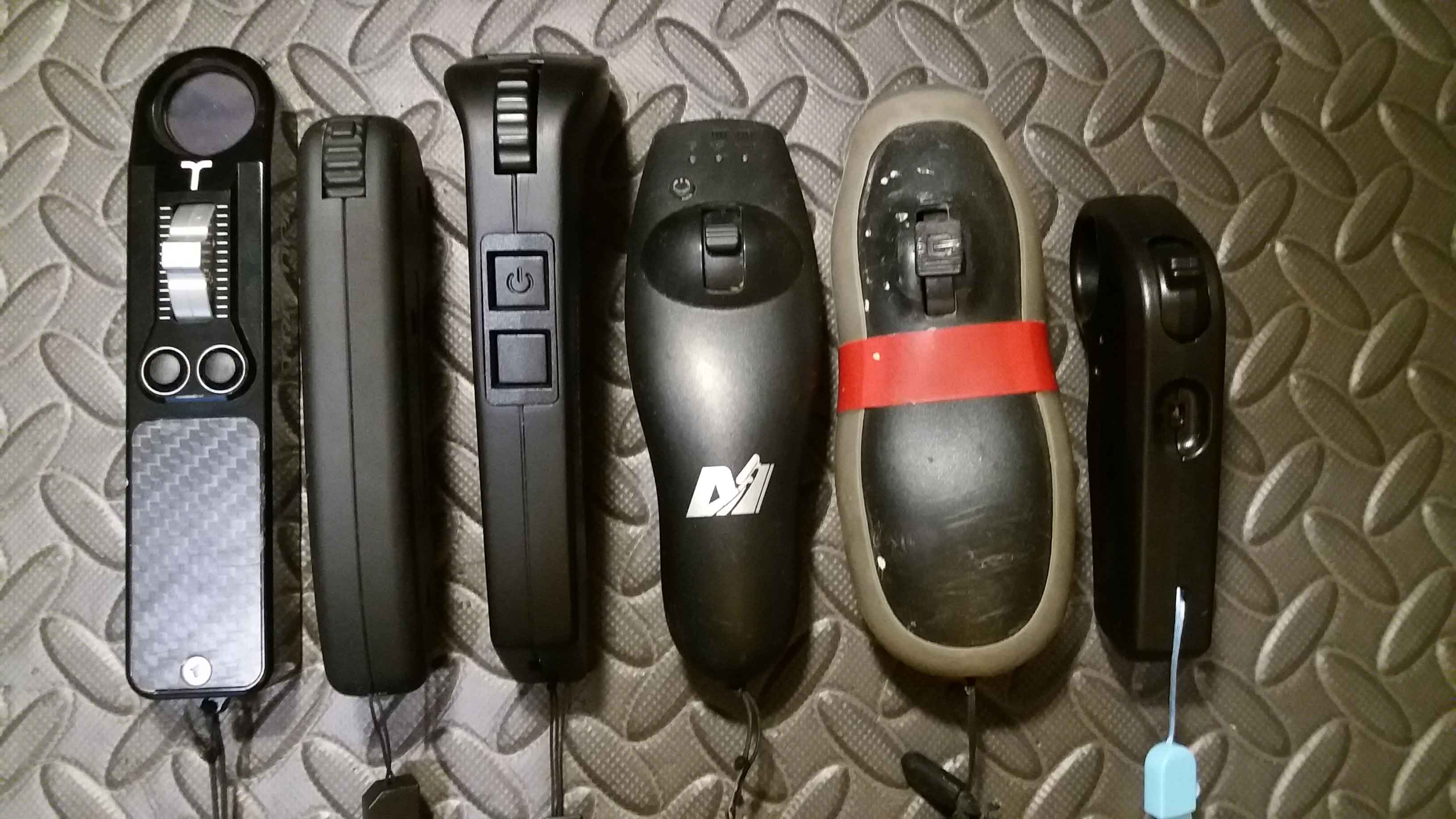

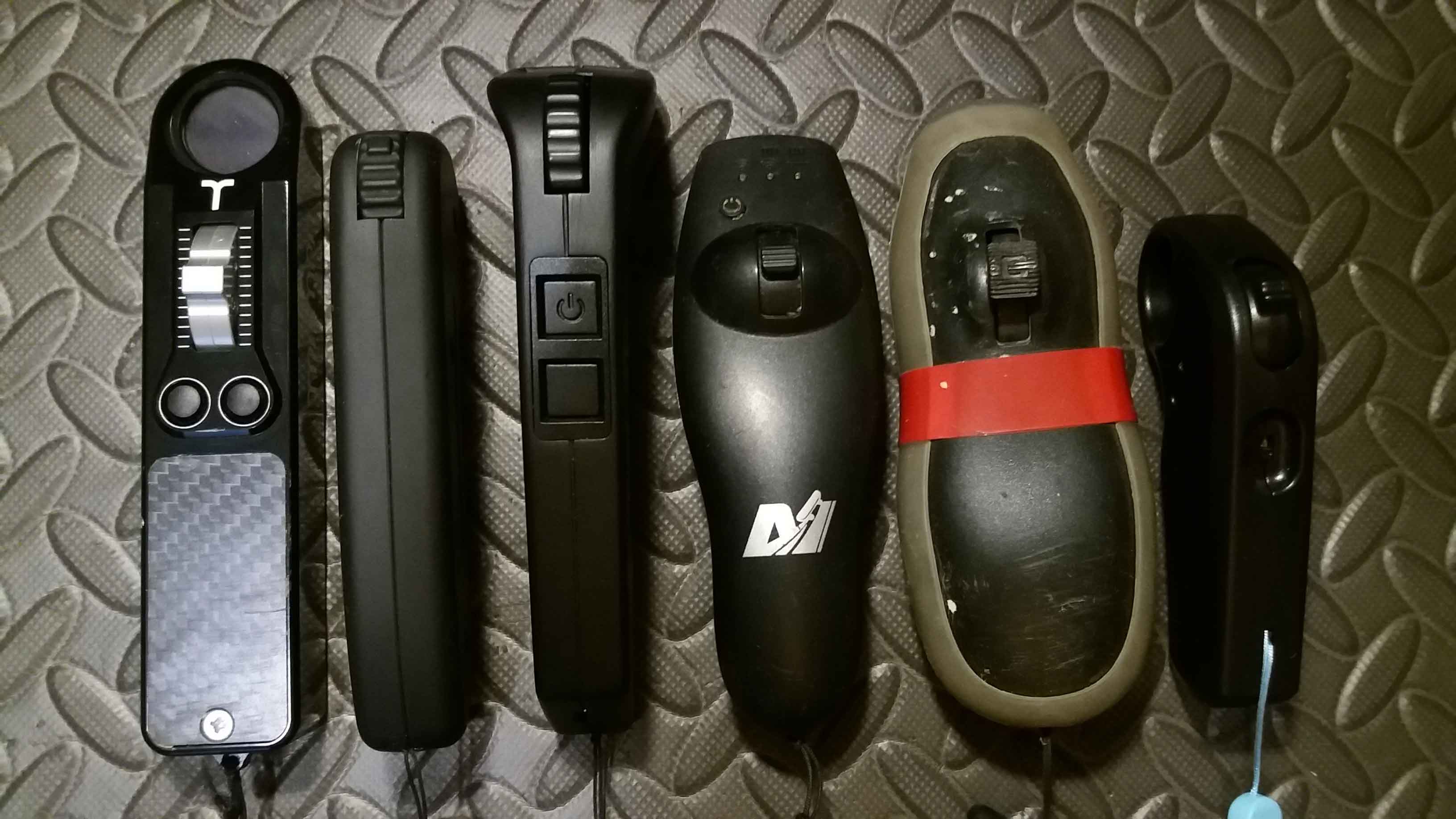

All these remotes and no mini?
Yup…
Well for me it’s too dangerous to switch between the mini and my remotes. I found it out the hard way :rofl:
I was riding a friend’s board with the mini remote doing hard acceleration and brake tests. Then I switched to my board and wanted to show him how my board behaves when slamming 100% brake at mid speed.
Instead of full brake I went full throttle because the mini trigger works the other way :man_shrugging:
Which is your favourite? Which are good and which are awful?
Good question, hard to give short answers but I try from left to right.
Wand
I used the remote only a couple of times so far but I like it. The throw is good and the display can be watched during riding. The cruise control is sick, not like the fake ppm cc. The battery percentage level is very accurate and personally like the AAA solution, too often I forgot to charge my remotes. The only downside is the thumb wheel, I don’t know how many crashes it can take, let’s see. The remote is quite heavy due to the aluminium case but if someone wants to steal my board I can knock him out by smashing the remote on his head.
VX1
Very nice and sturdy remote. The case and thumb wheel have a slip-proof coating which is perfect for gloves. No drop outs during riding yet but 2 times it disconnected for about a minute, no idea what happened. The only downside is the very short throw which is ok for boards with smaller motors but you can’t tame a beast with the VX1. I used it a couple of times with dual 6384 motors but that was no fun at all.
VX2
The throw is looooong! There is more spring resistance on braking. The case and thumb wheel is a bit slippery but I haven’t used it yet so I can’t tell about real life experience. I own it since a week and me lucky MF won it in the Bioboards lottery.
Maytech V2
Nice remote if you live in the desert or far away from civilisation. I had many dangerous moments due to disconnections in the city. On EVERY ride this remote has drop outs at least here in vienna. If you ride in the woods or avoid streets or buildings it works fine.
Maytech V1 (Steez)
It was my favourite remote for 2 years, never had disconnections but you have to mod the buttons on the PCB first otherwise they bend or snap off, badly designed. I used them on 2 builds and had random brake cut-offs on hard braking before standstill. After watching RT data I found out that both remotes are faulty and the root for the skipping brakes.
Wining V2
I didn’t test and won’t use it after reading too much horror stories about stuck full throttle. If someone needs a thrill in his life then pay shipping and it’s yours.
There is a newer vx2 with a tab on thumb wheel that makes it easier to use.
Thanks for the detailed response. I really like my maytech V2 but I live in the middle of nowhere. It also seems like there was a revision of these where they changed the antenna at some point cause my newer one is different to my older one.
Good to know, mine is a former (test) version.
Does the new version have the same slip-proof surface as the VX1?
Interesting, my Maytech V2 is for sure the first version.

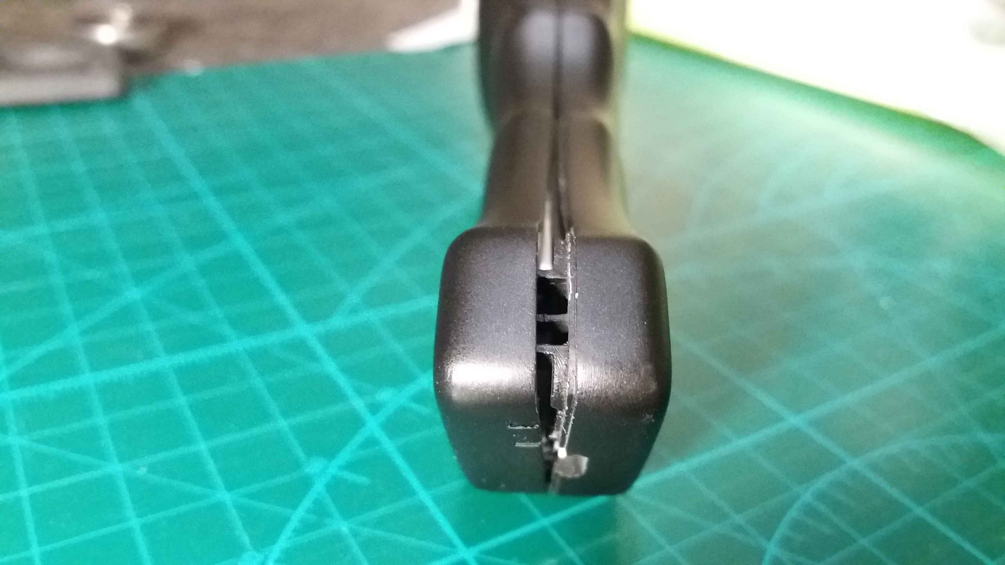

Whaaat… the VX2 just dropped from the chair to the floor (carpet)
Unintented bench test failed :rofl:

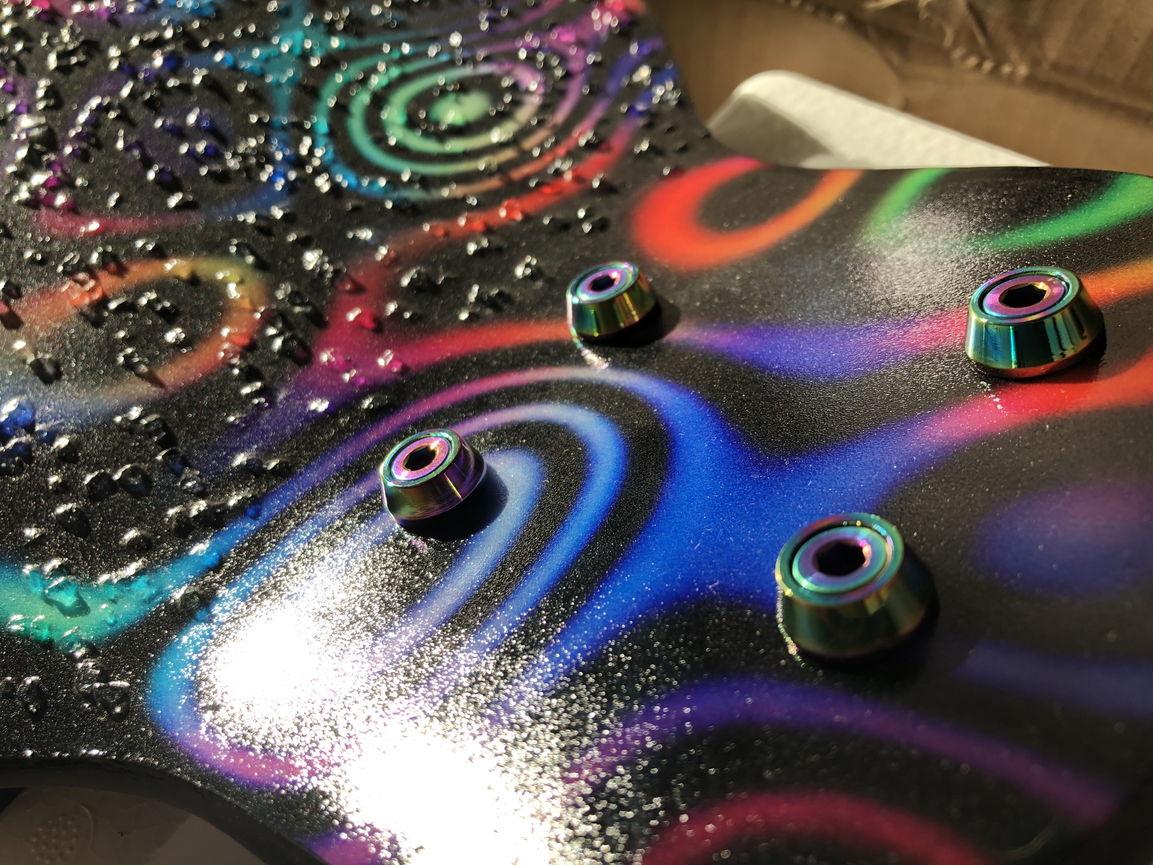

Yeah, they feel almost identical.
Hope you like being twins because I have those fender washers, the oil slick matrix 2s, and a space themed deck coming my way :kissing_heart:
is that the first Secret Santa package already?
Yes but indirectly… it didn’t really go over the “official” channel but as far as I can tell it’s @Goldrabe 's contribution… :smile:

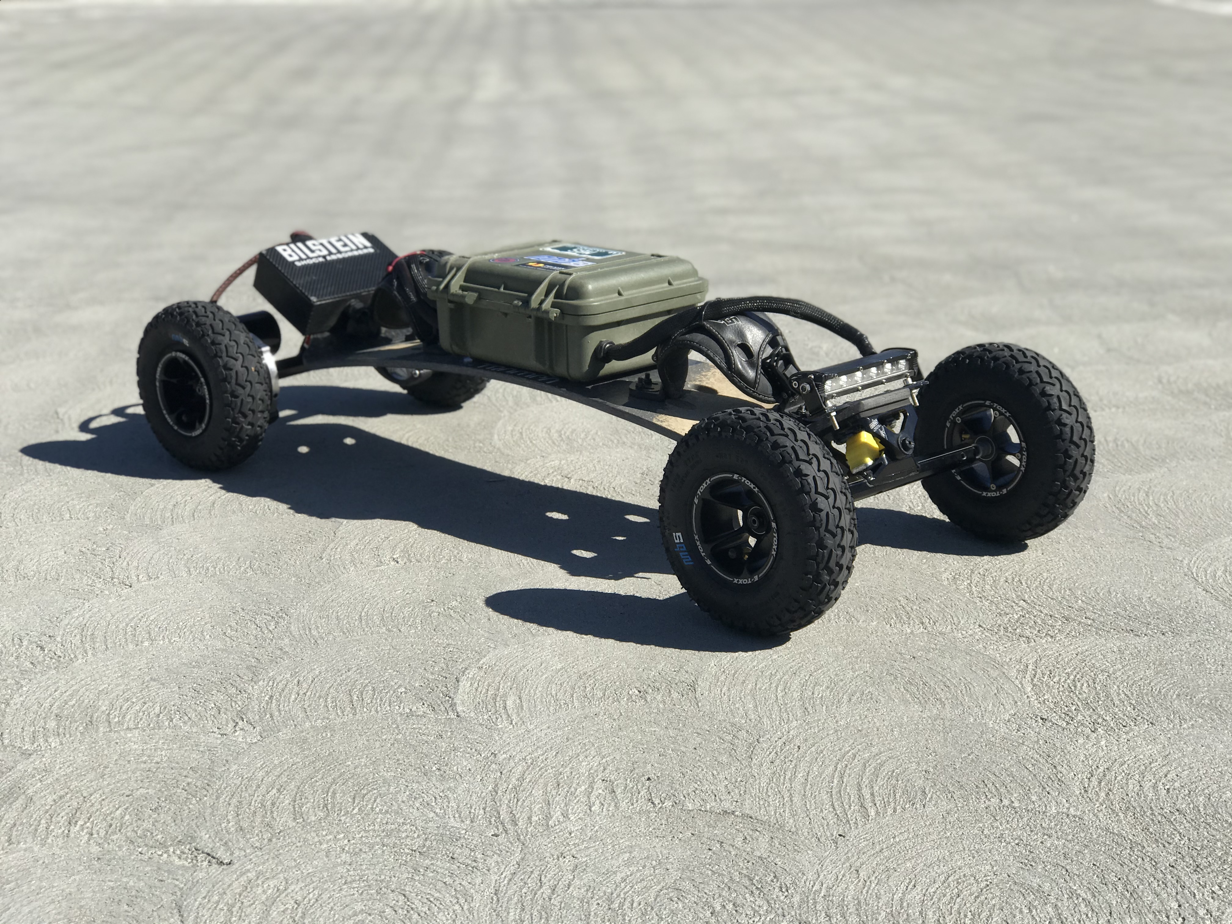

What case?
The battery box? Pelican 1200.
I’m trying hard to get decent amount of batteries underneath the deck with some 3D printed enclosure but it takes too damn long and I’m tempted to just do it the easiest way and get it going finally…
What are the specs for this battery pack?
It’s two 6s 10ah lipo connected in series.
Ohh I thought you use it for 18650 cells.
But people put 18650 in same case right?
Yeah plenty of space. 20700/21700 works too. We put a 12s7p 20700 cells with a charge only bms in a trampa monster box.
This is just for offroading fun rides. I don’t need a lot of range as of yet.
