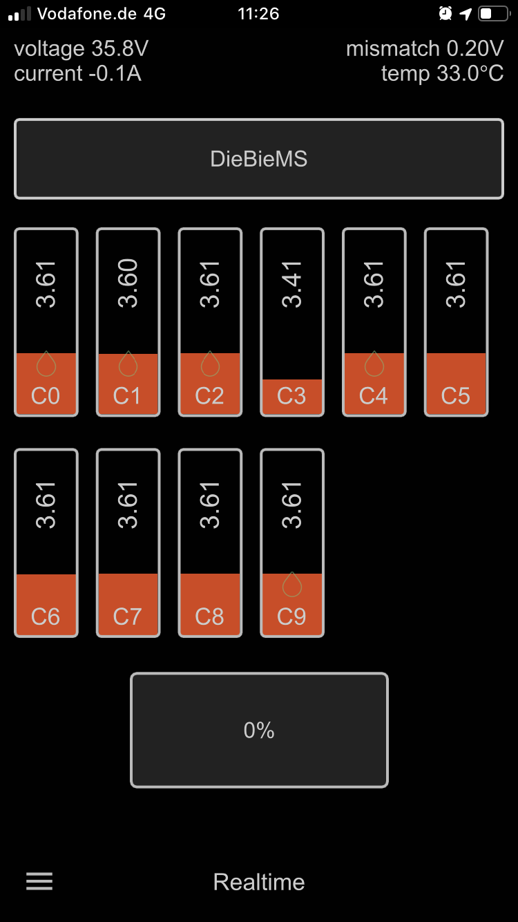

That’s my worst nightmare… Especially after the enclosure is sealed ā€˜for the last time’ :weary:
Yeah, if it wasn’t for the Diebiems I’d probably damaged the whole pack in the long term
And that’s exactly why you want to be Monitoring individual cell voltagesā„¢.
BTW, same thing happened to my battery pack. I’ve done at least 30 cycles since then without fixing anything and it’s still working fine, only with reduced capacity. It’s possible to live with it as long as you keep an eye on the voltages while charging and stop charging at the right time. In my case, once the weaker P-group reaches 4.2V, the other p-groups are at 4.1V, at which point I just stop charging. I don’t balance.
I need the full capacity to comfortably get to uni and back, about 32km (10s4p 30q) :grimacing:
Surgery incoming…
And precisely why I’ve got a davega x on the way :wink:
Turns out one of the single cell fuses was not soldered properly (my mistake… )
Monitoring every single cell is useful when you don’t have a discharge bms that does coulomb counting. The diebiems must have noted the difference.
Anyway, quick solder fix and the board is back running. I will monitor the cells closely and see if they stay balanced
