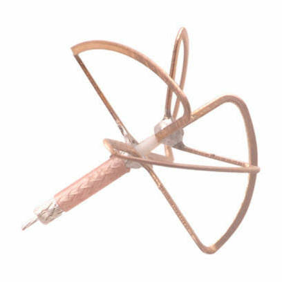

My “antenna” is a little wire coming our of my Rx, no structure as such just a bent wire.
YES… and at the ends of that wire are signal nulls… zip, nada, nothing… and when that aligns with the transmitter nulls… you have zip, squat, nada, nothing… zip…

How about with one of these?
if you insist… but even that antenna has nulls… it’s easier just to verify antenna lengths and orientations than add a bunch of gogbbly-goop, and as an aside… have you ever measured one of those in 2.4gHz… I think not… hahahaa

All this does not bode well for esk8 remotes that change orientation all the time. How do mobile phones solve the issue?
no… it’s easy… antennae alignment… do some reading… it’s fascinating… most of the time it works… (skateboards) cell fones operate on a different frequency… i’m not saying i can solve your problem… i;m just trying to help
