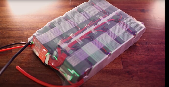

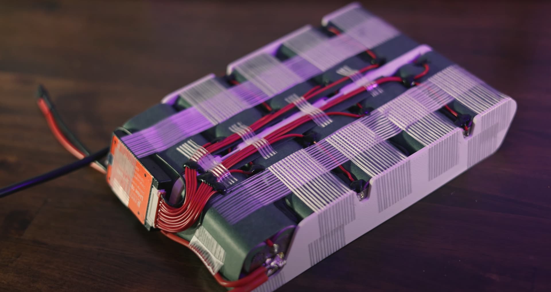

Wow…amazing attention to detail. Absolutely gorgeous.
Thank you :pray:

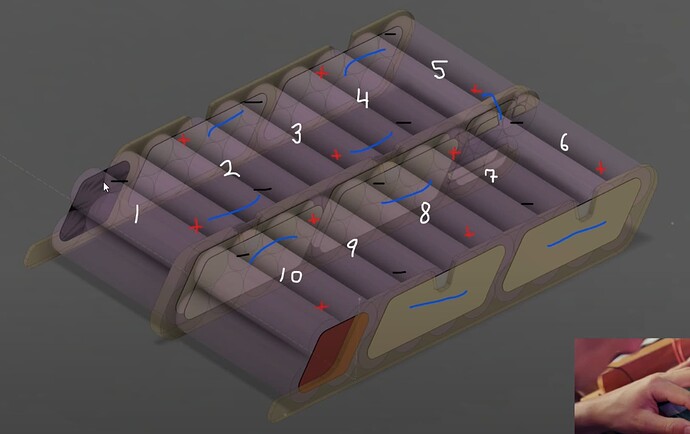

I would love to hear/see more about that pack construction, especially the cell frames system, if you’re willing to go into detail.
So much so, it looks like a render.
yep. this is really special @daegoe . whatever Onewheel is getting this, is super lucky!!!
I agree, looks beautiful. I’m curious about the construction too - I made something similar a year ago, but not quite as refined, and only 10s
And the most annoying part was the series connection in the middle - what did you end up using for that?
Thanks so much guys!
@BenjaminF @ShutterShock I made a topic and a video explaining the construction and some other ideas I had for the pack.

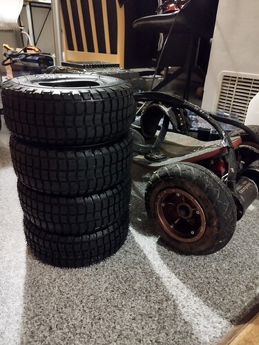

@alankerr Are those tires clever brand? Did you have any issues fitting them onto the rims? How balanced are they?
I’ve got a set of clever branded ones. Had to cut away quite a bit of material with a knife from the inner lip to make it fit to the 4" lip of my mbs rockstar ii pro xl-s. My ones measured at around 3.9" ID
I have the CST brand but those on picture look exactly like the ones I have. There was another brand I used that had the same issue with rim tightness. I don’t remember what brand. Rep said I had to leave them in the sun. Then I bought the CST. These fit snug, but not tight. I use Trampa hubs. I’m not privy to mbs hub sizing yet. As to balancing, it’s like a motor bike wheel, line up the rim of hub to line on turf tire as you slowly intermittently fill the tire. Fill it slowly as you mold the tire to the line. They balanced well.
Interesting! I guess my next set will be CST then. Hopefully I can get these seated reasonable well for some offroading though
