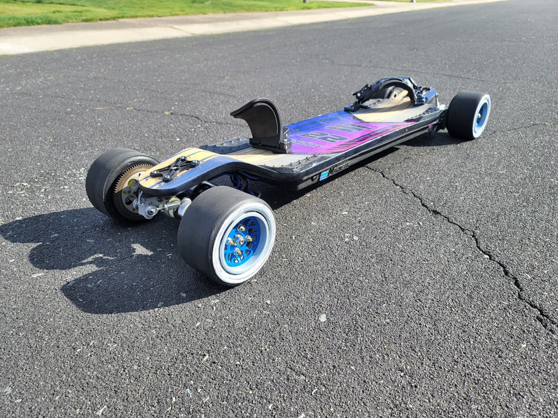

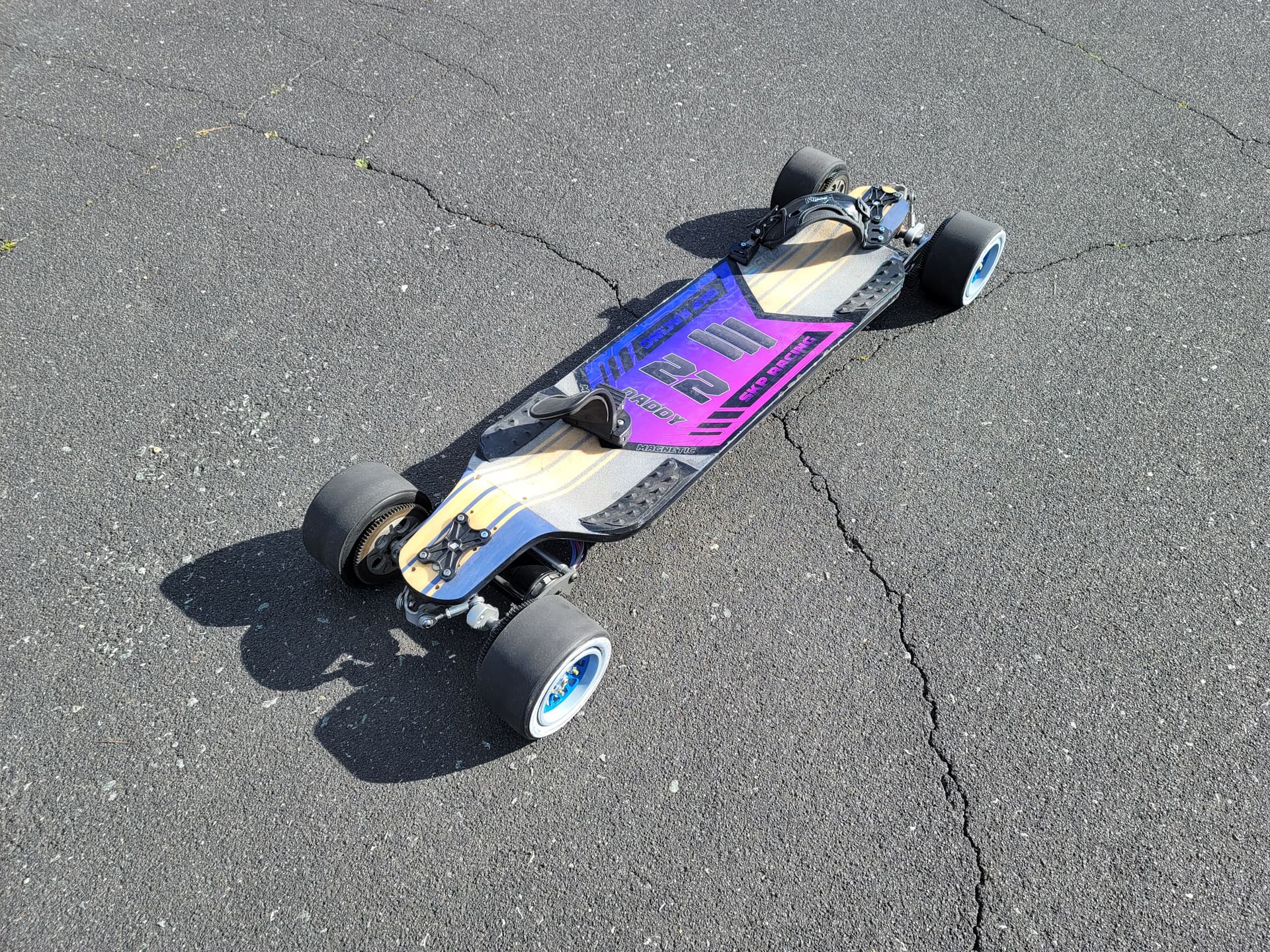

It was pretty easy to mount the tires. I just had to put a foot on the hub to squish the tire to get the first screw threaded. The rest went on easy after that
@Shadowfax @rafaelinmissouri if you want to widen the hubs here are the files, print them from PETG and they will survive pretty much anything, I tested them pretty extensively at this point. I can make other width as well if you want but it has to be over 10mm. (only fits XL hubs)
If anyone wants to print wideners for the MBS rockstar II pro XL hubs / rims here are the files, I just realised I still havenāt shared them yet: The step file for 20mm if you want to make your own version mbs_wide_20.step (75.4 KB) The STLs from 10mm up to 40mm in 5mm increments mbs_wide_10.stl (143.3 KB) mbs_wide_15.stl (171.6 KB) mbs_wide_20.stl (178.1 KB) mbs_wide_25.stl (200.4 KB) mbs_wide_30.stl (206.8 KB) mbs_wide_35.stl (224.9 KB) mbs_wide_40.stl (231.3 KB) The minimum length ā¦
If the fitment is too tight, take a dremel with a sanding disk to it going around in circles and within a minute or two you can probably make it fit. Try not to remove too much material though.
The only thing to be aware of is that the bearing seats of the hub can loosen up from a lot of abuse especially when widened, and you should check the bearings periodically, especially the inner one likes to wear a bit over time. For most tires youād be best of with the 15mm one. Perfect fitment for linnpower slicks and the like and also about right for my 9" treaded tires. Itās pretty much only the 9" slicks that really prefer something wider.
Siiiick - thanks dude! 10mm could be just the ticket here for the original xl rims with the mbs / cst rally tires
[20250303_145724] [20250303_145730] [20250303_145702]
Love the dual approach from tomiboi on the rear and MBS on the front, Iād been thinking about this for the dreamonseed
I reaaly like it! Lock you in really well
cst rally tires
What are those?
Thatās just what I call the big chungus tires that mbs sells. I think theyāre called the agent tire or something.
