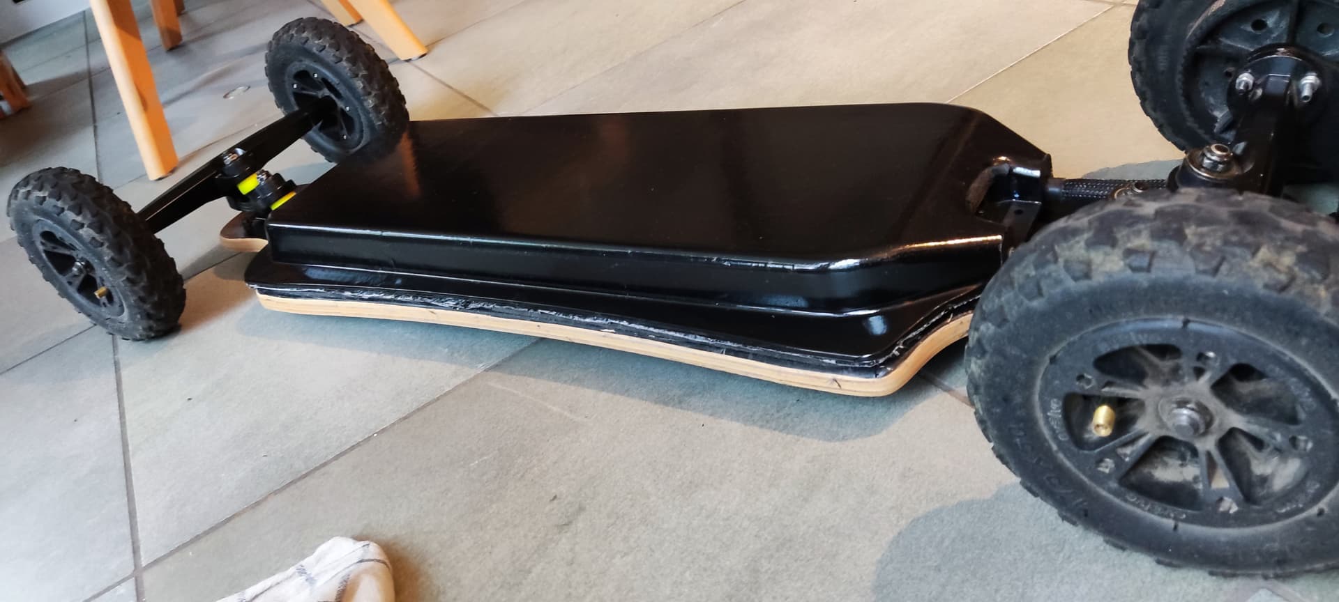

Made it for a evolve GTX bambo deck.
I’m not sure yet if I will skin the deck to be more stiff or do anothe flexible version of this enclosure.
This was mostly for trying out the whole process. Since this ist my very first mold and enclosure I wanted to start with a lesser complicated lamination.
Edith: I did a 3D printed inlay for the geometry of the xt90 loopkey. This work pretty well. So maybe I just put some 3D printed rips as inlays in there as well to make it flexible.
Maybe I have to start a thread about my tinkering. In short: CAD, 3D printing of the mold, grinding, lacquer the mold, printing the inlay, GFK layup.
This enclosure has a lot of air bubbles. Maybe some vacuming next time.

Made a test fit before doing any more on the cosmetical side (and chargeport and stuff). It is already stiff enough to dont need to add any more layers.
On the other hand the deck feels way less flexi now. Have to see if I like it.

I spend quite a lot of the time on the CAD design. Since I’m a engineer and do CAD all day long I’m quite familiar with the tool (I use Creo 7). I really hate grinding and polishing so the idea was to do it once with the mold and beeing able to produce at least two castings.
Giving it a coat of resin after demolding is definitly the faster way for a one time thing or/and if you dont have access to CAD and a nice 3D printer.
