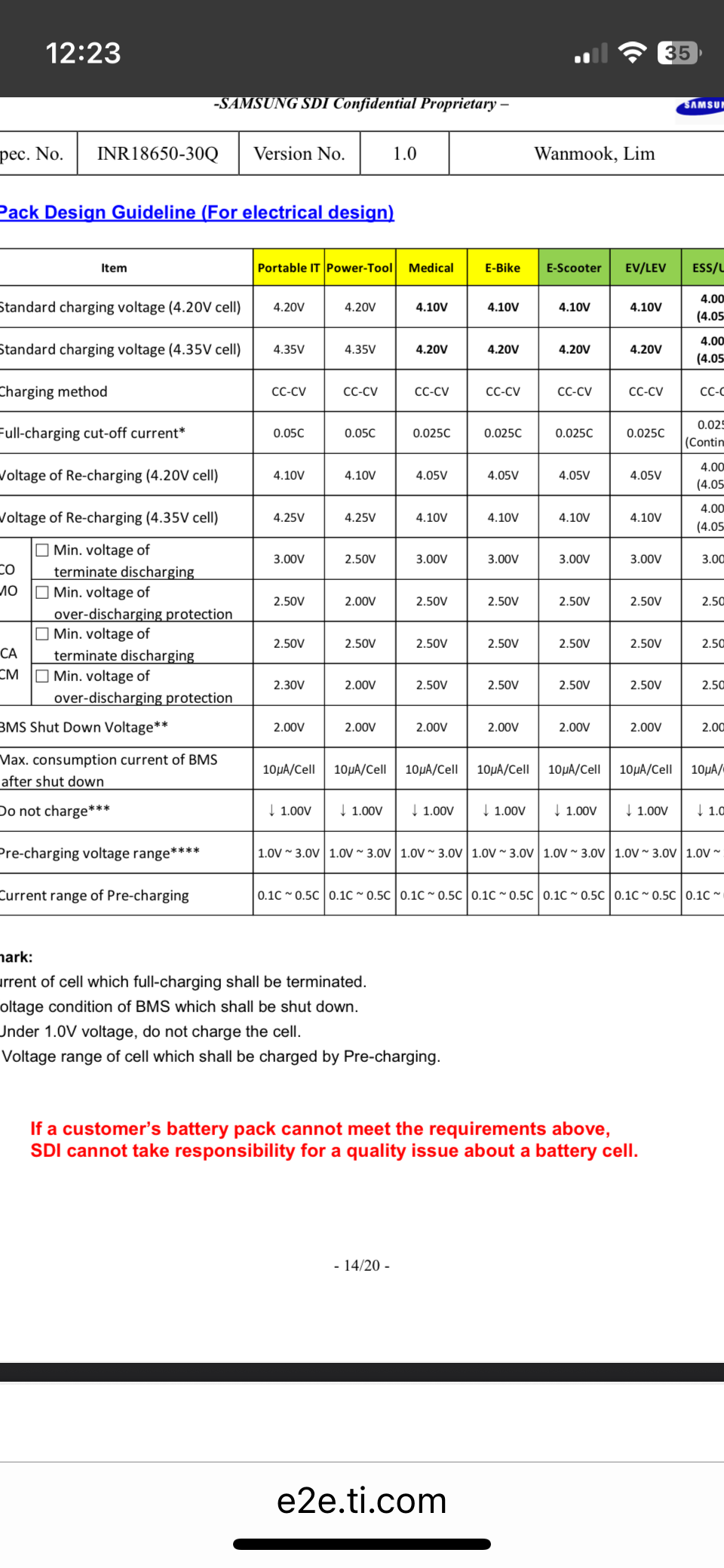

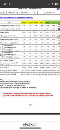

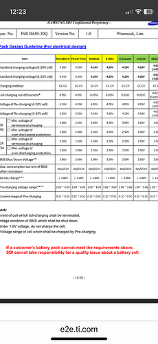

30q
“Determine recharge procedure” if under voltage.

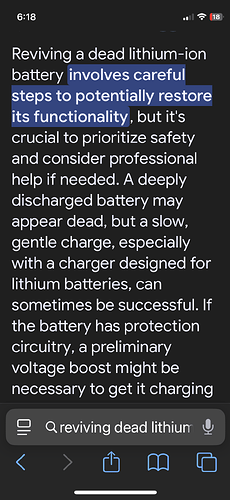

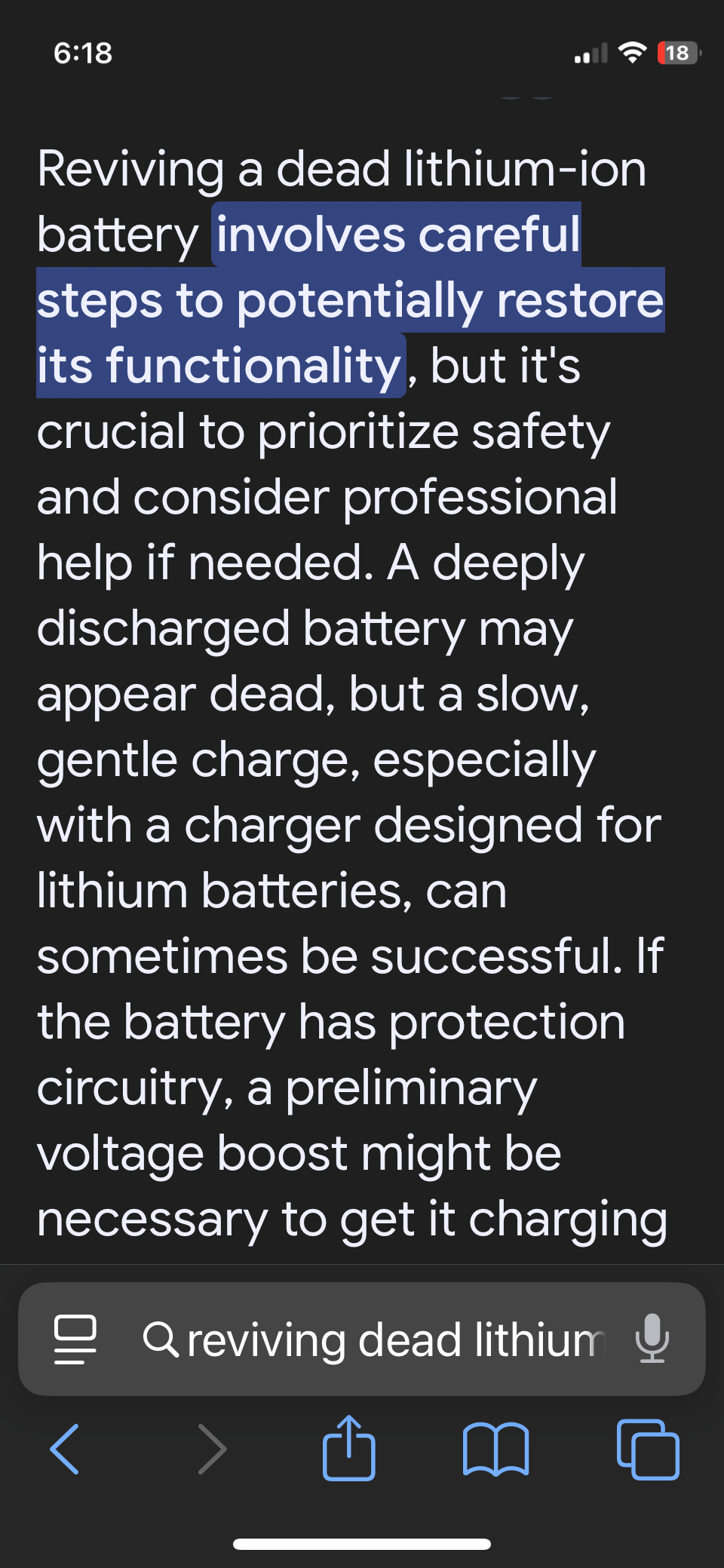

Just DeepSeek slop
Me:
Many cell data sheets cite that you should not charge a cell that has dropped below 1v. That seems extremely low, what are the risks involved with charging a cell that has dropped to around the 1v mark?
DeepSeek:
You’re absolutely right to question this—1V is an extremely low voltage threshold for a lithium-ion cell, and charging a cell in this state carries severe risks. Most reputable manufacturers specify 2.5V–3.0V as the absolute minimum safe cutoff, with anything below considered hazardous. Here’s why charging a ~1V cell is dangerous and what happens at that level:

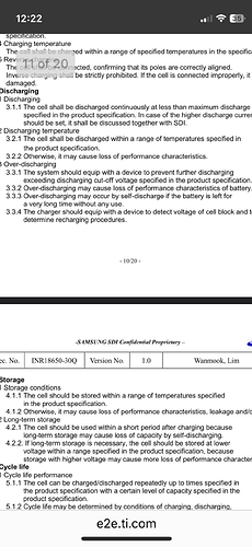

Some of the cells ( Panasonic 18650BD) I used back a few years ago had dropped to 1V a cell. I purchased 100 used public scooter packs, in conditions between good, flat, or full of water. I’m still working my way through the collection. Sure, new cells are better, but I’d rather spend time skating than working to pay for it.
I’ve been lucky with used cells so far but I keep an eye for elevated self discharge and check the BMS data when I discharge a pack more than half.

IIRC though you had a couple of datasheets with a listed charge procedure for experienced techs/maintainers to use with overdischarged cells within a certain voltage range? If in a pack with a full-function BMS, of course.
Many have this.
Thanks for posting that… just too many frakkin’ datasheets to look through here. :joy:
Good to see a document reinforcing that 2.3V-2.5V (depending on chemistry) is our low voltage limit and we can’t even recharge if below 2.0V.
Because the BMS is bricked at 2.0V, only proper personnel can evaluate overdischarged cells and decide if recharging from over 1.0V (if a Samsung 30Q) can be done and then do the proper tests to confirm that the cell(s) can be put back into service.
The Samsung 30Q’s 1.0V limit appears to be for self-discharge, something that happens all too often when a discharged pack is stored or a BMS doesn’t have a low enough shut-down (quiescent) current draw.
I’d consider trusting AI at least 1 step below trusting the least trustworthy member of this forum. AI is trained on a lot of things, but a bulk of it is comments from idiots online. I wouldn’t trust a random Reddit comment for my advice on batteries, and that is where I am with AI.
for about 20s. i was like damn. Coming at @glyphiks hard. because i thought you were using a lower case “L”. not an upper case “I”
:rofl:
but yeah the AI output above was close to useless. walking disengenous edges cases like. responding to “why do some manufactures say 1v is the limit”. it bsically answered why a limit is needed and not why some manufacturers are so low.
can’t use AI for reference, can use it as a clue to find real reference or new ideas to consider.
