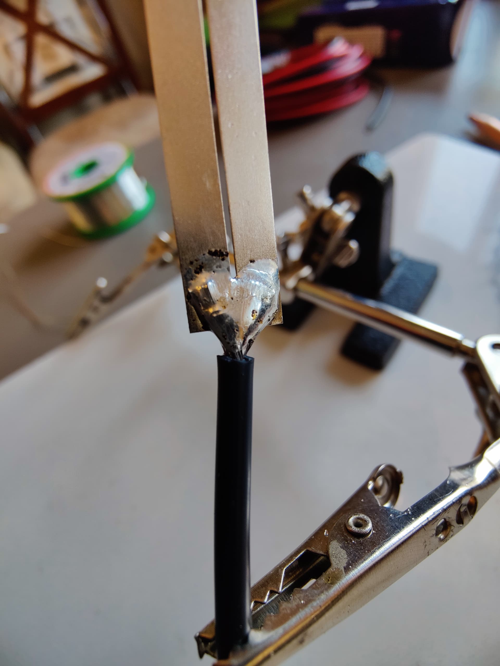

Rate my first battery build with the Kweld
I spent way too many years of my younger life soldering in poorly ventilated areas w/nothing pulling fumes out of my face (insert joke here)
Now I pretty much refuse to do a single joint without.

I love this solder. Bought it off @monsterbuilder ’s recommendation a while back and never looked back. Flows great.

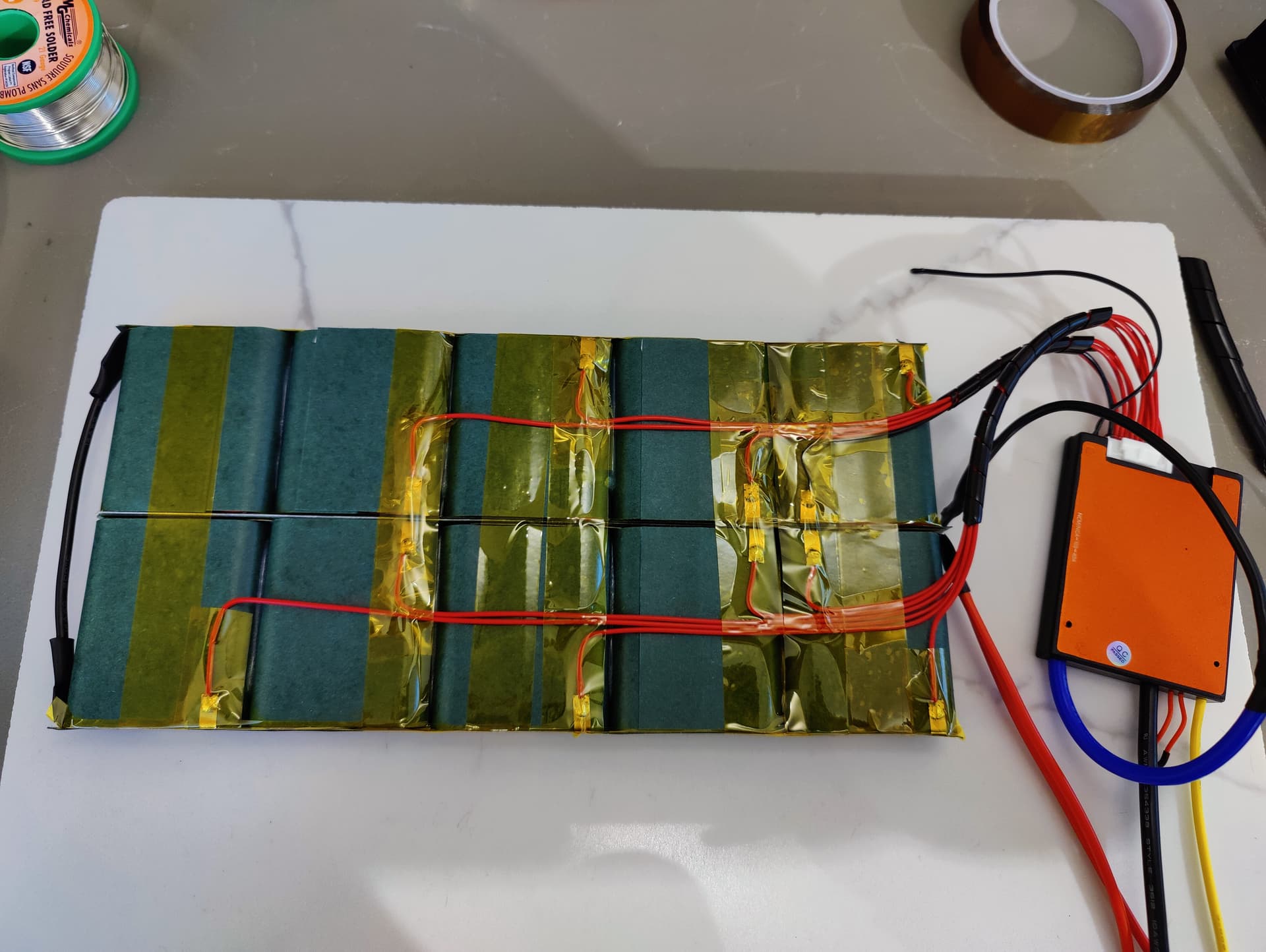

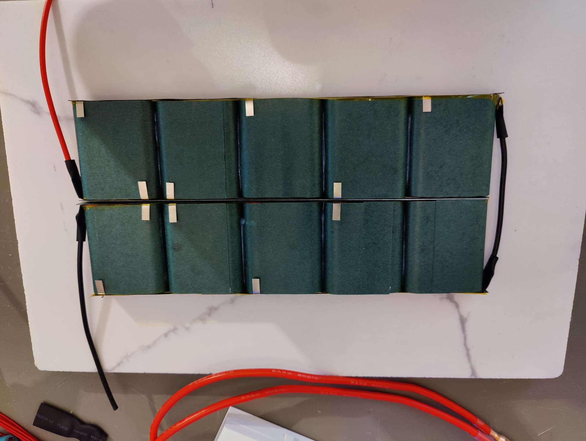

Rate my 2nd battery! :slight_smile:
This is my first time making a flat pack. I took all the feedback from the previous battery and applied them here.

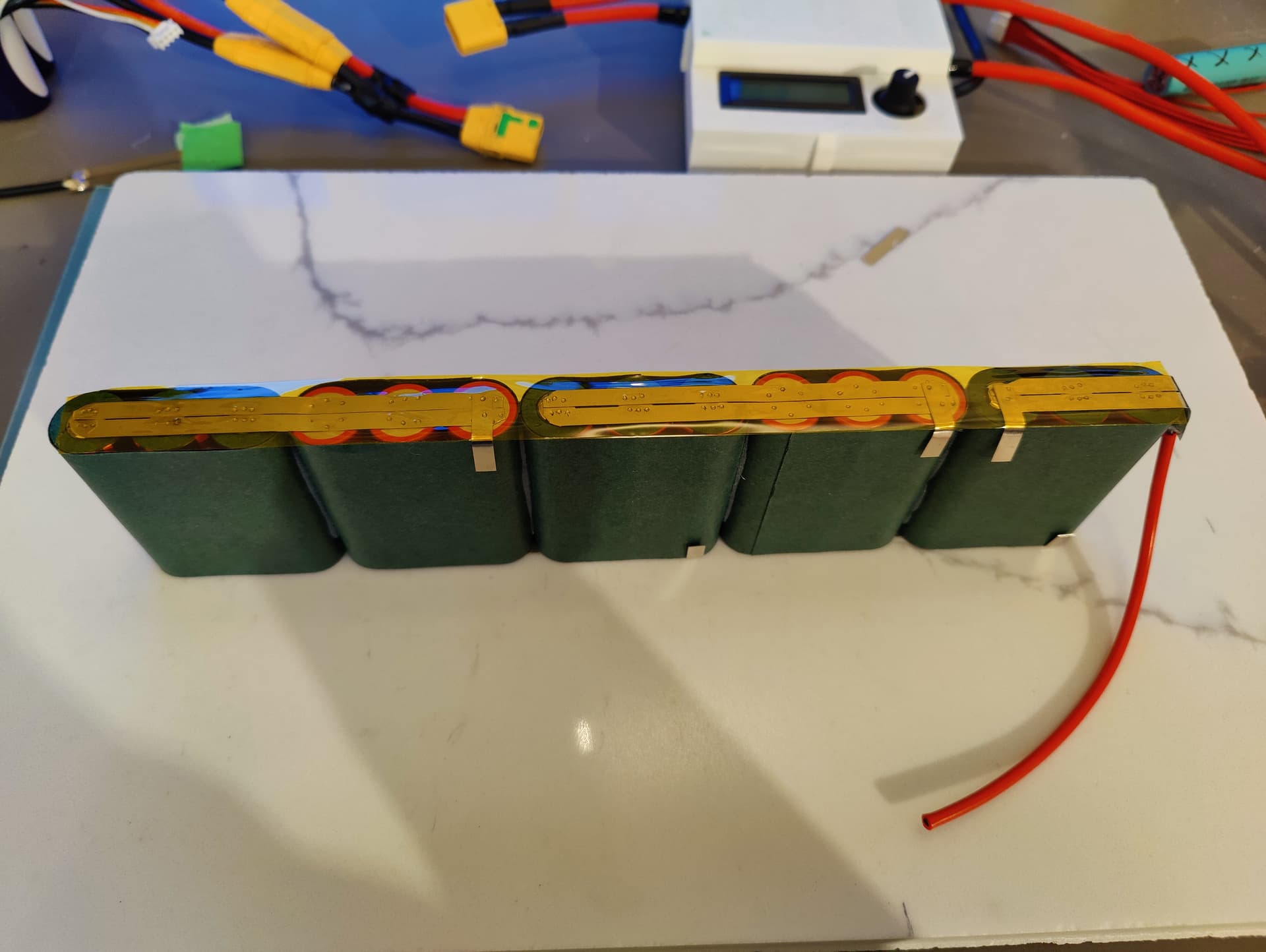

  • 10s3p flat pack for my friends non flex esk8
  • 30a max amps
  • Panasonic GA 18650 cells (3500mah)

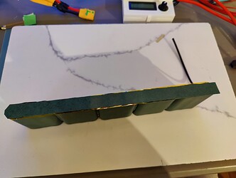

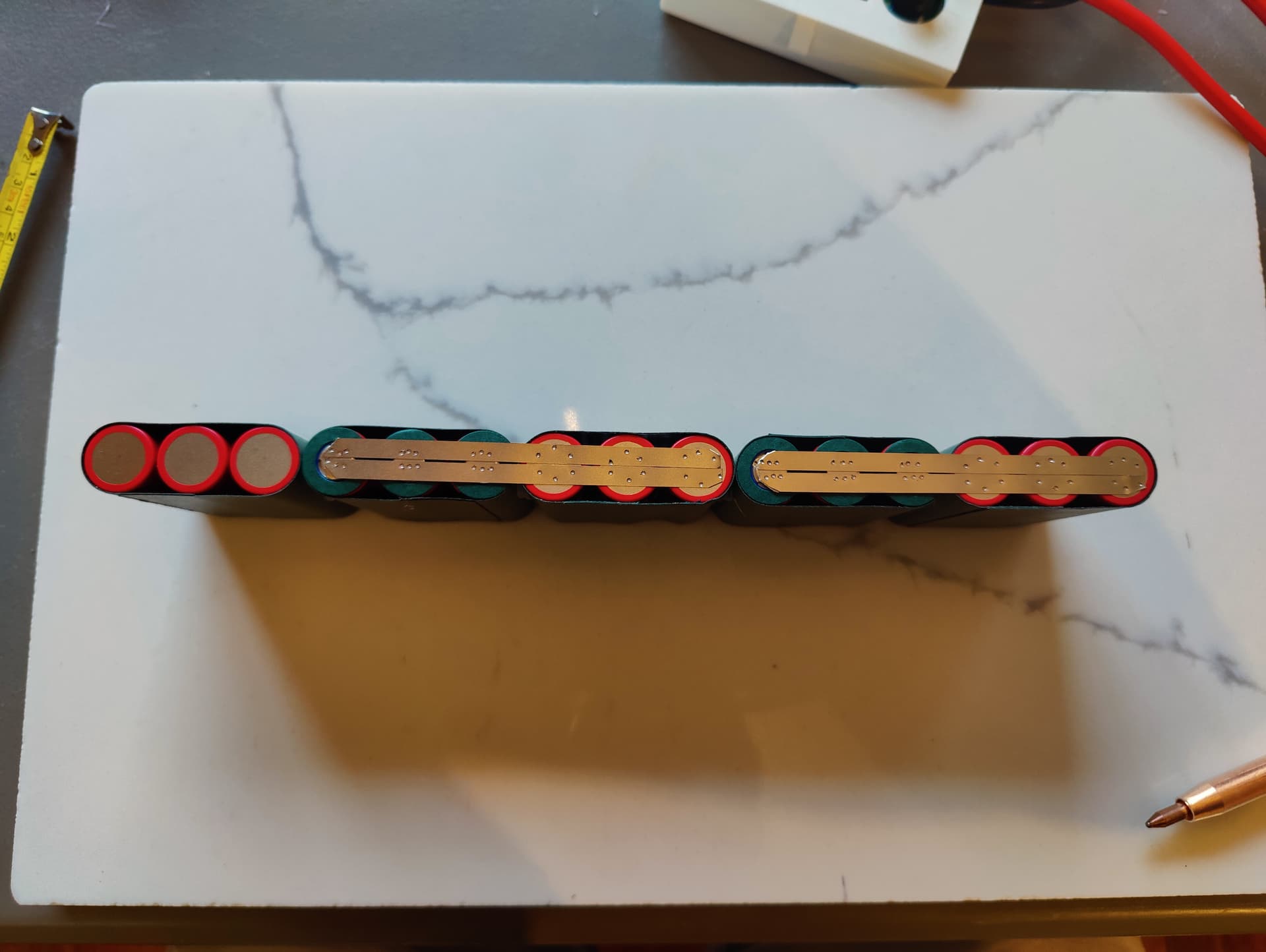

Step 1: Glue the P groups
Step 2: Wrap each group in fishpaper
Step 3: Glue the S groups together
Step 4: Spot weld. (snipped the corners on the positive ends)
Step 5: Solder on end leads. (Much better results with legit MG chemical solder)
Step 6: kapton tape and fishpaper the sides
Step 7:

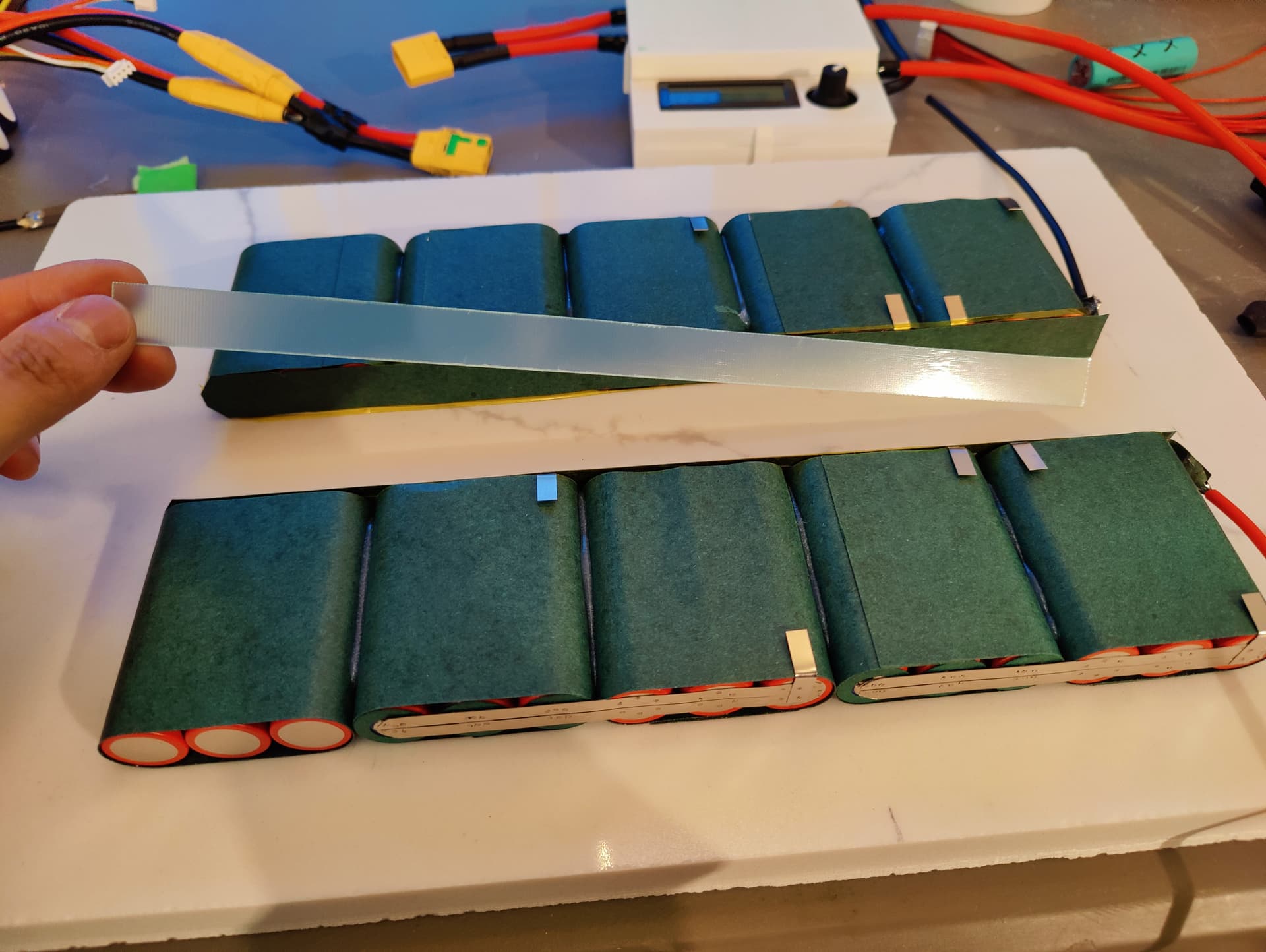

I added a FR4 fiberglass sheet between the halves for extra protection

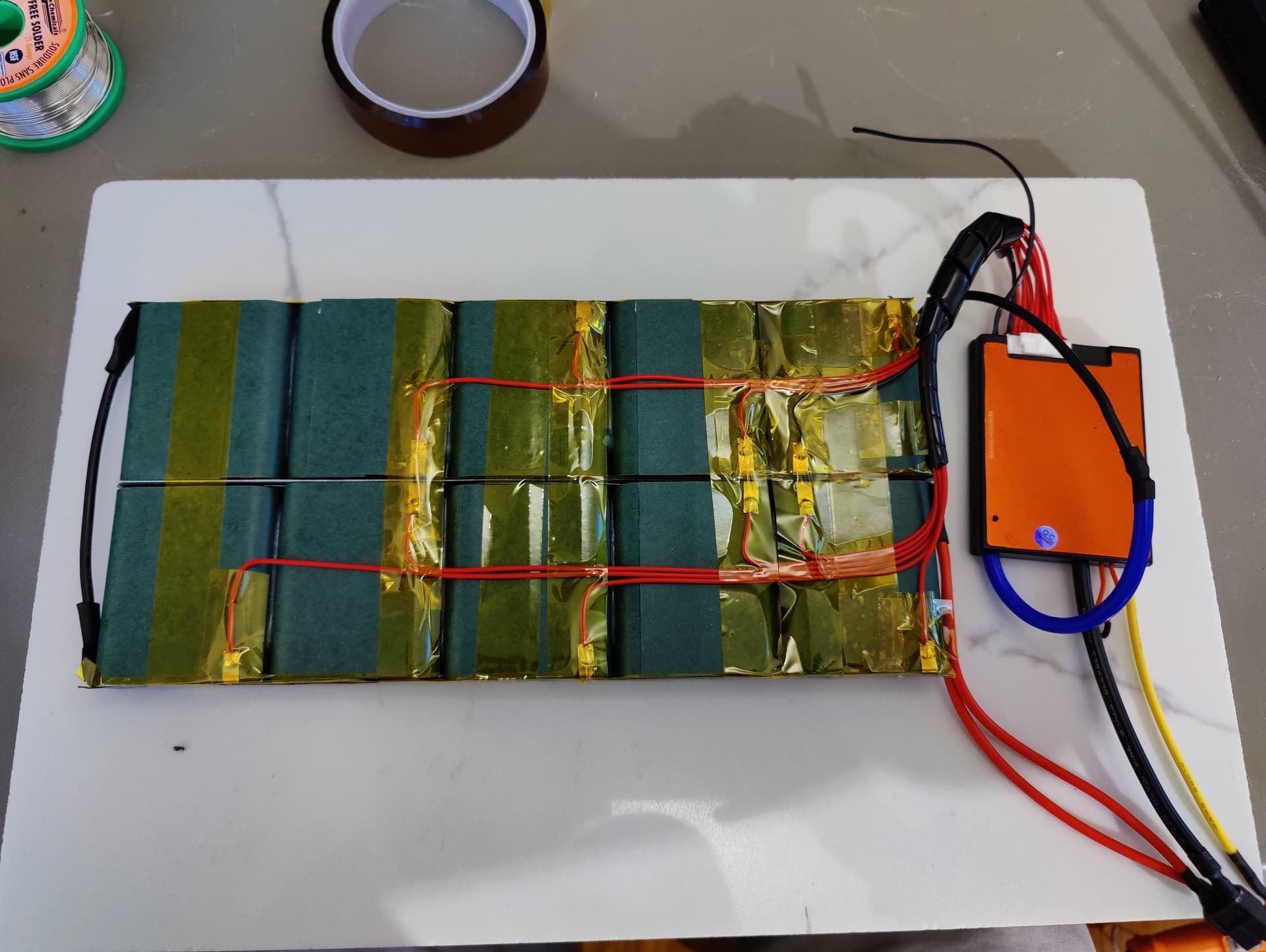

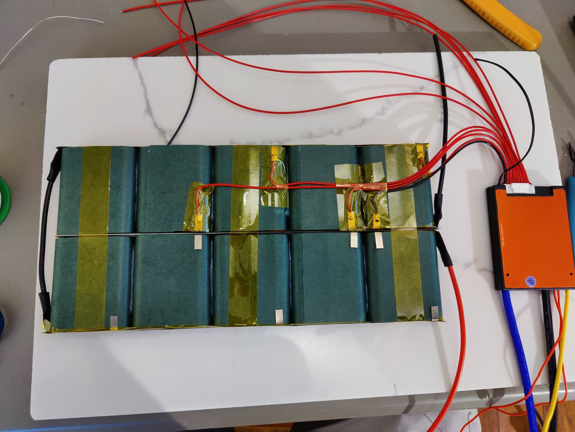

Step 8: BMS balance wire tabs
Step 9: BMS leads

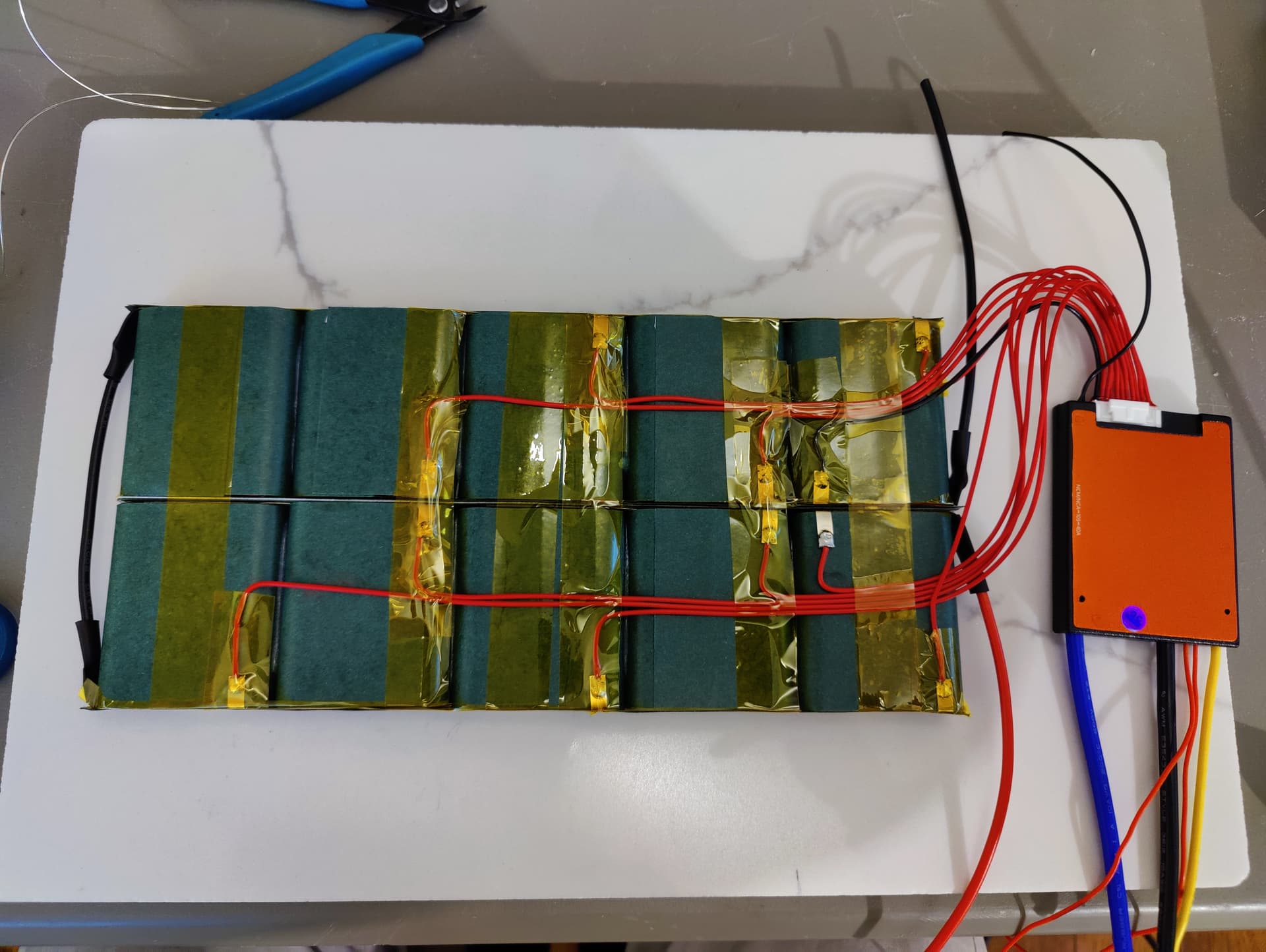

Step 10: End leads
Step 11: Added some ebike wire loom I had for the balance cable exit since the BMS won’t be heat shrinked. And taped the + and - wires to the pack.

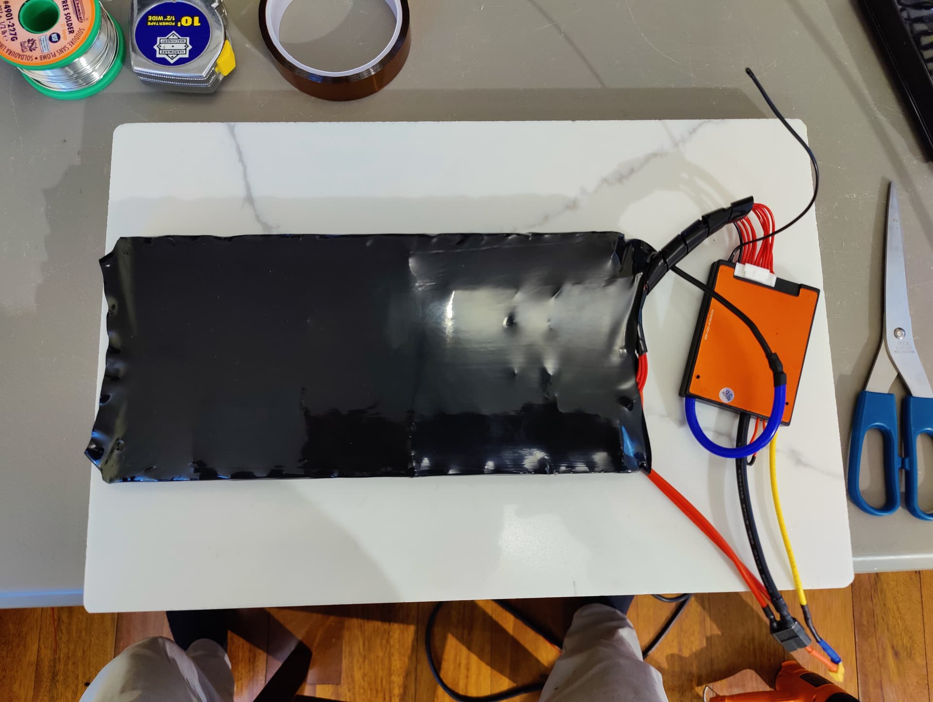

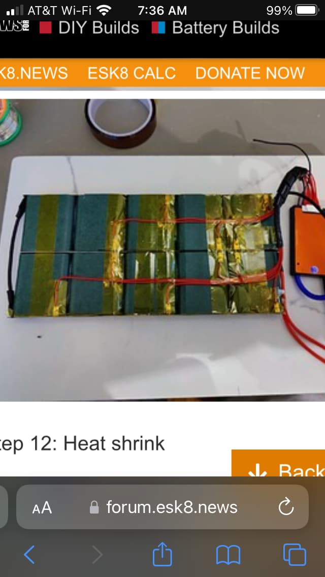

Step 12: Heat shrink
Thanks for any feedback you may have

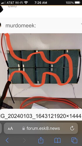

I wouldn’t have those balance lead tabs right next to eachother like that between the 2 halves,
especially tabs for the first p group and last p group. that is playin with fire
Keeps terminals separated. Maybe too late but could just flip the top n bottom halves
Some extra fish paper there will mitigate the risk mostly so you don’t need to redo that part.
Seems missing some balance wire connections.
theyre all there
