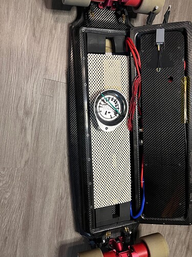

Inside of the thing is really cool, and I guess a window of no carbon on top rear so that there is less RF loss from receiver

Wtf discharge bms :skull_and_crossbones::skull_and_crossbones::skull_and_crossbones:
Peeps gon die
It is definitely the biggest bms I have ever seen, why is it so dangerous to have them discharge? I have seen that the quality control for bms is usually shit.
So every1 bypasses BMS for discharge because they “usually” can’t handle what the esc wants?
Yes, because we rather come to a stop on a flaming board than get tboned by traffic on a not-on-fire board lol
(Talking about the situation in which you go down a big hill with a fully charged battery).
The worst part about seeing that giant BMS in there is that it’s evidence that whoever engineered this board has not been keeping up to date on diy esk8. I do not trust things built by those who just follow the datasheet.

The awful cold weather performance is probably due to the bms. If you bypass the bms, I bet you’ll have better performance at 30f.
@glyphiks is right that cells perform worse at low temps, but they don’t drop off a cliff at 30f. They should still perform ok at that temp.

BATTERY: 33.3V, 10AH, 333Wh custom built 9S2P configuration LiPo rated for 150A maximum continuous discharge with
yeah you def were right, no problems since its been 45 F plus now
11s BMS on a 9s battery?
