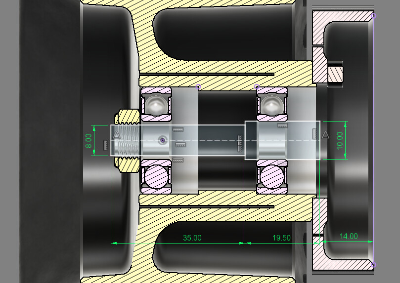

Hoping to get a set of these & just want to make sure I understand the bearing setup right to see if what I’m thinking is possible.
In this case I would be wanting to run these on boardnamics 10/8 stepped axles hopefully interchangeably with the AT hubs/pulleys on there now and it seems like if I understand correctly - with the bolt on radium pulley - they could use the stepped axle if I put a 10x28 bearing in the inner, then a spacer (would this be 10mm or a different length?), and a 8x28 in the outer bearing position?
I am starting to feel how i felt when i saw everyone buying Dualities… FOMO! might have to buy a set of SR125 just to have them sit there wait for me until i am finished with a build specifically made for them :eyes:

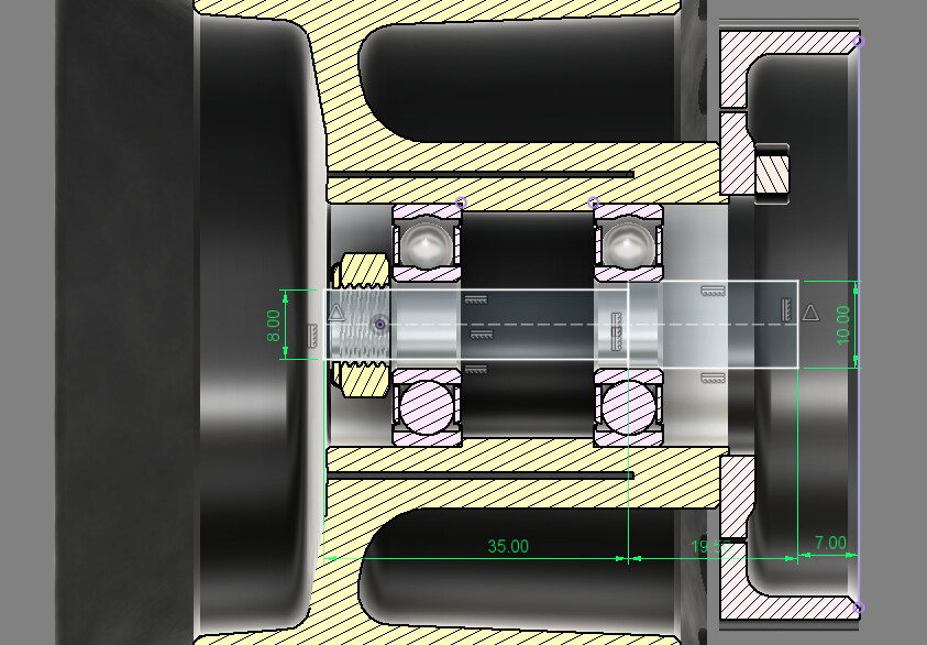

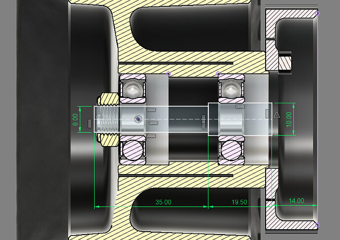

What is the length of both axle sections?
The 10mm part is about 19.5mm and the 8mm part is 35mm with about 10mm threaded
So these would be your two options depending on which spacers you use. And you can just use the included 10mm axle spacers for 8mm axle as the NSK 28-8 bearings have quite a thick inner race. You’d probably want to play with shims/spacers for the narrow bearing spacing option to get that inner bearing sitting fully on the 10mm portion.
Thanks - I really appreciate the diagram! Looks like I’ll have a good amount room to work with on the first option to get the pulleys to line up the same place as my pneumatic ones, which I was hoping for.

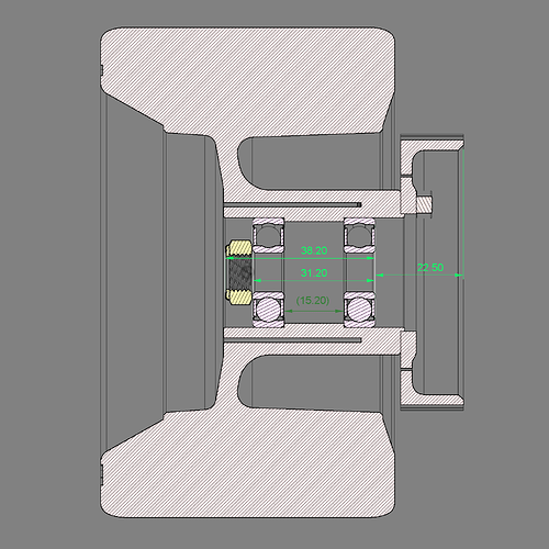

Reference drawing with narrow spacing for those unsure about compatibility with their axle length and motor mount position.
